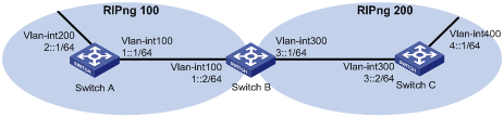

RIPng route redistribution configuration example
Network requirements
As shown in Figure 2, Switch B communicates with Switch A through RIPng 100 and with Switch C through RIPng 200.
Configure route redistribution on Switch B, so the two RIPng processes can redistribute routes from each other.
Figure 2 Network diagram
Configuration procedure
1.     Configure IPv6 addresses for the interfaces. (Details not shown.)
2.     Configure basic RIPng settings:
# Enable RIPng 100 on Switch A.
<SwitchA> system-view
[SwitchA] ripng 100
[SwitchA-ripng-100] quit
[SwitchA-Vlan-interface100] ripng 100 enable
[SwitchA] interface vlan-interface 200
[SwitchA-Vlan-interface200] ripng 100 enable
[SwitchA-Vlan-interface200] quit
# Enable RIPng 100 and RIPng 200 on Switch B.
<SwitchB> system-view
[SwitchB] ripng 100
[SwitchB-ripng-100] quit
[SwitchB-Vlan-interface100] ripng 100 enable
[SwitchB] ripng 200
[SwitchB-ripng-200] quit
[SwitchB] interface vlan-interface 300
[SwitchB-Vlan-interface300] ripng 200 enable
[SwitchB-Vlan-interface300] quit
#  Enable RIPng 200 on Switch C.
<SwitchC> system-view
[SwitchC] ripng 200
[SwitchC] interface vlan-interface 300
[SwitchC-Vlan-interface300] ripng 200 enable
[SwitchC-Vlan-interface300] quit
[SwitchC] interface vlan-interface 400
[SwitchC-Vlan-interface400] ripng 200 enable
[SwitchC-Vlan-interface400] quit
# Display the routing table on Switch A.
[SwitchA] display ipv6 routing-table
Destinations : 7 Routes : 7
Destination: ::1/128                                     Protocol  : Direct
NextHop    : ::1                                         Preference: 0
Interface  : InLoop0                                     Cost      : 0
Destination: 1::/64                                      Protocol  : Direct
NextHop    : 1::1                                        Preference: 0
Interface  : Vlan100                                     Cost      : 0
Destination: 1::1/128                                    Protocol  : Direct
Destination: 2::/64                                      Protocol  : Direct
NextHop    : 2::1                                        Preference: 0
Interface  : Vlan200                                     Cost      : 0
Destination: 2::1/128                                    Protocol  : Direct
Destination: FE80::/10                                   Protocol  : Direct
NextHop    : ::                                          Preference: 0
Interface  : NULL0                                       Cost      : 0
Destination: FF00::/8                                    Protocol  : Direct
3.     Configure RIPng route redistribution:
# Configure route redistribution between the two RIPng processes on Switch B.
[SwitchB] ripng 100
[SwitchB-ripng-100] import-route ripng 200
[SwitchB] ripng 200
[SwitchB-ripng-200] import-route ripng 100
Destinations : 8 Routes : 8
Destination: 4::/64                                      Protocol  : RIPng
NextHop    : FE80::200:BFF:FE01:1C02                     Preference: 100
Interface  : Vlan100                                     Cost      : 1
