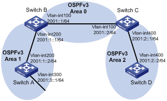

OSPFv3 stub area configuration example
Network requirements
As shown in Figure 1:
·     Enable OSPFv3 on all switches.
·     Split the AS into three areas.
·     Configure Switch B and Switch C as ABRs to forward routing information between areas.
·     Configure Area 2 as a stub area to reduce LSAs in the area without affecting route reachability.
Figure 1 Network diagram
Configuration procedure
1.     Configure IPv6 addresses for interfaces. (Details not shown.)
2.     Configure basic OSPFv3:
# On Switch A, enable OSPFv3 and specify the router ID as 1.1.1.1.
<SwitchA> system-view
[SwitchA] ospfv3
[SwitchA-ospfv3-1] router-id 1.1.1.1
[SwitchA-ospfv3-1] quit
[SwitchA] interface vlan-interface 300
[SwitchA-Vlan-interface300] ospfv3 1 area 1
[SwitchA-Vlan-interface300] quit
[SwitchA] interface vlan-interface 200
[SwitchA-Vlan-interface200] ospfv3 1 area 1
[SwitchA-Vlan-interface200] quit
# On Switch B, enable OSPFv3 and specify the router ID as 2.2.2.2.
<SwitchB> system-view
[SwitchB] ospfv3
[SwitchB-ospfv3-1] router-id 2.2.2.2
[SwitchB-ospfv3-1] quit
[SwitchB-Vlan-interface100] ospfv3 1 area 0
[SwitchB] interface vlan-interface 200
[SwitchB-Vlan-interface200] ospfv3 1 area 1
[SwitchB-Vlan-interface200] quit
# On Switch C, enable OSPFv3 and specify the router ID as 3.3.3.3.
<SwitchC> system-view
[SwitchC] ospfv3
[SwitchC-ospfv3-1] router-id 3.3.3.3
[SwitchC-ospfv3-1] quit
[SwitchC] interface vlan-interface 100
[SwitchC-Vlan-interface100] ospfv3 1 area 0
[SwitchC-Vlan-interface100] quit
[SwitchC] interface vlan-interface 400
[SwitchC-Vlan-interface400] ospfv3 1 area 2
[SwitchC-Vlan-interface400] quit
# On Switch D, enable OSPFv3 and specify the router ID as 4.4.4.4.
<SwitchD> system-view
[SwitchD] ospfv3
[SwitchD-ospfv3-1] router-id 4.4.4.4
[SwitchD-ospfv3-1] quit
[SwitchD] interface vlan-interface 400
[SwitchD-Vlan-interface400] ospfv3 1 area 2
[SwitchD-Vlan-interface400] quit
# Display OSPFv3 neighbors on Switch B.
[SwitchB] display ospfv3 peer
               OSPFv3 Process 1 with Router ID 2.2.2.2
 Area: 0.0.0.0
 Router ID       Pri State             Dead-Time InstID Interface
 3.3.3.3         1   Full/BDR          00:00:40  0      Vlan100
 Area: 0.0.0.1
 1.1.1.1         1   Full/DR           00:00:40  0      Vlan200
# Display OSPFv3 neighbors on Switch C.
[SwitchC] display ospfv3 peer
               OSPFv3 Process 1 with Router ID 3.3.3.3
 Area: 0.0.0.0
 2.2.2.2         1   Full/DR           00:00:40  0      Vlan100
 Area: 0.0.0.2
 4.4.4.4         1   Full/BDR          00:00:40  0      Vlan400
# Display OSPFv3 routing table information on Switch D.
[SwitchD] display ospfv3 routing
               OSPFv3 Process 1 with Router ID 4.4.4.4
 I  - Intra area route,  E1 - Type 1 external route,  N1 - Type 1 NSSA route
 IA - Inter area route,  E2 - Type 2 external route,  N2 - Type 2 NSSA route
 *  - Selected route
 *Destination: 2001::/64
  Type       : IA                                        Cost     : 2
  NextHop    : FE80::F40D:0:93D0:1                       Interface: Vlan400
  AdvRouter  : 3.3.3.3                                   Area     : 0.0.0.2
  Preference : 10
 *Destination: 2001:1::/64
  Type       : IA                                        Cost     : 3
  Preference : 10
 *Destination: 2001:2::/64
  Type       : I                                         Cost     : 1
  Nexthop    : ::                                        Interface: Vlan400
  AdvRouter  : 4.4.4.4                                   Area     : 0.0.0.2

OSPFv3 NSSA area configuration example
As shown in Figure 2:
·     Configure OSPFv3 on all switches and split the AS into three areas.
·     Configure Area 1 as an NSSA area and configure Switch A as an ASBR to redistribute static routes into the AS.
Figure 2 Network diagram

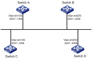

OSPFv3 DR election configuration example
As shown in Figure 3:
·     Configure router priority 100 for Switch A, the highest priority on the network, so it will become the DR.
·     Configure router priority 2 for Switch C, the second highest priority on the network, so it will become the BDR.
·     Configure router priority 0 for Switch B, so it cannot become a DR or BDR.
·     Switch D uses the default router priority 1.
Figure 3 Network diagram

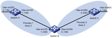

OSPFv3 route redistribution configuration example
As shown in Figure 4:
·     Switch A, Switch B, and Switch C are in Area 2.
·     OSPFv3 process 1 and OSPFv3 process 2 run on Switch B. Switch B communicates with Switch A and Switch C through OSPFv3 process 1 and OSPFv3 process 2.
·     Configure OSPFv3 process 2 to redistribute direct routes and the routes from OSPFv3 process 1 on Switch B, and set the default metric for redistributed routes to 3. Switch C can then learn the routes destined for 1::0/64 and 2::0/64, and Switch A cannot learn the routes destined for 3::0/64 or 4::0/64.
Figure 4 Network diagram

OSPFv3 route summarization configuration example
As shown in Figure 5:
·     OSPFv3 process 1 and OSPFv3 process 2 run on Switch B. Switch B communicates with Switch A and Switch C through OSPFv3 process 1 and OSPFv3 process 2, respectively.
·     On Switch A, configure IPv6 addresses 2:1:1::1/64, 2:1:2::1/64, and 2:1:3::1/64 for VLAN-interface 200.
·     On Switch B, configure OSPFv3 process 2 to redistribute direct routes and the routes from OSPFv3 process 1. Switch C can then learn the routes destined for 2::/64, 2:1:1::/64, 2:1:2::/64, and 2:1:3::/64.
·     On Switch B, configure route summarization to advertise only summary route 2::/16 to Switch C.
Figure 5 Network diagram
2.     Configure OSPFv3:

OSPFv3 IPsec profile configuration example
As shown in Figure 9, all switches run OSPFv3, and the AS is divided into two areas.
Configure IPsec profiles on the switches to authenticate and encrypt protocol packets.
Figure 9 Network diagram
2.     Configure OSPFv3 basic functions:

4.     Apply the IPsec profiles to areas:
# Configure Switch A.
[SwitchA] ospfv3 1
[SwitchA-ospfv3-1] area 1
[SwitchA-ospfv3-1-area-0.0.0.1] enable ipsec-profile profile001
[SwitchA-ospfv3-1-area-0.0.0.1] quit
# Configure Switch B.
[SwitchB] ospfv3 1
[SwitchB-ospfv3-1] area 0
[SwitchB-ospfv3-1-area-0.0.0.0] enable ipsec-profile profile002
[SwitchB-ospfv3-1-area-0.0.0.0] quit
[SwitchB-ospfv3-1] area 1
[SwitchB-ospfv3-1-area-0.0.0.1] enable ipsec-profile profile001
[SwitchB-ospfv3-1-area-0.0.0.1] quit
# Configure Switch C.
[SwitchC] ospfv3 1
[SwitchC-ospfv3-1] area 0
[SwitchC-ospfv3-1-area-0.0.0.0] enable ipsec-profile profile002
[SwitchC-ospfv3-1-area-0.0.0.0] quit
# Verify that OSPFv3 packets between Switches A, B, and C are protected by IPsec. (Details not shown.)
