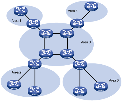

OSPF areas
In large OSPF routing domains, SPF route computations consume too many storage and CPU resources, and enormous OSPF packets generated for route synchronization occupy excessive bandwidth.
To resolve these issues, OSPF splits an AS into multiple areas. Each area is identified by an area ID. The boundaries between areas are routers rather than links. A network segment (or a link) can only reside in one area as shown in Figure 1.
You can configure route summarization on ABRs to reduce the number of LSAs advertised to other areas and minimize the effect of topology changes.
Figure 1 Area-based OSPF network partition

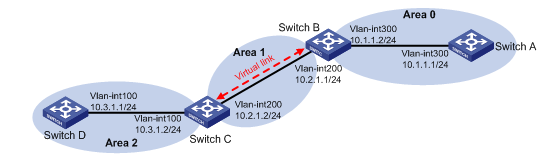

In practice, these requirements might not be met due to lack of physical links. OSPF virtual links can solve this issue.
A virtual link is established between two ABRs through a non-backbone area. It must be configured on both ABRs to take effect. The non-backbone area is called a transit area.
As shown in Figure 2, Area 2 has no direct physical link to the backbone Area 0. You can configure a virtual link between the two ABRs to connect Area 2 to the backbone area.
Figure 2 Virtual link application 1
Virtual links can also be used to provide redundant links. If the backbone area cannot maintain internal connectivity because of the failure of a physical link, you can configure a virtual link to replace the failed physical link, as shown in Figure 3.
Figure 3 Virtual link application 2
The virtual link between the two ABRs acts as a point-to-point connection. You can configure interface parameters, such as hello interval, on the virtual link as they are configured on a physical interface.
The two ABRs on the virtual link unicast OSPF packets to each other, and the OSPF routers in between convey these OSPF packets as normal IP packets.

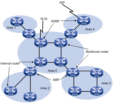

Router types
OSPF routers are classified into the following types based on their positions in the AS:
·     Internal routerAll interfaces on an internal router belong to one OSPF area.
·     ABRBelongs to more than two areas, one of which must be the backbone area. ABR connects the backbone area to a non-backbone area. An ABR and the backbone area can be connected through a physical or logical link.
·     Backbone router—At least one interface of a backbone router must reside in the backbone area. All ABRs and internal routers in Area 0 are backbone routers.
·     ASBR—Exchanges routing information with another AS is an ASBR. An ASBR might not reside on the border of the AS. It can be an internal router or an ABR.
Figure 5 OSPF router types

Configuring a virtual link
Virtual links are configured for connecting backbone area routers that have no direct physical links.
To configure a virtual link:
Step
Remarks
N/A
2.     Enter OSPF view.
ospf [ process-id | router-id router-id ] *
N/A
3.     Enter area view.
area area-id
N/A
4.     Configure a virtual link.
vlink-peer router-id [ dead seconds | hello seconds | { { hmac-md5 | md5 } key-id { cipher cipher-string | plain plain-string } | simple { cipher cipher-string | plain plain-string } } | retransmit seconds | trans-delay seconds ] *
By default, no virtual link is configured.
Configure this command on both ends of a virtual link. The hello and dead intervals must be identical on both ends of the virtual link.

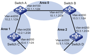

Network requirements
As shown in Figure 8:
·     Enable OSPF on all switches, and split the AS into three areas.
·     Configure Switch A and Switch B as ABRs.
Figure 8 Network diagram
Configuration procedure
1.     Configure IP addresses for interfaces. (Details not shown.)
2.     Enable OSPF:
# Configure Switch A.
<SwitchA> system-view
[SwitchA] router id 10.2.1.1
[SwitchA] ospf
[SwitchA-ospf-1] area 0
[SwitchA-ospf-1-area-0.0.0.0] network 10.1.1.0 0.0.0.255
[SwitchA-ospf-1-area-0.0.0.0] quit
[SwitchA-ospf-1] area 1
[SwitchA-ospf-1-area-0.0.0.1] network 10.2.1.0 0.0.0.255
[SwitchA-ospf-1-area-0.0.0.1] quit
[SwitchA-ospf-1] quit
# Configure Switch B.
<SwitchB> system-view
[SwitchB] router id 10.3.1.1
[SwitchB] ospf
[SwitchB-ospf-1] area 0
[SwitchB-ospf-1-area-0.0.0.0] network 10.1.1.0 0.0.0.255
[SwitchB-ospf-1-area-0.0.0.0] quit
[SwitchB-ospf-1] area 2
[SwitchB-ospf-1-area-0.0.0.2] network 10.3.1.0 0.0.0.255
[SwitchB-ospf-1-area-0.0.0.2] quit
[SwitchB-ospf-1] quit
# Configure Switch C.
<SwitchC> system-view
[SwitchC] router id 10.4.1.1
[SwitchC] ospf
[SwitchC-ospf-1] area 1
[SwitchC-ospf-1-area-0.0.0.1] network 10.2.1.0 0.0.0.255
[SwitchC-ospf-1-area-0.0.0.1] network 10.4.1.0 0.0.0.255
[SwitchC-ospf-1-area-0.0.0.1] quit
[SwitchC-ospf-1] quit
# Configure Switch D.
<SwitchD> system-view
[SwitchD] router id 10.5.1.1
[SwitchD] ospf
[SwitchD-ospf-1] area 2
[SwitchD-ospf-1-area-0.0.0.2] network 10.3.1.0 0.0.0.255
[SwitchD-ospf-1-area-0.0.0.2] network 10.5.1.0 0.0.0.255
[SwitchD-ospf-1-area-0.0.0.2] quit
[SwitchD-ospf-1] quit
# Display information about neighbors on Switch A.
[SwitchA] display ospf peer verbose
          OSPF Process 1 with Router ID 10.2.1.1
                  Neighbors
 Area 0.0.0.0 interface 10.1.1.1(Vlan-interface100)'s neighbors
 Router ID: 10.3.1.1         Address: 10.1.1.2         GR State: Normal
   State: Full  Mode: Nbr is Master  Priority: 1
   DR: 10.1.1.1  BDR: 10.1.1.2  MTU: 0
   Options is 0x02 (-|-|-|-|-|-|E|-)
   Dead timer due in 37  sec
   Neighbor is up for 06:03:59
   Authentication Sequence: [ 0 ]
   Neighbor state change count: 5
   BFD status: Disabled
 Area 0.0.0.1 interface 10.2.1.1(Vlan-interface200)'s neighbors
 Router ID: 10.4.1.1         Address: 10.2.1.2         GR State: Normal
   DR: 10.2.1.1  BDR: 10.2.1.2  MTU: 0
   Dead timer due in 32  sec
   Neighbor is up for 06:03:12
# Display OSPF routing information on Switch A.
[SwitchA] display ospf routing
                   Routing Tables
 Routing for Network
 Destination        Cost     Type    NextHop         AdvRouter       Area
 10.2.1.0/24        1        Transit 10.2.1.1        10.2.1.1        0.0.0.1
 10.3.1.0/24        2        Inter   10.1.1.2        10.3.1.1        0.0.0.0
 10.4.1.0/24        2        Stub    10.2.1.2        10.4.1.1        0.0.0.1
 10.5.1.0/24        3        Inter   10.1.1.2        10.3.1.1        0.0.0.0
 10.1.1.0/24        1        Transit 10.1.1.1        10.2.1.1        0.0.0.0
 Total Nets: 5
 Intra Area: 3  Inter Area: 2  ASE: 0  NSSA: 0
# Display OSPF routing information on Switch D.
[SwitchD] display ospf routing
          OSPF Process 1 with Router ID 10.5.1.1
                   Routing Tables
 Routing for Network
 10.2.1.0/24        3        Inter   10.3.1.1        10.3.1.1        0.0.0.2
 10.3.1.0/24        1        Transit 10.3.1.2        10.3.1.1        0.0.0.2
 10.4.1.0/24        4        Inter   10.3.1.1        10.3.1.1        0.0.0.2
 10.5.1.0/24        1        Stub    10.5.1.1        10.5.1.1        0.0.0.2
 10.1.1.0/24        2        Inter   10.3.1.1        10.3.1.1        0.0.0.2
 Total Nets: 5
 Intra Area: 2  Inter Area: 3  ASE: 0  NSSA: 0
# On Switch D, ping the IP address 10.4.1.1 to test reachability.
[SwitchD] ping 10.4.1.1
Ping 10.4.1.1 (10.4.1.1): 56 data bytes, press CTRL_C to break
56 bytes from 10.4.1.1: icmp_seq=0 ttl=253 time=1.549 ms
56 bytes from 10.4.1.1: icmp_seq=1 ttl=253 time=1.539 ms
56 bytes from 10.4.1.1: icmp_seq=2 ttl=253 time=0.779 ms
56 bytes from 10.4.1.1: icmp_seq=3 ttl=253 time=1.702 ms
56 bytes from 10.4.1.1: icmp_seq=4 ttl=253 time=1.471 ms
--- Ping statistics for 10.4.1.1 ---
round-trip min/avg/max/std-dev = 0.779/1.408/1.702/0.323 ms

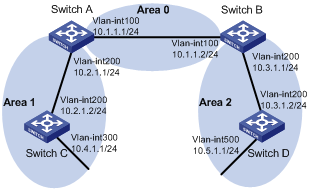

OSPF route redistribution configuration example
As shown in Figure 9:
·     Enable OSPF on all the switches.
·     Split the AS into three areas.
·     Configure Switch C as an ASBR to redistribute external routes (static routes).
Figure 9 Network diagram
2.     Enable OSPF (see "Basic OSPF configuration example").
3.     Configure OSPF to redistribute routes:
# On Switch C, configure a static route destined for network 3.1.2.0/24.
[SwitchC] ip route-static 3.1.2.1 24 10.4.1.2
# On Switch C, configure OSPF to redistribute static routes.
[SwitchC] ospf 1
[SwitchC-ospf-1] import-route static
# Display the ABR/ASBR information of Switch D.
<SwitchD> display ospf abr-asbr
                  Routing Table to ABR and ASBR
 Type        Destination     Area            Cost  Nexthop         RtType
 Intra       10.3.1.1        0.0.0.2         10    10.3.1.1        ABR
 Inter       10.4.1.1        0.0.0.2         22    10.3.1.1        ASBR
# Display the OSPF routing table on Switch D.
<SwitchD> display ospf routing
                   Routing Tables
 Routing for Network
 10.2.1.0/24        22       Inter   10.3.1.1        10.3.1.1        0.0.0.2
 10.3.1.0/24        10       Transit 10.3.1.2        10.3.1.1        0.0.0.2
 10.4.1.0/24        25       Inter   10.3.1.1        10.3.1.1        0.0.0.2
 10.5.1.0/24        10       Stub    10.5.1.1        10.5.1.1        0.0.0.2
 10.1.1.0/24        12       Inter   10.3.1.1        10.3.1.1        0.0.0.2
 Routing for ASEs
 Destination        Cost     Type    Tag         NextHop         AdvRouter
 3.1.2.0/24         1        Type2   1           10.3.1.1        10.4.1.1
 Total Nets: 6
 Intra Area: 2  Inter Area: 3  ASE: 1  NSSA: 0

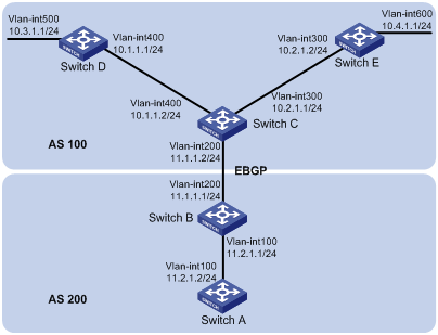

OSPF route summarization configuration example
As shown in Figure 10:
·     Configure OSPF on Switch A and Switch B in AS 200.
·     Configure OSPF on Switch C, Switch D, and Switch E in AS 100.
·     Configure an EBGP connection between Switch B and Switch C. Configure Switch B and Switch C to redistribute OSPF routes and direct routes into BGP and BGP routes into OSPF.
·     Configure Switch B to advertise only summary route 10.0.0.0/8 to Switch A.
Figure 10 Network diagram
2.     Enable OSPF:
[SwitchA] router id 11.2.1.2
[SwitchA] ospf
[SwitchA-ospf-1-area-0.0.0.0] network 11.2.1.0 0.0.0.255
[SwitchB] router id 11.2.1.1
[SwitchB] ospf
[SwitchB-ospf-1-area-0.0.0.0] network 11.2.1.0 0.0.0.255

3.     Configure BGP to redistribute OSPF routes and direct routes:
[SwitchB] bgp 200
[SwitchB-bgp] peer 11.1.1.2 as 100
[SwitchB-bgp] address-family ipv4 unicast
[SwitchB-bgp-ipv4] import-route ospf
[SwitchB-bgp-ipv4] import-route direct
[SwitchB-bgp ipv4] quit
[SwitchB-bgp] quit
[SwitchC] bgp 100
[SwitchC-bgp] peer 11.1.1.1 as 200
[SwitchC-bgp] address-family ipv4 unicast
[SwitchC-bgp-ipv4] import-route ospf
[SwitchC-bgp-ipv4]import-route direct
[SwitchC-bgp-ipv4] quit
[SwitchC-bgp] quit
4.     Configure Switch B and Switch C to redistribute BGP routes into OSPF:
# Configure OSPF to redistribute routes from BGP on Switch B.
[SwitchB] ospf
[SwitchB-ospf-1] import-route bgp
# Configure OSPF to redistribute routes from BGP on Switch C.
[SwitchC] ospf
[SwitchC-ospf-1] import-route bgp
# Display the OSPF routing table on Switch A.
[SwitchA] display ip routing-table
         Destinations : 16        Routes : 16
0.0.0.0/32          Direct 0    0            127.0.0.1       InLoop0
10.1.1.0/24         OSPF   150  1            11.2.1.1        Vlan100
10.2.1.0/24         OSPF   150  1            11.2.1.1        Vlan100
10.3.1.0/24         OSPF   150  1            11.2.1.1        Vlan100
10.4.1.0/24         OSPF   150  1            11.2.1.1        Vlan100
11.2.1.0/24         Direct 0    0            11.2.1.2        Vlan100
11.2.1.0/32         Direct 0    0            11.2.1.2        Vlan100
11.2.1.2/32         Direct 0    0            127.0.0.1       InLoop0
11.2.1.255/32       Direct 0    0            11.2.1.2        Vlan100
127.0.0.0/8         Direct 0    0            127.0.0.1       InLoop0
127.0.0.0/32        Direct 0    0            127.0.0.1       InLoop0
127.0.0.1/32        Direct 0    0            127.0.0.1       InLoop0
127.255.255.255/32  Direct 0    0            127.0.0.1       InLoop0
224.0.0.0/4         Direct 0    0            0.0.0.0         NULL0
224.0.0.0/24        Direct 0    0            0.0.0.0         NULL0
255.255.255.255/32  Direct 0    0            127.0.0.1       InLoop0
5.     Configure route summarization:
# Configure route summarization on Switch B to advertise a summary route 10.0.0.0/8.
[SwitchB-ospf-1] asbr-summary 10.0.0.0 8
# Display the IP routing table on Switch A.
         Destinations : 13        Routes : 13
10.0.0.0/8          OSPF   150  2            11.2.1.1        Vlan100
The output shows that routes 10.1.1.0/24, 10.2.1.0/24, 10.3.1.0/24 and 10.4.1.0/24 are summarized into a single route 10.0.0.0/8.

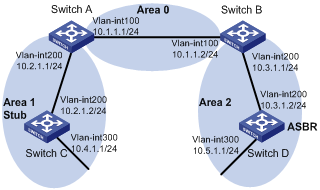

OSPF stub area configuration example
As shown in Figure 11:
·     Configure Switch A and Switch B as ABRs to forward routing information between areas.
·     Configure Switch D as the ASBR to redistribute static routes.
·     Configure Area 1 as a stub area to reduce advertised LSAs without influencing reachability.
Figure 11 Network diagram
3.     Configure route redistribution:
# Configure Switch D to redistribute static routes.
[SwitchD] ip route-static 3.1.2.1 24 10.5.1.2
[SwitchD] ospf
[SwitchD-ospf-1] import-route static
# Display ABR/ASBR information on Switch C.
<SwitchC> display ospf abr-asbr
          OSPF Process 1 with Router ID 10.4.1.1
 Intra       10.2.1.1        0.0.0.1         3     10.2.1.1        ABR
 Inter       10.5.1.1        0.0.0.1         7     10.2.1.1        ASBR
# Display OSPF routing table on Switch C.
<SwitchC> display ospf routing
                   Routing Tables
 Routing for Network
 10.2.1.0/24        3        Transit 10.2.1.2        10.2.1.1        0.0.0.1
 10.3.1.0/24        7        Inter   10.2.1.1        10.2.1.1        0.0.0.1
 10.4.1.0/24        3        Stub    10.4.1.1        10.4.1.1        0.0.0.1
 10.5.1.0/24        17       Inter   10.2.1.1        10.2.1.1        0.0.0.1
 10.1.1.0/24        5        Inter   10.2.1.1        10.2.1.1        0.0.0.1
 Routing for ASEs
 3.1.2.0/24         1        Type2   1           10.2.1.1        10.5.1.1
 Total Nets: 6
The output shows that Switch C's routing table contains an AS external route.
4.     Configure Area 1 as a stub area:
[SwitchA] ospf
[SwitchA-ospf-1-area-0.0.0.1] stub
[SwitchC] ospf
[SwitchC-ospf-1-area-0.0.0.1] stub
# Display OSPF routing information on Switch C
[SwitchC] display ospf routing
                   Routing Tables
 Routing for Network
 0.0.0.0/0          4        Inter   10.2.1.1        10.2.1.1        0.0.0.1
 Total Nets: 6
 Intra Area: 2  Inter Area: 4  ASE: 0  NSSA: 0
The output shows that a default route replaces the AS external route.
# Configure Area 1 as a totally stub area.
[SwitchA] ospf
[SwitchA-ospf-1-area-0.0.0.1] stub no-summary
# Display OSPF routing information on Switch C.
                   Routing Tables
 Routing for Network
 10.2.1.0/24        3        Transit 10.2.1.2        10.4.1.1        0.0.0.1
 Total Nets: 3
 Intra Area: 2  Inter Area: 1  ASE: 0  NSSA: 0
The output shows that inter-area routes are removed, and only one external route (a default route) exists on Switch C.

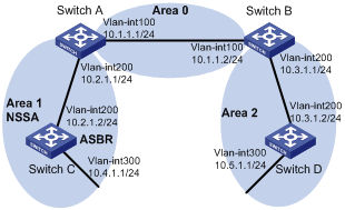

OSPF NSSA area configuration example)
As shown in Figure 12:
·     Configure OSPF on all switches and split AS into three areas.
·     Configure Area 1 as an NSSA area and configure Switch C as an ASBR to redistribute static routes into the AS.
Figure 12 Network diagram
3.     Configure Area 1 as an NSSA area:
[SwitchA] ospf
[SwitchA-ospf-1-area-0.0.0.1] nssa
[SwitchC] ospf
[SwitchC-ospf-1-area-0.0.0.1] nssa
                   Routing Tables
 Routing for Network
 Total Nets: 5
4.     Configure route redistribution:
# Configure Switch C to redistribute static routes.
[SwitchC] ip route-static 3.1.3.1 24 10.4.1.2
[SwitchC] ospf
                   Routing Tables
 Routing for Network
 Routing for ASEs
 3.1.3.0/24         1        Type2   1           10.3.1.1        10.2.1.1
 Total Nets: 6
The output shows that an external route imported from the NSSA area exists on Switch D.

OSPF virtual link configuration example
As shown in Figure 14, configure a virtual link between Switch B and Switch C to connect Area 2 to the backbone area. After configuration, Switch B can learn routes to Area 2.
Figure 14 Network diagram
2.     Enable OSPF:
[SwitchA] ospf 1 router-id 1.1.1.1
[SwitchB] ospf 1 router-id 2.2.2.2
[SwitchB-ospf-1] area 1
[SwitchB–ospf-1-area-0.0.0.1] network 10.2.1.0 0.0.0.255
[SwitchB–ospf-1-area-0.0.0.1] quit
[SwitchC] ospf 1 router-id 3.3.3.3
[SwitchC-ospf-1] area 2
[SwitchC–ospf-1-area-0.0.0.2] network 10.3.1.0 0.0.0.255
[SwitchC–ospf-1-area-0.0.0.2] quit
[SwitchD] ospf 1 router-id 4.4.4.4
# Display the OSPF routing table on Switch B.
[SwitchB] display ospf routing
          OSPF Process 1 with Router ID 2.2.2.2
                   Routing Tables
 Routing for Network
 10.2.1.0/24        2        Transit 10.2.1.1        3.3.3.3         0.0.0.1
 10.1.1.0/24        2        Transit 10.1.1.2        2.2.2.2         0.0.0.0
 Total Nets: 2
 Intra Area: 2  Inter Area: 0  ASE: 0  NSSA: 0
Area 0 has no direct connection to Area 2, so the routing table of Switch B has no route to Area 2.
3.     Configure a virtual link:
[SwitchB] ospf
[SwitchB-ospf-1-area-0.0.0.1] vlink-peer 3.3.3.3
[SwitchB-ospf-1-area-0.0.0.1] quit
[SwitchC] ospf 1
[SwitchC-ospf-1-area-0.0.0.1] vlink-peer 2.2.2.2
                   Routing Tables
 Routing for Network
 10.3.1.0/24        5        Inter   10.2.1.2        3.3.3.3         0.0.0.0
 Total Nets: 3
The output shows that Switch B has learned the route 10.3.1.0/24 to Area 2.
