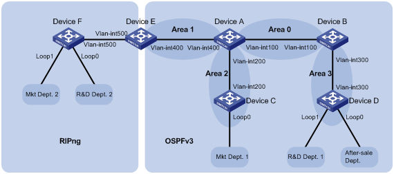

As shown in Figure 1, the devices of an enterprise reside in OSPFv3 and RIPng domains.
Configure route redistribution between OSPFv3 and RIPng to interconnect the devices.
Configure route filtering on Device E, Device C, and Device D to meet the following requirements:
·     The route destined for R&D department 2 is not redistributed to OSPFv3.
·     Marketing department 1 cannot reach R&D department 1.
·     R&D department 1 and the After-sale service department cannot reach Marketing department 2.
Figure 1 Network diagram
Device
Interface
IP address
Device
Interface
IP address
Device A
Vlan-int100
1::1/64
Device B
Vlan-int100
1::2/64
Vlan-int200
2::1/64
Vlan-int300
3::1/64
Vlan-int400
4::1/64
Device C
Vlan-int200
2::2/64
Device D
Vlan-int300
3::2/64
Loop0
13::1/64
Loop0
11::1/64
Loop1
12::1/64
Device E
Vlan-int400
4::2/64
Device F
Vlan-int500
5::2/64
Vlan-int500
5::1/64
Loop0
14::1/64
Loop1
15::1/64
Software versions used
This configuration example was created and verified on S7500X-CMW710-R7536P05.

# Verify that Marketing department 1 cannot reach R&D department 1.
[DeviceC] ping ipv6 -a 13::1 12::1
Ping6(56 data bytes) 13::1 --> 12::1, press CTRL_C to break
Request time out
Request time out
Request time out
Request time out
Request time out
--- Ping6 statistics for 12::1 ---
5 packet(s) transmitted, 0 packet(s) received, 100.0% packet loss
# Verify that Device D does not have a route to 15::/64.
[DeviceD] display ipv6 routing-table
Destinations : 14        Routes : 14
Destination: ::1/128                                     Protocol  : Direct
NextHop    : ::1                                         Preference: 0
Interface  : InLoop0                                     Cost      : 0
Destination: 1::/64                                      Protocol  : OSPFv3
NextHop    : FE80::2A0:FCFF:FE00:5815                    Preference: 10
Interface  : Vlan300                                     Cost      : 2
Destination: 2::/64                                      Protocol  : OSPFv3
Interface  : Vlan300                                     Cost      : 3
Destination: 3::/64                                      Protocol  : Direct
NextHop    : ::                                          Preference: 0
Interface  : Vlan300                                     Cost      : 0
Destination: 3::2/128                                    Protocol  : Direct
Destination: 4::/64                                      Protocol  : OSPFv3
Destination: 5::/64                                      Protocol  : OSPFv3
NextHop    : FE80::2A0:FCFF:FE00:5815                    Preference: 150
Interface  : Vlan300                                     Cost      : 1
Destination: 11::/64                                     Protocol  : Direct
Interface  : Loop0                                       Cost      : 0
Destination: 11::1/128                                   Protocol  : Direct
Destination: 12::/64                                     Protocol  : Direct
Interface  : Loop1                                       Cost      : 0
Destination: 12::1/128                                   Protocol  : Direct
Destination: 13::1/128                                   Protocol  : OSPFv3
Destination: FE80::/10                                   Protocol  : Direct
Interface  : NULL0                                       Cost      : 0
Destination: FF00::/8                                    Protocol  : Direct
Interface  : NULL0
# Verify that the After-sale service department cannot reach Marketing department 2.
[DeviceD] ping ipv6 -a 11::1 15::1
Ping6(56 data bytes) 11::1 --> 15::1, press CTRL_C to break
Request time out
Request time out
Request time out
Request time out
Request time out
--- Ping6 statistics for 15::1 ---
# Verify that R&D department 1 cannot reach Marketing department 2.
[DeviceD] ping ipv6 -a 12::1 15::1
Ping6(56 data bytes) 12::1 --> 15::1, press CTRL_C to break
Request time out
Request time out
Request time out
Request time out
Request time out
The output on Device C and Device D shows that Device E has filtered the route destined for R&D development 2.
