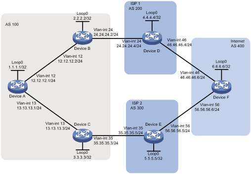

Example: Configuring route selection based on the AS_PATH attribute
As shown in Figure 1, all devices run BGP. Configure a routing policy on Device B and Device C to meet the following requirements:
·     Traffic from AS 100 to AS 200 is preferentially forwarded by Device D.
·     Traffic from AS 100 to AS 300 is preferentially forwarded by Device E.
·     Traffic from AS 100 to AS 400 is preferentially forwarded by Device D.
Figure 1 Network diagram
Analysis
For devices in AS 100 to select the optimal route based on AS numbers, increase the local preference for routes whose AS_PATH attributes end with the specified AS number.
·     Configure a routing policy on Device B to set the local preference to 300 for routes whose AS_PATH attributes end with AS number 200 or 400.
·     Configure a routing policy on Device C to set the local preference to 200 for routes whose AS_PATH attributes end with AS number 300.
To filter routes based on AS numbers, use an AS path list.
Software versions used
This configuration example was created and verified on S7500X-CMW710-R7536P05.
Procedures

# Display the BGP routing table on Device A. The output shows the routes advertised by Device D, Device E, and Device F, and the AS_PATH attributes of the routes.
[DeviceA] display bgp routing-table ipv4
Total number of routes: 12
 BGP local router ID is 1.1.1.1
 Status codes: * - valid, > - best, d - dampened, h - history,
               s - suppressed, S - stale, i - internal, e - external
               Origin: i - IGP, e - EGP, ? - incomplete
     Network            NextHop         MED        LocPrf     PrefVal Path/Ogn
* >i 2.2.2.2/32         12.12.12.2      0          100        0       ?
* >i 3.3.3.3/32         13.13.13.3      0          100        0       ?
* >i 4.4.4.4/32         24.24.24.4      0          100        0       200i
*  i                    35.35.35.5                 100        0       300 400
                                                                      200i
* >i 5.5.5.5/32         35.35.35.5      0          100        0       300i
*  i                    24.24.24.4                 100        0       200 400
                                                                      300i
* >i 6.6.6.6/32         24.24.24.4                 100        0       200 400i
*  i                    35.35.35.5                 100        0       300 400i
* >i 12.12.12.0/24      12.12.12.2      0          100        0       ?
* >i 13.13.13.0/24      13.13.13.3      0          100        0       ?
* >i 24.24.24.0/24      12.12.12.2      0          100        0       ?
* >i 35.35.35.0/24      13.13.13.3      0          100        0       ?
Configuring routing policies
# Create routing policy aspath on Device B, and set the local preference to 300 for routes whose AS_PATH attributes end with AS number 200 or 400.
[DeviceB] ip as-path 1 permit 200$
[DeviceB] ip as-path 1 permit 400$
[DeviceB] route-policy aspath permit node 10
[DeviceB-route-policy-aspath-10] if-match as-path 1
[DeviceB-route-policy-aspath-10] apply local-preference 300
[DeviceB-route-policy-aspath-10] quit
# Apply routing policy aspath to routes from the peer 24.24.24.4.
[DeviceB] bgp 100
[DeviceB-bgp-default] address-family ipv4
[DeviceB-bgp-default-ipv4] peer 24.24.24.4 route-policy aspath import
# Create routing policy aspath on Device C, and set the local preference to 200 for routes whose AS_PATH attributes end with AS number 300.
[DeviceC] ip as-path 1 permit 300$
[DeviceC] route-policy aspath permit node 20
[DeviceC-route-policy-aspath-20] if-match as-path 1
[DeviceC-route-policy-aspath-20] apply local-preference 200
[DeviceC-route-policy-aspath-20] quit
# Apply routing policy aspath to routes from the peer 35.35.35.5.
[DeviceC] bgp 100
[DeviceC-bgp-default] address-family ipv4
[DeviceC-bgp-default-ipv4] peer 35.35.35.5 route-policy aspath import
# Display the BGP routing table on Device A. The output shows the following:
·     The local preference of routes whose AS_PATH attributes end with AS number 200 or 400 changes to 300.
·     The local preference of routes whose AS_PATH attributes end with AS number 300 changes to 200.
Total number of routes: 11
* >i 4.4.4.4/32         24.24.24.4      0          300        0       200i
* >i 5.5.5.5/32         35.35.35.5      0          200        0       300i
* >i 6.6.6.6/32         24.24.24.4                 300        0       200 400i
# Verify that packets from Device A to 6.6.6.6 are forwarded by Device D.
[DeviceA] tracert 6.6.6.6
traceroute to 6.6.6.6 (6.6.6.6), 30 hops at most, 52 bytes each packet, press CT
RL_C to break
 1  12.12.12.2 (12.12.12.2)  2.417 ms  1.887 ms  1.773 ms
 2  24.24.24.4 (24.24.24.4)  4.057 ms  2.293 ms  2.739 ms
 3  6.6.6.6 (6.6.6.6)  5.145 ms  4.205 ms  4.402 ms

·     Device D:
vlan 24
vlan 46
interface LoopBack0
 ip address 4.4.4.4 255.255.255.255
interface Vlan-interface24
 ip address 24.24.24.4 255.255.255.0
interface Vlan-interface46
 ip address 46.46.46.4 255.255.255.0
bgp 200
 router-id 4.4.4.4
 peer 24.24.24.2 as-number 100
 peer 46.46.46.6 as-number 400
 address-family ipv4 unicast
  network 4.4.4.4 255.255.255.255
  peer 24.24.24.2 enable
  peer 46.46.46.6 enable
·     Device E:
vlan 35
vlan 56
interface LoopBack0
 ip address 5.5.5.5 255.255.255.255
interface Vlan-interface35
 ip address 35.35.35.5 255.255.255.0
interface Vlan-interface56
 ip address 56.56.56.5 255.255.255.0
bgp 300
 router-id 5.5.5.5
 peer 35.35.35.3 as-number 100
 peer 56.56.56.6 as-number 400
  network 5.5.5.5 255.255.255.255
  peer 35.35.35.3 enable
  peer 56.56.56.6 enable
·     Device F:
vlan 46
vlan 56
interface LoopBack0
 ip address 6.6.6.6 255.255.255.255
 ip address 46.46.46.6 255.255.255.0
 ip address 56.56.56.6 255.255.255.0
bgp 400
 router-id 6.6.6.6
 peer 46.46.46.4 as-number 200
 peer 56.56.56.5 as-number 300
  network 6.6.6.6 255.255.255.255
  peer 46.46.46.4 enable
  peer 56.56.56.5 enable

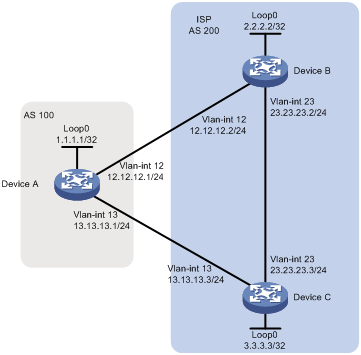

Example: Configuring route selection based on the MED attribute
As shown in Figure 2, all devices run BGP. EBGP runs between Device A and Device B, and between Device A and Device C. IBGP runs between Device B and Device C.
Configure a routing policy to ensure that traffic from AS 100 to AS 200 is preferentially forwarded by Device C. Before you configure the routing policy, the traffic is preferentially forwarded by Device B.
Figure 2 Network diagram
Analysis
To ensure that the traffic is preferentially forwarded by Device C, configure a routing policy on Device B to change the MED value for the route to Device A. Make sure the MED value is not the default MED value 0.
Procedures
Configuring basic BGP
# Configure an IP address for the interface VLAN-interface 12 on Device A.
<DeviceA> system-view
[DeviceA] interface Vlan-interface 12
[DeviceA-Vlan-interface12] ip address 12.12.12.1 24
[DeviceA-Vlan-interface12] quit
# Configure IP addresses for other interfaces as shown in Figure 2. (Details not shown.)
# On Device A, enable the default BGP instance, set the AS number to 100, and specify 12.12.12.2 and 13.13.13.3 as BGP peers.
[DeviceA] bgp 100
[DeviceA-bgp-default] router-id 1.1.1.1
[DeviceA-bgp-default] peer 12.12.12.2 as-number 200
[DeviceA-bgp-default] peer 13.13.13.3 as-number 200
[DeviceA-bgp-default] address-family ipv4 unicast
[DeviceA-bgp-default-ipv4] peer 12.12.12.2 enable
[DeviceA-bgp-default-ipv4] peer 13.13.13.3 enable
[DeviceA-bgp-default-ipv4] quit
[DeviceA-bgp-default] quit
# On Device B, enable the default BGP instance, set the AS number to 200, and specify 12.12.12.1 and 3.3.3.3 as BGP peers.
[DeviceB] bgp 200
[DeviceB-bgp-default] router-id 2.2.2.2
[DeviceB-bgp-default] peer 12.12.12.1 as-number 100
[DeviceB-bgp-default] peer 3.3.3.3 as-number 200
[DeviceB-bgp-default] peer 3.3.3.3 connect-interface LoopBack0
[DeviceB-bgp-default] address-family ipv4 unicast
[DeviceB-bgp-default-ipv4] peer 12.12.12.1 enable
[DeviceB-bgp-default-ipv4] peer 3.3.3.3 enable
[DeviceB-bgp-default-ipv4] network 23.23.23.0 24
[DeviceB-bgp-default-ipv4] quit
[DeviceB-bgp-default] quit
# Configure a static route to 3.3.3.3/32 on Device B.
[DeviceB] ip route-static 3.3.3.3 32 23.23.23.3
# On Device C, enable the default BGP instance, set the AS number to 200, and specify 13.13.13.1 and 2.2.2.2 as BGP peers.
[DeviceC] bgp 200
[DeviceC-bgp-default] router-id 3.3.3.3
[DeviceC-bgp-default] peer 13.13.13.1 as-number 100
[DeviceC-bgp-default] peer 2.2.2.2 as-number 200
[DeviceC-bgp-default] peer 2.2.2.2 connect-interface LoopBack0
[DeviceC-bgp-default] address-family ipv4 unicast
[DeviceC-bgp-default-ipv4] peer 13.13.13.1 enable
[DeviceC-bgp-default-ipv4] peer 2.2.2.2 enable
[DeviceC-bgp-default-ipv4] network 23.23.23.0 24
[DeviceC-bgp-default-ipv4] quit
[DeviceC-bgp-default] quit
# Configure a static route to 2.2.2.2/32 on Device C.
[DeviceC] ip route-static 2.2.2.2 32 23.23.23.2
# Display the BGP routing table on Device A. The output shows that the route with the next hop 12.12.12.2 becomes the optimal route to the network 23.23.23.0/24.
 Total number of routes: 2
* >e 23.23.23.0/24      12.12.12.2      0                     0       200i
*  e                    13.13.13.3      0                     0       200i
Configuring a routing policy
# Create routing policy 10 on Device B and set the cost to 100.
[DeviceB] route-policy 10 permit node 10
[DeviceB-route-policy-10-10] apply cost 100
[DeviceB-route-policy-10-10] quit
# Apply routing policy 10 to routes to the peer 12.12.12.1.
[DeviceB] bgp 200
[DeviceB-bgp-default-ipv4] peer 12.12.12.1 route-policy 10 export
# Display the BGP routing table on Device A. The output shows that the MED value for the route with the next hop 12.12.12.2 changes to 100, and the route with the next hop 13.13.13.3 becomes the optimal route.
* >e 23.23.23.0/24      13.13.13.3      0                     0       200i
*  e                    12.12.12.2      100                   0       200i
Configuration files
·     Device A:
vlan 12
vlan 13
interface LoopBack0
 ip address 1.1.1.1 255.255.255.255
interface Vlan-interface12
 ip address 12.12.12.1 255.255.255.0
interface Vlan-interface13
 ip address 13.13.13.1 255.255.255.0
bgp 100
 router-id 1.1.1.1
·     Device B:
vlan 12
vlan 23
interface LoopBack0
 ip address 2.2.2.2 255.255.255.255
 ip address 12.12.12.2 255.255.255.0
interface Vlan-interface23
 ip address 23.23.23.2 255.255.255.0
bgp 200
 router-id 2.2.2.2
  network 23.23.23.0 255.255.255.0
  peer 3.3.3.3 enable
 apply cost 100
·     Device C:
vlan 13
vlan 23
interface LoopBack0
 ip address 3.3.3.3 255.255.255.255
 ip address 13.13.13.3 255.255.255.0
 ip address 23.23.23.3 255.255.255.0
bgp 200
 router-id 3.3.3.3
  peer 2.2.2.2 enable
Related documentation
·     H3C S7500X Switch Series Layer 3—IP Routing Command Reference-R7536P05
·     H3C S7500X Switch Series Layer 3—IP Routing Configuration Guide-R7536P05
