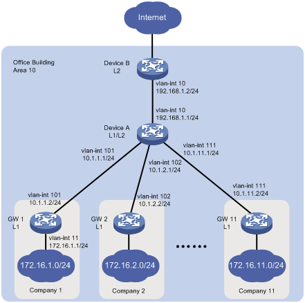

As shown in Figure 1, the five departments of a company use IS-IS to connect to the backbone network. The five departments are assigned the networks 192.168.1.0/24, 192.168.2.0/24, 192.168.3.0/24, 192.168.4.0/24, and 192.168.5.0/24. Configure IS-IS route summarization to reduce routing entries and save system resources for Device B.
Figure 1 Network diagram
Analysis
Configure route summarization on Device A because route summarization applies only to locally generated LSPs.
To avoid blackhole routes, set the summary route to 192.168.0.0/21.

# Configure other gateways in the same way GW 1 is configured. (Details not shown.)
