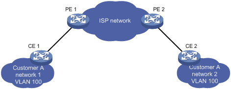

For example, as shown in Figure 3, PE 1 receives an STP packet (BPDU) from network 1 to network 2. CEs are the edge devices on the customer network, and PEs are the edge devices on the service provider network. L2PT processes the packet as follows:
1.     PE 1 performs the following operations:
a.     Changes the packet's destination multicast MAC address 0180-c200-0000 to a specified multicast MAC address (010f-e200-0003 by default) for the BPDU.
b.     Sends the tunneled packet out of all ISP-facing ports in the packet's VLAN.
2.     Upon receiving the tunneled packet, PE 2 decapsulates the packet and sends the BPDU to CE 2.
Through L2PT, both the ISP network and Customer A's network can perform independent spanning tree calculations.
Figure 3 L2PT network diagram

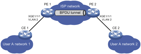

Configuring L2PT for STP
Network requirements
As shown in Figure 4, the MAC addresses of CE 1 and CE 2 are 00e0-fc02-5800 and 00e0-fc02-5802, respectively. MSTP is enabled in Customer A's network, and default MSTP settings are used.
Perform the following tasks on the PEs:
·     Configure the ports that connect to CEs as access ports, and configure the ports in the service provider network as trunk ports. Configure ports in the service provider network to allow packets from any VLAN to pass.
·     Enable L2PT for STP to enable Customer A's network to implement independent spanning tree calculation across the service provider network.
·     Set the destination multicast MAC address to 0100-0ccd-cdd0 for tunneled packets.
Figure 4 Network diagram
Configuration procedures
1.     Configure PE 1:
# Set the destination multicast address to 0100-0ccd-cdd0 for tunneled packets.
<PE1> system-view
[PE1] l2protocol tunnel-dmac 0100-0ccd-cdd0
# Create VLAN 2.
[PE1] vlan 2
[PE1-vlan2] quit
# Configure Ten-GigabitEthernet 1/1/1 as an access port and assign the port to VLAN 2.
[PE1] interface ten-gigabitethernet 1/1/1
[PE1-Ten-GigabitEthernet1/1/1] port access vlan 2
# Disable STP and enable L2PT for STP on Ten-GigabitEthernet 1/1/1.
[PE1-Ten-GigabitEthernet1/1/1] undo stp enable
[PE1-Ten-GigabitEthernet1/1/1] l2protocol stp tunnel dot1q
[PE1-Ten-GigabitEthernet1/1/1] quit
# Configure Ten-GigabitEthernet 1/1/2 connected to the service provider network as a trunk port, and assign the port to all VLANs.
[PE1] interface ten-gigabitethernet 1/1/2
[PE1-Ten-GigabitEthernet1/1/2] port link-type trunk
[PE1-Ten-GigabitEthernet1/1/2] port trunk permit vlan all
[PE1-Ten-GigabitEthernet1/1/2] quit
2.     Configure PE 2 in the same way PE 1 is configured. (Details not shown.)
# Verify that the root bridge of Customer A's network is CE 1.
<CE2> display stp root
 MST ID   Root Bridge ID        ExtPathCost IntPathCost Root Port
 0        32768.00e0-fc02-5800  0           0
# Verify that the root bridge of the service provider network is not CE 1.
[PE1] display stp root
 0        32768.0cda-41c5-ba50  0           0

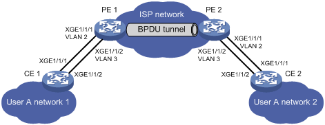

Configuring L2PT for LACP
As shown in Figure 5, the MAC addresses of CE 1 and CE 2 are 0001-0000-0000 and 0004-0000-0000, respectively.
Perform the following tasks:
·     Configure Ethernet link aggregation on CE 1 and CE 2.
·     Configure Ten-GigabitEthernet 1/1/1 and Ten-GigabitEthernet 1/1/2 on CE 1 to form aggregate links with Ten-GigabitEthernet 1/1/1 and Ten-GigabitEthernet 1/1/2 on CE 2, respectively.
·     Enable L2PT for LACP to enable CE 1 and CE 2 to implement Ethernet link aggregation across the service provider network.
Figure 5 Network diagram
Requirements analysis
To meet the network requirements, perform the following tasks:
·     For Ethernet link aggregation to operate correctly, configure VLANs on the PEs to ensure point-to-point transmission between CE 1 and CE 2 in an aggregation group.
¡     Set the PVIDs to VLAN 2 and VLAN 3 for Ten-GigabitEthernet 1/1/1 and Ten-GigabitEthernet 1/1/2 on PE 1, respectively.
¡     Configure PE 2 in the same way PE 1 is configured.
¡     Configure ports that connect to the CEs as trunk ports.
·     To retain the VLAN tag of the customer network, enable QinQ on Ten-GigabitEthernet 1/1/1 and Ten-GigabitEthernet 1/1/2 on both PE 1 and PE 2.
·     For packets from any VLAN to be transmitted, configure all ports in the service provider network as trunk ports.
1.     Configure CE 1:
# Configure Layer 2 aggregation group Bridge-Aggregation 1 to operate in dynamic aggregation mode.
<CE1> system-view
[CE1] interface bridge-aggregation 1
[CE1-Bridge-Aggregation1] port link-type access
[CE1-Bridge-Aggregation1] link-aggregation mode dynamic
[CE1-Bridge-Aggregation1] quit
# Assign Ten-GigabitEthernet 1/1/1 and Ten-GigabitEthernet 1/1/2 to Bridge-Aggregation 1.
[CE1] interface ten-gigabitethernet 1/1/1
[CE1-Ten-GigabitEthernet1/1/1] port link-aggregation group 1
[CE1-Ten-GigabitEthernet1/1/1] quit
[CE1] interface ten-gigabitethernet 1/1/2
[CE1-Ten-GigabitEthernet1/1/2] port link-aggregation group 1
[CE1-Ten-GigabitEthernet1/1/2] quit
2.     Configure CE 2 in the same way CE 1 is configured. (Details not shown.)
3.     Configure PE 1:
# Create VLANs 2 and 3.
<PE1> system-view
[PE1] vlan 2
[PE1-vlan2] quit
[PE1] vlan 3
[PE1-vlan3] quit
# Configure Ten-GigabitEthernet 1/1/1 as a trunk port, assign the port to VLAN 2, and set the PVID to VLAN 2.
[PE1-Ten-GigabitEthernet1/1/1] port link-mode bridge
[PE1-Ten-GigabitEthernet1/1/1] port link-type trunk
[PE1-Ten-GigabitEthernet1/1/1] port trunk permit vlan 2
[PE1-Ten-GigabitEthernet1/1/1] port trunk pvid vlan 2
# Enable QinQ on Ten-GigabitEthernet 1/1/1.
[PE1-Ten-GigabitEthernet1/1/1] qinq enable
# Enable L2PT for LACP on Ten-GigabitEthernet 1/1/1.
[PE1-Ten-GigabitEthernet1/1/1] l2protocol lacp tunnel dot1q
# Configure Ten-GigabitEthernet 1/1/2 as a trunk port, assign the port to VLAN 3, and set the PVID to VLAN 3.
[PE1-Ten-GigabitEthernet1/1/2] port link-mode bridge
[PE1-Ten-GigabitEthernet1/1/2] port trunk permit vlan 3
[PE1-Ten-GigabitEthernet1/1/2] port trunk pvid vlan 3
# Enable QinQ on Ten-GigabitEthernet 1/1/2.
[PE1-Ten-GigabitEthernet1/1/2] qinq enable
# Enable L2PT for LACP on Ten-GigabitEthernet 1/1/2.
[PE1-Ten-GigabitEthernet1/1/2] l2protocol lacp tunnel dot1q
4.     Configure PE 2 in the same way PE 1 is configured. (Details not shown.)
# Verify that CE 1 and CE 2 have completed Ethernet link aggregation successfully.
[CE1] display link-aggregation member-port
Flags: A -- LACP_Activity, B -- LACP_Timeout, C -- Aggregation,
       G -- Defaulted, H -- Expired
Ten-GigabitEthernet1/1/1:
Aggregate Interface: Bridge-Aggregation1
