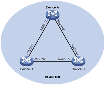

Loop detection configuration example
Network requirements
As shown in Figure 3_Ref257993452, configure loop detection on Device A to meet the following requirements:
·     Device A generates a log as a notification.
·     Device A automatically shuts down the port on which a loop is detected.
Figure 3 Network diagram

1.     Configure Device A:
# Create VLAN 100, and globally enable loop detection for the VLAN.
<DeviceA> system-view
[DeviceA] vlan 100
[DeviceA-vlan100] quit
[DeviceA] loopback-detection global enable vlan 100
# Configure Ten-GigabitEthernet 1/1/1 and Ten-GigabitEthernet 1/1/2 as trunk ports, and assign them to VLAN 100.
[DeviceA] interface ten-gigabitethernet 1/1/1
[DeviceA-Ten-GigabitEthernet1/1/1] port link-type trunk
[DeviceA-Ten-GigabitEthernet1/1/1] port trunk permit vlan 100
[DeviceA-Ten-GigabitEthernet1/1/1] quit
[DeviceA] interface ten-gigabitethernet 1/1/2
[DeviceA-Ten-GigabitEthernet1/1/2] port link-type trunk
[DeviceA-Ten-GigabitEthernet1/1/2] port trunk permit vlan 100
[DeviceA-Ten-GigabitEthernet1/1/2] quit
# Set the global loop protection action to shutdown.
[DeviceA] loopback-detection global action shutdown
# Set the loop detection interval to 35 seconds.
[DeviceA] loopback-detection interval-time 35
2.     Configure Device B:
# Create VLAN 100.
<DeviceB> system-view
[DeviceB] vlan 100
[DeviceB–vlan100] quit
[DeviceB] interface ten-gigabitethernet 1/1/1
[DeviceB-Ten-GigabitEthernet1/1/1] port link-type trunk
[DeviceB-Ten-GigabitEthernet1/1/1] port trunk permit vlan 100
[DeviceB-Ten-GigabitEthernet1/1/1] quit
[DeviceB] interface ten-gigabitethernet 1/1/2
[DeviceB-Ten-GigabitEthernet1/1/2] port link-type trunk
[DeviceB-Ten-GigabitEthernet1/1/2] port trunk permit vlan 100
[DeviceB-Ten-GigabitEthernet1/1/2] quit
3.     Configure Device C:
# Create VLAN 100.
<DeviceC> system-view
[DeviceC] vlan 100
[DeviceC–vlan100] quit
[DeviceC] interface ten-gigabitethernet 1/1/1
[DeviceC-Ten-GigabitEthernet1/1/1] port link-type trunk
[DeviceC-Ten-GigabitEthernet1/1/1] port trunk permit vlan 100
[DeviceC-Ten-GigabitEthernet1/1/1] quit
[DeviceC] interface ten-gigabitethernet 1/1/2
[DeviceC-Ten-GigabitEthernet1/1/2] port link-type trunk
[DeviceC-Ten-GigabitEthernet1/1/2] port trunk permit vlan 100
[DeviceC-Ten-GigabitEthernet1/1/2] quit
# View the system logs on devices, for example, Device A.
[DeviceA]
%Feb 24 15:04:29:663 2013 DeviceA LPDT/4/LPDT LOOPED: Loopback exists on Ten-GigabitEthernet1/1/1.
%Feb 24 15:04:29:667 2013 DeviceA LPDT/4/LPDT LOOPED: Loopback exists on Ten-GigabitEthernet1/1/2.
%Feb 24 15:04:44:243 2013 DeviceA LPDT/5/LPDT RECOVERED: Loopback on Ten-GigabitEthernet1/1/1 recovered.
%Feb 24 15:04:44:248 2013 DeviceA LPDT/5/LPDT RECOVERED: Loopback on Ten-GigabitEthernet1/1/2 recovered.
The output shows the following information:
·     Device A detected loops on Ten-GigabitEthernet 1/1/1 and Ten-GigabitEthernet 1/1/2 within a loop detection interval.
·     Loops on Ten-GigabitEthernet 1/1/1 and Ten-GigabitEthernet 1/1/2 were removed.
# Use the display loopback-detection command to display the loop detection configuration and status on devices, for example, Device A.
[DeviceA] display loopback-detection
Loop detection is enabled.
Loop detection interval is 35 second(s).
No loopback is detected.
The output shows that the device has removed the loops from Ten-GigabitEthernet 1/1/1 and Ten-GigabitEthernet 1/1/2 according to the shutdown action.
# Display the status of Ten-GigabitEthernet 1/1/1 on devices, for example, Device A.
[DeviceA] display interface ten-gigabitethernet 1/1/1
Ten-GigabitEthernet1/1/1 current state: DOWN (Loop detection down)
The output shows that Ten-GigabitEthernet 1/1/1 is already shut down by the loop detection module.
# Display the status of Ten-GigabitEthernet 1/1/2 on devices, for example, Device A.
[DeviceA] display interface ten-gigabitethernet 1/1/2
Ten-GigabitEthernet1/1/2 current state: DOWN (Loop detection down)
The output shows that Ten-GigabitEthernet 1/1/2 is already shut down by the loop detection module.
