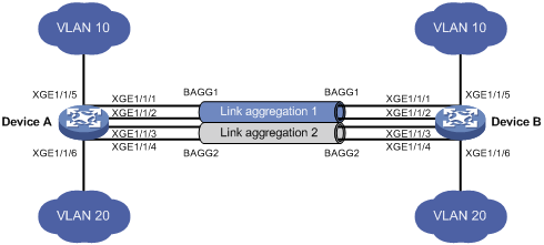

As shown in Figure 1, Device A and Device B are connected by three physical Ethernet links. These physical Ethernet links are combined into an aggregate link called link aggregation 1. The bandwidth of this aggregate link can reach up to the total bandwidth of the three physical Ethernet links. At the same time, the three Ethernet links back up one another. When a physical Ethernet link fails, the traffic previously transmitted on the failed link is switched to the other two links.
Figure 1 Ethernet link aggregation diagram

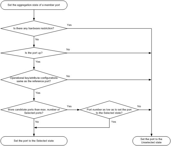

Setting the aggregation state of each member port
After the reference port is chosen, the system sets the aggregation state of each member port in the static aggregation group.
Figure 2 Setting the aggregation state of a member port in a static aggregation group
After the limit on Selected ports is reached, the aggregation state of a new member port varies by following conditions:
·     The port is placed in Unselected state if the port and the Selected ports have the same port priority. This mechanism prevents traffic interruption on the existing Selected ports. A device reboot can cause the device to recalculate the aggregation states of member ports.
·     The port is placed in Selected state when the following conditions are met:
¡     The port and the Selected ports have different port priorities, and the port has a higher port priority than a minimum of one Selected port.
¡     The port has the same attribute configurations as the aggregate interface.
Any operational key or attribute configuration change might affect the aggregation states of link aggregation member ports.

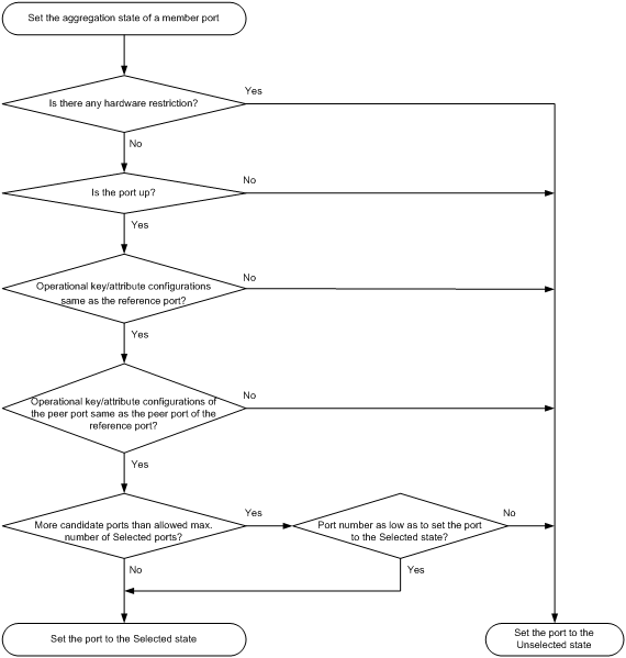

How dynamic link aggregation works
Choosing a reference port
The system chooses a reference port from the member ports in up state. A Selected port must have the same operational key and attribute configurations as the reference port.
The local system (the actor) and the peer system (the partner) negotiate a reference port by using the following workflow:
1.     The two systems determine the system with the smaller system ID.
A system ID contains the system LACP priority and the system MAC address.
a.     The two systems compare their LACP priority values.
The lower the LACP priority, the smaller the system ID. If the LACP priority values are the same, the two systems proceed to step b.
b.     The two systems compare their MAC addresses.
The lower the MAC address, the smaller the system ID.
2.     The system with the smaller system ID chooses the port with the smallest port ID as the reference port.
A port ID contains a port priority and a port number. The lower the port priority, the smaller the port ID.
a.     The system chooses the port with the lowest priority value as the reference port.
If the ports have the same priority, the system proceeds to step b.
b.     The system compares their port numbers.
The smaller the port number, the smaller the port ID.
The port with the smallest port number and the same attribute configurations as the aggregate interface is chosen as the reference port.
After the reference port is chosen, the system with the smaller system ID sets the state of each member port on its side.
Figure 3 Setting the state of a member port in a dynamic aggregation group
The system with the greater system ID can detect the aggregation state changes on the peer system. The system with the greater system ID sets the aggregation state of local member ports the same as their peer ports.

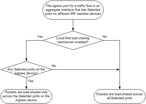

Load sharing modes for link aggregation groups
In a link aggregation group, traffic can be load shared across the Selected ports based on any of the following modes:
·     Per-flow load sharing—Load shares traffic on a per-flow basis. The load sharing mode classifies packets into flows and forwards packets of the same flow on the same link. This mode can be one or any combination of the following traffic classification criteria:
¡     Ingress port.
¡     Source or destination IP address.
¡     Source or destination MAC address.
¡     Source or destination port number.
¡     MPLS label.
·     Packet type-based load sharing—Load shares traffic automatically based on packet types (Layer 2 protocol, IPv4, MPLS, or IPv6).

Enabling local-first load sharing for link aggregation
Use local-first load sharing in a multidevice link aggregation scenario to distribute traffic preferentially across member ports on the ingress card or device.
When you aggregate ports on different member devices in an IRF fabric, you can use local-first load sharing to reduce traffic on IRF links, as shown in Figure 4. For more information about IRF, see IRF Configuration Guide.
Figure 4 Load sharing for multidevice link aggregation in an IRF fabric
To enable local-first load sharing for link aggregation:
Step
Remarks
N/A
2.     Enable local-first load sharing for link aggregation.
link-aggregation load-sharing mode local-first
By default, local-first load sharing for link aggregation is enabled.

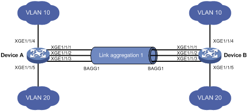

Layer 2 static aggregation configuration example
Network requirements
On the network shown in Figure 5, perform the following tasks:
·     Configure a Layer 2 static aggregation group on both Device A and Device B.
·     Enable VLAN 10 at one end of the aggregate link to communicate with VLAN 10 at the other end.
·     Enable VLAN 20 at one end of the aggregate link to communicate with VLAN 20 at the other end.
Figure 5 Network diagram
Configuration procedure
1.     Configure Device A:
# Create VLAN 10, and assign port Ten-GigabitEthernet 1/1/4 to VLAN 10.
<DeviceA> system-view
[DeviceA] vlan 10
[DeviceA-vlan10] port ten-gigabitethernet 1/1/4
[DeviceA-vlan10] quit
# Create VLAN 20, and assign port Ten-GigabitEthernet 1/1/5 to VLAN 20.
[DeviceA] vlan 20
[DeviceA-vlan20] port ten-gigabitethernet 1/1/5
[DeviceA-vlan20] quit
# Create Layer 2 aggregate interface Bridge-Aggregation 1.
[DeviceA] interface bridge-aggregation 1
[DeviceA-Bridge-Aggregation1] quit
# Assign ports Ten-GigabitEthernet 1/1/1 through Ten-GigabitEthernet 1/1/3 to link aggregation group 1.
[DeviceA] interface ten-gigabitethernet 1/1/1
[DeviceA-Ten-GigabitEthernet1/1/1] port link-aggregation group 1
[DeviceA-Ten-GigabitEthernet1/1/1] quit
[DeviceA] interface ten-gigabitethernet 1/1/2
[DeviceA-Ten-GigabitEthernet1/1/2] port link-aggregation group 1
[DeviceA-Ten-GigabitEthernet1/1/2] quit
[DeviceA] interface ten-gigabitethernet 1/1/3
[DeviceA-Ten-GigabitEthernet1/1/3] port link-aggregation group 1
[DeviceA-Ten-GigabitEthernet1/1/3] quit
# Configure Layer 2 aggregate interface Bridge-Aggregation 1 as a trunk port and assign it to VLANs 10 and 20.
[DeviceA-Bridge-Aggregation1] port link-type trunk
[DeviceA-Bridge-Aggregation1] port trunk permit vlan 10 20
2.     Configure Device B in the same way Device A is configured. (Details not shown.)
# Display detailed information about all aggregation groups on Device A.
[DeviceA] display link-aggregation verbose
Loadsharing Type: Shar -- Loadsharing, NonS -- Non-Loadsharing
Port Status: S -- Selected, U -- Unselected, I -- Individual, * -- Management port
Flags:  A -- LACP_Activity, B -- LACP_Timeout, C -- Aggregation,
        G -- Defaulted, H -- Expired
Aggregate Interface: Bridge-Aggregation1
Aggregation Mode: Static
Management VLAN : None
  Port             Status  Priority Oper-Key
  XGE1/1/1         S       32768    1
  XGE1/1/2         S       32768    1
  XGE1/1/3         S       32768    1
The output shows that link aggregation group 1 is a Layer 2 static aggregation group that contains three Selected ports.

Layer 2 aggregation load sharing configuration example
On the network shown in Figure 7, perform the following tasks:
·     Configure Layer 2 static aggregation groups 1 and 2 on Device A and Device B, respectively.
·     Configure link aggregation groups 1 and 2 to load share traffic across aggregation group member ports.
¡     Configure link aggregation group 1 to load share packets based on source MAC addresses.
¡     Configure link aggregation group 2 to load share packets based on destination MAC addresses.
Figure 7 Network diagram
# Create VLAN 10, and assign the port Ten-GigabitEthernet 1/1/5 to VLAN 10.
[DeviceA] vlan 10
[DeviceA-vlan10] port ten-gigabitethernet 1/1/5
# Create VLAN 20, and assign the port Ten-GigabitEthernet 1/1/6 to VLAN 20.
[DeviceA] vlan 20
[DeviceA-vlan20] port ten-gigabitethernet 1/1/6
# Configure Layer 2 aggregation group 1 to load share packets based on source MAC addresses.
[DeviceA-Bridge-Aggregation1] link-aggregation load-sharing mode source-mac
# Assign ports Ten-GigabitEthernet 1/1/1 and Ten-GigabitEthernet 1/1/2 to link aggregation group 1.
# Configure Layer 2 aggregate interface Bridge-Aggregation 1 as a trunk port and assign it to VLAN 10.
# Create Layer 2 aggregate interface Bridge-Aggregation 2.
[DeviceA] interface bridge-aggregation 2
# Configure Layer 2 aggregation group 2 to load share packets based on destination MAC addresses.
[DeviceA-Bridge-Aggregation2] link-aggregation load-sharing mode destination-mac
[DeviceA-Bridge-Aggregation2] quit
# Assign ports Ten-GigabitEthernet 1/1/3 and Ten-GigabitEthernet 1/1/4 to link aggregation group 2.
[DeviceA-Ten-GigabitEthernet1/1/3] port link-aggregation group 2
[DeviceA] interface ten-gigabitethernet 1/1/4
[DeviceA-Ten-GigabitEthernet1/1/4] port link-aggregation group 2
[DeviceA-Ten-GigabitEthernet1/1/4] quit
# Configure Layer 2 aggregate interface Bridge-Aggregation 2 as a trunk port and assign it to VLAN 20.
[DeviceA-Bridge-Aggregation2] port link-type trunk
[DeviceA-Bridge-Aggregation2] port trunk permit vlan 20
  XGE1/1/1         S       32768    1
  XGE1/1/2         S       32768    1
Aggregate Interface: Bridge-Aggregation2
  XGE1/1/3           S       32768    2
  XGE1/1/4           S       32768    2
The output shows that:
·     Link aggregation groups 1 and 2 are both load-shared Layer 2 static aggregation groups.
·     Each aggregation group contains two Selected ports.
# Display all the group-specific load sharing modes on Device A.
[DeviceA] display link-aggregation load-sharing mode interface
Bridge-Aggregation1 Load-Sharing Mode:
source-mac address
Bridge-Aggregation2 Load-Sharing Mode:
destination-mac address
·     Link aggregation group 1 load shares packets based on source MAC addresses.
·     Link aggregation group 2 load shares packets based on destination MAC addresses.
Aggregate Interface: Route-Aggregation1
  XGE1/1/1         S       32768    1
  XGE1/1/2         S       32768    1
Aggregate Interface: Route-Aggregation2
  XGE1/1/3         S       32768    2
  XGE1/1/4         S       32768    2
·     Link aggregation groups 1 and 2 are both load-shared Layer 3 static aggregation groups.
Route-Aggregation1 Load-Sharing Mode:
source-ip address
Route-Aggregation2 Load-Sharing Mode:
destination-ip address
·     Link aggregation group 1 load shares packets based on source IP addresses.
·     Link aggregation group 2 load shares packets based on destination IP addresses.
