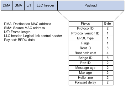

Configuration BPDUs
Devices exchange configuration BPDUs to elect the root bridge and determine port roles. Figure 1 shows the configuration BPDU format.

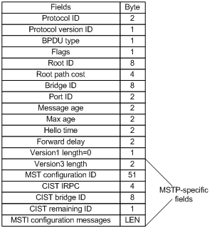

Figure 1 Configuration BPDU format
The payload of a configuration BPDU includes the following fields:
·     Protocol ID—Fixed at 0x0000, which represents IEEE 802.1d.
·     Protocol version ID—Spanning tree protocol version ID. The protocol version ID for STP is 0x00.
·     BPDU type—Type of the BPDU. The value is 0x00 for a configuration BPDU.
·     Flags—An 8-bit field indicates the purpose of the BPDU. The lowest bit is the Topology Change (TC) flag. The highest bit is the Topology Change Acknowledge (TCA) flag. All other bits are reserved.
·     Root ID—Root bridge ID formed by the priority and MAC address of the root bridge.
·     Root path cost—Cost of the path to the root bridge.
·     Bridge ID—Designated bridge ID formed by the priority and MAC address of the designated bridge.
·     Port ID—Designated port ID formed by the priority and global port number of the designated port.
·     Message age—Age of the configuration BPDU while it propagates in the network.
·     Max age—Maximum age of the configuration BPDU stored on the switch.
·     Hello time—Configuration BPDU transmission interval.
·     Forward delay—Delay for STP bridges to transit port state.
Devices use the root bridge ID, root path cost, designated bridge ID, designated port ID, message age, max age, hello time, and forward delay for spanning tree calculation.

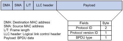

TCN BPDUs
Devices use TCN BPDUs to announce changes in the network topology. Figure 2 shows the TCN BPDU format.
Figure 2 TCN BPDU format
The payload of a TCN BPDU includes the following fields:
·     BPDU type—Type of the BPDU. The value is 0x80 for a TCN BPDU.

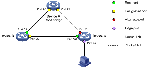

Root port
On a non-root bridge, the port nearest to the root bridge is the root port. The root port communicates with the root bridge. Each non-root bridge has only one root port. The root bridge has no root port.
Designated bridge and designated port
Classification
Designated bridge
Designated port
For a device
Device directly connected to the local device and responsible for forwarding BPDUs to the local device.
Port through which the designated bridge forwards BPDUs to this device.
For a LAN
Device responsible for forwarding BPDUs to this LAN segment.
Port through which the designated bridge forwards BPDUs to this LAN segment.

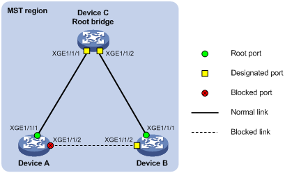

As shown in Figure 3, Device B and Device C are directly connected to a LAN.
If Device A forwards BPDUs to Device B through port A1, the designated bridge and designated port are as follows:
·     The designated bridge for Device B is Device A.
·     The designated port for Device B is port A1 on Device A.
If Device B forwards BPDUs to the LAN, the designated bridge and designated port are as follows:
·     The designated bridge for the LAN is Device B.
·     The designated port for the LAN is port B2 on Device B.

An RSTP BPDU uses the same format as an STP BPDU except that a Version1 length field is added to the payload of RSTP BPDUs. The differences between an RSTP BPDU and an STP BPDU are as follows:
·     Protocol version ID—The value is 0x02 for RSTP.
·     BPDU type—The value is 0x02 for RSTP BPDUs.
·     Flags—All 8 bits are used.
·     Version1 length—The value is 0x00, which means no version 1 protocol information is present.

In addition to root port and designated port, RSTP also uses the following port roles:
·     Alternate port—Acts as the backup port for a root port. When the root port is blocked, the alternate port takes over.
·     Backup port—Acts as the backup port of a designated port. When the designated port is invalid, the backup port becomes the new designated port. A loop occurs when two ports of the same spanning tree device are connected, so the device blocks one of the ports. The blocked port is the backup port.
·     Edge port—Directly connects to a user host rather than a network device or network segment.

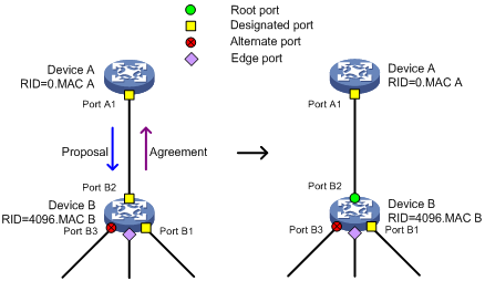

¡     A newly elected RSTP root port rapidly enters the forwarding state if the following requirements are met:
-     The old root port on the device has stopped forwarding data.
-     The upstream designated port has started forwarding data.
¡     A newly elected RSTP designated port rapidly enters the forwarding state if one of the following requirements is met:
-     The designated port is configured as an edge port which directly connects to a user terminal.
-     The designated port connects to a point-to-point link and receives a handshake response from the directly connected device.

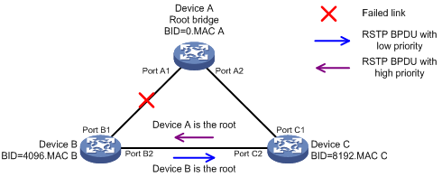

RSTP BPDU processing
In RSTP, a non-root bridge actively sends RSTP BPDUs at the hello time through designated ports without waiting for the root bridge to send RSTP BPDUs. This enables RSTP to quickly detect link failures. If a device fails to receive any RSTP BPDUs on a port within triple the hello time, the device considers that a link failure has occurred. After the stored configuration BPDU expires, the device floods RSTP BPDUs with the TC flag set to initiate a new RSTP calculation.
In RSTP, a port in blocking state can immediately respond to an RSTP BPDU with a lower priority than its own BPDU.
As shown in Figure 6, Device A is the root bridge. The priority of Device B is higher than the priority of Device C. Port C2 on Device C is blocked.
When the link between Device A and Device B fails, the following events occur:
1.     Device B sends an RSTP BPDU with itself as the root bridge to Device C.
2.     Device C compares the RSTP BPDU with its own BPDU.
3.     Because the RSTP BPDU from Device B has a lower priority, Device C sends its own BPDU to Device B.
4.     Device B considers that Port B2 is the root port and stops sending RSTP BPDUs to Device C.
Figure 6 BPDU processing in RSTP

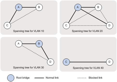

In an STP- or RSTP-enabled LAN, all bridges share one spanning tree. Traffic from all VLANs is forwarded along the spanning tree, and ports cannot be blocked on a per-VLAN basis to prune loops.
PVST allows every VLAN to have its own spanning tree, which increases usage of links and bandwidth. Because each VLAN runs RSTP independently, a spanning tree only serves its VLAN.

PVST implements per-VLAN spanning tree calculation by mapping each VLAN to an MSTI. In PVST, each VLAN runs RSTP independently to maintain its own spanning tree without affecting the spanning trees of other VLANs. In this way, loops in each VLAN are eliminated and traffic of different VLANs is load shared over links. PVST uses RSTP BPDUs in the default VLAN and PVST BPDUs in other VLANs for spanning tree calculation.

Figure 8 shows the format of an MSTP BPDU.
Figure 8 MSTP BPDU format
The first 13 fields of an MSTP BPDU are the same as an RSTP BPDU. The other six fields are unique to MSTP.
·     Protocol version IDThe value is 0x03 for MSTP.
·     BPDU typeThe value is 0x02 for RSTP/MSTP BPDUs.
·     Root IDID of the common root bridge.
·     Root path costCIST external path cost.
·     Bridge IDID of the regional root for the IST or an MSTI.
·     Port IDID of the designated port in the CIST.
·     Version3 lengthLength of the MSTP-specific fields. Devices use this field for verification upon receiving an MSTP BPDU.
·     MST configuration IDIncludes the format selector, configuration name, revision level, and configuration digest. The value for format selector is fixed at 0x00. The other parameters are used to identify the MST region for the originating bridge.
·     CIST IRPCInternal root path cost (IRPC) from the originating bridge to the root of the MST region.
·     CIST bridge IDID of the bridge that sends the MSTP BPDU.
·     CIST remaining IDRemaining hop count. This field limits the scale of the MST region. The regional root sends a BPDU with the remaining hop count set to the maximum value. Each device that receives the BPDU decrements the hop count by one. When the hop count reaches zero, the BPDU is discarded. Devices beyond the maximum hops of the MST region cannot participate in spanning tree calculation. The default remaining hop count is 20.
·     MSTI configuration messagesContains MSTI configuration messages. Each MSTI configuration message is 16 bytes. This field can contain 0 to 64 MSTI configuration messages. The number of the MSTI configuration messages is determined by the number of MSTIs in the MST region.

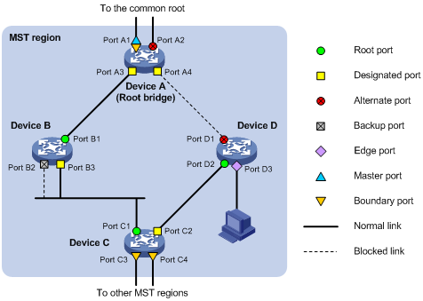

MSTP basic concepts

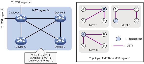

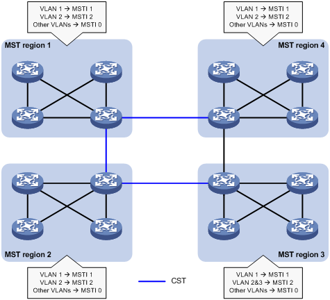

Figure 9 shows a switched network that contains four MST regions, each MST region containing four MSTP devices. Figure 10 shows the networking topology of MST region 3.
Figure 9 Basic concepts in MSTP
Figure 10 Network diagram and topology of MST region 3
MST region
A multiple spanning tree region (MST region) consists of multiple devices in a switched network and the network segments among them. All these devices have the following characteristics:
·     A spanning tree protocol enabled
·     Same region name
·     Same VLAN-to-instance mapping configuration
·     Same MSTP revision level
·     Physically linked together
Multiple MST regions can exist in a switched network. You can assign multiple devices to the same MST region, as shown in Figure 9.
·     The switched network contains four MST regions, MST region 1 through MST region 4.
·     All devices in each MST region have the same MST region configuration.
MSTI
MSTP can generate multiple independent spanning trees in an MST region, and each spanning tree is mapped to the specific VLANs. Each spanning tree is referred to as a multiple spanning tree instance (MSTI).
In Figure 10, MST region 3 contains three MSTIs, MSTI 1, MSTI 2, and MSTI 0.
VLAN-to-instance mapping table
As an attribute of an MST region, the VLAN-to-instance mapping table describes the mapping relationships between VLANs and MSTIs.
In Figure 10, the VLAN-to-instance mapping table of MST region 3 is as follows:
·     VLAN 1 to MSTI 1.
·     VLAN 2 and VLAN 3 to MSTI 2.
·     Other VLANs to MSTI 0.
MSTP achieves load balancing by means of the VLAN-to-instance mapping table.
CST
The common spanning tree (CST) is a single spanning tree that connects all MST regions in a switched network. If you regard each MST region as a device, the CST is a spanning tree calculated by these devices through STP or RSTP.
The blue lines in Figure 9 represent the CST.
IST
An internal spanning tree (IST) is a spanning tree that runs in an MST region. It is also called MSTI 0, a special MSTI to which all VLANs are mapped by default.
In Figure 9, MSTI 0 is the IST in MST region 3.
CIST
The common and internal spanning tree (CIST) is a single spanning tree that connects all devices in a switched network. It consists of the ISTs in all MST regions and the CST.
In Figure 9, the ISTs (MSTI 0) in all MST regions plus the inter-region CST constitute the CIST of the entire network.
Regional root
The root bridge of the IST or an MSTI within an MST region is the regional root of the IST or MSTI. Based on the topology, different spanning trees in an MST region might have different regional roots, as shown in MST region 3 in Figure 10.
·     The regional root of MSTI 1 is Device B.
·     The regional root of MSTI 2 is Device C.
·     The regional root of MSTI 0 (also known as the IST) is Device A.
Common root bridge
The common root bridge is the root bridge of the CIST.
In Figure 9, the common root bridge is a device in MST region 1.
Port roles
A port can play different roles in different MSTIs. As shown in Figure 11, an MST region contains Device A, Device B, Device C, and Device D. Port A1 and port A2 of Device A connect to the common root bridge. Port B2 and Port B3 of Device B form a loop. Port C3 and Port C4 of Device C connect to other MST regions. Port D3 of Device D directly connects to a host.
Figure 11 Port roles
MSTP calculation involves the following port roles:
·     Root port—Forwards data for a non-root bridge to the root bridge. The root bridge does not have any root port.
·     Designated port—Forwards data to the downstream network segment or device.
·     Alternate port—Acts as the backup port for a root port or master port. When the root port or master port is blocked, the alternate port takes over.
·     Backup port—Acts as the backup port of a designated port. When the designated port is invalid, the backup port becomes the new designated port. A loop occurs when two ports of the same spanning tree device are connected, so the device blocks one of the ports. The blocked port acts as the backup.
·     Master port—Acts as a port on the shortest path from the local MST region to the common root bridge. The master port is not always located on the regional root. It is a root port on the IST or CIST and still a master port on the other MSTIs.
·     Boundary port—Connects an MST region to another MST region or to an STP/RSTP-running device. In MSTP calculation, a boundary port's role on an MSTI is consistent with its role on the CIST. However, that is not true with master ports. A master port on MSTIs is a root port on the CIST.
Port states
In MSTP, a port can be in one of the following states:
·     Forwarding—The port receives and sends BPDUs, learns MAC addresses, and forwards user traffic.
·     Learning—The port receives and sends BPDUs, learns MAC addresses, but does not forward user traffic. Learning is an intermediate port state.
·     Discarding—The port receives and sends BPDUs, but does not learn MAC addresses or forward user traffic.
When in different MSTIs, a port can be in different states.

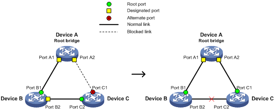

Root port rapid transition
When a root port is blocked, the bridge will elect the alternate port with the highest priority as the new root port. If the new root port's peer is in the forwarding state, the new root port immediately transits to the forwarding state.
As shown in Figure 13, Port C2 on Device C is a root port and Port C1 is an alternate port. When Port C2 transits to the blocking state, Port C1 is elected as the root port and immediately transits to the forwarding state.
Figure 13 Root port rapid transition

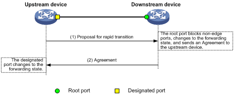

P/A transition
The P/A transition enables a designated port to rapidly transit to the forwarding state after a handshake with its peer. The P/A transition applies only to point-to-point links.
·     P/A transition for RSTP and PVST.
In RSTP or PVST, the ports on a new link or recovered link are designated ports in blocking state. When one of the designated ports transits to the discarding or learning state, it sets the proposal flag in its BPDU. Its peer bridge receives the BPDU and determines whether the receiving port is the root port. If it is the root port, the bridge blocks the other ports except edge ports. The bridge then replies an agreement BPDU to the designated port. The designated port immediately transits to the forwarding state upon receiving the agreement BPDU. If the designated port does not receive the agreement BPDU, it waits for twice the forward delay to transit to the forwarding state.
As shown in Figure 14, the P/A transition operates as follows:
a.     Device A sends a proposal BPDU to Device B through Port A1.
b.     Device B receives the proposal BPDU on Port B2. Port B2 is elected as the root port.
c.     Device B blocks its designated port Port B1 and alternate port Port B3 to eliminate loops.
d.     The root port Port B2 transits to the forwarding state and sends an agreement BPDU to Device A.
e.     The designated port Port A1 on Device A immediately transits to the forwarding state after receiving the agreement BPDU.
Figure 14 P/A transition for RSTP and PVST

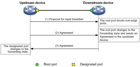

·     P/A transition for MSTP.
In MSTP, an upstream bridge sets both the proposal and agreement flags in its BPDU. If a downstream bridge receives the BPDU and its receiving port is elected as the root port, the bridge blocks all the other ports except edge ports. The downstream bridge then replies an agreement BPDU to the upstream bridge. The upstream port immediately transits to the forwarding state upon receiving the agreement BPDU. If the upstream port does not receive the agreement BPDU, it waits for twice the forward delay to transit to the forwarding state.
As shown in Figure 15, the P/A transition operates as follows:
a.     Device A sets the proposal and agreement flags in its BPDU and sends it to Device B through Port A1.
b.     Device B receives the BPDU. Port B1 of Device B is elected as the root port.
c.     Device B then blocks all its ports except the edge ports.
d.     The root port Port B1 of Device B transits to the forwarding state and sends an agreement BPDU to Device A.
e.     Port A1 of Device A immediately transits to the forwarding state upon receiving the agreement BPDU.
Figure 15 P/A transition for MSTP

Figure 17 Rapid state transition of an MSTP designated port
Figure 18 Rapid state transition of an RSTP designated port

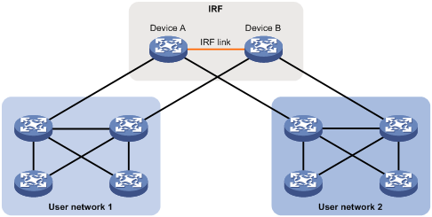

As shown in Figure 20, an IRF fabric connects to two user networks through double links.
·     Device A and Device B form the IRF fabric.
·     The spanning tree feature is disabled on Device A and Device B and enabled on all devices in user network 1 and user network 2.
·     The IRF fabric transparently transmits BPDUs for both user networks and is not involved in the calculation of spanning trees.
When the network topology changes, it takes time for the IRF fabric to update its MAC address table and ARP table. During this period, traffic in the network might be interrupted.
Figure 20 TC Snooping application scenario
image14.emf
To avoid traffic interruption, you can enable TC Snooping on the IRF fabric. After receiving a TC-BPDU through a port, the IRF fabric updates MAC address table and ARP table entries associated with the port's VLAN. In this way, TC Snooping prevents topology change from interrupting traffic forwarding in the network. For more information about the MAC address table and the ARP table, see "Configuring the MAC address table" and Layer 3—IP Services Configuration Guide.

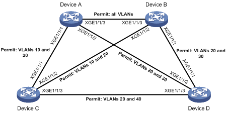

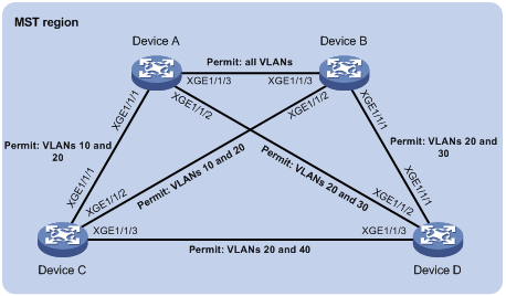

As shown in Figure 21, all devices on the network are in the same MST region. Device A and Device B work at the distribution layer. Device C and Device D work at the access layer.
Configure MSTP so that frames of different VLANs are forwarded along different spanning trees.
·     VLAN 10 frames are forwarded along MSTI 1.
·     VLAN 30 frames are forwarded along MSTI 3.
·     VLAN 40 frames are forwarded along MSTI 4.
·     VLAN 20 frames are forwarded along MSTI 0.
VLAN 10 and VLAN 30 are terminated on the distribution layer devices, and VLAN 40 is terminated on the access layer devices. The root bridges of MSTI 1 and MSTI 3 are Device A and Device B, respectively, and the root bridge of MSTI 4 is Device C.
Figure 21 Network diagram
Configuration procedure
1.     Configure VLANs and VLAN member ports. (Details not shown.)
¡     Create VLAN 10, VLAN 20, and VLAN 30 on both Device A and Device B.
¡     Create VLAN 10, VLAN 20, and VLAN 40 on Device C.
¡     Create VLAN 20, VLAN 30, and VLAN 40 on Device D.
¡     Configure the ports on these devices as trunk ports and assign them to related VLANs.

# Map VLAN 10, VLAN 30, and VLAN 40 to MSTI 1, MSTI 3, and MSTI 4, respectively.
[DeviceC-mst-region] instance 1 vlan 10
[DeviceC-mst-region] instance 3 vlan 30
[DeviceC-mst-region] instance 4 vlan 40
# Configure the revision level of the MST region as 0.
[DeviceC-mst-region] revision-level 0
# Activate MST region configuration.
[DeviceC-mst-region] active region-configuration
[DeviceC-mst-region] quit
# Configure the Device C as the root bridge of MSTI 4.
[DeviceC] stp instance 4 root primary
# Enable the spanning tree feature globally.
[DeviceC] stp global enable
5.     Configure Device D:
# Enter MST region view, and configure the MST region name as example.
<DeviceD> system-view
[DeviceD] stp region-configuration
[DeviceD-mst-region] region-name example
[DeviceD-mst-region] instance 1 vlan 10
[DeviceD-mst-region] instance 3 vlan 30
[DeviceD-mst-region] instance 4 vlan 40
[DeviceD-mst-region] revision-level 0
[DeviceD-mst-region] active region-configuration
[DeviceD-mst-region] quit
[DeviceD] stp global enable
In this example, Device B has the lowest root bridge ID. As a result, Device B is elected as the root bridge in MSTI 0.
When the network is stable, you can use the display stp brief command to display brief spanning tree information on each device.
# Display brief spanning tree information on Device A.
[DeviceA] display stp brief
 MST ID      Port                         Role  STP State     Protection
 0           Ten-GigabitEthernet1/1/1     ALTE  DISCARDING    NONE
 0           Ten-GigabitEthernet1/1/2     DESI  FORWARDING    NONE
 0           Ten-GigabitEthernet1/1/3     ROOT  FORWARDING    NONE
 1           Ten-GigabitEthernet1/1/1     DESI  FORWARDING    NONE
 1           Ten-GigabitEthernet1/1/3     DESI  FORWARDING    NONE
 3           Ten-GigabitEthernet1/1/2     DESI  FORWARDING    NONE
 3           Ten-GigabitEthernet1/1/3     ROOT  FORWARDING    NONE
# Display brief spanning tree information on Device B.
[DeviceB] display stp brief
 0           Ten-GigabitEthernet1/1/1     DESI  FORWARDING    NONE
 0           Ten-GigabitEthernet1/1/3     DESI  FORWARDING    NONE
 1           Ten-GigabitEthernet1/1/2     DESI  FORWARDING    NONE
 1           Ten-GigabitEthernet1/1/3     ROOT  FORWARDING    NONE
 3           Ten-GigabitEthernet1/1/1     DESI  FORWARDING    NONE
 3           Ten-GigabitEthernet1/1/3     DESI  FORWARDING    NONE
# Display brief spanning tree information on Device C.
[DeviceC] display stp brief
 0           Ten-GigabitEthernet1/1/2     ROOT  FORWARDING    NONE
 1           Ten-GigabitEthernet1/1/1     ROOT  FORWARDING    NONE
 1           Ten-GigabitEthernet1/1/2     ALTE  DISCARDING    NONE
 4           Ten-GigabitEthernet1/1/3     DESI  FORWARDING    NONE
# Display brief spanning tree information on Device D.
[DeviceD] display stp brief
 0           Ten-GigabitEthernet1/1/1     ROOT  FORWARDING    NONE
 0           Ten-GigabitEthernet1/1/2     ALTE  DISCARDING    NONE
 0           Ten-GigabitEthernet1/1/3     ALTE  DISCARDING    NONE
 3           Ten-GigabitEthernet1/1/1     ROOT  FORWARDING    NONE
 3           Ten-GigabitEthernet1/1/2     ALTE  DISCARDING    NONE
 4           Ten-GigabitEthernet1/1/3     ROOT  FORWARDING    NONE
Based on the output, you can draw each MSTI mapped to each VLAN, as shown in Figure 22.
Figure 22 MSTIs mapped to different VLANs

Network requirements
As shown in Figure 23, Device A and Device B work at the distribution layer, and Device C and Device D work at the access layer.
Configure PVST to meet the following requirements:
·     Frames of a VLAN are forwarded along the spanning trees of the VLAN.
·     VLAN 10, VLAN 20, and VLAN 30 are terminated on the distribution layer devices, and VLAN 40 is terminated on the access layer devices.
·     The root bridge of VLAN 10 and VLAN 20 is Device A.
·     The root bridge of VLAN 30 is Device B.
·     The root bridge of VLAN 40 is Device C.
Figure 23 Network diagram
 VLAN ID     Port                         Role  STP State     Protection
 10          Ten-GigabitEthernet1/1/1     DESI  FORWARDING    NONE
 10          Ten-GigabitEthernet1/1/3     DESI  FORWARDING    NONE
 20          Ten-GigabitEthernet1/1/1     DESI  FORWARDING    NONE
 20          Ten-GigabitEthernet1/1/2     DESI  FORWARDING    NONE
 20          Ten-GigabitEthernet1/1/3     DESI  FORWARDING    NONE
 30          Ten-GigabitEthernet1/1/2     DESI  FORWARDING    NONE
 30          Ten-GigabitEthernet1/1/3     ROOT  FORWARDING    NONE
 10          Ten-GigabitEthernet1/1/2     DESI  FORWARDING    NONE
 10          Ten-GigabitEthernet1/1/3     ROOT  FORWARDING    NONE
 20          Ten-GigabitEthernet1/1/3     ROOT  FORWARDING    NONE
 30          Ten-GigabitEthernet1/1/1     DESI  FORWARDING    NONE
 30          Ten-GigabitEthernet1/1/3     DESI  FORWARDING    NONE
 10          Ten-GigabitEthernet1/1/1     ROOT  FORWARDING    NONE
 10          Ten-GigabitEthernet1/1/2     ALTE  DISCARDING    NONE
 20          Ten-GigabitEthernet1/1/1     ROOT  FORWARDING    NONE
 20          Ten-GigabitEthernet1/1/2     ALTE  DISCARDING    NONE
 40          Ten-GigabitEthernet1/1/3     DESI  FORWARDING    NONE
 20          Ten-GigabitEthernet1/1/1     ALTE  DISCARDING    NONE
 20          Ten-GigabitEthernet1/1/2     ROOT  FORWARDING    NONE
 20          Ten-GigabitEthernet1/1/3     ALTE  DISCARDING    NONE
 30          Ten-GigabitEthernet1/1/1     ROOT  FORWARDING    NONE
 30          Ten-GigabitEthernet1/1/2     ALTE  DISCARDING    NONE
 40          Ten-GigabitEthernet1/1/3     ROOT  FORWARDING    NONE
Based on the output, you can draw a topology for each VLAN spanning tree, as shown in Figure 24.
Figure 24 VLAN spanning tree topologies
