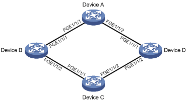

To avoid single-point failures and guarantee network reliability, downstream devices are typically dual-homed to upstream devices, as shown in Figure 1.
Figure 1 Dual uplink network diagram
To remove network loops on a dual-homed network, you can use a spanning tree protocol or the Rapid Ring Protection Protocol (RRPP). However, convergence time is long with spanning tree protocols, which makes it unsuitable for users who have high demand on convergence speed. RRPP can meet demand on convergence speed, but it involves complicated networking and configurations and is mainly used in ring-shaped networks.
For more information about spanning tree protocols, see Layer 2—LAN Switching Configuration Guide. For more information about RRPP, see "Configuring RRPP."
Smart Link is a feature developed to address the slow convergence issue with STP. It provides link redundancy as well as fast convergence in a dual uplink network, allowing the backup link to take over quickly when the primary link fails. Smart Link features subsecond convergence time.
A Smart Link device is configured with a smart link group and a transmit control VLAN to transmit flush messages. For example, Device C and Device D in Figure 1 are Smart Link devices.
An associated device supports Smart Link, and receives flush messages sent from the specified control VLAN. For example, Device A, Device B, and Device E in Figure 1 are associated devices.

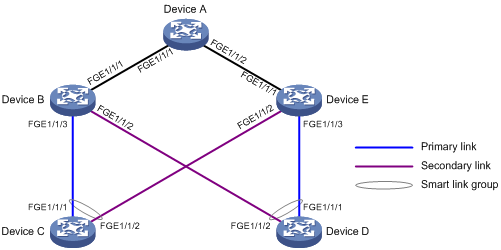

As shown in Figure 1, the link on Port 1 of Device C is the primary link. The link on Port 2 of Device C is the secondary link. Typically, Port 1 is in forwarding state, and Port 2 is in standby state. When the primary link fails, Port 2 takes over to forward traffic and Port 1 is blocked and placed in standby state.
When a port switches to the forwarding state, the system outputs log information to notify the user of the port state change.
Topology change
Link switchover can outdate the MAC address forwarding entries and ARP/ND entries on all devices, so a forwarding entry update mechanism is required to ensure proper transmission. The following update mechanisms are provided:
·     Uplink traffic-triggered MAC address learning—Update is triggered by uplink traffic. This mechanism is applicable to environments with devices that do not support Smart Link, including devices from other vendors.
·     Flush update—A Smart Link-enabled device updates its information by transmitting flush messages over the backup link to its upstream devices. This mechanism requires the upstream devices to be capable of recognizing Smart Link flush messages to update their MAC address forwarding entries and ARP/ND entries.
Role preemption
As shown in Figure 1, the link on Port 1 of Device C is the primary link. The link on Port 2 of Device C is the secondary link. Once the primary link fails, Port 1 is automatically blocked and placed in standby state, and Port 2 takes over to forward traffic. When the primary link recovers, one of the following actions occurs:
·     To keep traffic forwarding stable if the smart link group is not configured with role preemption, Port 1 does not immediately take over to forward traffic. It stays blocked until the next link switchover.
·     If the smart link group is configured with role preemption, Port 1 takes over to forward traffic as soon as its link recovers, and Port 2 is automatically blocked and placed in standby state.
Load sharing
A ring network might carry traffic of multiple VLANs. Smart Link can forward traffic from different VLANs in different smart link groups for load sharing.
To implement load sharing, you can assign a port to multiple smart link groups. Configure each group with a different protected VLAN. Make sure the state of the port is different in these smart link groups, so traffic from different VLANs can be forwarded along different paths.
You can configure protected VLANs for a smart link group by referencing Multiple Spanning Tree Instances (MSTIs). For more information about MSTIs, see Layer 2—LAN Switching Configuration Guide.

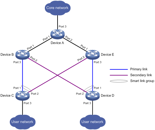

Network requirements
As shown in Figure 2:
·     Device C and Device D are Smart Link devices. Device A, Device B, and Device E are associated devices. Traffic of VLANs 1 through 30 on Device C and Device D is dually uplinked to Device A.
·     Configure Smart Link on Device C and Device D for dual uplink backup.
Figure 2 Network diagram
Configuration procedure
1.     Configure Device C:
# Create VLANs 1 through 30, map these VLANs to MSTI 1, and activate the MST region configuration.
<DeviceC> system-view
[DeviceC] vlan 1 to 30
[DeviceC] stp region-configuration
[DeviceC-mst-region] instance 1 vlan 1 to 30
[DeviceC-mst-region] active region-configuration
[DeviceC-mst-region] quit
# Shut down FortyGigE 1/1/1 and FortyGigE 1/1/2, disable the spanning tree feature on FortyGigE 1/1/1 and FortyGigE 1/1/2 separately, configure them as trunk ports, and assign them to VLANs 1 through 30.

# Create smart link group 1, and configure all VLANs mapped to MSTI 1 as the protected VLANs.
[DeviceC] smart-link group 1
[DeviceC-smlk-group1] protected-vlan reference-instance 1
# Configure FortyGigE 1/1/1 as the primary port and FortyGigE 1/1/2 as the secondary port for smart link group 1.
[DeviceC-smlk-group1] port fortygige 1/1/1 primary
[DeviceC-smlk-group1] port fortygige 1/1/2 secondary
# Enable flush message sending in smart link group 1, and configure VLAN 10 as the transmit control VLAN.
[DeviceC-smlk-group1] flush enable control-vlan 10
[DeviceC-smlk-group1] quit
# Bring up FortyGigE 1/1/1 and FortyGigE 1/1/2 again.
[DeviceC] interface fortygige 1/1/1
[DeviceC-FortyGigE1/1/1] undo shutdown
[DeviceC-FortyGigE1/1/1] quit
[DeviceC] interface fortygige 1/1/2
[DeviceC-FortyGigE1/1/2] undo shutdown
[DeviceC-FortyGigE1/1/2] quit
2.     Configure Device D:
<DeviceD> system-view
[DeviceD] vlan 1 to 30
[DeviceD] stp region-configuration
[DeviceD-mst-region] instance 1 vlan 1 to 30
[DeviceD-mst-region] active region-configuration
[DeviceD-mst-region] quit
[DeviceD] interface fortygige 1/1/1
[DeviceD-FortyGigE1/1/1] shutdown
[DeviceD-FortyGigE1/1/1] undo stp enable
[DeviceD-FortyGigE1/1/1] port link-type trunk
[DeviceD-FortyGigE1/1/1] port trunk permit vlan 1 to 30
[DeviceD-FortyGigE1/1/1] quit
[DeviceD] interface fortygige 1/1/2
[DeviceD-FortyGigE1/1/2] shutdown
[DeviceD-FortyGigE1/1/2] undo stp enable
[DeviceD-FortyGigE1/1/2] port link-type trunk
[DeviceD-FortyGigE1/1/2] port trunk permit vlan 1 to 30
[DeviceD-FortyGigE1/1/2] quit
[DeviceD] smart-link group 1
[DeviceD-smlk-group1] protected-vlan reference-instance 1
[DeviceD-smlk-group1] port fortygige 1/1/1 primary
[DeviceD-smlk-group1] port fortygige 1/1/2 secondary
# Enable flush message sending in smart link group 1, and configure VLAN 20 as the transmit control VLAN.
[DeviceD-smlk-group1] flush enable control-vlan 20
[DeviceD-smlk-group1] quit
[DeviceD-FortyGigE1/1/1] undo shutdown
[DeviceD-FortyGigE1/1/2] undo shutdown
3.     Configure Device B:
# Create VLANs 1 through 30.
<DeviceB> system-view
[DeviceB] vlan 1 to 30
# Configure FortyGigE 1/1/1 as a trunk port, and assign it to VLANs 1 through 30. Enable flush message receiving on it, and configure VLAN 10 and VLAN 20 as the receive control VLANs.
[DeviceB] interface fortygige 1/1/1
[DeviceB-FortyGigE1/1/1] port link-type trunk
[DeviceB-FortyGigE1/1/1] port trunk permit vlan 1 to 30
[DeviceB-FortyGigE1/1/1] smart-link flush enable control-vlan 10 20
[DeviceB-FortyGigE1/1/1] quit
# Configure FortyGigE 1/1/2 as a trunk port, and assign it to VLANs 1 through 30. Disable the spanning tree feature and enable flush message receiving on it, and configure VLAN 20 as the receive control VLAN.
[DeviceB] interface fortygige 1/1/2
[DeviceB-FortyGigE1/1/2] port link-type trunk
[DeviceB-FortyGigE1/1/2] port trunk permit vlan 1 to 30
[DeviceB-FortyGigE1/1/2] undo stp enable
[DeviceB-FortyGigE1/1/2] smart-link flush enable control-vlan 20
[DeviceB-FortyGigE1/1/2] quit
# Configure FortyGigE 1/1/3 as a trunk port, and assign it to VLANs 1 through 30. Disable the spanning tree feature and enable flush message receiving on it, and configure VLAN 10 as the receive control VLAN.
[DeviceB] interface fortygige 1/1/3
[DeviceB-FortyGigE1/1/3] port link-type trunk
[DeviceB-FortyGigE1/1/3] port trunk permit vlan 1 to 30
[DeviceB-FortyGigE1/1/3] undo stp enable
[DeviceB-FortyGigE1/1/3] smart-link flush enable control-vlan 10
[DeviceB-FortyGigE1/1/3] quit
4.     Configure Device E:
<DeviceE> system-view
[DeviceE] vlan 1 to 30
[DeviceE] interface fortygige 1/1/1
[DeviceE-FortyGigE1/1/1] port link-type trunk
[DeviceE-FortyGigE1/1/1] port trunk permit vlan 1 to 30
[DeviceE-FortyGigE1/1/1] smart-link flush enable control-vlan 10 20
[DeviceE-FortyGigE1/1/1] quit
# Configure FortyGigE 1/1/2 as a trunk port, and assign it to VLANs 1 through 30. Disable the spanning tree feature and enable flush message receiving on it, and configure VLAN 10 as the receive control VLAN.
[DeviceE] interface fortygige 1/1/2
[DeviceE-FortyGigE1/1/2] port link-type trunk
[DeviceE-FortyGigE1/1/2] port trunk permit vlan 1 to 30
[DeviceE-FortyGigE1/1/2] undo stp enable
[DeviceE-FortyGigE1/1/2] smart-link flush enable control-vlan 10
[DeviceE-FortyGigE1/1/2] quit
# Configure FortyGigE 1/1/3 as a trunk port, and assign it to VLANs 1 through 30. Disable the spanning tree feature and enable flush message receiving on it, and configure VLAN 20 as the receive control VLAN.
[DeviceE] interface fortygige 1/1/3
[DeviceE-FortyGigE1/1/3] port link-type trunk
[DeviceE-FortyGigE1/1/3] port trunk permit vlan 1 to 30
[DeviceE-FortyGigE1/1/3] undo stp enable
[DeviceE-FortyGigE1/1/3] smart-link flush enable control-vlan 20
[DeviceE-FortyGigE1/1/3] quit
5.     Configure Device A:
<DeviceA> system-view
[DeviceA] vlan 1 to 30
# Configure FortyGigE 1/1/1 and FortyGigE 1/1/2 as trunk ports, assign them to VLANs 1 through 30, enable flush message receiving on them, and configure VLAN 10 and VLAN 20 as the receive control VLANs.
[DeviceA] interface fortygige 1/1/1
[DeviceA-FortyGigE1/1/1] port link-type trunk
[DeviceA-FortyGigE1/1/1] port trunk permit vlan 1 to 30
[DeviceA-FortyGigE1/1/1] smart-link flush enable control-vlan 10 20
[DeviceA-FortyGigE1/1/1] quit
[DeviceA] interface fortygige 1/1/2
[DeviceA-FortyGigE1/1/2] port link-type trunk
[DeviceA-FortyGigE1/1/2] port trunk permit vlan 1 to 30
[DeviceA-FortyGigE1/1/2] smart-link flush enable control-vlan 10 20
[DeviceA-FortyGigE1/1/2] quit
Use the display smart-link group command to display the smart link group configuration on a device.
# Display the smart link group configuration on Device C.
[DeviceC] display smart-link group 1
Smart link group 1 information:
  Device ID       : 000f-e23d-5af0
  Preemption mode : NONE
  Preemption delay: 1(s)
  Control VLAN    : 10
  Protected VLAN  : Reference Instance 1
  Member                  Role      State   Flush-count     Last-flush-time
  FGE1/1/1                PRIMARY   ACTIVE  5               16:45:20 2014/04/21
  FGE1/1/2                SECONDARY STANDBY 1               16:37:20 2014/04/21
Use the display smart-link flush command to display the flush messages received on a device.
# Display the flush messages received on Device B.
[DeviceB] display smart-link flush
 Received flush packets                             : 5
 Receiving interface of the last flush packet       : FortyGigE1/1/3
 Receiving time of the last flush packet            : 16:50:21 2014/04/21
 Device ID of the last flush packet                 : 000f-e23d-5af0
 Control VLAN of the last flush packet              : 10
Multiple smart link groups load sharing configuration example
As shown in Figure 3:
·     Device C is a Smart Link device. Device A, Device B, and Device D are associated devices. Traffic of VLANs 1 through 200 on Device C is dually uplinked to Device A by Device B and Device D.
·     Implement dual uplink backup and load sharing on Device C: Traffic of VLANs 1 through 100 is uplinked to Device A by Device B. Traffic of VLANs 101 through 200 is uplinked to Device A by Device D.
Figure 3 Network diagram
# Create VLAN 1 through VLAN 200, map VLANs 1 through 100 to MSTI 1, and VLANs 101 through 200 to MSTI 2, and activate MST region configuration.
[DeviceC] vlan 1 to 200
[DeviceC-mst-region] instance 1 vlan 1 to 100
[DeviceC-mst-region] instance 2 vlan 101 to 200
# Shut down FortyGigE 1/1/1 and FortyGigE 1/1/2, disable the spanning tree feature on them, configure them as trunk ports, and assign them to VLAN 1 through VLAN 200.
[DeviceC-FortyGigE1/1/1] shutdown
[DeviceC-FortyGigE1/1/1] undo stp enable
[DeviceC-FortyGigE1/1/1] port link-type trunk
[DeviceC-FortyGigE1/1/1] port trunk permit vlan 1 to 200
[DeviceC-FortyGigE1/1/2] shutdown
[DeviceC-FortyGigE1/1/2] undo stp enable
[DeviceC-FortyGigE1/1/2] port link-type trunk
[DeviceC-FortyGigE1/1/2] port trunk permit vlan 1 to 200
# Create smart link group 1, and configure all VLANs mapped to MSTI 1 as the protected VLANs for smart link group 1.
# Enable role preemption in smart link group 1, enable flush message sending, and configure VLAN 10 as the transmit control VLAN.
[DeviceC-smlk-group1] preemption mode role
# Create smart link group 2, and configure all VLANs mapped to MSTI 2 as the protected VLANs for smart link group 2.
[DeviceC] smart-link group 2
[DeviceC-smlk-group2] protected-vlan reference-instance 2
# Configure FortyGigE 1/1/1 as the secondary port and FortyGigE 1/1/2 as the primary port for smart link group 2.
[DeviceC-smlk-group2] port fortygige 1/1/2 primary
[DeviceC-smlk-group2] port fortygige 1/1/1 secondary
# Enable role preemption in smart link group 2, enable flush message sending, and configure VLAN 110 as the transmit control VLAN.
[DeviceC-smlk-group2] preemption mode role
[DeviceC-smlk-group2] flush enable control-vlan 110
[DeviceC-smlk-group2] quit
# Bring up FortyGigE 1/1/1 and FortyGigE 1/1/2.
2.     Configure Device B:
# Create VLAN 1 through VLAN 200.
[DeviceB] vlan 1 to 200
# Configure FortyGigE 1/1/1 as a trunk port, assign it to VLANs 1 through 200, enable flush message receiving, and configure VLAN 10 and VLAN 110 as the receive control VLANs on the port.
[DeviceB-FortyGigE1/1/1] port trunk permit vlan 1 to 200
[DeviceB-FortyGigE1/1/1] smart-link flush enable control-vlan 10 110
# Configure FortyGigE 1/1/2 as a trunk port, assign it to VLANs 1 through 200, disable the spanning tree feature and enable flush message receiving on it, and configure VLAN 10 and VLAN 110 as the receive control VLANs.
[DeviceB-FortyGigE1/1/2] port trunk permit vlan 1 to 200
[DeviceB-FortyGigE1/1/2] smart-link flush enable control-vlan 10 110
3.     Configure Device D:
[DeviceD] vlan 1 to 200
[DeviceD-FortyGigE1/1/1] port trunk permit vlan 1 to 200
[DeviceD-FortyGigE1/1/1] smart-link flush enable control-vlan 10 110
# Configure FortyGigE 1/1/2 as a trunk port and assign it to VLANs 1 through 200, disable the spanning tree feature and enable flush message receiving, and configure VLAN 10 and VLAN 110 as the receive control VLANs on the port.
[DeviceD-FortyGigE1/1/2] port trunk permit vlan 1 to 200
[DeviceD-FortyGigE1/1/2] smart-link flush enable control-vlan 10 110
4.     Configure Device A:
[DeviceA] vlan 1 to 200
# Configure FortyGigE 1/1/1 and FortyGigE 1/1/2 as trunk ports, assign them to VLANs 1 through 200, enable flush message receiving, and configure VLAN 10 and VLAN 110 as the receive control VLANs on the ports.
[DeviceA-FortyGigE1/1/1] port trunk permit vlan 1 to 200
[DeviceA-FortyGigE1/1/1] smart-link flush enable control-vlan 10 110
[DeviceA-FortyGigE1/1/2] port trunk permit vlan 1 to 200
[DeviceA-FortyGigE1/1/2] smart-link flush enable control-vlan 10 110
[DeviceC] display smart-link group all
  Preemption mode : ROLE
  Control VLAN    : 10
Smart link group 2 information:
  Control VLAN    : 110
  Protected VLAN  : Reference Instance 2
  FGE1/1/2                PRIMARY   ACTIVE  5               16:45:20 2014/04/21

Smart Link and Track collaboration configuration example
As shown in Figure 4:
·     Device A, Device B, Device C, and Device D form maintenance domain (MD) MD_A of level 5. Device C is a Smart Link device, and Device A, Device B, and Device D are associated devices. Traffic of VLANs 1 through 200 on Device C is dually uplinked to Device A by Device B and Device D.
·     Configure the collaboration between Smart Link the CC function of CFD through track entries so that traffic of VLANs 1 through 100 is uplinked to Device A by Device C through FortyGigE 1/1/1 (primary port of smart link group 1). Traffic of VLANs 101 through 200 is uplinked to Device A by Device C through FortyGigE 1/1/2 (primary port of smart link group 2). When the link between Device C and Device A fails, traffic is quickly switched to the secondary port of each smart link group, and switched back to the primary ports after the fault is cleared.
For more information about CFD, see "Configuring CFD."
Figure 4 Network diagram
