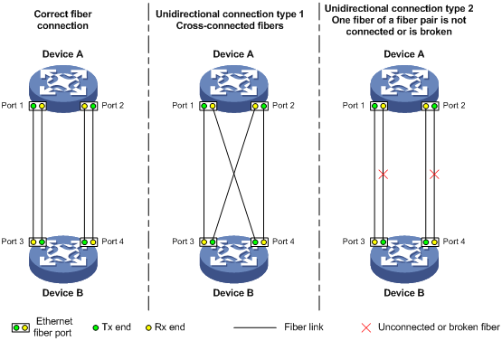

Unidirectional links occur when one end of a link can receive packets from the other end, but the other end cannot receive packets sent by the first end.
Unidirectional fiber links occur in the following cases:
·     Fibers are cross-connected.
·     A fiber is not connected at one end or one fiber of a fiber pair is broken.
Figure 1 shows a correct fiber connection and the two types of unidirectional fiber connections.
Figure 1 Correct and incorrect fiber connections

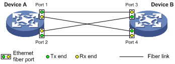

Figure 2 Cross-connected fibers
As shown in Figure 2, before you enable DLDP, the optical fibers between Device A and Device B are cross-connected. After you enable DLDP, the four ports are all up and in Unidirectional state, and they send RecoverProbe packets. Take Port 1 as an example to illustrate the unidirectional link detection process.
a.     Port 1 receives the RecoverProbe packet from Port 4, and returns a RecoverEcho packet.
b.     Port 4 cannot receive any RecoverEcho packet from Port 1, so Port 4 cannot become the neighbor of Port 1.
c.     Port 3 can receive the RecoverEcho packet from Port 1, but Port 3 is not the intended destination, so Port 3 cannot become the neighbor of Port 1.
The same process occurs on the other three ports. The four ports are all in Unidirectional state.

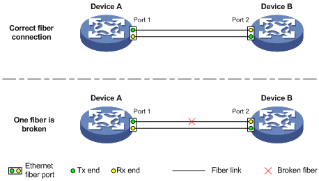

Figure 3 Broken fiber
As shown in Figure 3, Device and Device B are connected through an optical fiber. After you enable DLDP, Port 1 and Port 2 establish the bidirectional neighborship in the following way:
a.     Port 1 that is physically up enters the Unidirectional state and sends a RecoverProbe packet.
b.     After receiving the RecoverProbe packet, Port 2 returns a RecoverEcho packet.
c.     After Port 1 receives the RecoverEcho packet and detects that the neighbor information in the packet matches the local information, Port 1 establishes the neighborship with Port 2 and transits to the Bidirectional state. Port 1 then starts the Entry timer and periodically sends Advertisement packets.
d.     After Port 2 receives the Advertisement packet, it establishes the Unconfirmed neighborship with Port 1. Port 2 then starts the Echo timer and Probe timer, and periodically sends Probe packets.
e.     After receiving the Probe packet, Port 1 returns an Echo packet.
f.     After Port 2 receives the Echo packet and detects that the neighbor information in the packet matches the local information, the neighbor state of Port 1 becomes Confirmed. Port 2 then transits to the Bidirectional state, starts the Entry timer, and periodically sends Advertisement packets.
The bidirectional neighborship between Port 1 and Port 2 is now established.
After that, when Port 2's Rx end fails to receive signals, Port 2 is physically down and enters the Inactive state. Because Port 2's Tx end can still send signals to Port 1, Port 1 stays up. After the Entry timer for Port 2 expires, Port 1 starts the Enhanced timer and Echo timer, and sends a probe packet to Port 2. Because Port 1's Tx line is broken, Port 1 cannot receive the Echo packet from Port 2 after the Echo timer expires. Port 1 then enters the Unidirectional state, and sends a Disable packet to Port 2. At the same time, Port 1 deletes the neighborship with Port 2, and starts the RecoverProbe timer. Port 2 stays in Inactive state during this process.

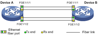

As shown in Figure 5, Device A and Device B are connected with two fiber pairs.
Configure DLDP to automatically shut down the faulty port upon detecting a unidirectional link, and automatically bring up the port after you clear the fault.
Figure 5 Network diagram

Network requirements
As shown in Figure 6, Device A and Device B are connected with two fiber pairs.
Configure DLDP to detect unidirectional links. When a unidirectional link is detected, the administrator must manually shut down the port.
Figure 6 Network diagram
Configuration procedure
