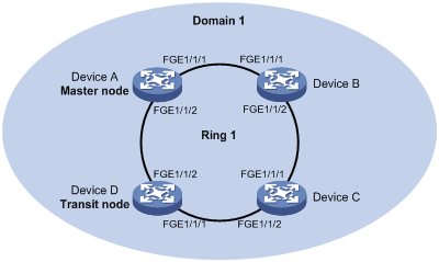

Figure 1 shows a typical RRPP network with two Ethernet rings and multiple nodes. RRPP detects ring status and sends topology change information by exchanging Rapid Ring Protection Protocol Data Units (RRPPDUs) among the nodes.
Figure 1 RRPP networking diagram

As shown in Figure 1, Domain 1 is an RRPP domain, containing two RRPP rings: Ring 1 and Ring 2. All the nodes on the two RRPP rings belong to the RRPP domain.

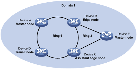

As shown in Figure 1, Ring 1 is the primary ring and Ring 2 is a subring. Device A is the master node of Ring 1. Device B, Device C, and Device D are the transit nodes of Ring 1. Device E is the master node of Ring 2, Device B is the edge node of Ring 2, and Device C is the assistant edge node of Ring 2.

As shown in Figure 1, Device A is the master node of Ring 1. Port 1 and Port 2 are the primary port and the secondary port of the master node on Ring 1, respectively. Device B, Device C, and Device D are the transit nodes of Ring 1. Their Port 1 and Port 2 are the primary port and the secondary port on Ring 1, respectively.

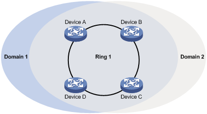

You can configure multiple RRPP domains for a ring network. Each RRPP domain transmits the traffic from the specified VLANs (protected VLANs). Traffic from different VLANs can be transmitted according to different topologies in the ring network for load balancing.
As shown in Figure 6, Ring 1 is configured as the primary ring of Domain 1 and Domain 2, which are configured with different protected VLANs. Device A is the master node of Ring 1 in Domain 1. Device B is the master node of Ring 1 in Domain 2. With such configurations, traffic from different VLANs can be transmitted on different links for load balancing in the single-ring network.

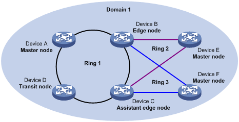

Broadcast storm suppression mechanism in case of SRPT failure in a multi-homed subring

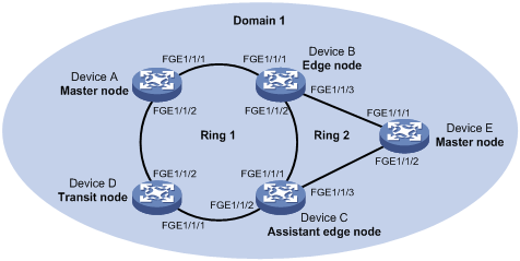

As shown in Figure 5, Ring 1 is the primary ring, and Ring 2 and Ring 3 are subrings. When the two SRPTs between the edge node and the assistant edge node are down, the master nodes of Ring 2 and Ring 3 will open their secondary ports. A loop is generated among Device B, Device C, Device E, and Device F, causing a broadcast storm.
To avoid generating a loop, the edge node will temporarily block the edge port. The blocked edge port is activated only when the edge node determines that no loop will be generated when the edge port is activated.
RRPP ring group
In an edge node RRPP ring group, only the activated subring with the smallest domain ID and ring ID can send Edge-Hello packets. In an assistant edge node RRPP ring group, any activated subring that has received Edge-Hello packets will forward these packets to the other activated subrings. When an edge node RRPP ring group and an assistant edge node RRPP ring group are configured, the CPU workload is reduced because of the following reasons:
·     Only one subring sends Edge-Hello packets on the edge node.
·     Only one subring receives Edge-Hello packets on the assistant edge node.
As shown in Figure 5, Device B is the edge node of Ring 2 and Ring 3. Device C is the assistant edge node of Ring 2 and Ring 3. Device B and Device C need to send or receive Edge-Hello packets frequently. If more subrings are configured or more domains are configured for load balancing, Device B and Device C will send or receive a large number of Edge-Hello packets.
To reduce Edge-Hello traffic, perform the following tasks:
·     Assign Ring 2 and Ring 3 to an RRPP ring group configured on the edge node Device B.
·     Assign Ring 2 and Ring 3 to an RRPP ring group configured on the assistant edge node Device C.
If all rings are activated, only Ring 2 on Device B sends Edge-Hello packets.

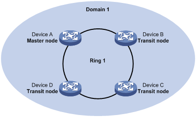

Single ring
As shown in Figure 2, only a single ring exists in the network topology. You need only define an RRPP domain.
Figure 2 Schematic diagram for a single-ring network

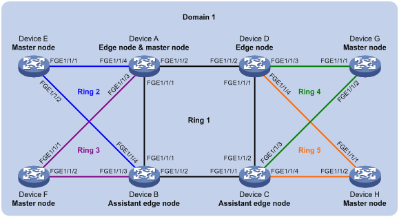

Tangent rings

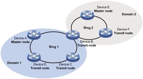

As shown in Figure 3, two or more rings exist in the network topology and only one common node exists between rings. You must define an RRPP domain for each ring.
Figure 3 Schematic diagram for a tangent-ring network

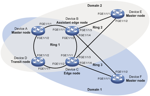

Intersecting rings
As shown in Figure 4, two or more rings exist in the network topology and two common nodes exist between rings. You need only define an RRPP domain and configure one ring as the primary ring and the other rings as subrings.
Figure 4 Schematic diagram for an intersecting-ring network
Dual-homed rings
As shown in Figure 5, two or more rings exist in the network topology and two similar common nodes exist between rings. You need only define an RRPP domain and configure one ring as the primary ring and the other rings as subrings.
Figure 5 Schematic diagram for a dual-homed-ring network

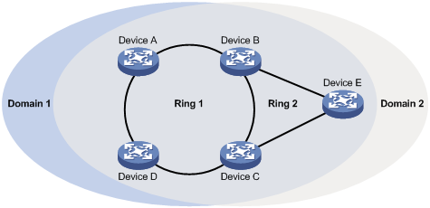

Single-ring load balancing
In a single-ring network, you can achieve load balancing by configuring multiple domains.
As shown in Figure 6:
·     Ring 1 is configured as the primary ring of both Domain 1 and Domain 2.
·     Domain 1 and Domain 2 are configured with different protected VLANs.
·     In Domain 1, Device A is configured as the master node of Ring 1.
·     In Domain 2, Device B is configured as the master node of Ring 1.
Such configurations enable the ring to block different links based on VLANs and achieve single-ring load balancing.
Figure 6 Schematic diagram for a single-ring load balancing network

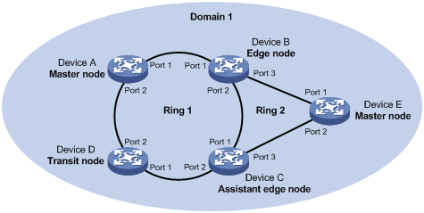

Intersecting-ring load balancing
In an intersecting-ring network, you can also achieve load balancing by configuring multiple domains.
As shown in Figure 7:
·     Ring 1 is the primary ring and Ring 2 is the subring in both Domain 1 and Domain 2.
·     Device A is configured as the master node of Ring 1 in Domain 1.
·     Device D is configured as the master node of Ring 1 in Domain 2.
·     Device E is configured as the master node of Ring 2 in both Domain 1 and Domain 2. However, different ports on Device E are blocked in Domain 1 and Domain 2.
With the configurations, you can enable traffic from different VLANs to travel over different paths in the subring and primary ring, achieving intersecting-ring load balancing.
Figure 7 Schematic diagram for an intersecting-ring load balancing network

Single ring configuration example
Network requirements
As shown in Figure 8:
·     Device A, Device B, Device C, and Device D form RRPP domain 1. Specify the primary control VLAN of RRPP domain 1 as VLAN 4092. Specify the protected VLANs of RRPP domain 1 as VLANs 1 through 30.
·     Device A, Device B, Device C, and Device D form primary ring 1.
·     Specify Device A as the master node of primary ring 1, FortyGigE 1/1/1 as the primary port, and FortyGigE 1/1/2 as the secondary port.
·     Specify Device B, Device C, and Device D as the transit nodes of primary ring 1. Specify FortyGigE 1/1/1 as the primary port and FortyGigE 1/1/2 as the secondary port on Device B, Device C, and Device D.
Figure 8 Network diagram
Configuration procedure
1.     Configure Device A:
# Create VLANs 1 through 30.
<DeviceA> system-view
[DeviceA] vlan 1 to 30
# Map these VLANs to MSTI 1.
[DeviceA] stp region-configuration
[DeviceA-mst-region] instance 1 vlan 1 to 30
# Activate the MST region configuration.
[DeviceA-mst-region] active region-configuration
[DeviceA-mst-region] quit
# Set the physical state change suppression interval to 0 seconds on FortyGigE 1/1/1.
[DeviceA] interface fortygige 1/1/1
[DeviceA-FortyGigE1/1/1] link-delay 0
# Disable the spanning tree feature on the port.
[DeviceA-FortyGigE1/1/1] undo stp enable
# Configure the port as a trunk port.
[DeviceA-FortyGigE1/1/1] port link-type trunk
# Assign the port to VLANs 1 through 30.
[DeviceA-FortyGigE1/1/1] port trunk permit vlan 1 to 30
[DeviceA-FortyGigE1/1/1] quit
# Configure FortyGigE 1/1/2 in the same way FortyGigE 1/1/1 is configured.
[DeviceA] interface fortygige 1/1/2
[DeviceA-FortyGigE1/1/2] link-delay 0
[DeviceA-FortyGigE1/1/2] undo stp enable
[DeviceA-FortyGigE1/1/2] port link-type trunk
[DeviceA-FortyGigE1/1/2] port trunk permit vlan 1 to 30
[DeviceA-FortyGigE1/1/2] quit
# Create RRPP domain 1.
[DeviceA] rrpp domain 1
# Configure VLAN 4092 as the primary control VLAN of RRPP domain 1.
[DeviceA-rrpp-domain1] control-vlan 4092
# Configure the VLANs mapped to MSTI 1 as the protected VLANs of RRPP domain 1.
[DeviceA-rrpp-domain1] protected-vlan reference-instance 1
# Configure Device A as the master node of primary ring 1, with FortyGigE 1/1/1 as the primary port and FortyGigE 1/1/2 as the secondary port. Enable ring 1.
[DeviceA-rrpp-domain1] ring 1 node-mode master primary-port fortygige 1/1/1 secondary-port fortygige 1/1/2 level 0
[DeviceA-rrpp-domain1] ring 1 enable
[DeviceA-rrpp-domain1] quit
# Enable RRPP.
[DeviceA] rrpp enable

Intersecting ring configuration example
As shown in Figure 9:
·     Device A, Device B, Device C, Device D, and Device E form RRPP domain 1. VLAN 4092 is the primary control VLAN of RRPP domain 1. RRPP domain 1 protects VLANs 1 through 30.
·     Device A, Device B, Device C, and Device D form primary ring 1. Device B, Device C, and Device E form subring 2.
·     Device A is the master node of primary ring 1, with FortyGigE 1/1/1 as the primary port and FortyGigE 1/1/2 the secondary port.
·     Device E is the master node of subring 2, with FortyGigE 1/1/1 as the primary port and FortyGigE 1/1/2 the secondary port.
·     Device B is the transit node of primary ring 1 and the edge node of subring 2, with FortyGigE 1/1/3 as the edge port.
·     Device C is the transit node of primary ring 1 and the assistant edge node of subring 1, with FortyGigE 1/1/3 as the edge port.
·     Device D is the transit node of primary ring 1, with FortyGigE 1/1/1 as the primary port and FortyGigE 1/1/2 the secondary port.
Figure 9 Network diagram

Dual-homed rings configuration example
As shown in Figure 10:
·     Device A through Device H form RRPP domain 1. Specify the primary control VLAN of RRPP domain 1 as VLAN 4092. Specify the protected VLANs of RRPP domain 1 as VLANs 1 through 30.
·     Device A through Device D form primary ring 1. Device A, Device B, and Device E form subring 2. Device A, Device B, and Device F form subring 3. Device C, Device D, and Device G form subring 4. Device C, Device D, and Device H form subring 5.
·     Specify Device A, Device E, Device F, Device G, and Device H as the master nodes of Ring 1, Ring 2, Ring 3, Ring 4, and Ring 5, respectively. Specify FortyGigE 1/1/1 as the primary port and FortyGigE 1/1/2 as the secondary port on the rings.
·     Specify Device A as the edge node of the connected subrings, its FortyGigE 1/1/3 and FortyGigE 1/1/4 as the edge ports. Specify Device D as the transit node of the primary ring and edge node of the connected subrings, its FortyGigE 1/1/3 and FortyGigE 1/1/4 as the edge ports. Specify Device B and Device C as the transit node of the primary ring and assistant edge nodes of the connected subrings, their FortyGigE 1/1/3 and FortyGigE 1/1/4 as the edge ports.
IMPORTANT
IMPORTANT:
Configure the primary and secondary ports on the master nodes correctly to make sure other protocols still operate correctly when data VLANs are denied by the secondary ports.
Figure 10 Network diagram
# Configure Device A as the edge node of subring 2, with FortyGigE 1/1/4 as the edge port. Enable subring 2.
[DeviceA-rrpp-domain1] ring 2 node-mode edge edge-port fortygige 1/1/4
[DeviceA-rrpp-domain1] ring 2 enable
# Configure Device A as the edge node of subring 3, with FortyGigE 1/1/3 as the edge port. Enable subring 3.
[DeviceA-rrpp-domain1] ring 3 node-mode edge edge-port fortygige 1/1/3
[DeviceA-rrpp-domain1] ring 3 enable
# Enable RRPP.
2.     Configure Device B:
<DeviceB> system-view
[DeviceB] vlan 1 to 30
[DeviceB] stp region-configuration
[DeviceB-mst-region] instance 1 vlan 1 to 30
[DeviceB-mst-region] active region-configuration
[DeviceB-mst-region] quit
[DeviceB] interface fortygige 1/1/1
[DeviceB-FortyGigE1/1/1] link-delay 0
[DeviceB-FortyGigE1/1/1] undo stp enable
[DeviceB-FortyGigE1/1/1] port link-type trunk
[DeviceB-FortyGigE1/1/1] port trunk permit vlan 1 to 30
[DeviceB-FortyGigE1/1/1] quit
[DeviceB] interface fortygige 1/1/2
[DeviceB-FortyGigE1/1/2] link-delay 0
[DeviceB-FortyGigE1/1/2] undo stp enable
[DeviceB-FortyGigE1/1/2] port link-type trunk
[DeviceB-FortyGigE1/1/2] port trunk permit vlan 1 to 30
[DeviceB-FortyGigE1/1/2] quit
# Configure FortyGigE 1/1/3 in the same way FortyGigE 1/1/1 is configured.
[DeviceB] interface fortygige 1/1/3
[DeviceB-FortyGigE1/1/3] link-delay 0
[DeviceB-FortyGigE1/1/3] undo stp enable
[DeviceB-FortyGigE1/1/3] port link-type trunk
[DeviceB-FortyGigE1/1/3] port trunk permit vlan 1 to 30
[DeviceB-FortyGigE1/1/3] quit
# Configure FortyGigE 1/1/4 in the same way FortyGigE 1/1/1 is configured.
[DeviceB] interface fortygige 1/1/4
[DeviceB-FortyGigE1/1/4] link-delay 0
[DeviceB-FortyGigE1/1/4] undo stp enable
[DeviceB-FortyGigE1/1/4] port link-type trunk
[DeviceB-FortyGigE1/1/4] port trunk permit vlan 1 to 30
[DeviceB-FortyGigE1/1/4] quit
[DeviceB] rrpp domain 1
[DeviceB-rrpp-domain1] control-vlan 4092
[DeviceB-rrpp-domain1] protected-vlan reference-instance 1
# Configure Device B as the transit node of primary ring 1, with FortyGigE 1/1/1 as the primary port and FortyGigE 1/1/2 as the secondary port. Enable ring 1.
[DeviceB-rrpp-domain1] ring 1 node-mode transit primary-port fortygige 1/1/1 secondary-port fortygige 1/1/2 level 0
[DeviceB-rrpp-domain1] ring 1 enable
# Configure Device B as the assistant edge node of subring 2, with FortyGigE 1/1/4 as the edge port. Enable subring 2.
[DeviceB-rrpp-domain1] ring 2 node-mode assistant-edge edge-port fortygige 1/1/4
[DeviceB-rrpp-domain1] ring 2 enable
# Configure Device B as the assistant edge node of subring 3, with FortyGigE 1/1/3 as the edge port. Enable subring 3.
[DeviceB-rrpp-domain1] ring 3 node-mode assistant-edge edge-port fortygige 1/1/3
[DeviceB-rrpp-domain1] ring 3 enable
[DeviceB-rrpp-domain1] quit
# Enable RRPP.
[DeviceB] rrpp enable
3.     Configure Device C:
<DeviceC> system-view
[DeviceC] vlan 1 to 30
[DeviceC] stp region-configuration
[DeviceC-mst-region] instance 1 vlan 1 to 30
[DeviceC-mst-region] active region-configuration
[DeviceC-mst-region] quit
[DeviceC] interface fortygige 1/1/1
[DeviceC-FortyGigE1/1/1] link-delay 0
[DeviceC-FortyGigE1/1/1] undo stp enable
[DeviceC-FortyGigE1/1/1] port link-type trunk
[DeviceC-FortyGigE1/1/1] port trunk permit vlan 1 to 30
[DeviceC-FortyGigE1/1/1] quit
[DeviceC] interface fortygige 1/1/2
[DeviceC-FortyGigE1/1/2] link-delay 0
[DeviceC-FortyGigE1/1/2] undo stp enable
[DeviceC-FortyGigE1/1/2] port link-type trunk
[DeviceC-FortyGigE1/1/2] port trunk permit vlan 1 to 30
[DeviceC-FortyGigE1/1/2] quit
[DeviceC] interface fortygige 1/1/3
[DeviceC-FortyGigE1/1/3] link-delay 0
[DeviceC-FortyGigE1/1/3] undo stp enable
[DeviceC-FortyGigE1/1/3] port link-type trunk
[DeviceC-FortyGigE1/1/3] port trunk permit vlan 1 to 30
[DeviceC-FortyGigE1/1/3] quit
[DeviceC] interface fortygige 1/1/4
[DeviceC-FortyGigE1/1/4] link-delay 0
[DeviceC-FortyGigE1/1/4] undo stp enable
[DeviceC-FortyGigE1/1/4] port link-type trunk
[DeviceC-FortyGigE1/1/4] port trunk permit vlan 1 to 30
[DeviceC-FortyGigE1/1/4] quit
[DeviceC] rrpp domain 1
[DeviceC-rrpp-domain1] control-vlan 4092
[DeviceC-rrpp-domain1] protected-vlan reference-instance 1
# Configure Device C as the transit node of primary ring 1, with FortyGigE 1/1/1 as the primary port and FortyGigE 1/1/2 as the secondary port. Enable ring 1.
[DeviceC-rrpp-domain1] ring 1 node-mode transit primary-port fortygige 1/1/1 secondary-port fortygige 1/1/2 level 0
[DeviceC-rrpp-domain1] ring 1 enable
# Configure Device C as the assistant edge node of subring 4, with FortyGigE 1/1/3 as the edge port. Enable subring 4.
[DeviceC-rrpp-domain1] ring 4 node-mode assistant-edge edge-port fortygige 1/1/3
[DeviceC-rrpp-domain1] ring 4 enable
# Configure Device C as the assistant edge node of subring 5, with FortyGigE 1/1/4 as the edge port. Enable subring 5.
[DeviceC-rrpp-domain1] ring 5 node-mode assistant-edge edge-port fortygige 1/1/4
[DeviceC-rrpp-domain1] ring 5 enable
[DeviceC-rrpp-domain1] quit
# Enable RRPP.
[DeviceC] rrpp enable
4.     Configure Device D:
<DeviceD> system-view
[DeviceD] vlan 1 to 30
[DeviceD] stp region-configuration
[DeviceD-mst-region] instance 1 vlan 1 to 30
[DeviceD-mst-region] active region-configuration
[DeviceD-mst-region] quit
[DeviceD] interface fortygige 1/1/1
[DeviceD-FortyGigE1/1/1] link-delay 0
[DeviceD-FortyGigE1/1/1] undo stp enable
[DeviceD-FortyGigE1/1/1] port link-type trunk
[DeviceD-FortyGigE1/1/1] port trunk permit vlan 1 to 30
[DeviceD-FortyGigE1/1/1] quit
[DeviceD] interface fortygige 1/1/2
[DeviceD-FortyGigE1/1/2] link-delay 0
[DeviceD-FortyGigE1/1/2] undo stp enable
[DeviceD-FortyGigE1/1/2] port link-type trunk
[DeviceD-FortyGigE1/1/2] port trunk permit vlan 1 to 30
[DeviceD-FortyGigE1/1/2] quit
[DeviceD] interface fortygige 1/1/3
[DeviceD-FortyGigE1/1/3] link-delay 0
[DeviceD-FortyGigE1/1/3] undo stp enable
[DeviceD-FortyGigE1/1/3] port link-type trunk
[DeviceD-FortyGigE1/1/3] port trunk permit vlan 1 to 30
[DeviceD-FortyGigE1/1/3] quit
[DeviceD] interface fortygige 1/1/4
[DeviceD-FortyGigE1/1/4] link-delay 0
[DeviceD-FortyGigE1/1/4] undo stp enable
[DeviceD-FortyGigE1/1/4] port link-type trunk
[DeviceD-FortyGigE1/1/4] port trunk permit vlan 1 to 30
[DeviceD-FortyGigE1/1/4] quit
[DeviceD] rrpp domain 1
[DeviceD-rrpp-domain1] control-vlan 4092
[DeviceD-rrpp-domain1] protected-vlan reference-instance 1
# Configure Device D as the transit node of primary ring 1, with FortyGigE 1/1/1 as the primary port and FortyGigE 1/1/2 as the secondary port. Enable ring 1.
[DeviceD-rrpp-domain1] ring 1 node-mode transit primary-port fortygige 1/1/1 secondary-port fortygige 1/1/2 level 0
[DeviceD-rrpp-domain1] ring 1 enable
# Configure Device D as the edge node of subring 4, with FortyGigE 1/1/3 as the edge port. Enable subring 4.
[DeviceD-rrpp-domain1] ring 4 node-mode edge edge-port fortygige 1/1/3
[DeviceD-rrpp-domain1] ring 4 enable
# Configure Device D as the edge node of subring 5, with FortyGigE 1/1/4 as the edge port. Enable subring 5.
[DeviceD-rrpp-domain1] ring 5 node-mode edge edge-port fortygige 1/1/4
[DeviceD-rrpp-domain1] ring 5 enable
[DeviceD-rrpp-domain1] quit
# Enable RRPP.
[DeviceD] rrpp enable
5.     Configure Device E:
<DeviceE> system-view
[DeviceE] vlan 1 to 30
[DeviceE] stp region-configuration
[DeviceE-mst-region] instance 1 vlan 1 to 30
[DeviceE-mst-region] active region-configuration
[DeviceE-mst-region] quit
[DeviceE] interface fortygige 1/1/1
[DeviceE-FortyGigE1/1/1] link-delay 0
[DeviceE-FortyGigE1/1/1] undo stp enable
[DeviceE-FortyGigE1/1/1] port link-type trunk
[DeviceE-FortyGigE1/1/1] port trunk permit vlan 1 to 30
[DeviceE-FortyGigE1/1/1] quit
[DeviceE] interface fortygige 1/1/2
[DeviceE-FortyGigE1/1/2] link-delay 0
[DeviceE-FortyGigE1/1/2] undo stp enable
[DeviceE-FortyGigE1/1/2] port link-type trunk
[DeviceE-FortyGigE1/1/2] port trunk permit vlan 1 to 30
[DeviceE-FortyGigE1/1/2] quit
[DeviceE] rrpp domain 1
[DeviceE-rrpp-domain1] control-vlan 4092
[DeviceE-rrpp-domain1] protected-vlan reference-instance 1
# Configure Device E as the master node of subring 2, with FortyGigE 1/1/1 as the primary port and FortyGigE 1/1/2 as the secondary port. Enable subring 2.
[DeviceE-rrpp-domain1] ring 2 node-mode master primary-port fortygige 1/1/1 secondary-port fortygige 1/1/2 level 1
[DeviceE-rrpp-domain1] ring 2 enable
[DeviceE-rrpp-domain1] quit
# Enable RRPP.
[DeviceE] rrpp enable
6.     Configure Device F:
<DeviceF> system-view
[DeviceF] vlan 1 to 30
[DeviceF] stp region-configuration
[DeviceF-mst-region] instance 1 vlan 1 to 30
[DeviceF-mst-region] active region-configuration
[DeviceF-mst-region] quit
[DeviceF] interface fortygige 1/1/1
[DeviceF-FortyGigE1/1/1] link-delay 0
[DeviceF-FortyGigE1/1/1] undo stp enable
[DeviceF-FortyGigE1/1/1] port link-type trunk
[DeviceF-FortyGigE1/1/1] port trunk permit vlan 1 to 30
[DeviceF-FortyGigE1/1/1] quit
[DeviceF] interface fortygige 1/1/2
[DeviceF-FortyGigE1/1/2] link-delay 0
[DeviceF-FortyGigE1/1/2] undo stp enable
[DeviceF-FortyGigE1/1/2] port link-type trunk
[DeviceF-FortyGigE1/1/2] port trunk permit vlan 1 to 30
[DeviceF-FortyGigE1/1/2] quit
[DeviceF] rrpp domain 1
[DeviceF-rrpp-domain1] control-vlan 4092
[DeviceF-rrpp-domain1] protected-vlan reference-instance 1
# Configure Device F as the master node of subring 3, with FortyGigE 1/1/1 as the primary port and FortyGigE 1/1/2 as the secondary port. Enable subring 3.
[DeviceG] rrpp domain 1
[DeviceG-rrpp-domain1] control-vlan 4092
[DeviceG-rrpp-domain1] protected-vlan reference-instance 1
# Configure Device G as the master node of subring 4, with FortyGigE 1/1/1 as the primary port and FortyGigE 1/1/2 as the secondary port. Enable subring 4.
[DeviceG-rrpp-domain1] ring 4 node-mode master primary-port fortygige 1/1/1 secondary-port fortygige 1/1/2 level 1
[DeviceG-rrpp-domain1] ring 4 enable
[DeviceG-rrpp-domain1] quit
# Enable RRPP.
[DeviceG] rrpp enable
8.     Configure Device H:
<DeviceH> system-view
[DeviceH] vlan 1 to 30
[DeviceH] stp region-configuration
[DeviceH-mst-region] instance 1 vlan 1 to 30
[DeviceH-mst-region] active region-configuration
[DeviceH-mst-region] quit
[DeviceH] interface fortygige 1/1/1
[DeviceH-FortyGigE1/1/1] link-delay 0
[DeviceH-FortyGigE1/1/1] undo stp enable
[DeviceH-FortyGigE1/1/1] port link-type trunk
[DeviceH-FortyGigE1/1/1] port trunk permit vlan 1 to 30
[DeviceH-FortyGigE1/1/1] quit
[DeviceH] interface fortygige 1/1/2
[DeviceH-FortyGigE1/1/2] link-delay 0
[DeviceH-FortyGigE1/1/2] undo stp enable
[DeviceH-FortyGigE1/1/2] port link-type trunk
[DeviceH-FortyGigE1/1/2] port trunk permit vlan 1 to 30
[DeviceH-FortyGigE1/1/2] quit
[DeviceH] rrpp domain 1
[DeviceH-rrpp-domain1] control-vlan 4092
[DeviceH-rrpp-domain1] protected-vlan reference-instance 1
# Configure Device H as the master node of subring 5, with FortyGigE 1/1/1 as the primary port and FortyGigE 1/1/2 as the secondary port. Enable subring 5.
[DeviceH-rrpp-domain1] ring 5 node-mode master primary-port fortygige 1/1/1 secondary-port fortygige 1/1/2 level 1
[DeviceH-rrpp-domain1] ring 5 enable
[DeviceH-rrpp-domain1] quit
# Enable RRPP.
[DeviceH] rrpp enable
# Use the display commands to view RRPP configuration and operational information on each device.
Load-balanced intersecting-ring configuration example
As shown in Figure 11:
·     Device A, Device B, Device C, Device D, and Device F form RRPP domain 1. VLAN 100 is the primary control VLAN of the RRPP domain. Device A is the master node of the primary ring, Ring 1. Device D is the transit node of Ring 1. Device F is the master node of the subring Ring 3. Device C is the edge node of the subring Ring 3. Device B is the assistant edge node of the subring Ring 3.
·     Device A, Device B, Device C, Device D, and Device E form RRPP domain 2. VLAN 105 is the primary control VLAN of the RRPP domain. Device A is the master node of the primary ring, Ring 1. Device D is the transit node of Ring 1. Device E is the master node of the subring Ring 2. Device C is the edge node of the subring Ring 2. Device B is the assistant edge node of the subring Ring 2.
·     Specify VLAN 11 as the protected VLAN of domain 1, and VLAN 12 the protected VLAN of domain 2. You can implement VLAN-based load balancing on Ring 1.
·     Ring 2 and Ring 3 have the same edge node and assistant edge node, and the two subrings have the same SRPTs. You can add Ring 2 and Ring 3 to an RRPP ring group to reduce Edge-Hello traffic.
Figure 11 Network diagram
# Create VLANs 11 and 12.
[DeviceA] vlan 11 to 12
# Map VLAN 11 to MSTI 1 and VLAN 12 to MSTI 2.
[DeviceA-mst-region] instance 1 vlan 11
[DeviceA-mst-region] instance 2 vlan 12
# Remove the port from VLAN 1, and assign it to VLANs 11 and 12.
[DeviceA-FortyGigE1/1/1] undo port trunk permit vlan 1
[DeviceA-FortyGigE1/1/1] port trunk permit vlan 11 12
# Configure VLAN 11 as the default VLAN.
[DeviceA-FortyGigE1/1/1] port trunk pvid vlan 11
[DeviceA-FortyGigE1/1/2] undo port trunk permit vlan 1
[DeviceA-FortyGigE1/1/2] port trunk permit vlan 11 12
[DeviceA-FortyGigE1/1/2] port trunk pvid vlan 11
# Configure VLAN 100 as the primary control VLAN of RRPP domain 1.
[DeviceA-rrpp-domain1] control-vlan 100
# Configure the VLAN mapped to MSTI 1 as the protected VLAN of RRPP domain 1.
# Create RRPP domain 2.
[DeviceA] rrpp domain 2
# Configure VLAN 105 as the primary control VLAN of RRPP domain 2.
[DeviceA-rrpp-domain2] control-vlan 105
# Configure the VLAN mapped to MSTI 2 as the protected VLAN of RRPP domain 2.
[DeviceA-rrpp-domain2] protected-vlan reference-instance 2
# Configure Device A as the master node of primary ring 1, with FortyGigE 1/1/2 as the master port and FortyGigE 1/1/1 as the secondary port. Enable ring 1.
[DeviceA-rrpp-domain2] ring 1 node-mode master primary-port fortygige 1/1/2 secondary-port fortygige 1/1/1 level 0
[DeviceA-rrpp-domain2] ring 1 enable
[DeviceA-rrpp-domain2] quit
# Enable RRPP.
[DeviceB] vlan 11 to 12
[DeviceB-mst-region] instance 1 vlan 11
[DeviceB-mst-region] instance 2 vlan 12
[DeviceB-FortyGigE1/1/1] undo port trunk permit vlan 1
[DeviceB-FortyGigE1/1/1] port trunk permit vlan 11 12
[DeviceB-FortyGigE1/1/1] port trunk pvid vlan 11
[DeviceB-FortyGigE1/1/2] undo port trunk permit vlan 1
[DeviceB-FortyGigE1/1/2] port trunk permit vlan 11 12
[DeviceB-FortyGigE1/1/2] port trunk pvid vlan 11
# Set the physical state change suppression interval to 0 seconds on FortyGigE 1/1/3.
# Remove the port from VLAN 1, and assign it to VLAN 12.
[DeviceB-FortyGigE1/1/3] undo port trunk permit vlan 1
[DeviceB-FortyGigE1/1/3] port trunk permit vlan 12
# Configure VLAN 12 as the default VLAN.
[DeviceB-FortyGigE1/1/3] port trunk pvid vlan 12
# Set the physical state change suppression interval to 0 seconds on FortyGigE 1/1/4.
# Remove the port from VLAN 1, and assign it to VLAN 11.
[DeviceB-FortyGigE1/1/4] undo port trunk permit vlan 1
[DeviceB-FortyGigE1/1/4] port trunk permit vlan 11
[DeviceB-FortyGigE1/1/4] port trunk pvid vlan 11
[DeviceB-rrpp-domain1] control-vlan 100
# Configure Device B as a transit node of primary ring 1 in RRPP domain 1, with FortyGigE 1/1/1 as the primary port and FortyGigE 1/1/2 as the secondary port. Enable ring 1.
# Configure Device B as the assistant edge node of subring 3 in RRPP domain 1, with FortyGigE 1/1/4 as the edge port. Enable subring 3.
[DeviceB-rrpp-domain1] ring 3 node-mode assistant-edge edge-port fortygige 1/1/4
[DeviceB] rrpp domain 2
[DeviceB-rrpp-domain2] control-vlan 105
[DeviceB-rrpp-domain2] protected-vlan reference-instance 2
[DeviceB-rrpp-domain2] ring 1 node-mode transit primary-port fortygige 1/1/1 secondary-port fortygige 1/1/2 level 0
[DeviceB-rrpp-domain2] ring 1 enable
# Configure Device B as the assistant edge node of subring 2 in RRPP domain 2, with FortyGigE 1/1/3 as the edge port. Enable subring 2.
[DeviceB-rrpp-domain2] ring 2 node-mode assistant-edge edge-port fortygige 1/1/3
[DeviceB-rrpp-domain2] ring 2 enable
[DeviceC-rrpp-domain2] quit
# Enable RRPP.
[DeviceC-FortyGigE1/1/3] undo port trunk permit vlan 1
[DeviceC-FortyGigE1/1/3] port trunk permit vlan 12
[DeviceC-FortyGigE1/1/3] port trunk pvid vlan 12
[DeviceC-FortyGigE1/1/4] undo port trunk permit vlan 1
[DeviceC-FortyGigE1/1/4] port trunk permit vlan 11
[DeviceC-FortyGigE1/1/4] port trunk pvid vlan 11
[DeviceC-rrpp-domain1] control-vlan 100
# Configure Device C as the transit node of primary ring 1 in RRPP domain 1, with FortyGigE 1/1/1 as the primary port and FortyGigE 1/1/2 as the secondary port. Enable ring 1.
# Configure Device C as the edge node of subring 3 in RRPP domain 1, with FortyGigE 1/1/4 as the edge port. Enable subring 3.
[DeviceC-rrpp-domain1] ring 3 node-mode edge edge-port fortygige 1/1/4
[DeviceC-rrpp-domain1] ring 3 enable
[DeviceC] rrpp domain 2
[DeviceC-rrpp-domain2] control-vlan 105
[DeviceC-rrpp-domain2] protected-vlan reference-instance 2
# Configure Device C as the transit node of primary ring 1 in RRPP domain 2, with FortyGigE 1/1/1 as the primary port and FortyGigE 1/1/2 as the secondary port. Enable ring 1.
[DeviceC-rrpp-domain2] ring 1 node-mode transit primary-port fortygige 1/1/1 secondary-port fortygige 1/1/2 level 0
[DeviceC-rrpp-domain2] ring 1 enable
# Configure Device C as the edge node of subring 2 in RRPP domain 2, with FortyGigE 1/1/3 as the edge port. Enable subring 2.
[DeviceC-rrpp-domain2] ring 2 node-mode edge edge-port fortygige 1/1/3
[DeviceC-rrpp-domain2] ring 2 enable
# Enable RRPP.
[DeviceD] vlan 11 to 12
[DeviceD-mst-region] instance 1 vlan 11
[DeviceD-mst-region] instance 2 vlan 12
[DeviceD-FortyGigE1/1/1] undo port trunk permit vlan 1
[DeviceD-FortyGigE1/1/1] port trunk permit vlan 11 12
[DeviceD-FortyGigE1/1/1] port trunk pvid vlan 11
[DeviceD-FortyGigE1/1/2] undo port trunk permit vlan 1
[DeviceD-FortyGigE1/1/2] port trunk permit vlan 11 12
[DeviceD-FortyGigE1/1/2] port trunk pvid vlan 11
[DeviceD-rrpp-domain1] control-vlan 100
# Configure Device D as the transit node of primary ring 1 in RRPP domain 1, with FortyGigE 1/1/1 as the primary port and FortyGigE 1/1/2 as the secondary port. Enable ring 1.
[DeviceD] rrpp domain 2
[DeviceD-rrpp-domain2] control-vlan 105
[DeviceD-rrpp-domain2] protected-vlan reference-instance 2
# Configure Device D as the transit node of primary ring 1 in RRPP domain 2, with FortyGigE 1/1/1 as the primary port and FortyGigE 1/1/2 as the secondary port. Enable ring 1.
[DeviceD-rrpp-domain2] ring 1 node-mode transit primary-port fortygige 1/1/1 secondary-port fortygige 1/1/2 level 0
[DeviceD-rrpp-domain2] ring 1 enable
[DeviceD-rrpp-domain2] quit
# Enable RRPP.
# Create VLAN 12.
[DeviceE] vlan 12
# Map VLAN 12 to MSTI 2.
[DeviceE-vlan12] quit
[DeviceE-mst-region] instance 2 vlan 12
[DeviceE-FortyGigE1/1/1] undo port trunk permit vlan 1
[DeviceE-FortyGigE1/1/1] port trunk permit vlan 12
[DeviceE-FortyGigE1/1/1] port trunk pvid vlan 12
[DeviceE-FortyGigE1/1/2] undo port trunk permit vlan 1
[DeviceE-FortyGigE1/1/2] port trunk permit vlan 12
[DeviceE-FortyGigE1/1/2] port trunk pvid vlan 12
[DeviceE] rrpp domain 2
[DeviceE-rrpp-domain2] control-vlan 105
[DeviceE-rrpp-domain2] protected-vlan reference-instance 2
# Configure Device E as the master mode of subring 2 in RRPP domain 2, with FortyGigE 1/1/2 as the primary port and FortyGigE 1/1/1 as the secondary port. Enable ring 2.
[DeviceE-rrpp-domain2] ring 2 node-mode master primary-port fortygige 1/1/2 secondary-port fortygige 1/1/1 level 1
[DeviceE-rrpp-domain2] ring 2 enable
[DeviceE-rrpp-domain2] quit
# Enable RRPP.
# Create VLAN 11.
[DeviceF] vlan 11
[DeviceF-vlan11] quit
# Map VLAN 11 to MSTI 1.
[DeviceF-mst-region] instance 1 vlan 11
[DeviceF-FortyGigE1/1/1] undo port trunk permit vlan 1
[DeviceF-FortyGigE1/1/1] port trunk permit vlan 11
[DeviceF-FortyGigE1/1/1] port trunk pvid vlan 11
[DeviceF-FortyGigE1/1/2] undo port trunk permit vlan 1
[DeviceF-FortyGigE1/1/2] port trunk permit vlan 11
[DeviceF-FortyGigE1/1/2] port trunk pvid vlan 11
[DeviceF-rrpp-domain1] control-vlan 100
# Configure Device F as the master node of subring 3 in RRPP domain 1, with FortyGigE 1/1/1 as the primary port and FortyGigE 1/1/2 as the secondary port. Enable subring 3.
[DeviceF-rrpp-domain1] ring 3 node-mode master primary-port fortygige 1/1/1 secondary-port fortygige 1/1/2 level 1
[DeviceF-rrpp-domain1] ring 3 enable
[DeviceF-rrpp-domain1] quit
# Enable RRPP.
[DeviceF] rrpp enable
7.     Configure RRPP ring group settings on Device B and Device C:
# Create RRPP ring group 1 on Device B, and add subrings 2 and 3 to the RRPP ring group.
[DeviceB] rrpp ring-group 1
[DeviceB-rrpp-ring-group1] domain 2 ring 2
[DeviceB-rrpp-ring-group1] domain 1 ring 3
# Create RRPP ring group 1 on Device C, and add subrings 2 and 3 to the RRPP ring group.
[DeviceC] rrpp ring-group 1
[DeviceC-rrpp-ring-group1] domain 2 ring 2
[DeviceC-rrpp-ring-group1] domain 1 ring 3
