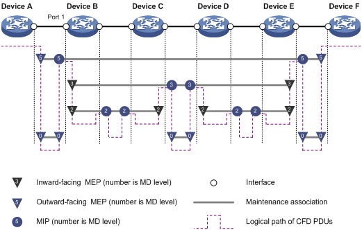

To accurately locate faults, CFD introduces eight levels (from 0 to 7) to MDs. The bigger the number, the higher the level and the larger the area covered. Domains can touch or nest (if the outer domain has a higher level than the nested one) but cannot intersect or overlap.
MD levels facilitate fault location and make fault location more accurate. As shown in Figure 1, MD_A in light blue nests MD_B in dark blue. If a connectivity fault is detected at the boundary of MD_A, any of the devices in MD_A, including Device A through Device E, might fail. If a connectivity fault is also detected at the boundary of MD_B, the failure points can be any of Device B through Device D. If the devices in MD_B can operate correctly, at least Device C is operational.
Figure 1 Two nested MDs
CFD exchanges messages and performs operations on a per-domain basis. By planning MDs correctly in a network, you can use CFD to rapidly locate failure points.

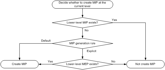

A MIP is internal to an MA. It cannot send CFD packets actively; however, it can handle and respond to CFD packets. By cooperating with MEPs, a MIP can perform a function similar to ping and traceroute. A MIP forwards packets of a different level without any processing and only processes packet of its level.
The MA to which a MIP belongs defines the VLAN of packets that the MIP can receive. The level of a MIP is defined by its generation rule and the MD to which the MIP belongs. MIPs are generated on each port automatically according to the following MIP generation rules:
¡     Default ruleIf no lower-level MIP exists on an interface, a MIP is created on the current level. A MIP can be created even if no MEP is configured on the interface.
¡     Explicit rule—If no lower-level MIP exists and a lower-level MEP exists on an interface, a MIP is created on the current level. A MIP can be created only when a lower-level MEP is created on the interface.
If a port has no MIP, the system will check the MAs in each MD (from low to high levels), and follow the procedure as described in Figure 2 to create or not to create MIPs at the current level.
Figure 2 Procedure of creating MIPs

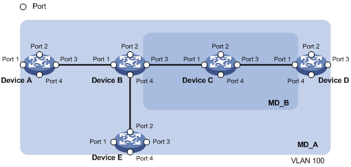

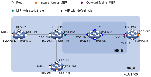

Figure 3 demonstrates a grading example of the CFD module. Four levels of MDs (0, 2, 3, and 5) are designed. The bigger the number, the higher the level and the larger the area covered. MPs are configured on the ports of Device A through Device F. Port 1 of Device B is configured with the following MPs: a level 5 MIP, a level 3 inward-facing MEP, a level 2 inward-facing MEP, and a level 0 outward-facing MEP.
Figure 3 CFD grading example

Network requirements
As shown in Figure 4:
·     The network comprises five devices and is divided into two MDs: MD_A (level 5) and MD_B (level 3). All ports belong to VLAN 100, and the MAs in the two MDs all serve VLAN 100. Assume that the MAC addresses of Device A through Device E are 0010-FC01-6511, 0010-FC02-6512, 0010-FC03-6513, 0010-FC04-6514, and 0010-FC05-6515, respectively.
·     MD_A has three edge ports: FortyGigE 1/1/1 on Device A, FortyGigE 1/1/3 on Device D, and FortyGigE 1/1/4 on Device E, and they are all inward-facing MEPs. MD_B has two edge ports: FortyGigE 1/1/3 on Device B and FortyGigE 1/1/1 on Device D, and they are both outward-facing MEPs.
·     In MD_A, Device B is designed to have MIPs when its port is configured with low level MEPs. Port FortyGigE 1/1/3 is configured with MEPs of MD_B, and the MIPs of MD_A can be configured on this port. You should configure the MIP generation rule of MD_A as explicit.
·     The MIPs of MD_B are designed on Device C, and are configured on all ports. You must configure the MIP generation rule as default.
·     Configure CC to monitor the connectivity among all the MEPs in MD_A and MD_B. Configure LB to locate link faults, and use the AIS and EAIS functions to suppress the error alarms that are reported.
·     After the status information for the entire network is obtained, use LT, LM, one-way DM, two-way DM, and TST to detect link faults.
Figure 4 Network diagram

4.     Configure MEPs:
# On Device A, configure a MEP list in service instance 1, and create inward-facing MEP 1001 in service instance 1 on FortyGigE 1/1/1.
[DeviceA] cfd meplist 1001 4002 5001 service-instance 1
[DeviceA] interface fortygige 1/1/1
[DeviceA-FortyGigE1/1/1] cfd mep 1001 service-instance 1 inbound
[DeviceA-FortyGigE1/1/1] quit
# On Device B, configure a MEP list in service instances 1 and 2.
[DeviceB] cfd meplist 1001 4002 5001 service-instance 1
[DeviceB] cfd meplist 2001 4001 service-instance 2
# Create outward-facing MEP 2001 in service instance 2 on FortyGigE 1/1/3.
[DeviceB] interface fortygige 1/1/3
[DeviceB-FortyGigE1/1/3] cfd mep 2001 service-instance 2 outbound
[DeviceB-FortyGigE1/1/3] quit
# On Device D, configure a MEP list in service instances 1 and 2.
[DeviceD] cfd meplist 1001 4002 5001 service-instance 1
[DeviceD] cfd meplist 2001 4001 service-instance 2
# Create outward-facing MEP 4001 in service instance 2 on FortyGigE 1/1/1.
[DeviceD] interface fortygige 1/1/1
[DeviceD-FortyGigE1/1/1] cfd mep 4001 service-instance 2 outbound
[DeviceD-FortyGigE1/1/1] quit
# Create inward-facing MEP 4002 in service instance 1 on FortyGigE 1/1/3.
[DeviceD] interface fortygige 1/1/3
[DeviceD-FortyGigE1/1/3] cfd mep 4002 service-instance 1 inbound
[DeviceD-FortyGigE1/1/3] quit
# On Device E, configure a MEP list in service instance 1.
[DeviceE] cfd meplist 1001 4002 5001 service-instance 1
# Create inward-facing MEP 5001 in service instance 1 on FortyGigE 1/1/4.
[DeviceE] interface fortygige 1/1/4
[DeviceE-FortyGigE1/1/4] cfd mep 5001 service-instance 1 inbound
[DeviceE-FortyGigE1/1/4] quit
5.     Configure MIPs:
# Configure the MIP generation rule in service instance 1 on Device B as explicit.
[DeviceB] cfd mip-rule explicit service-instance 1
# Configure the MIP generation rule in service instance 2 on Device C as default.
[DeviceC] cfd mip-rule default service-instance 2
