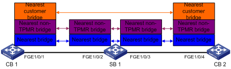

LLDP agent
An LLDP agent is a mapping of an entity where LLDP runs. Multiple LLDP agents can run on the same interface.
LLDP agents are divided into the following types:
·     Nearest bridge agent.
·     Nearest customer bridge agent.
·     Nearest non-TPMR bridge agent.
A Two-port MAC Relay (TPMR) is a type of bridge that has only two externally-accessible bridge ports, and supports a subset of the functions of a MAC bridge. A TPMR is transparent to all frame-based media-independent protocols except for the following:
·     Protocols destined to it.
·     Protocols destined to reserved MAC addresses that the relay function of the TPMR is configured not to forward.
LLDP exchanges packets between neighbor agents and creates and maintains neighbor information for them. Figure 1 shows the neighbor relationships for these LLDP agents. LLDP has two bridge modes: customer bridge (CB) and service bridge (SB).
Figure 1 LLDP neighbor relationships

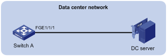

Figure 5 DCBX application scenario
DCBX enables lossless packet transmission on DCE networks.
As shown in Figure 5, DCBX applies to an FCoE-based data center network, and operates on an access switch. DCBX enables the switch to control the server's or disk device's adapter, and simplifies the configuration and guarantees configuration consistency. DCBX extends LLDP by using the IEEE 802.1 organizationally specific TLVs (DCBX TLVs) to transmit DCBX data, including:

Enabling LLDP and DCBX TLV advertising
To enable the device to advertise APP, ETS, and PFC data through an interface, perform the following tasks:
·     Enable LLDP globally.
·     Enable LLDP and DCBX TLV advertising on the interface.
To enable LLDP and DCBX TLV advertising:

DCBX configuration example
Network requirements
As shown in Figure 8, in a data center network, interface FortyGigE 1/1/1 of the access switch (Switch A) connects to the FCoE adapter of the data center server (DC server).
Configure Switch A to implement lossless FCoE and FIP frame transmission to DC server.
In this example, both Switch A and the DC server support DCBX Rev 1.01.
Figure 8 Network diagram
Configuration procedure
1.     Enable LLDP and DCBX TLV advertising:
# Enable LLDP globally.
<SwitchA> system-view
[SwitchA] lldp global enable
# Enable LLDP and DCBX TLV advertising on interface FortyGigE 1/1/1.
[SwitchA] interface fortygige 1/1/1
[SwitchA-FortyGigE1/1/1] lldp enable
[SwitchA-FortyGigE1/1/1] lldp tlv-enable dot1-tlv dcbx
[SwitchA-FortyGigE1/1/1] quit
2.     Configure APP parameters:
# Create Ethernet frame header ACL 4000.
[SwitchA] acl number 4000
# Configure ACL 4000 to permit FCoE frames (frame type is 0x8906) and FIP frames (frame type is 0x8914) to pass through.
[SwitchA-acl-ethernetframe-4000] rule permit type 8906 ffff
[SwitchA-acl-ethernetframe-4000] rule permit type 8914 ffff
[SwitchA-acl-ethernetframe-4000] quit
# Create a class named app_c, specify the operator of the class as OR, and use ACL 4000 as the match criterion of the class.
[SwitchA] traffic classifier app_c operator or
[SwitchA-classifier-app_c] if-match acl 4000
[SwitchA-classifier-app_c] quit
# Create a traffic behavior named app_b, and configure the traffic behavior to mark packets with 802.1p priority value 3.
[SwitchA] traffic behavior app_b
[SwitchA-behavior-app_b] remark dot1p 3
[SwitchA-behavior-app_b] quit
# Create a QoS policy named plcy, associate class app_c with traffic behavior app_b in the QoS policy, and apply the association to DCBX.
[SwitchA] qos policy plcy
[SwitchA-qospolicy-plcy] classifier app_c behavior app_b mode dcbx
[SwitchA-qospolicy-plcy] quit
# Apply the policy named plcy to the outgoing traffic of interface FortyGigE 1/1/1.
[SwitchA-FortyGigE1/1/1] qos apply policy plcy outbound
3.     Configure ETS parameters:
# Configure the 802.1p-to-local priority mapping table to map 802.1p priority value 3 to local precedence 3. (This is the default mapping table. You can modify this configuration as needed.)
[SwitchA] qos map-table dot1p-lp
[SwitchA-maptbl-dot1p-lp] import 3 export 3
[SwitchA-maptbl-dot1p-lp] quit
# Configure the interface FortyGigE 1/1/1 to trust the 802.1p priority carried in packets.
[SwitchA-FortyGigE1/1/1] qos trust dot1p
# Enable byte-count WRR queuing on interface FortyGigE 1/1/1, and configure queue 3 on the interface to use SP queuing.
[SwitchA-FortyGigE1/1/1] qos wrr byte-count
[SwitchA-FortyGigE1/1/1] qos wrr 3 group sp
4.     Enable interface FortyGigE 1/1/1 to automatically negotiate with its peer to decide whether to enable PFC, and enable PFC for 802.1 priority 3.
[SwitchA-FortyGigE1/1/1] priority-flow-control auto
[SwitchA-FortyGigE1/1/1] priority-flow-control no-drop dot1p 3

        Number of Traffic Classes Supported: 1
The output shows that the DC server will use PFC for 802.1p priority 3.
