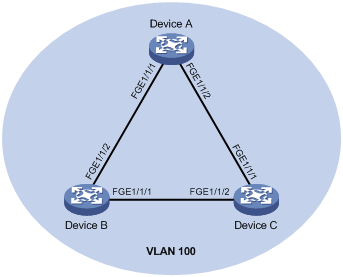

Loop detection configuration example
Network requirements
As shown in Figure 3, configure loop detection on Device A, so that Device A generates a log as a notification and automatically shuts down the port on which a loop is detected.
Figure 3 Network diagram

# View the system logs on devices, for example, Device A.
[DeviceA]
%Feb 24 15:04:29:663 2013 DeviceA LPDT/4/LPDT_LOOPED: Loopback exists on FortyGigE1/1/1.
%Feb 24 15:04:29:667 2013 DeviceA LPDT/4/LPDT_LOOPED: Loopback exists on FortyGigE1/1/2.
%Feb 24 15:04:44:243 2013 DeviceA LPDT/5/LPDT_RECOVERED: Loopback on FortyGigE1/1/1 recovered.
%Feb 24 15:04:44:248 2013 DeviceA LPDT/5/LPDT_RECOVERED: Loopback on FortyGigE1/1/2 recovered.
The output shows the following information:
·     Device A detects loops on ports FortyGigE 1/1/1 and FortyGigE 1/1/2 within a loop detection interval.
·     Device A automatically shuts down the ports and generates log messages.
# Use the display loopback-detection command to display the loop detection configuration and status on devices, for example, Device A.
[DeviceA] display loopback-detection
Loop detection is enabled.
Loop detection interval is 35 second(s).
No loopback is detected.
The output shows that the device has removed the loops from FortyGigE 1/1/1 and FortyGigE 1/1/2 according to the shutdown action.
# Display the status of FortyGigE 1/1/1 on devices, for example, Device A.
[DeviceA] display interface fortygige 1/1/1
FortyGigE1/1/1 current state: DOWN (Loop detection down)
The output shows that FortyGigE 1/1/1 is already shut down by the loop detection module.
# Display the status of FortyGigE 1/1/2 on Device A.
[DeviceA] display interface fortygige 1/1/2
FortyGigE1/1/2 current state: DOWN (Loop detection down)
The output shows that FortyGigE 1/1/2 is already shut down by the loop detection module.
