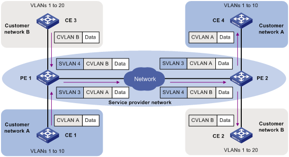

How QinQ works
As shown in Figure 1, a QinQ frame transmitted over the service provider network carries the following tags:
·     CVLAN tag—Identifies the VLAN to which the frame belongs when it is transmitted in the customer network.
·     SVLAN tag—Identifies the VLAN to which the QinQ frame belongs when it is transmitted in the service provider network. The service provider allocates the SVLAN tag to the customer.
The devices in the service provider network forward a tagged frame according to its SVLAN tag only. The CVLAN tag is transmitted as part of the frame's payload.
Figure 1 Single-tagged Ethernet frame header and double-tagged Ethernet frame header
As shown in Figure 2, customer A has remote sites CE 1 and CE 4. Customer B has remote sites CE 2 and CE 3. The CVLANs of the two customers overlap. The service provider assigns SVLANs 3 and 4 to customers A and B, respectively.
When a tagged frame from CE 1 arrives, PE 1 tags the frame with SVLAN 3. The double-tagged frame travels over the service provider network until it arrives at PE 2. PE 2 removes the SVLAN tag of the frame, and then sends the frame to CE 4.
Figure 2 Typical QinQ application scenario
QinQ implementations
QinQ is enabled on a per-port basis. The link type of a QinQ-enabled port can be access, hybrid, or trunk. The QinQ tagging behaviors are the same across these types of ports.
A QinQ-enabled port tags all incoming frames (tagged or untagged) with the PVID tag.
·     If an incoming frame already has one tag, it becomes a double-tagged frame.
·     If the frame does not have any 802.1Q tags, it becomes a frame tagged with the PVID.

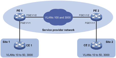

Configuring the TPID in VLAN tags
TPID identifies a frame as an 802.1Q tagged frame. The TPID value varies by vendor. On the device, the TPID in the 802.1Q tag added on a QinQ-enabled port is 0x8100 by default, in compliance with IEEE 802.1Q. In a multi-vendor network, make sure the TPID setting is the same across all devices so 802.1Q tagged frames can be identified correctly.
TPID settings include CVLAN TPID and SVLAN TPID.
A QinQ-enabled port uses the CLAN TPID to match incoming tagged frames. An incoming frame is handled as untagged if its TPID is different from the CVLAN TPID.
SVLAN TPIDs are configurable on a per-port basis. A service provider-side port uses the SVLAN TPID to replace the TPID in outgoing frames' SVLAN tags and match incoming tagged frames. An incoming frame is handled as untagged if the TPID in its outer VLAN tag is different from the SVLAN TPID.
For example, a PE device is connected to a customer device that uses the TPID 0x8200 and to a provider device that uses the TPID 0x9100. For correct packet processing, you must set the CVLAN TPID and SVLAN TPID to 0x8200 and 0x9100 on the PE, respectively.
The TPID field is in the same position as the EtherType field in an untagged Ethernet frame. To ensure correct packet type identification, do not set the TPID value to any of the values listed in Table 1.

Configuring the SVLAN TPID
When you configure the SVLAN ID, follow these restrictions and guidelines:
·     Configure the SVLAN TPID on service provider-side ports of PEs.
·     Do not configure the SVLAN TPID on a QinQ-enabled port.
·     EVB and SVLAN TPID configuration are mutually exclusive. Do not configure both features on a port.
To configure the SVLAN TPID:
Step
Remarks
N/A
2.     Enter Ethernet interface view or aggregate interface view.
N/A
3.     Configure the SVLAN TPID.
qinq ethernet-type service-tag hex-value
The default setting is 0x8100 for SVLAN tags.

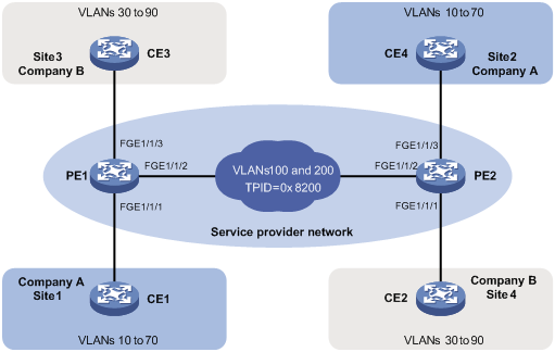

QinQ configuration examples
Basic QinQ configuration example
Network requirements
As shown in Figure 3:
·     The service provider assigns VLAN 100 to Company A's VLANs 10 through 70.
·     The service provider assigns VLAN 200 to Company B's VLANs 30 through 90.
·     The devices between PE 1 and PE 2 in the service provider network use a TPID value of 0x8200.
Configure QinQ on PE 1 and PE 2 to transmit traffic in VLANs 100 and 200 for Company A and Company B, respectively.
For the QinQ frames to be identified correctly, set the SVLAN TPID to 0x8200 on the service provider-side ports of PE 1 and PE 2.
Figure 3 Network diagram
Configuration procedure
1.     Configure PE 1:
# Configure FortyGigE 1/1/1 as a trunk port, and assign it to VLAN 100 and VLANs 10 through 70.
<PE1> system-view
[PE1] interface fortygige 1/1/1
[PE1-FortyGigE1/1/1] port link-type trunk
[PE1-FortyGigE1/1/1] port trunk permit vlan 100 10 to 70
# Configure VLAN 100 as the PVID for FortyGigE 1/1/1.
[PE1-FortyGigE1/1/1] port trunk pvid vlan 100
# Enable QinQ on FortyGigE 1/1/1.
[PE1-FortyGigE1/1/1] qinq enable
[PE1-FortyGigE1/1/1] quit
# Configure FortyGigE 1/1/2 as a trunk port, and assign it to VLANs 100 and 200.
[PE1] interface fortygige 1/1/2
[PE1-FortyGigE1/1/2] port link-type trunk
[PE1-FortyGigE1/1/2] port trunk permit vlan 100 200
# Set the TPID value in the SVLAN tags to 0x8200 on FortyGigE 1/1/2.
[PE1-FortyGigE1/1/2] qinq ethernet-type service-tag 8200
[PE1-FortyGigE1/1/2] quit
# Configure FortyGigE 1/1/3 as a trunk port, and assign it to VLAN 200 and VLANs 30 through 90.
[PE1] interface fortygige 1/1/3
[PE1-FortyGigE1/1/3] port link-type trunk
[PE1-FortyGigE1/1/3] port trunk permit vlan 200 30 to 90
# Configure VLAN 200 as the PVID for FortyGigE 1/1/3.
[PE1-FortyGigE1/1/3] port trunk pvid vlan 200
# Enable QinQ on FortyGigE 1/1/3.
[PE1-FortyGigE1/1/3] qinq enable
[PE1-FortyGigE1/1/3] quit
2.     Configure PE 2:
# Configure FortyGigE 1/1/1 as a trunk port, and assign it to VLAN 200 and VLANs 30 through 90.
<PE2> system-view
[PE2] interface fortygige 1/1/1
[PE2-FortyGigE1/1/1] port link-type trunk
[PE2-FortyGigE1/1/1] port trunk permit vlan 200 30 to 90
# Configure VLAN 200 as the PVID for FortyGigE 1/1/1.
[PE2-FortyGigE1/1/1] port trunk pvid vlan 200
[PE2-FortyGigE1/1/1] qinq enable
[PE2-FortyGigE1/1/1] quit
[PE2] interface fortygige 1/1/2
[PE2-FortyGigE1/1/2] port link-type trunk
[PE2-FortyGigE1/1/2] port trunk permit vlan 100 200
[PE2-FortyGigE1/1/2] qinq ethernet-type service-tag 8200
[PE2-FortyGigE1/1/2] quit
# Configure FortyGigE 1/1/3 as a trunk port, and assign it to VLAN 100 and VLANs 10 through 70.
[PE2] interface fortygige 1/1/3
[PE2-FortyGigE1/1/3] port link-type trunk
[PE2-FortyGigE1/1/3] port trunk permit vlan 100 10 to 70
# Configure VLAN 100 as the PVID for FortyGigE 1/1/3.
[PE2-FortyGigE1/1/3] port trunk pvid vlan 100
[PE2-FortyGigE1/1/3] qinq enable
[PE2-FortyGigE1/1/3] quit
3.     Configure the devices between PE 1 and PE 2:
# Set the MTU to a minimum of 1504 bytes for each port on the path of QinQ frames. (Details not shown.)
# Configure all the ports on the forwarding path to allow frames from VLANs 100 and 200 to pass through without removing the VLAN tag. (Details not shown.)
VLAN transparent transmission configuration example
As shown in Figure 4:
·     The service provider assigns VLAN 100 to a company's VLANs 10 through 50.
·     VLAN 3000 is the dedicated VLAN of the company on the service provider network.
Configure QinQ on PE 1 and PE 2 to provide Layer 2 connectivity for CVLANs 10 through 50 over the service provider network.
Configure VLAN transparent transmission for VLAN 3000 on PE 1 and PE 2 to enable the hosts in VLAN 3000 to communicate without using an SVLAN.
Figure 4 Network diagram
1.     Configure PE 1:
# Configure FortyGigE 1/1/1 as a trunk port, and assign it to VLANs 10 through 50, 100, and 3000.
<PE1> system-view
[PE1-FortyGigE1/1/1] port trunk permit vlan 100 3000 10 to 50
# Configure VLAN 100 as the PVID of FortyGigE 1/1/1.
# Configure FortyGigE 1/1/1 to transparently transmit frames from VLAN 3000.
[PE1-FortyGigE1/1/1] qinq transparent-vlan 3000
# Configure FortyGigE 1/1/2 as a trunk port, and assign it to VLANs 100 and 3000.
[PE1-FortyGigE1/1/2] port trunk permit vlan 100 3000
2.     Configure PE 2:
<PE2> system-view
[PE2-FortyGigE1/1/1] port trunk permit vlan 100 3000 10 to 50
[PE2-FortyGigE1/1/1] qinq transparent-vlan 3000
[PE2-FortyGigE1/1/2] port trunk permit vlan 100 3000
# Configure all the ports on the forwarding path to allow frames from VLANs 100 and 3000 to pass through without removing the VLAN tag. (Details not shown.)
