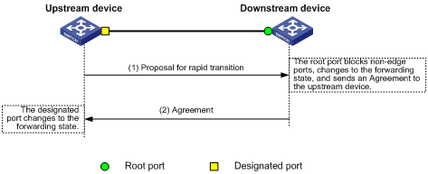

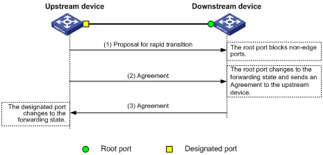

RSTP achieves rapid network convergence by allowing a newly elected root port or designated port to enter the forwarding state much faster than STP.
A newly elected RSTP root port rapidly enters the forwarding state when the following conditions exist:
·     The old root port on the device has stopped forwarding data.
·     The upstream designated port has started forwarding data.
A newly elected RSTP designated port rapidly enters the forwarding state if it is an edge port or it connects to a point-to-point link.
·     A port that directly connects to a user terminal can be configured as an edge port. Edge ports directly enter the forwarding state.
·     When a designated port connects to a point-to-point link, it enters the forwarding state immediately after the device receives a handshake response from the directly connected device.

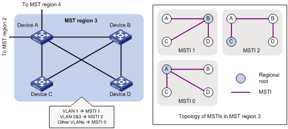

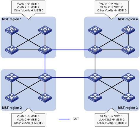

Figure 4 shows a switched network that comprises four MST regions, each MST region comprising four MSTP devices. Figure 5 shows the networking topology of MST region 3.
Figure 4 Basic concepts in MSTP
Figure 5 Network diagram and topology of MST region 3
MST region
A multiple spanning tree region (MST region) consists of multiple devices in a switched network and the network segments among them. All these devices have the following characteristics:
·     A spanning tree protocol enabled
·     Same region name
·     Same VLAN-to-instance mapping configuration
·     Same MSTP revision level
·     Physically linked together
Multiple MST regions can exist in a switched network. You can assign multiple devices to the same MST region as shown in Figure 4.
·     The switched network comprises four MST regions, MST region 1 through MST region 4.
·     All devices in each MST region have the same MST region configuration.
MSTI
MSTP can generate multiple independent spanning trees in an MST region, and each spanning tree is mapped to the specific VLANs. Each spanning tree is referred to as a multiple spanning tree instance (MSTI).
In Figure 5, MST region 3 comprises three MSTIs, MSTI 1, MSTI 2, and MSTI 0.
VLAN-to-instance mapping table
As an attribute of an MST region, the VLAN-to-instance mapping table describes the mapping relationships between VLANs and MSTIs.
In Figure 5, the VLAN-to-instance mapping table of MST region 3 is as follows:
·     VLAN 1 to MSTI 1.
·     VLAN 2 and VLAN 3 to MSTI 2.
·     Other VLANs to MSTI 0.

CST
The common spanning tree (CST) is a single spanning tree that connects all MST regions in a switched network. If you regard each MST region as a device, the CST is a spanning tree calculated by these devices through STP or RSTP.
The blue lines in Figure 4 represent the CST.

Regional root
The root bridge of the IST or an MSTI within an MST region is the regional root of the IST or MSTI. Based on the topology, different spanning trees in an MST region might have different regional roots, as shown in MST region 3 in Figure 5:
·     The regional root of MSTI 1 is Device B.
·     The regional root of MSTI 2 is Device C.
·     The regional root of MSTI 0 (also known as the IST) is Device A.

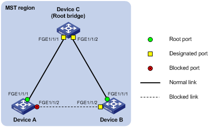

A port can play different roles in different MSTIs. As shown in Figure 6, an MST region comprises Device A, Device B, Device C, and Device D. Port A1 and port A2 of Device A connect to the common root bridge. Port B2 and Port B3 of Device B form a loop. Port C3 and Port C4 of Device C connect to other MST regions. Port D3 of Device D directly connects to a host.
Figure 6 Port roles
MSTP calculation involves the following port roles:
·     Root port—Forwards data for a non-root bridge to the root bridge. The root bridge does not have any root port.
·     Designated port—Forwards data to the downstream network segment or device.
·     Alternate portActs as the backup port for a root port or master port. When the root port or master port is blocked, the alternate port takes over.
·     Backup portActs as the backup port of a designated port. When the designated port is invalid, the backup port becomes the new designated port. A loop occurs when two ports of the same spanning tree device are connected, so the device blocks one of the ports. The blocked port acts as the backup.

In RSTP and MSTP, the following types of messages are used for rapid state transition on designated ports:
·     Proposal—Sent by designated ports to request rapid transition
·     Agreement—Used to acknowledge rapid transition requests
Both RSTP and MSTP devices can perform rapid transition on a designated port only when the port receives an agreement packet from the downstream device. RSTP and MSTP devices have the following differences:
·     For MSTP, the root port of the downstream device sends an agreement packet only after it receives an agreement packet from the upstream device.
·     For RSTP, the downstream device sends an agreement packet regardless of whether an agreement packet from the upstream device is received.
Figure 8 Rapid state transition of an MSTP designated port
Figure 9 Rapid state transition of an RSTP designated port
If the upstream device is a third-party device, the rapid state transition implementation might be limited as follows:
·     The upstream device uses a rapid transition mechanism similar to that of RSTP.
·     The downstream device adopts MSTP and does not operate in RSTP mode.
In this case, the following occurs:
1.     The root port on the downstream device receives no agreement packet from the upstream device.
2.     It sends no agreement packets to the upstream device.
As a result, the designated port of the upstream device can transit to the forwarding state only after a period twice the Forward Delay.
You can enable the No Agreement Check feature on the downstream device's port to enable the designated port of the upstream device to transit its state rapidly.

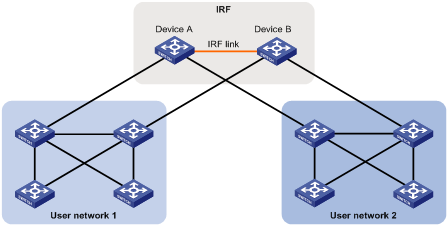

As shown in Figure 11, an IRF fabric connects to two user networks through double links.
·     Device A and Device B form an IRF fabric.
·     The spanning tree feature is disabled on Device A and Device B and enabled on all devices in user network 1 and user network 2.
·     The IRF fabric transparently transmits BPDUs for both user networks and is not involved in the calculation of spanning trees.
When the network topology changes, it takes time for the IRF fabric to update its MAC address table and ARP table. During this period, traffic in the network might be interrupted.
Figure 11 TC Snooping application scenario
image18.emf
To avoid traffic interruption, you can enable TC Snooping on the IRF fabric. After receiving a TC-BPDU through a port, the IRF fabric updates MAC address table and ARP table entries associated with the port's VLAN. In this way, TC Snooping prevents topology change from interrupting traffic forwarding in the network. For more information about the MAC address table and the ARP table, see "Configuring the MAC address table" and Layer 3—IP Services Configuration Guide.

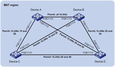

MSTP configuration example
Network requirements

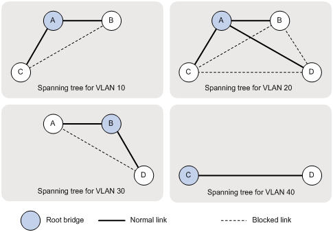

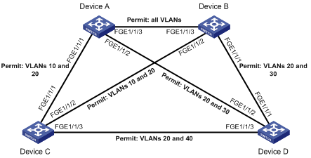

As shown in Figure 12, all devices on the network are in the same MST region. Device A and Device B work at the distribution layer. Device C and Device D work at the access layer.
Configure MSTP so that packets of different VLANs are forwarded along different spanning trees.
·     VLAN 10 packets are forwarded along MSTI 1.
·     VLAN 30 packets are forwarded along MSTI 3.
·     VLAN 40 packets are forwarded along MSTI 4.
·     VLAN 20 packets are forwarded along MSTI 0.
VLAN 10 and VLAN 30 are terminated on the distribution layer devices, and VLAN 40 is terminated on the access layer devices. The root bridges of MSTI 1 and MSTI 3 are Device A and Device B, respectively, and the root bridge of MSTI 4 is Device C.
Figure 12 Network diagram
Configuration procedure
1.     Configure VLANs and VLAN member ports. (Details not shown.)
¡     Create VLAN 10, VLAN 20, and VLAN 30 on both Device A and Device B.
¡     Create VLAN 10, VLAN 20, and VLAN 40 on Device C.
¡     Create VLAN 20, VLAN 30, and VLAN 40 on Device D.
¡     Configure the ports on these devices as trunk ports and assign them to related VLANs.

PVST configuration example
As shown in Figure 14, Device A and Device B work at the distribution layer, and Device C and Device D work at the access layer.
Configure PVST to meet the following requirements:
·     Packets of a VLAN are forwarded along the spanning trees of the VLAN.
·     VLAN 10, VLAN 20, and VLAN 30 are terminated on the distribution layer devices, and VLAN 40 is terminated on the access layer devices.
·     The root bridge of VLAN 10 and VLAN 20 is Device A.
·     The root bridge of VLAN 30 is Device B.
·     The root bridge of VLAN 40 is Device C.
Figure 14 Network diagram

Based on the output, you can draw a topology for each VLAN spanning tree, as shown in Figure 15.
Figure 15 VLAN spanning tree topologies
