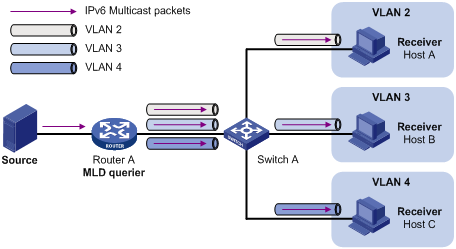

As shown in Figure 1, in the traditional IPv6 multicast programs-on-demand mode, when receiver hosts (Host A, Host B, and Host C) that belong to different VLANs require IPv6 multicast programs on demand service, the Layer 3 device (Router A) needs to forward a separate copy of the multicast traffic in each user VLAN to the Layer 2 device (Switch A). In this case, a large amount of network bandwidth is used and an extra burden is added to the Layer 3 device.
Figure 1 Multicast transmission without the IPv6 multicast VLAN feature

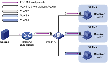

The IPv6 multicast VLAN feature configured on the Layer 2 device is the solution to this issue. With the IPv6 multicast VLAN feature, the Layer 3 device needs to replicate the multicast traffic only in the IPv6 multicast VLAN instead of making a separate copy of the multicast traffic in each user VLAN. This saves the network bandwidth and lessens the burden of the Layer 3 device.
The switch supports only sub-VLAN-based IPv6 multicast VLANs.
As shown in Figure 2, Host A, Host B, and Host C are in three different user VLANs. On Switch A, configure VLAN 10 as an IPv6 multicast VLAN, configure all the user VLANs as sub-VLANs of this IPv6 multicast VLAN, and enable MLD snooping in the IPv6 multicast VLAN.
Figure 2 A sub-VLAN-based IPv6 multicast VLAN
After the configuration, MLD snooping manages router ports in the IPv6 multicast VLAN and member ports in the sub-VLANs. When forwarding multicast data to Switch A, Router A needs to send only one copy of multicast traffic to Switch A in the IPv6 multicast VLAN, and Switch A distributes the traffic to the IPv6 multicast VLAN's sub-VLANs that contain receivers.

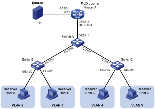

As shown in Figure 3, MLDv1 runs on Router A, and MLDv1 snooping runs on Switch A. Router A acts as the MLD querier.
The IPv6 multicast source sends IPv6 multicast data to the IPv6 multicast group FF1E::101. Host A, Host B, Host C, and Host D are receivers of the IPv6 multicast group. The hosts belong to VLAN 2 through VLAN 5.
Configure the sub-VLAN-based IPv6 multicast VLAN feature on Switch A so that Router A just sends IPv6 multicast data to Switch A through the IPv6 multicast VLAN and Switch A forwards the traffic to the receivers that belong to different user VLANs.
Figure 3 Network diagram
