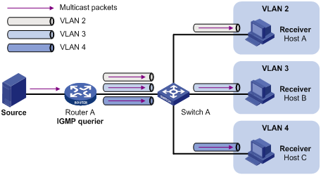

In the traditional multicast programs-on-demand mode shown in Figure 1, when hosts (Host A, Host B, and Host C) that belong to different VLANs require multicast programs-on-demand service, the Layer 3 device (Router A) must forward a separate copy of the multicast traffic in each user VLAN to the Layer 2 device (Switch A). In this case, a large amount of network bandwidth is used and an extra burden is added to the Layer 3 device.
Figure 1 Multicast transmission without the multicast VLAN feature
The multicast VLAN feature configured on the Layer 2 device is the solution to this issue. With the multicast VLAN feature, the Layer 3 device replicates the multicast traffic only in the multicast VLAN instead of making a separate copy of the multicast traffic in each user VLAN. This saves network bandwidth and lessens the burden on the Layer 3 device.

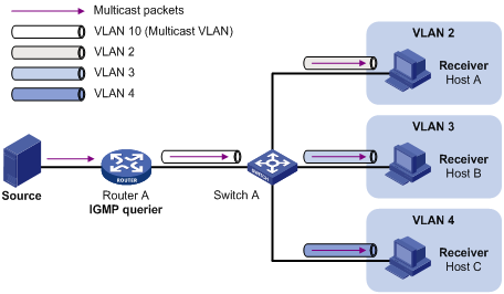

The multicast VLAN feature can be implemented in a sub-VLAN-based multicast VLAN.
As shown in Figure 2, Host A, Host B, and Host C are in three different user VLANs. On Switch A, configure VLAN 10 as a multicast VLAN, configure all user VLANs as sub-VLANs of this multicast VLAN, and enable IGMP snooping in the multicast VLAN.
Figure 2 A sub-VLAN-based multicast VLAN
After the configuration, IGMP snooping manages router ports in the multicast VLAN and member ports in the sub-VLANs. When forwarding multicast data to Switch A, Router A needs to send only one copy of multicast traffic to Switch A in the multicast VLAN, and Switch A distributes the traffic to the multicast VLAN's sub-VLANs that contain receivers.

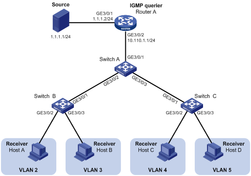

As shown in Figure 3, IGMPv2 runs on Router A, and IGMPv2 snooping runs on Switch A, Switch B, and Switch C. Router A acts as the IGMP querier.
The multicast source sends multicast data to multicast group 224.1.1.1. Host A, Host B, Host C, and Host D are receivers of the multicast group. The hosts belong to VLAN 2 through VLAN 5.
Configure the sub-VLAN-based multicast VLAN feature on Switch A so that Router A just sends multicast data to Switch A through the multicast VLAN and Switch A forwards the traffic to the receivers that belong to different user VLANs.
Figure 3 Network diagram

1.     Configure an IP address and subnet mask for each interface as per Figure 3. (Details not shown.)
2.     On Router A, enable IP multicast routing, enable PIM-DM on each Layer 3 interface, and enable IGMP on the host-side interface GigabitEthernet 3/0/2.
<RouterA> system-view
[RouterA] multicast routing-enable
[RouterA] interface GigabitEthernet 3/0/1
[RouterA-GigabitEthernet3/0/1]port link-mode route
[RouterA-GigabitEthernet3/0/1] pim dm
[RouterA-GigabitEthernet3/0/1] quit
[RouterA] interface GigabitEthernet 3/0/2
[RouterA-GigabitEthernet3/0/2]port link-mode route
[RouterA-GigabitEthernet3/0/2] pim dm
[RouterA-GigabitEthernet3/0/2] igmp enable
3.     Configure Switch A:
# Enable IGMP snooping globally.
<SwitchA> system-view
[SwitchA] igmp-snooping
[SwitchA-igmp-snooping] quit
# Create VLAN 2 through VLAN 5.
[SwitchA] vlan 2 to 5
# Configure GigabitEthernet 3/0/2 as a trunk port, and assign it to VLAN 2 and VLAN 3.
[SwitchA] interface GigabitEthernet 3/0/2
[SwitchA-GigabitEthernet3/0/2] port link-type trunk
[SwitchA-GigabitEthernet3/0/2] port trunk permit vlan 2 3
[SwitchA-GigabitEthernet3/0/2] quit
# Configure GigabitEthernet 3/0/3 as a trunk port, and assign it to VLAN 4 and VLAN 5.
[SwitchA] interface GigabitEthernet 3/0/3
[SwitchA-GigabitEthernet3/0/3] port link-type trunk
[SwitchA-GigabitEthernet3/0/3] port trunk permit vlan 4 5
[SwitchA-GigabitEthernet3/0/3] quit
# Create VLAN 10, assign GigabitEthernet 3/0/1 to this VLAN, and enable IGMP snooping in the VLAN.
[SwitchA] vlan 10
[SwitchA-vlan10] port GigabitEthernet 3/0/1
[SwitchA-vlan10] igmp-snooping enable
[SwitchA-vlan10] quit
# Configure VLAN 10 as a multicast VLAN and configure VLAN 2 through VLAN 5 as its sub-VLANs.
[SwitchA] multicast-vlan 10
[SwitchA-mvlan-10] subvlan 2 to 5
[SwitchA-mvlan-10] quit
4.     Configure Switch B:
<SwitchB> system-view
[SwitchB] igmp-snooping
[SwitchB-igmp-snooping] quit
# Create VLAN 2, assign GigabitEthernet 3/0/2 to VLAN 2, and enable IGMP snooping in the VLAN.
[SwitchB] vlan 2
[SwitchB-vlan2] port GigabitEthernet 3/0/2
[SwitchB-vlan2] igmp-snooping enable
[SwitchB-vlan2] quit
# Create VLAN 3, assign GigabitEthernet 3/0/3 to VLAN 3, and enable IGMP snooping in the VLAN.
[SwitchB] vlan 3
[SwitchB-vlan3] port GigabitEthernet 3/0/3
[SwitchB-vlan3] igmp-snooping enable
[SwitchB-vlan3] quit
# Configure GigabitEthernet 3/0/1 as a trunk port, and assign it to VLAN 2 and VLAN 3.
[SwitchB] interface GigabitEthernet 3/0/1
[SwitchB-GigabitEthernet3/0/1] port link-type trunk
[SwitchB-GigabitEthernet3/0/1] port trunk permit vlan 2 3
5.     Configure Switch C in the same way as you configure Switch B. (Details not shown.)
