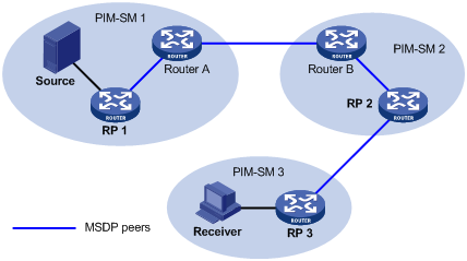

MSDP peers
Configuring one or more pairs of MSDP peers in the network forms an MSDP interconnection map, where the RPs of different PIM-SM domains are interconnected in series. An SA message sent by an RP and relayed by these MSDP peers can be delivered to all other RPs.
Figure 1 Where MSDP peers are in the network
As shown in Figure 1, an MSDP peer can be created on any PIM-SM router. MSDP peers created on PIM-SM routers that assume different roles function differently.
1.     MSDP peers on RPs include the following types:
¡     Source-side MSDP peer—The MSDP peer nearest to the multicast source (Source), typically the source-side RP, like RP 1. The source-side RP creates SA messages and sends the messages to its remote MSDP peer to notify the MSDP peer of the locally registered multicast source information. A source-side MSDP peer must be created on the source-side RP. Otherwise it will not be able to advertise the multicast source information out of the PIM-SM domain.
¡     Receiver-side MSDP peer—The MSDP peer nearest to the receivers, typically the receiver-side RP, like RP 3. After receiving an SA message, the receiver-side MSDP peer resolves the multicast source information carried in the message and joins the SPT rooted at the source across the PIM-SM domain. When multicast data from the multicast source arrives, the receiver-side MSDP peer forwards the data to the receivers along the RPT.
¡     Intermediate MSDP peer—An MSDP peer with multicast remote MSDP peers, like RP 2. An intermediate MSDP peer forwards SA messages received from one remote MSDP peer to other remote MSDP peers, functioning as a relay of multicast source information.
2.     MSDP peers created on common PIM-SM routers (other than RPs)
Router A and Router B are MSDP peers on common multicast routers. Such MSDP peers just forward received SA messages.
In a PIM-SM network running the BSR mechanism, the RP is dynamically elected from C-RPs. To enhance network robustness, a PIM-SM network typically has more than one C-RP. As the RP election result is unpredictable, MSDP peering relationship must be built among all C-RPs so that the winner C-RP is always on the "MSDP interconnection map", and loser C-RPs will assume the role of common PIM-SM routers on the "MSDP interconnection map."

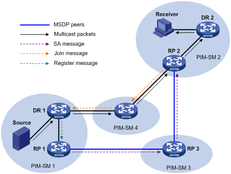

Inter-domain multicast delivery through MSDP
As shown in Figure 2, an active source (Source) exists in the domain PIM-SM 1, and RP 1 has learned the existence of Source through multicast source registration. If RPs in PIM-SM 2 and PIM-SM 3 also seek the location of Source so that receiver hosts can receive multicast traffic that originated from it, MSDP peering relationship must be established between RP 1 and RP 3 and between RP 3 and RP 2.
Figure 2 Inter-domain multicast delivery through MSDP
The process of implementing PIM-SM inter-domain multicast delivery by leveraging MSDP peers is as follows:
1.     When the multicast source in PIM-SM 1 sends the first multicast packet to multicast group G, DR 1 encapsulates the multicast data within a register message and sends the register message to RP 1. Then, RP 1 identifies the information related to the multicast source.
2.     As the source-side RP, RP 1 creates SA messages and periodically sends the SA messages to its MSDP peer. An SA message contains the source address (S), the multicast group address (G), and the address of the RP that has created this SA message (RP 1).
3.     On MSDP peers, each SA message undergoes a reverse path forwarding (RPF) check and multicast policy–based filtering, so that only SA messages that have arrived along the correct path and passed the filtering are received and forwarded. This avoids delivery loops of SA messages. In addition, you can configure MSDP peers into an MSDP mesh group so as to avoid flooding of SA messages between MSDP peers.
An MSDP mesh group refers to a group of MSDP peers that have MSDP peering relationship among one another and share the same group name.
4.     SA messages are forwarded from one MSDP peer to another, and finally the information about the multicast source traverses all PIM-SM domains with MSDP peers (PIM-SM 2 and PIM-SM 3 in this example).
5.     After receiving the SA message that RP 1 created, RP 2 in PIM-SM 2 determines whether any receivers for the multicast group exist in the domain.
¡     If so, the RPT for the multicast group G is maintained between RP 2 and the receivers. RP 2 creates an (S, G) entry, and sends an (S, G) join message hop by hop toward DR 1 at the multicast source side, so that it can directly join the SPT rooted at the source over other PIM-SM domains. Then, the multicast data can flow along the SPT to RP 2 and RP 2 can forward the data to the receivers along the RPT. After receiving the multicast traffic, the DR at the receiver side (DR 2) determines whether to initiate an RPT-to-SPT switchover process.
¡     If no receivers for the group exist in the domain, RP 2 neither creates an (S, G) entry nor joins the SPT rooted at the source.
When using MSDP for inter-domain multicasting, once an RP receives information form a multicast source, it no longer relies on RPs in other PIM-SM domains. The receivers can override the RPs in other domains and directly join the multicast source-based SPT.

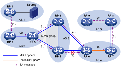

RPF check rules for SA messages
As shown in Figure 3, the autonomous systems in the network are AS 1 through AS 5, with IGP enabled on routers within each AS and BGP or MBGP as the interoperation protocol among different ASs. Each AS contains at least one PIM-SM domain, and each PIM-SM domain contains one or more RPs. MSDP peering relationship have been established among different RPs. RP 3, RP 4, and RP 5 are in an MSDP mesh group. On RP 7, RP 6 is configured as its static RPF peer.
When the switch receives an SA message from a static RPF peer, it accepts the SA message and forwards it to other peers without performing an RPF check.
Figure 3 Diagram for RPF check for SA messages
As illustrated in Figure 3, these MSDP peers dispose of SA messages according to the following RPF check rules:
1.     When RP 2 receives an SA message from RP 1: Because the source-side RP address carried in the SA message is the same as the MSDP peer address, which means that the MSDP peer where the SA is from is the RP that has created the SA message, RP 2 accepts the SA message and forwards it to its other MSDP peer (RP 3).
2.     When RP 3 receives the SA message from RP 2: Because the SA message is from an MSDP peer (RP 2) in the same AS, and the MSDP peer is the next hop on the optimal path to the source-side RP, RP 3 accepts the message and forwards it to other peers (RP 4 and RP 5).
3.     When RP 4 and RP 5 receive the SA message from RP 3: Because the SA message is from an MSDP peer (RP 3) in the same mesh group, RP 4 and RP 5 both accept the SA message, but they do not forward the message to other members in the mesh group. Instead, they forward it to other MSDP peers (RP 6 in this example) out of the mesh group.
4.     When RP 6 receives the SA messages from RP 4 and RP 5 (supposing that RP 5 has a higher IP address): Although RP 4 and RP 5 are in the same AS (AS 3) and both are MSDP peers of RP 6, because RP 5 has a higher IP address, RP 6 accepts only the SA message from RP 5.
5.     When RP 7 receives the SA message from RP 6: Because the SA message is from a static RPF peer (RP 6), RP 7 accepts the SA message and forwards it to other peer (RP 8).
6.     When RP 8 receives the SA message from RP 7: A BGP or MBGP route exists between two MSDP peers in different ASs. Because the SA message is from an MSDP peer (RP 7) in a different AS, and the MSDP peer is the next hop on the BGP or MBGP route to the source-side RP, RP 8 accepts the message and forwards it to its other peer (RP 9).
7.     When RP 9 receives the SA message from RP 8: Because RP 9 has only one MSDP peer, RP 9 accepts the SA message.
SA messages from paths other than those described previously will not be accepted or forwarded by MSDP peers.

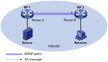

Intra-domain Anycast RP through MSDP
Anycast RP refers to an application that enables load balancing and redundancy backup between two or more RPs within a PIM-SM domain by configuring the same IP address for, and establishing MSDP peering relationship between, these RPs.
The significance of Anycast RP is as follows:
·     Optimal RP path—A multicast source registers with the nearest RP so that an SPT with the optimal path is built. A receiver joins the nearest RP so that an RPT with the optimal path is built.
·     Load balancing between RPs—Each RP needs to maintain just part of the source/group information within the PIM-SM domain and forward part of the multicast data, thus achieving load balancing between different RPs.
·     Redundancy backup between RPs—When an RP fails, the multicast source previously registered on it or the receivers that previously joined it will register with or join another nearest RP, achieving redundancy backup between RPs.
As shown in Figure 4, within a PIM-SM domain, a multicast source sends multicast data to multicast group G, and Receiver is a member of the multicast group. To implement Anycast RP, configure the same IP address (known as Anycast RP address, typically a private address) on Router A and Router B, configure these interfaces as C-RPs, and establish an MSDP peering relationship between Router A and Router B.
Usually an Anycast RP address is configured on a logic interface, like a loopback interface.
Figure 4 Intra-domain Anycast RP through MSDP
The work process of Anycast RP is as follows:
1.     The multicast source registers with the nearest RP. In this example, Source registers with RP 1, with its multicast data encapsulated in the register message. When the register message arrives at RP 1, RP 1 de-encapsulates the message.
2.     Receivers send join messages to the nearest RP to join in the RPT rooted as this RP. In this example, Receiver joins the RPT rooted at RP 2.
3.     RPs share the registered multicast information by means of SA messages. In this example, RP 1 creates an SA message and sends it to RP 2, with the multicast data from Source encapsulated in the SA message. When the SA message reaches RP 2, RP 2 de-encapsulates the message.
4.     Receivers receive the multicast data along the RPT and directly join the SPT rooted at the multicast source. In this example, RP 2 forwards the multicast data down the RPT. When Receiver receives the multicast data from Source, it directly joins the SPT rooted at Source.
IMPORTANT
IMPORTANT:
·     Be sure to configure a 32-bit subnet mask 255.255.255.255 for the Anycast RP address.
·     An MSDP peer address must be different from the Anycast RP address

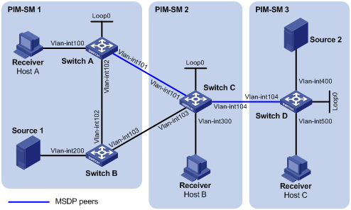

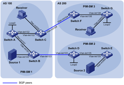

PIM-SM inter-domain multicast configuration
Network requirements
As shown in Figure 5, BGP runs between the two ASs. PIM-SM 1 belongs to AS 100, and PIM-SM 2 and PIM-SM 3 belong to AS 200. Each PIM-SM domain has at least one multicast source or receiver.
Configure Loopback 0 as the C-BSR and C-RP of the related PIM-SM domain on Switch B, Switch C, and Switch E.
Set up MSDP peering relationship between the RPs of the PIM-SM domains to share multicast source information among the PIM-SM domains.
Figure 5 Network diagram
Table 1 shows the interface and IP address assignment, and network topology scheme.

Configuration procedure
1.     Configure the IP address and subnet mask for each interface as per Figure 5. (Details not shown.)
2.     Configure OSPF on switches in each AS to make sure the network-layer is interoperable among each AS, and routing information between the switches can be dynamically updated. (Details not shown.)
3.     Enable IP multicast routing, enable PIM-SM on each interface, and configure a PIM-SM domain border:
# Enable IP multicast routing on Switch A, enable PIM-SM on each interface, and enable IGMP on the host-side interface VLAN-interface 200.
<SwitchA> system-view

Inter-AS multicast configuration by leveraging static RPF peers
As shown in Figure 6, AS 100 and AS 200 are two ASs running OSPF. BGP runs between the two ASs.
Configure Loopback 0 as a C-BSR and C-RP of the related PIM-SM domain on Switch A, Switch D and Switch G.
According to the RPF principle, the device can receive SA messages that pass the filtering policy from its static RPF peers. To share multicast source information among PIM-SM domains without changing the unicast topology structure, configure MSDP peering relationship for the RPs of the PIM-SM domains and configure static RPF peering relationship for the MSDP peers to share multicast source information among the PIM-SM domains.
Figure 6 Network diagram
Table 2 shows the interface and IP address assignment, and network topology scheme.
Device
Interface
IP address
Device
Interface
IP address
Source 1
192.168.1.100/24
Switch D
Vlan-int105
10.110.5.1/24
Source 2
192.168.3.100/24
Switch D
Vlan-int103
10.110.3.2/24
Switch A
Vlan-int101
10.110.1.1/24
Switch D
Loop0
2.2.2.2/32
Switch A
Vlan-int102
10.110.2.1/24
Switch E
Vlan-int105
10.110.5.2/24
Switch A
Loop0
1.1.1.1/32
Switch E
Vlan-int300
192.168.3.1/24
Switch B
Vlan-int101
10.110.1.2/24
Switch F
Vlan-int106
10.110.6.1/24
Switch B
Vlan-int100
192.168.1.1/24
Switch F
Vlan-int104
10.110.4.2/24
Switch B
Vlan-int103
10.110.3.1/24
Switch G
Vlan-int106
10.110.6.2/24
Switch C
Vlan-int102
10.110.2.2/24
Switch G
Vlan-int400
192.168.4.1/24
Switch C
Vlan-int200
192.168.2.1/24
Switch G
Loop0
3.3.3.3/32
Switch C
Vlan-int104
10.110.4.1/24
1.     Configure the IP address and subnet mask for each interface as per Figure 6. (Details not shown.)
2.     Configure OSPF on the switches to make sure the network-layer is interoperable in each AS, and routing information among the switches can be dynamically updated. (Details not shown.)
3.     Enable IP multicast routing, enable PIM-SM and IGMP, and configure a PIM-SM domain border:
# Enable IP multicast routing on Switch C, enable PIM-SM on each interface, and enable IGMP on the host-side interface VLAN-interface 200.
<SwitchC> system-view
[SwitchC] multicast routing-enable
[SwitchC] interface vlan-interface 102
[SwitchC-Vlan-interface102] pim sm
[SwitchC-Vlan-interface102] quit
[SwitchC] interface vlan-interface 200
[SwitchC-Vlan-interface200] igmp enable
[SwitchC-Vlan-interface200] pim sm
[SwitchC-Vlan-interface200] quit
[SwitchC] interface vlan-interface 104
[SwitchC-Vlan-interface104] pim sm
[SwitchC-Vlan-interface104] quit
# Enable IP multicast routing, PIM-SM, and IGMP on Switch A, Switch B, Switch D, Switch E, Switch F, and Switch G in the same way. (Details not shown.)
# Configure PIM domain borders on Switch B.
[SwitchB] interface vlan-interface 103
[SwitchB-Vlan-interface103] pim bsr-boundary
[SwitchB-Vlan-interface103] quit
# Configure PIM domain borders on Switch C, Switch D, and Switch F in the same way. (Details not shown.)
4.     Configure C-BSRs and C-RPs:
# Configure Loopback 0 as a C-BSR and a C-RP on Switch A.
[SwitchA] pim
[SwitchA-pim] c-bsr loopback 0
[SwitchA-pim] c-rp loopback 0
[SwitchA-pim] quit
# Configure C-BSRs and C-RPs on Switch D and Switch G in the same way. (Details not shown.)
5.     Configure BGP, and redistribute BGP routing information into OSPF, and OSPF routing information into BGP:
# Configure the EBGP peer, and redistribute OSPF routing information on Switch B.
[SwitchB] bgp 100
[SwitchB-bgp] router-id 1.1.1.2
[SwitchB-bgp] peer 10.110.3.2 as-number 200
[SwitchB-bgp] import-route ospf 1
[SwitchB-bgp] quit
# Configure the EBGP peer, and redistribute OSPF routing information on Switch D.
[SwitchD] bgp 200
[SwitchD-bgp] router-id 2.2.2.2
[SwitchD-bgp] peer 10.110.3.1 as-number 100
[SwitchD-bgp] import-route ospf 1
[SwitchD-bgp] quit
# Configure the EBGP peer, and redistribute OSPF routing information on Switch C.
[SwitchC] bgp 100
[SwitchC-bgp] router-id 1.1.1.3
[SwitchC-bgp] peer 10.110.4.2 as-number 200
[SwitchC-bgp] import-route ospf 1
[SwitchC-bgp] quit
# Configure the EBGP peer, and redistribute OSPF routing information on Switch F.
[SwitchF] bgp 200
[SwitchF-bgp] router-id 3.3.3.1
[SwitchF-bgp] peer 10.110.4.1 as-number 100
[SwitchF-bgp] import-route ospf 1
[SwitchF-bgp] quit
# Redistribute BGP routing information into OSPF on Switch B.
[SwitchB] ospf 1
[SwitchB-ospf-1] import-route bgp
[SwitchB-ospf-1] quit
# Redistribute BGP routing information into OSPF on Switch D.
[SwitchD] ospf 1
[SwitchD-ospf-1] import-route bgp
[SwitchD-ospf-1] quit
# Redistribute BGP routing information into OSPF on Switch C.
[SwitchC] ospf 1
[SwitchC-ospf-1] import-route bgp
[SwitchC-ospf-1] quit
# Redistribute BGP routing information into OSPF on Switch F.
[SwitchF] ospf 1
[SwitchF-ospf-1] import-route bgp
[SwitchF-ospf-1] quit
6.     Configure MSDP peers and static RPF peers:
# Configure Switch D and Switch G as the MSDP peers and static RPF peers of Switch A.
[SwitchA] ip ip-prefix list-dg permit 10.110.0.0 16 greater-equal 16 less-equal 32
[SwitchA] msdp
[SwitchA-msdp] peer 10.110.3.2 connect-interface vlan-interface 101
[SwitchA-msdp] peer 10.110.6.2 connect-interface vlan-interface 102
[SwitchA-msdp] static-rpf-peer 10.110.3.2 rp-policy list-dg
[SwitchA-msdp] static-rpf-peer 10.110.6.2 rp-policy list-dg
[SwitchA-msdp] quit
# Configure Switch A as the MSDP peer and static RPF peer of Switch D.
[SwitchD] ip ip-prefix list-a permit 10.110.0.0 16 greater-equal 16 less-equal 32
[SwitchD] msdp
[SwitchD-msdp] peer 10.110.1.1 connect-interface vlan-interface 103
[SwitchD-msdp] static-rpf-peer 10.110.1.1 rp-policy list-a
[SwitchD-msdp] quit
# Configure Switch A as the MSDP peer and static RPF peer of Switch G.
[SwitchG] ip ip-prefix list-a permit 10.110.0.0 16 greater-equal 16 less-equal 32
[SwitchG] msdp
[SwitchG-msdp] peer 10.110.2.1 connect-interface vlan-interface 106
[SwitchG-msdp] static-rpf-peer 10.110.2.1 rp-policy list-a
[SwitchG-msdp] quit
Use the display bgp peer command to view the BGP peering relationship between the switches. If the command gives no output on Switch A, it means that no BGP peering relationship has been established between Switch A and Switch D, or between Switch A and Switch G.

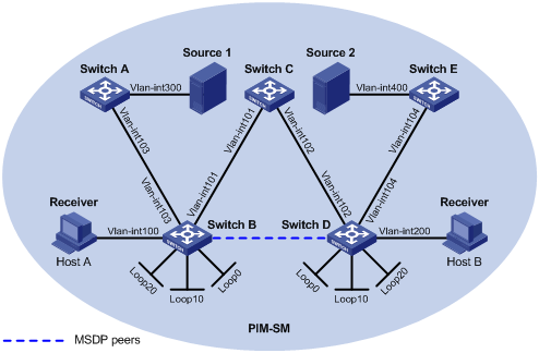

Anycast RP configuration
As shown in Figure 7, the PIM-SM domain has multiple multicast sources and receivers. OSPF runs within the domain to provide unicast routes.
Configure the Anycast RP application so that the receiver-side DRs and the source-side DRs can initiate a join message to their respective RPs that are the topologically nearest to them.
On Switch B and Switch D, configure the interface Loopback 10 as a C-BSR, and Loopback 20 as a C-RP.
The router ID of Switch B is 1.1.1.1, and the router ID of Switch D is 2.2.2.2. Set up an MSDP peering relationship between Switch B and Switch D.
Figure 7 Network diagram
Table 3 shows the interface and IP address assignment, and network topology scheme.
Table 3 Interface and IP address assignment
Device
Interface
IP address
Source 1
10.110.5.100/24
Source 2
10.110.6.100/24
Switch A
VLAN-interface 300
10.110.5.1/24
Switch A
VLAN-interface 103
10.110.2.2/24
Switch B
VLAN-interface 100
10.110.1.1/24
Switch B
VLAN-interface 103
10.110.2.1/24
Switch B
VLAN-interface 101
192.168.1.1/24
Switch B
Loopback 0
1.1.1.1/32
Switch B
Loopback 10
3.3.3.3/32
Switch B
Loopback 20
10.1.1.1/32
Switch C
VLAN-interface 101
192.168.1.2/24
Switch C
VLAN-interface 102
192.168.2.2/24
Switch D
VLAN-interface 200
10.110.3.1/24
Switch D
VLAN-interface 104
10.110.4.1/24
Switch D
VLAN-interface 102
192.168.2.1/24
Switch D
Loopback 0
2.2.2.2/32
Switch D
Loopback 10
4.4.4.4/32
Switch D
Loopback 20
10.1.1.1/32
Switch E
VLAN-interface 400
10.110.6.1/24
Switch E
VLAN-interface 104
10.110.4.2/24
1.     Configure the IP address and subnet mask for each interface as per Figure 7. (Details not shown.)
2.     Configure OSPF on the switches to make sure the network-layer is interoperable among the switches, and routing information between the switches can be dynamically updated. (Details not shown.)
3.     Enable IP multicast routing, and enable PIM-SM and IGMP:
# Enable IP multicast routing on Switch B, enable PIM-SM on each interface, and enable IGMP on the host-side interface VLAN-interface 100.
<SwitchB> system-view
[SwitchB] multicast routing-enable
[SwitchB-Vlan-interface100] igmp enable
[SwitchB-Vlan-interface100] pim sm
[SwitchB-Vlan-interface103] pim sm
[SwitchB] interface Vlan-interface 101
[SwitchB-Vlan-interface101] pim sm
[SwitchB-Vlan-interface101] quit
[SwitchB] interface loopback 0
[SwitchB-LoopBack0] pim sm
[SwitchB-LoopBack0] quit
[SwitchB] interface loopback 10
[SwitchB-LoopBack10] pim sm
[SwitchB-LoopBack10] quit
[SwitchB] interface loopback 20
[SwitchB-LoopBack20] pim sm
[SwitchB-LoopBack20] quit
# Enable IP multicast routing, PIM-SM, and IGMP on Switch A, Switch C, Switch D, and Switch E in the same way. (Details not shown.)
# Configure Loopback 10 as a C-BSR and Loopback 20 as a C-RP on Switch B.
[SwitchB] pim
[SwitchB-pim] c-bsr loopback 10
[SwitchB-pim] c-rp loopback 20
[SwitchB-pim] quit
# Configure a C-BSR and a C-RP on Switch D in the same way. (Details not shown.)
5.     Configure MSDP peers:
# Configure an MSDP peer on Loopback 0 of Switch B.
[SwitchB] msdp
[SwitchB-msdp] originating-rp loopback 0
[SwitchB-msdp] peer 2.2.2.2 connect-interface loopback 0
[SwitchB-msdp] quit
# Configure an MSDP peer on Loopback 0 of Switch D.
[SwitchD] msdp
[SwitchD-msdp] originating-rp loopback 0
[SwitchD-msdp] peer 1.1.1.1 connect-interface loopback 0
[SwitchD-msdp] quit
You can use the display msdp brief command to view the brief information of MSDP peering relationship between the switches.
# Display brief MSDP peer information on Switch B.
[SwitchB] display msdp brief
MSDP Peer Brief Information of VPN-Instance: public net
  Configured   Up           Listen       Connect      Shutdown     Down
  1            1            0            0            0            0
  Peer's Address    State    Up/Down time    AS     SA Count   Reset Count
  2.2.2.2           Up       00:10:17        ?      0          0
# Display brief MSDP peer information on Switch D.
[SwitchD] display msdp brief
  1            1            0            0            0            0
  1.1.1.1           Up       00:10:18        ?      0          0

SA message filtering configuration
As shown in Figure 8, three PIM-SM domains exist in the network, and OSPF runs within and among the domains to provide unicast routing.
Configure Loopback 0 of Switch A, Switch C, and Switch D as a C-BSR and C-RP in the respective PIM-SM domain.
Set up an MSDP peering relationship between Switch A and Switch C and between Switch C and Switch D.
Source 1 sends multicast data to multicast groups 225.1.1.0/30 and 226.1.1.0/30, and Source 2 sends multicast data to multicast group 227.1.1.0/30.
Configure SA message filtering rules so that receivers Host A and Host B can receive only the multicast data addressed to multicast groups 225.1.1.0/30 and 226.1.1.0/30, and Host can receive only the multicast data addressed to multicast groups 226.1.1.0/30 and 227.1.1.0/30.
Figure 8 Network diagram
Table 4 shows the interface and IP address assignment, and network topology scheme.
Table 4 Interface and IP address assignment
Device
Interface
IP address
Source 1
10.110.3.100/24
Source 2
10.110.6.100/24
Switch A
VLAN-interface 100
10.110.1.1/24
Switch A
VLAN-interface 102
10.110.2.1/24
Switch A
VLAN-interface 101
192.168.1.1/24
Switch A
Loopback 0
1.1.1.1/32
Switch B
VLAN-interface 200
10.110.3.1/24
Switch B
VLAN-interface 102
10.110.2.2/24
Switch B
VLAN-interface 103
192.168.2.1/24
Switch C
VLAN-interface 300
10.110.4.1/24
Switch C
VLAN-interface 104
10.110.5.1/24
Switch C
VLAN-interface 101
192.168.1.2/24
Switch C
VLAN-interface 103
192.168.2.2/24
Switch C
Loopback 0
2.2.2.2/32
Switch D
VLAN-interface 400
10.110.6.1/24
Switch D
VLAN-interface 500
10.110.7.1/24
Switch D
VLAN-interface 104
10.110.5.2/24
Switch D
Loopback 0
3.3.3.3/32
Configuration Procedure
1.     Configure the IP address and subnet mask for each interface as per Figure 8. (Details not shown.)
2.     Configure OSPF on the switches to make sure the network-layer is interoperable within and between the PIM-SM domains and routing information among the switches can be dynamically updated. (Details not shown.)
3.     Enable IP multicast routing, PIM-SM and IGMP, and configure a PIM domain border:
# On Switch A, enable IP multicast routing, enable PIM-SM on each interface, and enable IGMP on the host-side interface, VLAN-interface 100.
[SwitchA] multicast routing-enable
[SwitchA-Vlan-interface100] igmp enable
[SwitchA-Vlan-interface100] pim sm
[SwitchA] interface vlan-interface 101
[SwitchA-Vlan-interface101] pim sm
[SwitchA-Vlan-interface101] quit
[SwitchA] interface vlan-interface 102
[SwitchA-Vlan-interface102] pim sm
[SwitchA-Vlan-interface102] quit
[SwitchA] interface loopback 0
[SwitchA-LoopBack0] pim sm
[SwitchA-LoopBack0] quit
# Enable IP multicast routing, PIM-SM, and IGMP on Switch B, Switch C, and Switch D in the same way. (Details not shown.)
# Configure a PIM domain border on Switch C.
[SwitchC] interface vlan-interface 101
[SwitchC-Vlan-interface101] pim bsr-boundary
[SwitchC-Vlan-interface101] quit
[SwitchC] interface vlan-interface 103
[SwitchC-Vlan-interface103] pim bsr-boundary
[SwitchC-Vlan-interface103] quit
[SwitchC-Vlan-interface104] pim bsr-boundary
# Configure a PIM domain border on Switch A, Switch B, and Switch D in the same way. (Details not shown.)
[SwitchA] pim
[SwitchA-pim] quit
# Configure C-BSRs and C-RPs on Switch C and Switch D in the same way. (Details not shown.)
# Configure an MSDP peer on Switch A.
[SwitchA] msdp
[SwitchA-msdp] peer 192.168.1.2 connect-interface vlan-interface 101
[SwitchA-msdp] quit
# Configure MSDP peers on Switch C.
[SwitchC] msdp
[SwitchC-msdp] peer 192.168.1.1 connect-interface vlan-interface 101
[SwitchC-msdp] peer 10.110.5.2 connect-interface vlan-interface 104
[SwitchC-msdp] quit
# Configure an MSDP peer on Switch D.
[SwitchD] msdp
[SwitchD-msdp] peer 10.110.5.1 connect-interface vlan-interface 104
[SwitchD-msdp] quit
6.     Configure SA message filtering rules:
# Configure an SA message rule on Switch C so that Switch C will not forward SA messages for (Source 1, 225.1.1.0/30) to Switch D.
[SwitchC] acl number 3001
[SwitchC-acl-adv-3001] rule deny ip source 10.110.3.100 0 destination 225.1.1.0 0.0.0.3
[SwitchC-acl-adv-3001] rule permit ip source any destination any
[SwitchC-acl-adv-3001] quit
[SwitchC] msdp
[SwitchC-msdp] peer 10.110.5.2 sa-policy export acl 3001
[SwitchC-msdp] quit
# Configure an SA message rule on Switch D so that Switch D will not create SA messages for Source 2.
[SwitchD] acl number 2001
[SwitchD-acl-basic-2001] rule deny source 10.110.6.100 0
[SwitchD-acl-basic-2001] quit
[SwitchD] msdp
[SwitchD-msdp] import-source acl 2001
[SwitchD-msdp] quit
# Display the (S, G) entries cached in the SA cache on Switch C.
[SwitchC] display msdp sa-cache
MSDP Source-Active Cache Information of VPN-Instance: public net
 MSDP Total Source-Active Cache - 8 entries
 MSDP matched 8 entries
(Source, Group)              Origin RP       Pro  AS     Uptime   Expires
(10.110.3.100, 225.1.1.0)    1.1.1.1         ?    ?      02:03:30 00:05:31
(10.110.3.100, 225.1.1.1)    1.1.1.1         ?    ?      02:03:30 00:05:31
(10.110.3.100, 225.1.1.2)    1.1.1.1         ?    ?      02:03:30 00:05:31
(10.110.3.100, 225.1.1.3)    1.1.1.1         ?    ?      02:03:30 00:05:31
(10.110.3.100, 226.1.1.0)    1.1.1.1         ?    ?      02:03:30 00:05:31
(10.110.3.100, 226.1.1.1)    1.1.1.1         ?    ?      02:03:30 00:05:31
(10.110.3.100, 226.1.1.2)    1.1.1.1         ?    ?      02:03:30 00:05:31
(10.110.3.100, 226.1.1.3)    1.1.1.1         ?    ?      02:03:30 00:05:31
# Display the (S, G) entries cached in the SA cache on Switch D.
[SwitchD] display msdp sa-cache
 MSDP Total Source-Active Cache - 4 entries
 MSDP matched 4 entries
(10.110.3.100, 226.1.1.0)    1.1.1.1         ?    ?      00:32:53 00:05:07
(10.110.3.100, 226.1.1.1)    1.1.1.1         ?    ?      00:32:53 00:05:07
(10.110.3.100, 226.1.1.2)    1.1.1.1         ?    ?      00:32:53 00:05:07
(10.110.3.100, 226.1.1.3)    1.1.1.1         ?    ?      00:32:53 00:05:07
