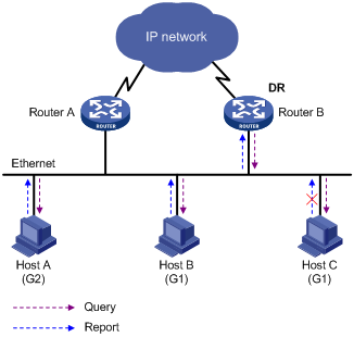

Figure 1 IGMP queries and reports
As shown in Figure 1, assume that Host B and Host C receive multicast data addressed to multicast group G1, and Host A receive multicast data addressed to G2. The following process describes how the hosts join the multicast groups and how the IGMP querier (Router B in the figure) maintains the multicast group memberships:
1.     The hosts send unsolicited IGMP reports to the addresses of the multicast groups that they want to join, without having to wait for the IGMP queries from the IGMP querier.
2.     The IGMP querier periodically multicasts IGMP queries (with the destination address of 224.0.0.1) to all hosts and routers on the local subnet.
3.     After receiving a query message, Host B or Host C (the delay timer of whichever expires first) sends an IGMP report to the multicast group address of G1, to announce its membership for G1. Assume that Host B sends the report message. After receiving the report from Host B, Host C (which is on the same subnet as Host B) suppresses its own report for G1, because the IGMP routers (Router A and Router B) have already known that at least one host on the local subnet is interested in G1. This mechanism (known as "IGMP report suppression") helps reduce traffic on the local subnet.
4.     At the same time, because Host A is interested in G2, it sends a report to the multicast group address of G2.
5.     Through the query/report process, the IGMP routers determine that members of G1 and G2 are attached to the local subnet, and the multicast routing protocol (PIM, for example) that is running on the routers generates (*, G1) and (*, G2) multicast forwarding entries. These entries will be the basis for subsequent multicast forwarding, where the asterisk (*) represents any multicast source.
6.     When the multicast data addressed to G1 or G2 reaches an IGMP router, because the (*, G1) and (*, G2) multicast forwarding entries exist on the IGMP router, the router forwards the multicast data to the local subnet, and then the receivers on the subnet receive the data.

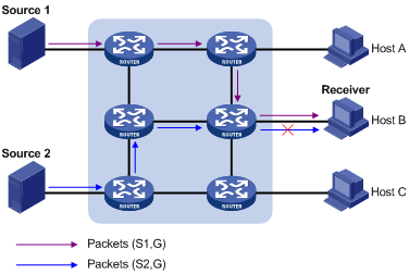

As shown in Figure 2, the network comprises two multicast sources, Source 1 (S1) and Source 2 (S2), both of which can send multicast data to multicast group G. Host B is interested only in the multicast data that Source 1 sends to G but not in the data from Source 2.
Figure 2 Flow paths of source-and-group-specific multicast traffic
In the case of IGMPv1 or IGMPv2, Host B cannot select multicast sources when it joins multicast group G. Therefore, multicast streams from both Source 1 and Source 2 will flow to Host B whether it needs them or not.
When IGMPv3 is running between the hosts and routers, Host B can explicitly express that it needs to receive the multicast data that Source 1 sends to multicast group Gdenoted as (S1, G), rather than the multicast data that Source 2 sends to multicast group Gdenoted as (S2, G). Thus, only multicast data from Source 1 will be delivered to Host B.

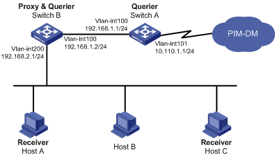

IGMP proxying
In a simple tree-shaped topology, it is not necessary to configure multicast routing protocols, such as PIM, on edge devices. Instead, you can configure IGMP proxying on these devices. With IGMP proxying configured, the device serves as a proxy for the downstream hosts to send IGMP messages, maintain group memberships, and implement multicast forwarding based on the memberships. In this case, each edge device is a host but no longer a PIM neighbor to the upstream device.
Figure 4 Network diagram
As shown in Figure 4, the following types of interfaces are defined on an IGMP proxy device:
·     Upstream interface—Also called the "proxy interface." A proxy interface is an interface on which IGMP proxying is configured. It is in the direction toward the root of the multicast forwarding tree. An upstream interface acts as a host that is running IGMP. Therefore, it is also called the "host interface."
·     Downstream interface—An interface that is running IGMP and is not in the direction toward the root of the multicast forwarding tree. A downstream interface acts as a router that is running IGMP. Therefore, it is also called the "router interface."
An IGMP proxy device maintains a group membership database, which stores the group memberships on all the downstream interfaces. Each entry comprises the multicast address, filter mode, and source list. Such an entry is a collection of members in the same multicast group on each downstream interface.
An IGMP proxy device performs host functions on the upstream interface based on the database. It responds to queries according to the information in the database or sends join/leave messages when the database changes. On the other hand, the IGMP proxy device performs router functions on the downstream interfaces by participating in the querier election, sending queries, and maintaining memberships based on the reports.

Configuring IGMP proxying
Before you configure the IGMP proxying feature, complete the following tasks:
·     Configure any unicast routing protocol so that all devices in the domain are interoperable at the network layer.
·     Enable IP multicast routing.
Enabling IGMP proxying
You can enable IGMP proxying on the interface in the direction toward the root of the multicast forwarding tree to make the device serve as an IGMP proxy.
Configuration guidelines
·     Each device can have only one interface serving as the proxy interface. In scenarios with multiple instances, IGMP proxying is configured on only one interface per instance.
·     You cannot enable IGMP on an interface with IGMP proxying enabled. Moreover, only the igmp require-router-alert, igmp send-router-alert, and igmp version commands can take effect on such an interface.
·     You cannot enable other multicast routing protocols (such as PIM-DM or PIM-SM) on an interface with IGMP proxying enabled, or vice versa. However, the source-lifetime, source-policy, and ssm-policy commands configured in PIM view can still take effect. In addition, in IGMPv1, the designated router (DR) is elected by the working multicast routing protocol (such as PIM) to serve as the IGMP querier. Therefore, a downstream interface running IGMPv1 cannot be elected as the DR and thus cannot serve as the IGMP querier.
·     You cannot enable IGMP proxying on a VLAN interface with IGMP snooping enabled, or vice versa.
Configuration procedure
To enable IGMP proxying:
Step
Remarks
N/A
2.     Enter interface view.
N/A
3.     Enable the IGMP proxying feature.
igmp proxying enable
Disabled by default.
Configuring multicast forwarding on a downstream interface
CAUTION:
On a multi-access network with more than one IGMP proxy device, you cannot enable multicast forwarding on any other non-querier downstream interface after one of the downstream interfaces of these IGMP proxy devices has been elected as the querier. Otherwise, duplicate multicast flows might be received on the multi-access network.
Only queriers can forward multicast traffic but non-queriers have no multicast forwarding capabilities, to avoid duplicate multicast flows. It is the same on IGMP proxy devices. Only the downstream interfaces acting as a querier can forward multicast traffic to downstream hosts.
However, when a downstream interface of a proxy device fails to win the querier election, you must enable multicast forwarding on this interface.
To enable multicast forwarding on a downstream interface:
Step
Remarks
N/A
N/A
3.     Enable multicast forwarding on a non-querier downstream interface.
igmp proxying forwarding

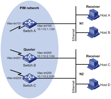

Basic IGMP functions configuration example
Network requirements
As shown in Figure 5, receivers receive VOD information through multicast. Receivers of different organizations form stub networks N1 and N2, and Host A and Host C are receivers in N1 and N2 respectively.
IGMPv2 runs between Switch A and N1. IGMPv2 runs between the other two switches and N2. Switch B acts as the IGMP querier in N2 because it has a lower IP address.
The hosts in N1 can join only multicast group 224.1.1.1, and the hosts in N2 can join any multicast groups.
Figure 5 Network diagram
1.     Configure the IP address and subnet mask of each interface as shown in Figure 5. (Details not shown.)
2.     Configure OSPF for interoperation on the PIM network to make sure that the network-layer is interoperable on the PIM network and routing information among the switches can be dynamically updated. (Details not shown.)
3.     Enable IP multicast routing, and enable PIM-DM and IGMP:
# Enable IP multicast routing on Switch A, enable PIM-DM on each interface, and enable IGMP on VLAN-interface 100.
<SwitchA> system-view
[SwitchA] multicast routing-enable
[SwitchA-Vlan-interface100] igmp enable
[SwitchA-Vlan-interface100] pim dm
[SwitchA] interface vlan-interface 101
[SwitchA-Vlan-interface101] pim dm
[SwitchA-Vlan-interface101] quit
# Enable IP multicast routing on Switch B, enable PIM-DM on each interface, and enable IGMP on VLAN-interface 200.
<SwitchB> system-view
[SwitchB] multicast routing-enable
[SwitchB] interface vlan-interface 200
[SwitchB-Vlan-interface200] igmp enable
[SwitchB-Vlan-interface200] pim dm
[SwitchB-Vlan-interface200] quit
[SwitchB] interface vlan-interface 201
[SwitchB-Vlan-interface201] pim dm
[SwitchB-Vlan-interface201] quit
# Enable IP multicast routing on Switch C, enable PIM-DM on each interface, and enable IGMP on VLAN-interface 200.
<SwitchC> system-view
[SwitchC] multicast routing-enable
[SwitchC] interface vlan-interface 200
[SwitchC-Vlan-interface200] igmp enable
[SwitchC-Vlan-interface200] pim dm
[SwitchC-Vlan-interface200] quit
[SwitchC] interface vlan-interface 202
[SwitchC-Vlan-interface202] pim dm
[SwitchC-Vlan-interface202] quit
4.     Configure a multicast group filter on Switch A, so that the hosts connected to VLAN-interface 100 can join only multicast group 224.1.1.1.
[SwitchA] acl number 2001
[SwitchA-acl-basic-2001] rule permit source 224.1.1.1 0
[SwitchA-acl-basic-2001] quit
[SwitchA-Vlan-interface100] igmp group-policy 2001
Use the display igmp interface command to view the IGMP configuration and operation status on each switch interface. For example:
# Display IGMP information on VLAN-interface 200 of Switch B.
[SwitchB] display igmp interface vlan-interface 200
 Vlan-interface200(10.110.2.1):
   IGMP is enabled
   Current IGMP version is 2
   Value of query interval for IGMP(in seconds): 60
   Value of other querier present interval for IGMP(in seconds): 125
   Value of maximum query response time for IGMP(in seconds): 10
   Querier for IGMP: 10.110.2.1 (this router)
  Total 1 IGMP Group reported

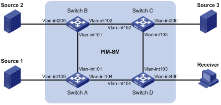

SSM mapping configuration example
As shown in Figure 6, the PIM-SM domain applies both the ASM model and SSM model for multicast delivery. Switch D's VLAN-interface 104 serves as the C-BSR and C-RP. The SSM group range is 232.1.1.0/24.
IGMPv3 runs on Switch D's VLAN-interface 400. The receiver host runs IGMPv2, and does not support IGMPv3. Therefore, the Receiver host cannot specify expected multicast sources in its membership reports.
Source 1, Source 2, and Source 3 send multicast packets to multicast groups in the SSM group range. You can configure the IGMP SSM mapping feature on Switch D so that the receiver host will receive multicast data from Source 1 and Source 3 only.
Figure 6 Network diagram
Device
Interface
IP address
Device
Interface
IP address
Source 1
133.133.1.1/24
Source 3
133.133.3.1/24
Source 2
133.133.2.1/24
Receiver
133.133.4.1/24
Switch A
Vlan-int100
133.133.1.2/24
Switch C
Vlan-int300
133.133.3.2/24
Switch A
Vlan-int101
192.168.1.1/24
Switch C
Vlan-int103
192.168.3.1/24
Switch A
Vlan-int104
192.168.4.2/24
Switch C
Vlan-int102
192.168.2.2/24
Switch B
Vlan-int200
133.133.2.2/24
Switch D
Vlan-int400
133.133.4.2/24
Switch B
Vlan-int101
192.168.1.2/24
Switch D
Vlan-int103
192.168.3.2/24
Switch B
Vlan-int102
192.168.2.1/24
Switch D
Vlan-int104
192.168.4.1/24
1.     Configure the IP address and subnet mask of each interface as shown in Figure 6. (Details not shown.)
2.     Configure OSPF on the switches to make sure the network-layer is interoperable on the PIM-SM domain and routing information among the switches can be dynamically updated. (Details not shown.)
3.     Enable IP multicast routing, enable PIM-SM on each interface, and enable IGMP and IGMP SSM mapping on the host-side interface:
# Enable IP multicast routing on Switch D, enable PIM-SM on each interface, and enable IGMPv3 and IGMP SSM mapping on VLAN-interface 400.
<SwitchD> system-view
[SwitchD] multicast routing-enable
[SwitchD] interface vlan-interface 400
[SwitchD-Vlan-interface400] igmp enable
[SwitchD-Vlan-interface400] igmp version 3
[SwitchD-Vlan-interface400] igmp ssm-mapping enable
[SwitchD-Vlan-interface400] pim sm
[SwitchD-Vlan-interface400] quit
[SwitchD] interface vlan-interface 103
[SwitchD-Vlan-interface103] pim sm
[SwitchD-Vlan-interface103] quit
[SwitchD] interface vlan-interface 104
[SwitchD-Vlan-interface104] pim sm
[SwitchD-Vlan-interface104] quit
# Enable IP multicast routing on Switch A, and enable PIM-SM on each interface.
[SwitchA-Vlan-interface100] pim sm
[SwitchA-Vlan-interface101] pim sm
[SwitchA] interface vlan-interface 104
[SwitchA-Vlan-interface104] pim sm
[SwitchA-Vlan-interface104] quit
# Enable IP multicast routing and PIM-SM on Switch B and Switch C in the same way. (Details not shown.)
4.     Configure C-BSR and C-RP interfaces on Switch D.
[SwitchD] pim
[SwitchD-pim] c-bsr vlan-interface 104
[SwitchD-pim] c-rp vlan-interface 104
[SwitchD-pim] quit
5.     Configure the SSM group range:
# Configure the SSM group range 232.1.1.0/24 on Switch D.
[SwitchD] acl number 2000
[SwitchD-acl-basic-2000] rule permit source 232.1.1.0 0.0.0.255
[SwitchD-acl-basic-2000] quit
[SwitchD] pim
[SwitchD-pim] ssm-policy 2000
[SwitchD-pim] quit
# Configure the SSM group range on Switch A, Switch B and Switch C in the same way. (Details not shown.)
6.     Configure IGMP SSM mappings on Switch D.
[SwitchD] igmp
[SwitchD-igmp] ssm-mapping 232.1.1.0 24 133.133.1.1
[SwitchD-igmp] ssm-mapping 232.1.1.0 24 133.133.3.1
[SwitchD-igmp] quit
# Display the IGMP SSM mapping information for multicast group 232.1.1.1 on Switch D.
[SwitchD] display igmp ssm-mapping 232.1.1.1
Vpn-Instance: public net
Group: 232.1.1.1
Source list:
             133.133.1.1
             133.133.3.1
# Display the IGMP group information created based on the IGMP SSM mappings on Switch D.
[SwitchD] display igmp ssm-mapping group
Total 1 IGMP SSM-mapping Group(s).
Interface group report information of VPN-Instance: public net
 Vlan-interface400(133.133.4.2):
  Total 1 IGMP SSM-mapping Group reported
   Group Address       Last Reporter   Uptime      Expires
   232.1.1.1           133.133.4.1     00:02:04    off
# Display PIM routing table information on Switch D.
[SwitchD] display pim routing-table
Vpn-instance: public net
Total 0 (*, G) entry; 2 (S, G) entry
 (133.133.1.1, 232.1.1.1)
     Protocol: pim-ssm, Flag:
     UpTime: 00:13:25
     Upstream interface: Vlan-interface104
         Upstream neighbor: 192.168.4.2
         RPF prime neighbor: 192.168.4.2
     Downstream interface(s) information:
       Total number of downstreams: 1
         1: Vlan-interface400
                 Protocol: igmp, UpTime: 00:13:25, Expires: -
 (133.133.3.1, 232.1.1.1)
     UpTime: 00:13:25
     Upstream interface: Vlan-interface103
         Upstream neighbor: 192.168.3.1
         RPF prime neighbor: 192.168.3.1
IGMP proxying configuration example
As shown in Figure 7, PIM-DM runs on the core network. Host A and Host C in the stub network receive VOD information destined to multicast group 224.1.1.1.
Configure the IGMP proxying feature on Switch B so that Switch B can maintain group memberships and forward multicast traffic without running PIM-DM.
Figure 7 Network diagram
1.     Configure the IP address and subnet mask of each interface as shown in Figure 7. (Details not shown.)
2.     Enable IP multicast routing, PIM-DM, IGMP, and IGMP proxying:
# Enable IP multicast routing on Switch A, PIM-DM on VLAN-interface 101, and IGMP on VLAN-interface 100.
# Enable IP multicast routing on Switch B, IGMP proxying on VLAN-interface 100, and IGMP on VLAN-interface 200.
[SwitchB-Vlan-interface100] igmp proxying enable
# Display IGMP configuration information on VLAN-interface 100 of Switch B.
[SwitchB] display igmp interface vlan-interface 100 verbose
 Vlan-interface100(192.168.1.2):
   IGMP proxy is enabled
   Multicast routing on this interface: enabled
   Require-router-alert: disabled
   Version1-querier-present-timer-expiry: 00:00:20
# Display IGMP group information on Switch A.
[SwitchA] display igmp group
Total 1 IGMP Group(s).
 Vlan-interface100(192.168.1.1):
  Total 1 IGMP Groups reported
   224.1.1.1       192.168.1.2     00:02:04    00:01:15
The output shows that IGMP reports from the hosts are forwarded to Switch A through the proxy interface, VLAN-interface 100 on Switch B.
