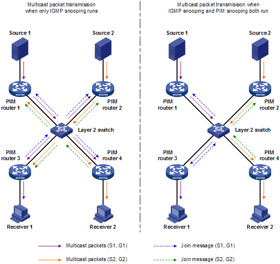

Overview
Protocol Independent Multicast (PIM) snooping runs on Layer 2 devices. It determines which ports are interested in multicast data by analyzing the received PIM messages, and adds the ports to a multicast forwarding entry to make sure that multicast data can be forwarded to only the ports that are interested in the data.
Figure 1 Multicast packet transmission without or with PIM snooping
As shown in Figure 1, Source 1 sends multicast data to multicast group G1, and Source 2 sends multicast data to multicast group G2. Receiver 1 belongs to G1, and Receiver 2 belongs to G2. The Layer 2 switch's interfaces that connect to the PIM-capable routers are in the same VLAN.
·     When running IGMP snooping without PIM snooping, the Layer 2 switch maintains the router ports according to PIM hello messages received from PIM-capable routers, broadcasts all other types of received PIM messages in the VLAN, and forwards all multicast data to all router ports in the VLAN. Each PIM-capable router in the VLAN, whether interested in the multicast data or not, will receive all multicast data and all PIM messages except for PIM hello messages.
·     When running both IGMP snooping and PIM snooping, the Layer 2 switch determines whether PIM-capable routers are interested in the multicast data addressed to a multicast group according to PIM messages received from the routers, and adds only the ports for connecting the routers that are interested in the data to a multicast forwarding entry. Then, the Layer 2 switch forwards PIM messages and multicast data to only the routers that are interested in the data, saving network bandwidth.

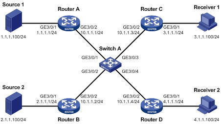

PIM snooping configuration example
Network requirements
As shown in Figure 2, Source 1 sends multicast data to multicast group 224.1.1.1, and Source 2 sends multicast data to multicast group 225.1.1.1. Receiver 1 belongs to multicast group 224.1.1.1, and Receiver 2 belongs to multicast group 225.1.1.1. Router C and Router D run IGMP on their interface GigabitEthernet 3/0/1. Router A, Router B, Router C, and Router D run PIM-SM, and interface GigabitEthernet 3/0/2 on Router A acts as a C-BSR and C-RP.
Configure IGMP snooping and PIM snooping on Switch A so that Switch A forwards PIM messages and multicast data to only the routers that are interested in the multicast data.
Figure 2 Network diagram
Configuration procedure
1.     Configure an IP address and subnet mask for each interface according to Figure 2. (Details not shown.)
2.     On Router A, enable IP multicast routing, enable PIM-SM on each interface, and configure interface GigabitEthernet 3/0/2 as the C-BSR and the C-RP.
<RouterA> system-view
[RouterA] multicast routing-enable
[RouterA] interface GigabitEthernet 3/0/1
[RouterA-GigabitEthernet3/0/1] pim sm
[RouterA-GigabitEthernet3/0/1] quit
[RouterA] interface GigabitEthernet 3/0/2
[RouterA-GigabitEthernet3/0/2] pim sm
[RouterA-GigabitEthernet3/0/2] quit
[RouterA] pim
[RouterA-pim] c-bsr GigabitEthernet 3/0/2
[RouterA-pim] c-rp GigabitEthernet 3/0/2
3.     On Router B, enable IP multicast routing, and enable PIM-SM on each interface.
<RouterB> system-view
[RouterB] multicast routing-enable
[RouterB] interface GigabitEthernet 3/0/1
[RouterB-GigabitEthernet3/0/1] pim sm
[RouterB-GigabitEthernet3/0/1] quit
[RouterB] interface GigabitEthernet 3/0/2
[RouterB-GigabitEthernet3/0/2] pim sm
4.     On Router C, enable IP multicast routing, enable PIM-SM on each interface, and enable IGMP on GigabitEthernet 3/0/1.
<RouterC> system-view
[RouterC] multicast routing-enable
[RouterC] interface GigabitEthernet 3/0/1
[RouterC-GigabitEthernet3/0/1] pim sm
[RouterC-GigabitEthernet3/0/1] igmp enable
[RouterC-GigabitEthernet3/0/1] quit
[RouterC] interface GigabitEthernet 3/0/2
[RouterC-GigabitEthernet3/0/2] pim sm
5.     Enable IP multicast routing, PIM-SM, and IGMP on Router D in the same way. (Details not shown.)
6.     Configure Switch A:
# Enable IGMP snooping globally.
<SwitchA> system-view
[SwitchA] igmp-snooping
[SwitchA-igmp-snooping] quit
# Create VLAN 100, assign GigabitEthernet 3/0/1 through GigabitEthernet 3/0/4 to this VLAN, and enable IGMP snooping and PIM snooping in the VLAN.
[SwitchA] vlan 100
[SwitchA-vlan100] port GigabitEthernet 3/0/1 to GigabitEthernet 3/0/4
[SwitchA-vlan100] igmp-snooping enable
[SwitchA-vlan100] pim-snooping enable
[SwitchA-vlan100] quit
# On Switch A, display the PIM snooping neighbor information of VLAN 100.
[SwitchA] display pim-snooping neighbor vlan 100
  Total number of neighbors: 4
  VLAN ID: 100
    Neighbor        Port                          Expires   Option Flags
    10.1.1.1        GE3/0/1                       02:02:23  LAN Prune Delay
    10.1.1.2        GE3/0/2                       03:00:05  LAN Prune Delay
    10.1.1.3        GE3/0/3                       02:22:13  LAN Prune Delay
    10.1.1.4        GE3/0/4                       03:07:22  LAN Prune Delay
The output shows that Router A, Router B, Router C, and Router D are PIM snooping neighbors.
# On Switch A, display the PIM snooping routing information of VLAN 100.
[SwitchA] display pim-snooping routing-table vlan 100
  Total 2 entry(ies)
  FSM Flag: NI-no info, J-join, PP-prune pending
  VLAN ID: 100
    Total 2 entry(ies)
    (*, 224.1.1.1)
      Upstream neighbor: 10.1.1.1
        Total number of downstream ports: 1
          1: GE3/0/3
    (*, 225.1.1.1)
      Upstream neighbor: 10.1.1.2
          1: GE3/0/4
The output shows that Switch A will forward the multicast data intended for multicast group 224.1.1.1 to only Router C, and forward the multicast data intended for multicast group 225.1.1.1 to only Router D.
