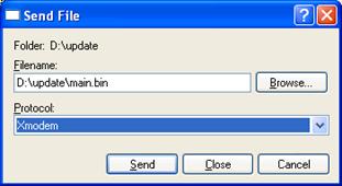

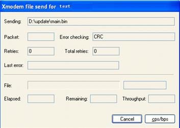

Updating the extended BootWare segment
If the extended BootWare segment has been corrupted, enter 2 in the BASIC-BOOTWARE menu to update it.
Enter your choice(0-5): 2
Please Start To Transfer File, Press <Ctrl+C> To Exit.
Waiting ...CCCCC
Download successfully!
329344 bytes downloaded!
Updating Extend BootWare? [Y/N]Y
Updating Extend BootWare...............Done!

4.     On the configuration terminal, configure the communication settings and transfer the upgrade file. For more information, see "Using XMODEM to upgrade software through the console port."
In this example, when the file transfer is complete, the system sets the file as the main system software image. The following is the sample output:
Loading...................................................................
..................................Done!
47979456 bytes downloaded!
Updating File cfa0:/test.bin..............................................
..Done!

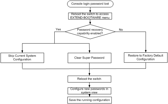

Clearing console login password
IMPORTANT
IMPORTANT:
·     To perform this task, make sure password recovery capability is enabled. If the capability is disabled, you cannot perform this task.
·     This is a one-time operation. The configuration takes effect only for the first system boot or reboot (option 1 and option 0 in the EXTEND-BOOTWARE menu) after you perform the operation. If you do not save the running configuration, the original settings continue to take effect for the subsequent reboot.
If you cannot remember the console login password, enter 7 in the EXTEND-BOOTWARE menu to clear the password, and then configure a new password and save the running configuration.
Enter your choice(0-9): 7
Clear Application Password Success!
For more information about the console login password, see "Logging in to the CLI."

Disabling password recovery capability
Password recovery capability controls console user access to the device configuration and SDRAM from BootWare menus. This feature also determines the method for dealing with console login password loss (see Figure 1).
If password recovery capability is enabled, a console user can access the device configuration without authentication to configure new passwords.
If password recovery capability is disabled, console users must restore the factory-default configuration before they can configure new passwords. Restoring the factory-default configuration deletes the next-startup configuration files.
To enhance system security, disable password recovery capability.
Figure 1 Dealing with console login password loss
Table 15 summarizes options whose availability varies with the password recovery capability setting.
Table 15 BootWare options and password recovery capability compatibility matrix
BootWare menu option
Password recovery enabled
Password recovery disabled
Tasks that can be performed
Download Application Program To SDRAM And Run
Yes
No
Load and run the system software image in SDRAM.
Update User Private File
Yes
No
Download a file to the current storage medium.
Clear Super Password
Yes
No
Clear the console login password to allow console login without authentication.
This is a one-time operation and takes effect only for the first system boot or reboot after you choose this option.
Modify Chassis ID Operation
Yes
No
Switch between IRF mode and standalone mode and change the member ID of the device. For more information about IRF, see IRF Configuration Guide.
Skip Current System Configuration
Yes
No
Load the factory-default configuration without deleting the next-startup configuration file.
This is a one-time operation and takes effect only for the first system boot or reboot after you perform the operation.
Restore to Factory Default Configuration
No
Yes
Delete the next-startup configuration file and load the factory-default configuration.
To disable password recovery capability:
Step
Remarks
N/A
2.     Disable password recovery capability.
undo password-recovery enable
Enabled by default.

6.     Select Transfer > Send File in the HyperTerminal window. In the dialog box that appears, click Browse to select the source file, and select Xmodem from the Protocol list.
Figure 2 File transmission dialog box
7.     Click Send.
The following dialog box appears:
Figure 3 File transfer progress
After the file transfer is complete, the Serial submenu appears again. You can choose other options as required.
