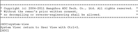

At the command-line interface (CLI), you can enter text commands to configure, manage, and monitor your switch.
Figure 1 CLI example
The output depends on the switch model.

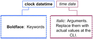

The following example analyzes the syntax of the clock datetime time date command according to Table 1.
Figure 2 Understanding command-line parameters
For example, to set the system time to 10:30:20, February 23, 2010, enter the following command line at the CLI and press Enter:
<Sysname> clock datetime 10:30:20 2/23/2010

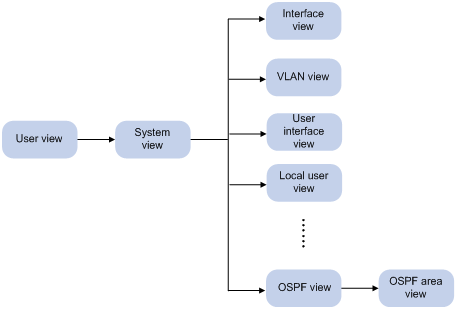

CLI views
Commands are grouped in different views by function. To use a command, you must enter the view of the command.
CLI views are organized in a hierarchical structure, as shown in Figure 3. Each view has a unique prompt, from which you can identify where you are and what you can do. For example, the prompt [Sysname-vlan100] shows that you are in the view of VLAN 100 and can configure attributes for the VLAN.
You are placed in user view immediately after you are logged in to the CLI. The user view prompt is <Device-name>, where the Device-name argument can be changed by using the sysname command. In user view, you can perform displaying, debugging, file management, FTP, and Telnet operations, set the system time, and restart your switch. For more information about the sysname command, see Fundamentals Command Reference.
From user view, you can enter system view to configure global settings, including the daylight saving time, banners, and short-cut keys. The system view prompt is [Device-name].
From system view, you can enter different function views. For example, you can enter interface view to configure interface parameters, enter VLAN view to add ports to the specific VLAN, enter user interface view to configure login user attributes, or create a local user and enter local user view to configure attributes for the local user.
To display all commands available in a view, enter a question mark (?) at the view prompt.
Figure 3 CLI view hierarchy
