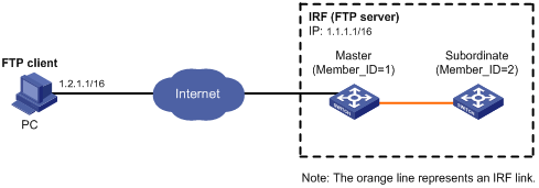

Figure 1 FTP application scenario

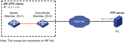

FTP client configuration example (IRF mode)
Network requirements
As shown in Figure 3:
·           The device is an IRF fabric, which is composed of a master and a subordinate device. The member ID of the master is 1, and the slot numbers of the active MPU and the standby MPU on the master are 0 and 1 respectively. The member ID of the subordinate device is 2, and the slot numbers of the active MPU and standby MPU on the subordinate device are 0 and 1 respectively.
·           The device serves as an FTP client. The PC serves as the FTP server. They can reach each other.
·           On the PC, an FTP user account has been created for the FTP client, with the username abc and the password abc.
From the device, download a system software image file from the PC for upgrade, and upload the configuration file to the PC for backup.
Figure 3 Network diagram

[ftp] get newest.bin chassis1#slot1#flash:/newest.bin
227 Entering Passive Mode (10,1,1,1,10,68).
125 BINARY mode data connection already open, transfer starting for chassis1#slot1#flash:/newest.bin.
226 Transfer complete.
FTP: 23951480 byte(s) received in 95.399 second(s), 251.00K byte(s)/sec.

FTP server configuration example (IRF mode)
As shown in Figure 5, an IRF fabric comprises a master and a subordinate device. The member ID of the master is 1, and the slot numbers of the active MPU and the standby MPU on the master are 0 and 1 respectively. The member ID of the subordinate device is 2, and the slot numbers of the active MPU and standby MPU on the subordinate device are 0 and 1 respectively. The IRF fabric and the PC are reachable to each other.
Use the IRF fabric serves as an FTP server, and create an FTP user account with the username abc and password abc for the FTP client. From the IRF fabric, download a system software image file from PC for upgrade, and uploads the configuration file to PC for backup.
Figure 5 Network diagram
