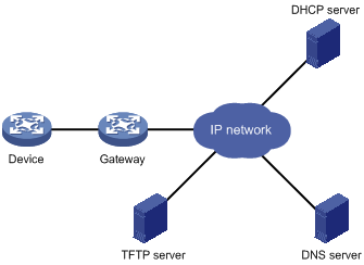

Typical automatic configuration network
Figure 1 Network diagram
As shown in Figure 1, the device implements automatic configuration with the cooperation of the following servers:
·     DHCP server—Assigns an IP address and other configuration parameters such as the configuration file name, TFTP server IP address, and DNS server IP address to the device.
·     TFTP server—Saves files needed in automatic configuration. The device gets the files needed from the TFTP server, such as the host name file that saves mappings between host IP addresses and host names, and the configuration file.
·     DNS server—Resolves between IP addresses and host names. In some cases, the device resolves its IP address to the corresponding host name through the DNS server, and then uses the host name to request the configuration file with the same name (hostname.cfg) from the TFTP server. If the device gets the domain name of the TFTP server from the DHCP response, the device can also resolve the domain name of the TFTP server to the IP address of the TFTP server through the DNS server.
If the DHCP server, TFTP server, DNS server, and the device are not in the same network segment, you must configure the DHCP relay agent on the gateway, and configure routing protocols to enable each server and the device to reach one another.

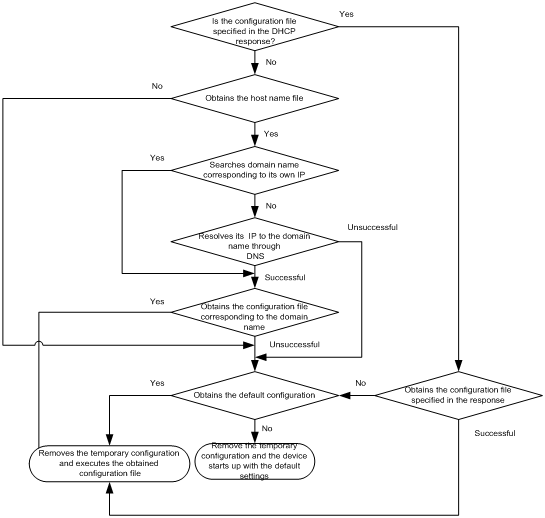

Obtaining the configuration file
Figure 3 Obtaining the configuration file
A device obtains its configuration file by using the following workflow:
·     If the DHCP response contains the configuration file name, the device requests the specified configuration file from the TFTP server.
·     If not, the device tries to get its host name from the host name file obtained from the TFTP server. If it fails, the device resolves its IP address to the host name through DNS server. Once the device gets its host name, it requests the configuration file with the same name from the TFTP server.
·     If all the above operations fail, the device requests the default configuration file from the TFTP server.

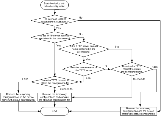

TFTP request sending mode
The device determines whether to unicast or broadcast a TFTP request by using the following work flow:
·     If a legitimate TFTP server IP address is contained in the DHCP response, the device unicasts a TFTP request to the TFTP server.
·     If not, the device resolves the TFTP server domain name contained in the DHCP response to the corresponding IP address through the DNS server. If successful, the device unicasts a TFTP request to the TFTP server; if not, the device broadcasts a TFTP request.
·     If the IP address and the domain name of the TFTP server are not contained in the DHCP response or they are illegitimate, the device broadcasts a TFTP request.
After broadcasting a TFTP request, the device selects the TFTP server that responds first to obtain the configuration file. If the requested configuration file does not exist on the TFTP server, the request operation fails, and the device removes the temporary configuration and starts up with factory defaults.
