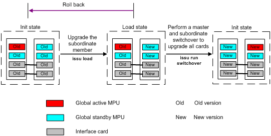

Member switch-based ISSU upgrade for compatible and partially compatible versions
With this method, each member switch is considered as a separate switch.
To perform a member switch-based ISSU upgrade for a compatible or partially compatible version:
1.     Upgrade a subordinate switch when the master is operating correctly.
2.     Set the priority of the subordinate switch so that the subordinate switch has a higher priority than the master.
3.     Perform a master/subordinate switchover so that the subordinate switch becomes the new master.
4.     Upgrade the former master and the other switches one by one.
This method does not require upgrade hotfixes in the system software image. It upgrades each member switch through switch reboot, thus causing a brief interruption to the traffic passing through the member switches. H3C recommends that you aggregate links on different interface cards or even different switches to avoid traffic interruption during the upgrade process.
This method is not applicable when the version compatibility check result is incompatible.

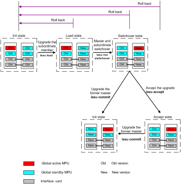

Member switch-based ISSU upgrade for incompatible versions
To perform a member switch-based ISSU upgrade for an incompatible version:
2.     Perform a master/subordinate switchover, so that the subordinate switch becomes the new master and the former master and the other switches get upgraded.
This method requires that the IRF connection is a ring connection if there are more than two members. If you do not follow this guideline, the IRF fabric will be partitioned during upgrade and the upgrade process will be out of control.
This method is not applicable when the version compatibility check result is compatible or partially compatible.

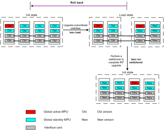

Member switches-based ISSU upgrade (for incompatible versions only)
With this method, multiple member switches are considered as a whole.
To perform a member switches-based ISSU upgrade:
1.     When the master is operating correctly, upgrade two or more subordinate switches.
2.     Perform a master/subordinate switchover so that an upgraded subordinate switch (the one with the highest priority) becomes the new master and the former master and the other switches get upgraded.
This method requires that the IRF connection is a ring connection if there are more than two members. If you do not follow this guideline, the IRF will be partitioned during upgrade and the upgrade process will be out of control.
The subordinate switches to be upgraded first must be physically connected.
This method is a good choice for upgrading a four-member IRF fabric. By upgrading more than one member first, this method helps improve the reliability of the ISSU upgrade and the service continuity during the upgrade.

Figure 2 Member switch-based upgrade for compatible/partially compatible versions
Figure 3 Member switch-based upgrade for incompatible versions
Figure 4 Member switches-based upgrade for incompatible versions

The chassis-number argument is the member ID of the subordinate switch to be upgraded.
Executing this command reboots the subordinate switch.
3.     Perform a manual master/subordinate switchover to upgrade the whole IRF fabric.
issu run switchover [ chassis chassis-number ]
The value of the chassis-number argument provided in this command must be the same as that specified in the issu load command.
Executing this command reboot the former master and the other member switches.
To perform a member switches-based ISSU upgrade for an incompatible version:
Step
Remarks
N/A
2.     Upgrade multiple subordinate switches.
issu load file upgrading-filename { chassis chassis-number } &<2-10> force
The chassis-number argument is the member ID of a subordinate switch to be upgraded. &<2-10> means that you can specify multiple subordinate switches.
Executing this command reboots the specified subordinate switches.
issu run switchover
Executing this command reboots the former master and the member switches that are not upgraded yet (if any).
Performing a version rollback
You might need to cancel the upgrade during an upgrade process, for example, when the new system software image is broken. The ISSU provides the version rollback function to enable the switch in the upgrade process to roll back to the previous version.
Version rollback is triggered by either of the following events:
·     Auto-rollback triggered by rollback timer expiration. With the issu load command executed, the system automatically creates a version rollback timer. If you do not execute the issu accept or issu commit command before the rollback timer expires, the system automatically stops the ISSU process and reverts to the previous software version. If you execute the issu accept or issu commit command, the system deletes the rollback timer and does not perform the rollback operation in this upgrade process.
·     Manual rollback at the CLI. When the switch is in the load, switchover, or accept state, you can use the issu rollback command to reboot the upgraded cards with the system software image of the previous version or delete the upgrade hotfixes. In this case, the system reverts to the previous version and the MPUs resume their former roles.
During a compatible or partially compatible ISSU upgrade, issuing the issu commit command completes the upgrade and disables the version rollback function. To roll back to the previous version, perform a new ISSU upgrade.
During an incompatible ISSU upgrade, issuing the issu run switchover command completes the upgrade, deletes the rollback timer, and disables the version rollback function. To roll back to the previous version, perform a new ISSU upgrade.
IMPORTANT:
Do not perform version rollback immediately after executing the issu load or issu run switch command, and do not give the rollback timer a value shorter than the system boot time. When the standby MPU is in the reboot process and the upgrading process of the standby MPU is not complete, if the rollback timer expires or you perform a manual rollback at this time, the version rollback will fail.

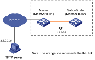

Member switch-based ISSU upgrade example (compatible or partially compatible version)
Network requirements
As shown in Figure 7:
·     The IRF fabric is made up of a master and a subordinate switch. The master has an MPU in slot 0, and the subordinate switch has an active MPU in slot 0 and a standby MPU in slot 1.
·     The current system software image of the IRF fabric is soft-version1. The latest system software image soft-version2.bin is saved on the TFTP server. The two versions are compatible. (This example also applies if the two versions are partially compatible.)
·     The IRF fabric and the TFTP server can reach each other.
Use ISSU to upgrade the software version of the IRF fabric to soft-version2.
Figure 7 Network diagram
Upgrade procedure
1.     Prepare the TFTP server:
Obtain the right system software image for software version upgrade through legal channels (such as H3C official websites, agents, or technical staff), and then save the file to the working path on the TFTP server to make the file accessible to the TFTP client. (Details not shown.)
2.     Upgrade the IRF fabric:

Member switch-based ISSU upgrade example (four members, compatible or partially compatible version)
As shown in Figure 8:
·     The IRF fabric is made up of four member switches. The master has an MPU in slot 0, and each subordinate switch has an active MPU in slot 0 and a standby MPU in slot 1.
Figure 8 Network diagram

[IRF] issu load file soft-version2.bin chassis 2
This command will begin ISSU, and the specified board will reboot and be upgraded. Please save the current running configuration first; otherwise, the configuration may be lost.Continue? [Y/N]:y
# After the subordinate switch reboots, perform a master/subordinate switchover.
[IRF] issu run switchover chassis 2
Master will reboot, switch the specified chassis to master. Continue? [Y/N]:y
# Accept the upgrade to the new master (with the member ID 2).
[IRF] issu accept chassis 2
# Upgrade the former master and the other member switches.
[IRF] issu commit chassis 1
The specified board will reboot and be upgraded. Continue? [Y/N]:y
[IRF] issu commit chassis 3
[IRF] issu commit chassis 4
The ISSU upgrade process is completed and the software of the IRF fabric is upgraded to the new version. The master is now the switch with the member ID 2.

Member switch-based ISSU upgrade example (incompatible version)
As shown in Figure 9:
·     The IRF fabric is made up of two member switches, each of which has an active MPU in slot 0 and a standby MPU in slot 1.
·     The current system software image of the IRF fabric is soft-version1. The latest system software image is soft-version2.bin and is saved on the TFTP server. The two versions are incompatible.
Use ISSU to upgrade the software version of the IRF fabric to soft-version2.bin.
Figure 9 Network diagram
# Download the system software image soft-version2.bin to the root directory of the storage medium on all MPUs of the IRF fabric.
<IRF> tftp 2.2.2.2 get soft-version2.bin
 File will be transferred in binary mode
 Downloading file from remote TFTP server, please wait……

# Upgrade the subordinate switch.
<IRF> system-view
[IRF] save
The current configuration will be written to the device. Are you sure? [Y/N]:Y
Please input the file name(*.cfg)[flash:/config.cfg]
(To leave the existing filename unchanged, press the enter key):
flash:/config.cfg exists, overwrite? [Y/N]:Y
 Validating file. Please wait............................
 The current configuration is saved to the active main board successfully.
 Configuration is saved to device successfully.
[IRF] issu load file soft-version2.bin chassis 2 force
# After the subordinate switch reboots, perform a master/subordinate switchover to complete the IRF fabric upgrade.
3.     Verify the configuration:

Member switch-based ISSU upgrade example (four members, incompatible version)
As shown in Figure 10:
·     The IRF fabric is made up of four member switches, each of which has an active MPU in slot 0 and a standby MPU in slot 1.
Perform a member switch-based ISSU upgrade to upgrade the software version of the IRF fabric to soft-version2.bin.
Figure 10 Network diagram
