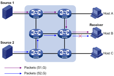

As shown in Figure 2, the network comprises two IPv6 multicast sources, Source 1 (S1) and Source 2 (S2), both of which can send IPv6 multicast data to IPv6 multicast group G. Host B is interested only in the IPv6 multicast data that Source 1 sends to G but not in the data from Source 2.
Figure 2 Flow paths of multicast-address-and-source-specific multicast traffic
In the case of MLDv1, Host B cannot select IPv6 multicast sources when it joins IPv6 multicast group G. Therefore, IPv6 multicast streams from both Source 1 and Source 2 will flow to Host B whether it needs them or not.
When MLDv2 is running on the hosts and routers, Host B can explicitly express its interest in the IPv6 multicast data that Source 1 sends to G—denoted as (S1, G), rather than the IPv6 multicast data that Source 2 sends to G—denoted as (S2, G). Thus, only IPv6 multicast data from Source 1 will be delivered to Host B.

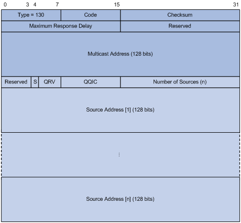

MLD query message
An MLD querier identifies the multicast listening state of neighbor interfaces by sending MLD query messages. The dark area in Figure 3 shows the format of an MLDv1 message.
Figure 3 Format of MLDv2 query message
Table 1 Description on fields in an MLDv2 query message
Field
Description
Type = 130
Message type. For a query message, this field is set to 130.
Code
Initialized to zero
Checksum
Standard IPv6 checksum
Maximum Response Delay
Maximum response delay allowed before a host sends a report message
Reserved
Reserved field and initialized to zero
Multicast Address
·       This field is set to 0 in a general query message.
·       It is set to a specific IPv6 multicast address in a multicast-address-specific query message or multicast-address-and-source-specific query message.
S
Flag indicating whether a router updates the timer for suppression after receiving a query message.
QRV
Querier’s Robustness Variable
QQIC
Querier’s Query Interval Code
Number of Sources
·       This field is set to 0 in a general query message or a multicast-address-specific query message.
·       This field represents the number of source addresses in a multicast-address-and-source-specific query message
Source Address( i )
IPv6 multicast source address in a multicast-address-specific query message (i = 1, 2, .., n, where n represents the number of multicast source addresses.)

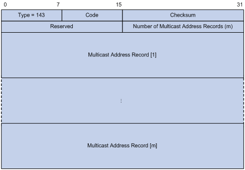

MLD report message
A host sends an MLD report message to report the current multicast listening state Figure 4 shows the format of an MLD report message.
Figure 4 Format of MLDv2 report message
Table 2 Description on fields in an MLDv2 report message
Field
Description
Type = 143
Message type. For a report message, this field is set to 143.
Reserved
The Reserved fields are set to 0 on transmission and ignored on reception.
Checksum
Number of Multicast Address Records
This field indicates how many IPv6 multicast address records are present in this report message.
Multicast Address Record(i)
This field represents information of each IPv6 multicast address the host listens to on the interface from which the report message is sent, including record type, IPv6 multicast address, and IPv6 multicast source address on the sender (i= 1, 2, ... m, where m represents the number of IPv6 multicast address records).

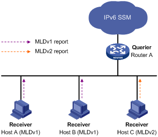

Figure 5 Network diagram
As shown in Figure 5, on an IPv6 SSM network, Host A and Host B are running MLDv1 and Host C is running MLDv2. To provide SSM service for all the hosts if MLDv2 is not available on Host A and Host B, you need to configure the MLD SSM mapping feature on Router A.
With the MLD SSM mapping feature configured, when Router A receives an MLDv1 report, it checks the IPv6 multicast group address G carried in the message:
·           If G is not in the IPv6 SSM group range, Router A cannot provide the SSM service but can provide the ASM service.
·           If G is in the IPv6 SSM group range but no MLD SSM mappings that correspond to the IPv6 multicast group G have been configured on Router A, Router A cannot provide SSM service and drops the packet.
·           If G is in the IPv6 SSM group range, and the MLD SSM mappings have been configured on Router A for multicast group G, Router A translates the (*, G) information in the MLD report into (G, INCLUDE, (S1, S2...)) information based on the configured MLD SSM mappings and provides SSM service accordingly.
·       The MLD SSM mapping feature does not process MLDv2 reports.
·       For more information about the IPv6 SSM group range, see the chapter “Configuring IPv6 PIM.”

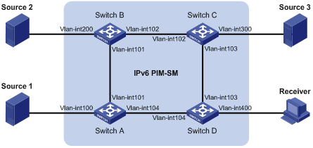

MLD SSM mapping configuration example
Network requirements
As shown in Figure 8, the IPv6 PIM-SM domain applies both the ASM model and SSM model for IPv6 multicast delivery. Switch D’s VLAN-interface 104 serves as the C-BSR and C-RP. The SSM group range is FF3E::/64.
MLDv2 runs on Switch D’s VLAN-interface 400. The receiver host runs MLDv1, and does not support MLDv2. Therefore, the Receiver host cannot specify expected multicast sources in its membership reports.
Source 1, Source 2, and Source 3 send IPv6 multicast packets to multicast groups in the IPv6 SSM group range. You can configure the MLD SSM mapping feature on Switch D so that the receiver host will receive IPv6 multicast data from Source 1 and Source 3 only.
Figure 8 Network diagram
Device
Interface
IPv6 address
Device
Interface
IPv6 address
Source 1
1001::1/64
Source 3
3001::1/64
Source 2
2001::1/64
Receiver
4001::1/64
Switch A
Vlan-int100
1001::2/64
Switch C
Vlan-int300
3001::2/64
Vlan-int101
1002::1/64
Vlan-int103
3002::1/64
Vlan-int104
1003::1/64
Vlan-int102
2002::2/64
Switch B
Vlan-int200
2001::2/64
Switch D
Vlan-int400
4001::2/64
Vlan-int101
1002::2/64
Vlan-int103
3002::2/64
Vlan-int102
2002::1/64
Vlan-int104
1003::2/64
Configuration procedure
1.      Enable IPv6 forwarding and configure IPv6 addresses and IPv6 unicast routing:
Enable IPv6 forwarding on each switch and configure an IPv6 address and prefix length for each interface as shown in Figure 8. (Details not shown)
Configure OSPFv3 for interoperability among the switches. Ensure the network-layer interoperation on the IPv6 PIM-SM domain and dynamic update of routing information among the switches through an IPv6 unicast routing protocol. (Details not shown)
2.      Enable IPv6 multicast routing, enable IPv6 PIM-SM on each interface and enable MLD and MLD SSM mapping on the host-side interface:
# Enable IPv6 multicast routing on Switch D, enable IPv6 PIM-SM on each interface, and enable MLD (version 2) and MLD SSM mapping on VLAN-interface 400.
<SwitchD> system-view
[SwitchD] multicast ipv6 routing-enable
[SwitchD] interface vlan-interface 400
[SwitchD-Vlan-interface400] mld enable
[SwitchD-Vlan-interface400] mld version 2
[SwitchD-Vlan-interface400] mld ssm-mapping enable
[SwitchD-Vlan-interface400] pim ipv6 sm
[SwitchD-Vlan-interface400] quit
[SwitchD] interface vlan-interface 103
[SwitchD-Vlan-interface103] pim ipv6 sm
[SwitchD-Vlan-interface103] quit
[SwitchD] interface vlan-interface 104
[SwitchD-Vlan-interface104] pim ipv6 sm
[SwitchD-Vlan-interface104] quit
# Enable IPv6 multicast routing on Switch A, and enable IPv6 PIM-SM on each interface.
<SwitchA> system-view
[SwitchA] multicast ipv6 routing-enable
[SwitchA-Vlan-interface100] pim ipv6 sm
[SwitchA] interface vlan-interface 101
[SwitchA-Vlan-interface101] pim ipv6 sm
[SwitchA-Vlan-interface101] quit
[SwitchA] interface vlan-interface 104
[SwitchA-Vlan-interface104] pim ipv6 sm
[SwitchA-Vlan-interface104] quit
The configuration on Switch B and Switch C is similar to that on Switch A.
3.      Configure a C-BSR and a C-RP:
# Configure C-BSR and C-RP interfaces on Switch D.
[SwitchD] pim ipv6
[SwitchD-pim6] c-bsr 1003::2
[SwitchD-pim6] c-rp 1003::2
[SwitchD-pim6] quit
4.      Configure the IPv6 SSM group range:
# Configure the IPv6 SSM group range FF3E::/64 on Switch D.
[SwitchD] acl ipv6 number 2000
[SwitchD-acl6-basic-2000] rule permit source ff3e:: 64
[SwitchD-acl6-basic-2000] quit
[SwitchD] pim ipv6
[SwitchD-pim6] ssm-policy 2000
[SwitchD-pim6] quit
The configuration on Switch A, Switch B and Switch C is similar to that on Switch D.
5.      Configure MLD SSM mappings:
# Configure MLD SSM mappings on Switch D.
[SwitchD] mld
[SwitchD-mld] ssm-mapping ff3e:: 64 1001::1
[SwitchD-mld] ssm-mapping ff3e:: 64 3001::1
[SwitchD-mld] quit
6.      Verify the configuration:
# Display the MLD SSM mapping information for IPv6 multicast group FF3E::101 on Switch D.
[SwitchD] display mld ssm-mapping ff3e::101
Group: FF3E::101
Source list:
       1001::1
       3001::1
# Display the IPv6 multicast group information created based on the configured MLD SSM mappings on Switch D.
[SwitchD] display mld ssm-mapping group
Total 1 MLD SSM-mapping Group(s).
Interface group report information
 Vlan-interface400 (4001::2):
  Total 1 MLD SSM-mapping Group reported
   Group Address: FF3E::101
    Last Reporter: 4001::1
    Uptime: 00:02:04
    Expires: off
# Display the IPv6 PIM routing table information on Switch D.
[SwitchD] display pim ipv6 routing-table
Total 0 (*, G) entry; 2 (S, G) entry
 (1001::1, FF3E::101)
     Protocol: pim-ssm, Flag:
     UpTime: 00:13:25
     Upstream interface: Vlan-interface104
         Upstream neighbor: 1003::1
         RPF prime neighbor: 1003::1
     Downstream interface(s) information:
       Total number of downstreams: 1
         1: Vlan-interface400
                 Protocol: mld, UpTime: 00:13:25, Expires: -
 (3001::1, FF3E::101)
     UpTime: 00:13:25
     Upstream interface: Vlan-interface103
         Upstream neighbor: 3002::1
         RPF prime neighbor: 3002::1
