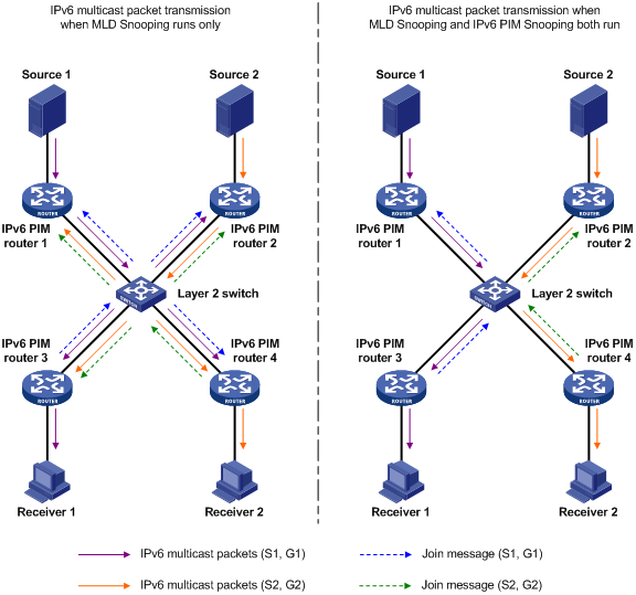

IPv6 Protocol Independent Multicast (PIM) snooping runs on Layer 2 devices. It determines which ports are interested in multicast data by analyzing the received IPv6 PIM messages, and adds the ports to a multicast forwarding entry to make sure that multicast data can be forwarded to only the ports that are interested in the data.
Figure 1 Multicast packet transmission without or with IPv6 PIM snooping
As shown in Figure 1, Source 1 sends multicast data to multicast group G1, and Source 2 sends multicast data to multicast group G2. Receiver 1 belongs to G1, and Receiver 2 belongs to G2. The Layer 2 switch’s interfaces that connect to the IPv6 PIM-capable routers are in the same VLAN.
·           When running MLD snooping without IPv6 PIM snooping, the Layer 2 switch maintains the router ports according to IPv6 PIM hello messages received from IPv6 PIM-capable routers, broadcasts all other types of received IPv6 PIM messages in the VLAN, and forwards all multicast data to all router ports in the VLAN. Each IPv6 PIM-capable router in the VLAN, whether interested in the multicast data or not, will receive all multicast data and all IPv6 PIM messages except for IPv6 PIM hello messages.
·           If the Layer 2 switch runs both MLD snooping and IPv6 PIM snooping, it determines whether an IPv6 PIM-capable router is interested in the multicast data destined for a multicast group according to the received IPv6 PIM messages that the router sends, and adds the port that connects to the router to a multicast forwarding entry. Then, the Layer 2 switch can correctly forward IPv6 PIM messages and the multicast data only to the router according to the multicast forwarding entry, saving network bandwidth.

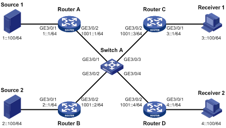

As shown in Figure 2, Source 1 and Source 2 are connected to Router A and Router B, and Receiver 1 and Receiver 2 are connected to Router C and Router D, respectively.
Source 1 sends multicast data to IPv6 multicast group FF1E::101, and Source 2 sends multicast data to IPv6 multicast group FF2E::101. Receiver 1 belongs to multicast group FF1E::101, and Receiver 2 belongs to multicast group FF2E::101. Router C and Router D run MLD on their interface GigabitEthernet 3/0/1. Router A, Router B, Router C, and Router D run IPv6 PIM-SM, and interface GigabitEthernet 3/0/2 on Router A acts as a C-BSR and C-RP.
Configure MLD snooping and IPv6 PIM snooping on Switch A so that Switch A forwards IPv6 PIM messages and multicast data to only the routers that are interested in the multicast data.
Figure 2 Network diagram

The output shows that Switch A will forward the multicast data intended for IPv6 multicast group FF1E::101 to only Router C, and forward the multicast data intended for IPv6 multicast group FF2E::101 to only Router D.
