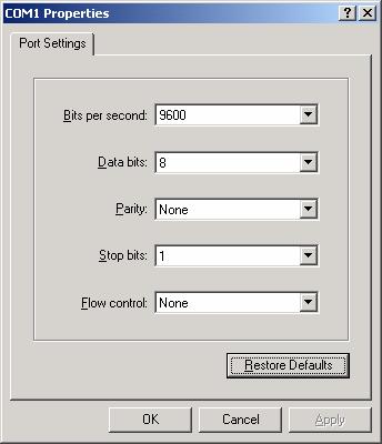

l           The Console cable is not connected to the right serial port, that is, the port in use is not the one configured on the terminal.
l           There are Console terminal parameter errors. (According to the parameter setting requirements, you should set the baud rate to 9600, data bits to 8, parity to None, stop bits to 1, flow control to None, and select VT100 as terminal emulation.)
l           The Console cable is not in good condition.
2)         The terminal gives illegible characters.
This symptom is very likely caused by a Console terminal setting error. In this case, check that you have set the baud rate to 9600, data bits to 8, parity to None, stop bits to 1, flow control to None, and select VT100 as terminal emulation.

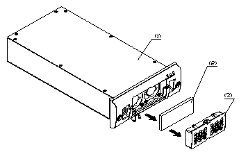

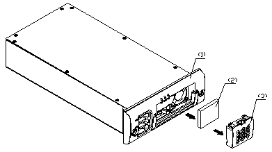

6.2.3  Replacing and Cleaning the Air Filter of PSU
The air filter of AC PSU and DC PSU can be replaced in a similar way even though they have different shapes.
  Caution:
You are strongly recommended to clean the air filter semimonthly to guarantee adequate ventilation.
I. Removing and cleaning the air filter of PSU
Step 1: Clutch the air filter by the upper and lower edges with your index finger and the thumb.
Step 2: Pull the air filter out with an even strength.
Step 3: Take the black air filter mesh out.
Step 4: Clean the mesh and dry it, taking care not to rub it.
Step 5: Place the dry black mesh back in position again.
(1) PSU
(2) Air filter
(3) Air filter cover
Figure 6-3 Remove the air filter of DC PSU
(1) PSU
(2) Air filter
Figure 6-4 Remove the air filter of AC PSU

When loading the host program through the Boot menu, you must configure correct attributes of the serial interface (as shown in Figure 6-9). Otherwise, the HyperTerminal does not respond.
Figure 6-9 Attribute settings of HyperTerminal serial interface

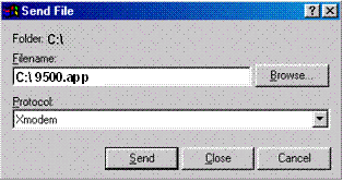

Step 6: Select [Transfer/Send File] in the terminal window. Click on <Browse> in the pop-up dialog box (shown as the following figure), select the desired application, and change the protocol used for downloading to XModem.
Figure 6-10 Send File dialog box

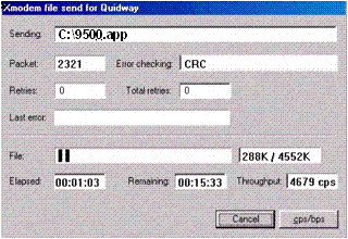

Step 7: Click on <Send> and the following interface pops up.
Figure 6-11 Sending file page
