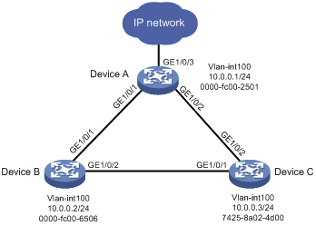

Example: Configuring MAC address move suppression
Network requirements
As shown in Figure 2, Devices A, B, and C form a loop because of cable misconnection, and spanning tree protocols are not enabled on the devices. As a result, MAC addresses are frequently moves among Devices A, B, and C. To deal with loop-triggered MAC flapping, perform the following tasks:
·     Display MAC address move records to locate the Layer 2 loop.
·     Configure MAC address move suppression on Device A to eliminate the Layer 2 loop.
Figure 2 Network diagram
Requirements analysis
To meet the network requirements, you must perform the following tasks:
·     For Devices A, B, and C to communicate with each other, assign all inter-connected ports to VLAN 100.
·     Configure MAC address move suppression on one or more ports of Device A.
·     To monitor the port status change of Device A, enable the log monitoring of the current terminal feature.
·     For loop detection, create VLAN-interface 100 and assign an IP address to the interface on each device.
·     To display MAC address move records, ping Device B from Device A.

# Ping Device B from Device A. (Details not shown.)
# Verify that GigabitEthernet 1/0/1 on Device A is shut down.
[DeviceA] %Dec 11 09:51:06:309 2014 DeviceA IFNET/3/PHY_UPDOWN: -MDC=1; GigabitEt
hernet1/0/1 link status is down.
%Dec 11 09:51:06:323 2014 DeviceA IFNET/5/LINK_UPDOWN: -MDC=1; Line protocol on
# Verify that GigabitEthernet 1/0/1 is shut down because a MAC address move is detected.
[DeviceA] display interface gigabitethernet 1/0/1
GigabitEthernet1/0/1
Current state: mac-address moving down
Line protocol state: DOWN
# Verify that GigabitEthernet 1/0/1 comes up automatically after 300 seconds.
[DeviceA] %Dec 11 09:56:07:002 2014 DeviceA IFNET/3/PHY_UPDOWN: -MDC=1; GigabitEt
hernet1/0/1 link status is up.
%Dec 11 09:56:07:004 2014 DeviceA IFNET/5/LINK_UPDOWN: -MDC=1; Line protocol on
the interface GigabitEthernet1/0/1 is up.
# Verify that the MAC address of Device B's VLAN-interface 100 moves between GigabitEthernet 1/0/1 and GigabitEthernet 1/0/2. You can manually shut down either port to eliminate the loop.
[DeviceA] display mac-address mac-move
MAC address    VLAN Current port  Source port   Last time              Times
0000-fc00-6506  100      GE1/0/2      GE1/0/1   2014-12-11 09:29:48        3
0000-fc00-6506  100      GE1/0/1      GE1/0/2   2014-12-11 09:51:03        4
---  2 MAC address moving records found  ---
