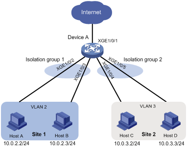

As shown in Figure 1, the company branches Site 1 and Site 2 transfer service traffic in VLAN 2 and VLAN 3. Device A connects to the Internet through Ten-GigabitEthernet 1/0/1.
Configure port isolation on Device A to meet the following requirements:
·     All hosts can access the Internet through Device A.
·     Host A and Host B are isolated from each other at Layer 2.
·     Host C and Host D are isolated from each other at Layer 2.
Figure 1 Network diagram
