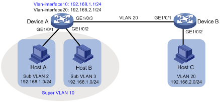

Example: Configuring the super VLAN
Network requirements
As shown in Figure 2:
·     Users in VLAN 2 access the network through GigabitEthernet 1/0/1 of Device A.
·     Users in VLAN 3 access the network through GigabitEthernet 1/0/2 of Device A.
·     GigabitEthernet 1/0/3 of Device A and GigabitEthernet 1/0/1 of Device B are in VLAN 20.
·     Users in VLAN 20 use the gateway address 192.168.2.1 and IP addresses on the IP network segment 192.168.2.0/24.
Configure a super VLAN to meet the following requirements:
·     Users in VLAN 2 and VLAN 3 use the gateway address 192.168.1.1 and IP addresses on the IP network segment 192.168.1.0/24.
·     Users in VLAN 2, VLAN 3, and VLAN 20 are isolated at Layer 2 but interoperable at Layer 3.
Figure 2 Network diagram
Software version used
This configuration example was created and verified on S10500-CMW710-R7150.
A super VLAN does not have physical ports. A VLAN that has physical ports cannot be configured as a super VLAN.
Configuration procedures
Configuring Device A
# Create VLAN 10 and configure it as a super VLAN.
<DeviceA> system-view
[DeviceA] vlan 10
[DeviceA-vlan10] supervlan
[DeviceA-vlan10] quit
# Create VLAN 2, and assign GigabitEthernet 1/0/1 to VLAN 2.
[DeviceA] vlan 2
[DeviceA-vlan2] port gigabitethernet 1/0/1
[DeviceA-vlan2] quit
# Create VLAN 3, and assign GigabitEthernet 1/0/2 to VLAN 3.
[DeviceA] vlan 3
[DeviceA-vlan3] port gigabitethernet 1/0/2
[DeviceA-vlan3] quit
# Associate super VLAN 10 with VLANs 2 and 3.
[DeviceA] vlan 10
[DeviceA-vlan10] subvlan 2 3
# Create VLAN-interface 10, and assign IP address 192.168.1.1 to it.
[DeviceA] interface vlan-interface 10
[DeviceA-Vlan-interface10] ip address 192.168.1.1 24
# Enable local proxy ARP on VLAN-interface 10.
[DeviceA-Vlan-interface10] local-proxy-arp enable
[DeviceA-Vlan-interface10] quit
# Create VLAN 20.
[DeviceA] vlan 20
[DeviceA-vlan20] quit
# Configure GigabitEthernet 1/0/3 as a trunk port, and remove the port from VLAN 1.
[DeviceA] interface gigabitethernet 1/0/3
[DeviceA-GigabitEthernet1/0/3] port link-type trunk
[DeviceA-GigabitEthernet1/0/3] undo port trunk permit vlan 1
# Assign GigabitEthernet 1/0/3 to VLAN 20.
[DeviceA-GigabitEthernet1/0/3] port trunk permit vlan 20
# Create VLAN-interface 20, and assign IP address 192.168.2.1 to it.
[DeviceA] interface Vlan-interface 20
[DeviceA-Vlan-interface20] ip address 192.168.2.1 24
[DeviceA-Vlan-interface20] quit
Configuring Device B
# Create VLAN 20.
[DeviceB] vlan 20
[DeviceB-vlan20] quit
# Configure GigabitEthernet 1/0/1 as a trunk port, and remove the port from VLAN 1.
[DeviceB-GigabitEthernet1/0/1] port link-type trunk
[DeviceB-GigabitEthernet1/0/1] undo port trunk permit vlan 1
# Assign GigabitEthernet 1/0/1 to VLAN 20.
[DeviceB-GigabitEthernet1/0/1] port trunk permit vlan 20
# Assign GigabitEthernet 1/0/2 to VLAN 20.
[DeviceB] vlan 20
[DeviceB-vlan20] port gigabitethernet 1/0/2
# Verify the super VLAN configuration.
[DeviceA] display supervlan
 SuperVLAN ID :  10
 SubVLAN ID :  2 3
 VLAN ID: 10
 VLAN Type: static
 It is a Super VLAN.
 Route Interface: configured
 IP Address: 192.168.1.1
 Subnet Mask: 255.255.255.0
 Description: VLAN 0010
 Tagged   Ports: none
 Untagged Ports: none
 VLAN ID: 2
 VLAN Type: static
 It is a Sub VLAN.
 Description: VLAN 0002
 Tagged   Ports: none
 Untagged Ports:
 VLAN ID: 3
 VLAN Type: static
 It is a Sub VLAN.
 Description: VLAN 0003
 Tagged   Ports: none
 Untagged Ports:
    GigabitEthernet1/0/2
# Verify that Host A and Host B can ping each other. In the ARP table of Host A, the IP address of Host B corresponds to the MAC address of VLAN-interface 10. In the ARP table of Host B, the IP address of Host A corresponds to the MAC address of VLAN-interface 10. (Details not shown.)
# Verify that Host A and Host C can ping each other. In the ARP table of Host A, no entry about Host C exists. In the ARP table of Host C, no entry about Host A exists. (Details not shown.)
# Verify that Host B and Host C can ping each other. In the ARP table of Host B, no entry about Host C exists. In the ARP table of Host C, no entry about Host B exists. (Details not shown.)
Configuration files
·     Device A:
vlan 2
vlan 3
vlan 10
 supervlan
 subvlan 2 3
vlan 20
interface Vlan-interface10
interface Vlan-interface20
 ip address 192.168.2.1 255.255.255.0
 port link-mode bridge
 port access vlan 2
 port access vlan 3
·     Device B:
vlan 20
 port access vlan 20

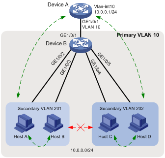

Example: Configuring the private VLAN
As shown in Figure 3:
·     The aggregation-layer device Device A assigns VLAN 10 to Device B. Hosts access the network through VLAN-interface 10.
·     Users connected to Device B are on the same subnet 10.0.0.0/24.
·     Host A and Host B are in the Marketing department. Host C and Host D are in the Finance department.
Configure the private VLAN feature to meet the following requirements:
·     Device A is only aware of the primary VLAN 10.
·     Hosts in the same secondary VLAN are interoperable at Layer 2.
·     Hosts in different secondary VLANs are isolated at Layer 2.
Figure 3 Network diagram
Requirements analysis
The private VLAN configuration is required only on Device B.
The system default VLAN (VLAN 1) does not support the private VLAN configuration.
# Create VLAN 10 and configure it as a primary VLAN.
<DeviceB> system-view
[DeviceB] vlan 10
[DeviceB-vlan10] private-vlan primary
[DeviceB-vlan10] quit
# Create VLANs 201 and 202.
[DeviceB] vlan 201 to 202
# Associate primary VLAN 10 with secondary VLANs 201 and 202.
[DeviceB] vlan 10
[DeviceB-vlan10] private-vlan secondary 201 to 202
# Configure the uplink port GigabitEthernet 1/0/1 as a promiscuous port of VLAN 10.
[DeviceB-GigabitEthernet1/0/1] port private-vlan 10 promiscuous
[DeviceB-GigabitEthernet1/0/1] undo shutdown
[DeviceB-GigabitEthernet1/0/1] quit
# Assign the downlink ports GigabitEthernet 1/0/2 and GigabitEthernet 1/0/3 to VLAN 201 as host ports.
[DeviceB] interface range gigabitethernet 1/0/2 to gigabitethernet 1/0/3
[DeviceB-if-range] port link-mode bridge
[DeviceB-if-range] port access vlan 201
[DeviceB-if-range] port private-vlan host
[DeviceB-if-range] undo shutdown
[DeviceB-if-range] quit
# Assign the downlink ports GigabitEthernet 1/0/4 and GigabitEthernet 1/0/5 to VLAN 202 as host ports.
[DeviceB] interface range gigabitethernet 1/0/4 to gigabitethernet 1/0/5
[DeviceB-if-range] port access vlan 202
# Create VLAN 10.
[DeviceA] vlan 10

# Assign GigabitEthernet 1/0/1 to VLAN 10.
[DeviceA-GigabitEthernet1/0/1] port link-mode bridge
[DeviceA-GigabitEthernet1/0/1] port access vlan 10
[DeviceA-GigabitEthernet1/0/1] undo shutdown
[DeviceA-GigabitEthernet1/0/1] quit
# Create VLAN-interface 10, and assign IP address 10.0.0.1 to it.
[DeviceA-Vlan-interface10] ip address 10.0.0.1 24
[DeviceA-Vlan-interface10] undo shutdown
# Verify that Device A can ping Host A, Host B, Host C, and Host D successfully. (Details not shown.)
# Display the ARP table of Device A.
[DeviceA] display arp
  Type: S-Static   D-Dynamic   O-Openflow   M-Multiport  I-Invalid
IP address      MAC address    VLAN     Interface                Aging Type
10.0.0.2        d485-64a1-7e4a 10       GE1/0/1                  19    D
10.0.0.3        7446-a0aa-7774 10       GE1/0/1                  19    D
10.0.0.4        6805-ca05-39ae 10       GE1/0/1                  20    D
10.0.0.5        6805-ca05-414e 10       GE1/0/1                  20    D
# Display the private VLAN configuration on Device B.
[DeviceB] display private-vlan
 Primary VLAN ID: 10
 Secondary VLAN ID: 201-202
 VLAN ID: 10
 VLAN type: Static
 Private VLAN type: Primary
 Route interface: Not configured
 Tagged ports:   None
 Untagged ports:
    GigabitEthernet1/0/1          GigabitEthernet1/0/2
    GigabitEthernet1/0/3          GigabitEthernet1/0/4
    GigabitEthernet1/0/5
 VLAN ID: 201
 VLAN type: Static
 Private VLAN type: Secondary
 Description: VLAN 0201
 Tagged ports:   None
 Untagged ports:
 VLAN ID: 202
 VLAN type: Static
 Description: VLAN 0202
 Tagged ports:   None
 Untagged ports:
    GigabitEthernet1/0/1          GigabitEthernet1/0/4
The output shows that:
·     The promiscuous port GigabitEthernet1/0/1 is an untagged member of primary VLAN 10 and secondary VLANs 201 and 202.
·     The host ports GigabitEthernet 1/0/2 and GigabitEthernet 1/0/3 are untagged members of secondary VLANs 201.
·     The host ports GigabitEthernet 1/0/4 and GigabitEthernet 1/0/5 are untagged members of secondary VLANs 202.
# Verify that Hosts in the same secondary VLAN can ping each other, but they fail to ping hosts in the other secondary VLAN. (Details not shown.)
Configuration files
·     Device B:
vlan 1
vlan 10
vlan 201 to 202
 port link-type hybrid
 undo port hybrid vlan 1
 port hybrid vlan 10 201 to 202 untagged
 port hybrid pvid vlan 10
 port hybrid vlan 10 201 untagged
 port hybrid pvid vlan 201
interface GigabitEthernet1/0/4
 port hybrid vlan 10 202 untagged
 port hybrid pvid vlan 202
interface GigabitEthernet1/0/5
·     Device A:
vlan 1
vlan 10
 ip address 10.0.0.1 255.255.255.0
 port access vlan 10
Related documentation
·     H3C S10500 Switch Series Layer 2—LAN Switching Configuration Guide-Release 7150
·     H3C S10500 Switch Series Layer 2—LAN Switching Command Reference-Release 7150
