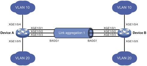

Network requirements
As shown in Figure 1, both Device A and Device B forward traffic from VLAN 10 and VLAN 20.
Configure link aggregation on Device A and Device B to meet the following requirements:
·     VLAN 10 on Device A can communicate with VLAN 10 on Device B.
·     VLAN 20 on Device A can communicate with VLAN 20 on Device B.
Figure 1 Network diagram

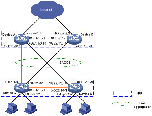

Example: Configuring Layer 2 link aggregation in an IRF fabric
On the network as shown in Figure 2, perform the following tasks:
·     Set up a two-chassis IRF fabric at the access layer and a two-chassis IRF fabric at the distribution layer of the enterprise network.
·     Configure link aggregation to improve the reliability of the links between the access-layer and distribution-layer IRF fabrics and implement load sharing.
·     Run LACP MAD on the two IRF fabrics to detect IRF split.
Figure 2 Network diagram

3.     Configure a Layer 2 aggregation group on Device A:
# Create Layer 2 aggregate interface Bridge-Aggregation 1, and configure the link aggregation mode as dynamic.
[DeviceA] interface bridge-aggregation 1
[DeviceA-Bridge-Aggregation1] link-aggregation mode dynamic
# Configure Layer 2 aggregation group 1 to load share packets based on source IP addresses.
[DeviceA-Bridge-Aggregation1] link-aggregation load-sharing mode source-ip
[DeviceA-Bridge-Aggregation1] quit
# Assign ports Ten-GigabitEthernet 1/1/0/9, Ten-GigabitEthernet 1/1/0/10, Ten-GigabitEthernet 2/1/0/9, and Ten-GigabitEthernet 2/1/0/10 to link aggregation group 1.
[DeviceA] interface range ten-gigabitethernet 1/1/0/9 to ten-gigabitethernet 1/1/0/10
ten-gigabitethernet 2/1/0/9 to ten-gigabitethernet 2/1/0/10
[DeviceA-if-range] port link-aggregation group 1
[DeviceA-if-range] quit
[DeviceA]
4.     Configure LACP MAD on the IRF fabric:
# Set the domain ID of the IRF fabric to 1.
[DeviceA] irf domain 1
# Enable LACP MAD on Bridge-Aggregation 1.
[DeviceA] interface Bridge-Aggregation 1
[DeviceA-Bridge-Aggregation1] mad enable
You need to assign a domain ID (range: 0-4294967295)
[Current domain is: 1]:
The assigned domain ID is: 1
MAD LACP only enable on dynamic aggregation interface.
5.     Configure IRF on Device C in the same way IRF is configured on Device A. (Details not shown.)
6.     Configure IRF on Device D in the same way IRF is configured on Device B. (Details not shown.)
Device C and Device D perform master election, and the one that has lost the election reboots to form an IRF fabric with the master. In this example, Device C reboots.
7.     Configure a Layer 2 dynamic aggregation group Bridge-Aggregation 1 on Device C in the same way Bridge-Aggregation 1 is configured on Device A. (Details not shown.)
8.     Configure LACP MAD on the IRF fabric:
# Set the domain ID of the IRF fabric to 2.
<DeviceC> system-view
[DeviceC] irf domain 2
[DeviceC] interface Bridge-Aggregation 1
[DeviceC-Bridge-Aggregation1] mad enable
[Current domain is: 2]:
The assigned domain ID is: 2
# Display the information about the link aggregation groups on Device A.
[DeviceA] display link-aggregation verbose
Loadsharing Type: Shar -- Loadsharing, NonS -- Non-Loadsharing
Port Status: S -- Selected, U -- Unselected, I -- Individual
Flags:  A -- LACP_Activity, B -- LACP_Timeout, C -- Aggregation,
        G -- Defaulted, H -- Expired
Aggregate Interface: Bridge-Aggregation1
Aggregation Mode: Dynamic
System ID: 0x8000, 00a0-fc00-5800
Local:
  Port             Status  Priority Oper-Key  Flag
  XGE1/1/0/9         S       32768    1         {ACDEF}
  XGE1/1/0/10        S       32768    1         {ACDEF}
  XGE2/1/0/9         S       32768    1         {ACDEF}
  XGE2/1/0/10        s       32768    1         {ACDEF}
Remote:
  Actor            Partner Priority Oper-Key  SystemID               Flag
  XGE1/1/0/9         139     32768    1         0x8000, 0cda-414a-859b {ACDEF}
  XGE1/1/0/10        205     32768    1         0x8000, 0cda-414a-859b {ACDEF}
  XGE2/1/0/9         204     32768    1         0x8000, 0cda-414a-859b {ACDEF}
  XGE2/1/0/10        138     32768    1         0x8000, 0cda-414a-859b {ACDEF}
The output shows that the local member ports and the corresponding peer member ports are all Selected. In the dynamic link aggregation mode, each local member port and its peer member port have the same Selected state through exchanging LACPDUs. The user data traffic can be forwarded correctly.
# Display the load sharing mode of Layer 2 aggregation group 1 on Device A.
[DeviceA] display link-aggregation load-sharing mode interface Bridge-Aggregation 1
Bridge-Aggregation1 Load-Sharing Mode:
source-ip address
The output shows that Layer 2 aggregation group 1 load shares packets based on source IP addresses.
# Shut down physical IRF port Ten-GigabitEthernet 2/0/1 on Device B.
A log message appears on Device A.
[DeviceA]%Jan  1 03:12:43:397 2011 Transit STM/3/STM_LINK_STATUS_DOWN: IRF port 2 is down.
%Jan  1 03:12:43:410 2011 Transit DEV/3/BOARD_REMOVED: Board is removed from Slo
t 1, type is MAIN_BOARD_TYPE_52QF.
%Jan  1 03:12:44:385 2011 Transit IFNET/3/PHY_UPDOWN: Ten-GigabitEthernet2/1/0/1
link status is down.
%Jan  1 03:12:44:386 2011 Transit IFNET/5/LINK_UPDOWN: Line protocol on the inte
rface Ten-GigabitEthernet2/1/0/1 is down.
The output shows that IRF split occurs on the distribution layer because Ten-GigabitEthernet 2/1/0/1 that is bound to IRF port 2 is physically down.
On the network as shown in Figure 3, perform the following tasks:
·     Configure a Layer 3 dynamic aggregation group on both Device A and Device B.
·     Configure IP addresses and subnet masks for the corresponding Layer 3 aggregate interfaces.
Figure 3 Network diagram
Software version used
This configuration example was created and verified on S10500-CMW710-R7150.
An aggregation group can operate in static or dynamic mode. You can choose one mode as required.
·     In a static aggregation group, the aggregation states of the member ports are not affected by the peer ports. Static link aggregation is stable.
·     In a dynamic aggregation group, the local system and the peer system automatically maintain the aggregation states of the member ports. Dynamic link aggregation reduces the administrators' workload.
Configuration procedures
1.     Configure Device A:
# Create Layer 3 aggregate interface Route-Aggregation 1. Use one of the following methods as needed.
¡     Use the static aggregation mode to create Layer 3 aggregate interface Route-Aggregation 1.
<DeviceA> system-view
[DeviceA] interface route-aggregation 1
¡     Use the dynamic aggregation mode to create Layer 3 aggregate interface Route-Aggregation 1.
[DeviceA-Route-Aggregation1] link-aggregation mode dynamic
# Configure an IP address and subnet mask for Layer 3 aggregate interface Route-Aggregation 1.
[DeviceA-Route-Aggregation1] ip address 192.168.1.1 24
[DeviceA-Route-Aggregation1] quit
# Assign ports Ten-GigabitEthernet 1/0/1 through Ten-GigabitEthernet 1/0/3 to aggregation group 1.
[DeviceA] interface range ten-gigabitethernet 1/0/1 to ten-gigabitethernet 1/0/3
2.     Configure Device B in the same way Device A is configured. (Details not shown.)
# Display detailed information about the link aggregation groups on Device A.
·     Link aggregation configuration information when the static aggregation mode is used:
Aggregate Interface: Route-Aggregation1
Aggregation Mode: Static
  XGE1/0/1         S       32768    1
  XGE1/0/2         S       32768    1
  XGE1/0/3         S       32768    1
The output shows that all member ports in the local aggregation group are in Selected state. The Selected states of the local member ports are not affected by the Selected states of the peer member ports.
·     Link aggregation configuration information when the dynamic aggregation mode is used:
System ID: 0x8000, 000f-e267-6c6a
Local:
  XGE1/0/1         S       32768    1         {ACDEF}
  XGE1/0/2         S       32768    1         {ACDEF}
  XGE1/0/3         S       32768    1         {ACDEF}
Remote:
  XGE1/0/1         1       32768    1         0x8000, 000f-e267-57ad {ACDEF}
  XGE1/0/2         2       32768    1         0x8000, 000f-e267-57ad {ACDEF}
  XGE1/0/3         3       32768    1         0x8000, 000f-e267-57ad {ACDEF}
