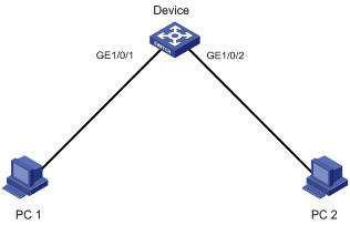

1.7.4  定时执行任务典型配置举例
1. 组网需求
对Device进行配置,在星期一到星期五的上午八点到下午十八点开启GigabitEthernet1/0/1和GigabitEthernet1/0/2,其它时间关闭端口,以便起到有效节能的作用。
2. 组网图
图1-1 定时执行任务典型配置举例组网图
3. 配置步骤
# 进入系统视图。
<Sysname> system-view
# 创建关闭GigabitEthernet1/0/1的Job。
[Sysname] scheduler job shutdown-GigabitEthernet1/0/1
[Sysname-job-shutdown-GigabitEthernet1/0/1] command 1 system-view
[Sysname-job-shutdown-GigabitEthernet1/0/1] command 2 interface gigabitethernet 1/0/1
[Sysname-job-shutdown-GigabitEthernet1/0/1] command 3 shutdown
[Sysname-job-shutdown-GigabitEthernet1/0/1] quit
# 创建开启GigabitEthernet1/0/1的Job。
[Sysname] scheduler job start-GigabitEthernet1/0/1
[Sysname-job-start-GigabitEthernet1/0/1] command 1 system-view
[Sysname-job-start-GigabitEthernet1/0/1] command 2 interface gigabitethernet 1/0/1
[Sysname-job-start-GigabitEthernet1/0/1] command 3 undo shutdown
[Sysname-job-start-GigabitEthernet1/0/1] quit
# 创建关闭GigabitEthernet1/0/2的Job。
[Sysname] scheduler job shutdown-GigabitEthernet1/0/2
[Sysname-job-shutdown-GigabitEthernet1/0/2] command 1 system-view
[Sysname-job-shutdown-GigabitEthernet1/0/2] command 2 interface gigabitethernet 1/0/2
[Sysname-job-shutdown-GigabitEthernet1/0/2] command 3 shutdown
[Sysname-job-shutdown-GigabitEthernet1/0/2] quit
# 创建开启GigabitEthernet1/0/2的Job。
[Sysname] scheduler job start-GigabitEthernet1/0/2
[Sysname-job-start-GigabitEthernet1/0/2] command 1 system-view
[Sysname-job-start-GigabitEthernet1/0/2] command 2 interface gigabitethernet 1/0/2
[Sysname-job-start-GigabitEthernet1/0/2] command 3 undo shutdown
[Sysname-job-start-GigabitEthernet1/0/2] quit
# 配置定时执行任务,使Device在星期一到星期五的上午八点开启pc1、pc2对应的以太网端口。
[Sysname] scheduler schedule START-pc1/pc2
[Sysname-schedule-START-pc1/pc2] job start-GigabitEthernet1/0/1
[Sysname-schedule-START-pc1/pc2] job start-GigabitEthernet1/0/2
[Sysname-schedule-START-pc1/pc2] time repeating at 8:00 week-day mon tue wed thu fri
[Sysname-schedule-START-pc1/pc2] quit
# 配置定时执行任务,使Device在星期一到星期五的下午十八点关闭pc1、pc2对应的以太网端口。
[Sysname] scheduler schedule STOP-pc1/pc2
[Sysname-schedule- STOP-pc1/pc2] job shutdown-GigabitEthernet1/0/1
[Sysname-schedule- STOP-pc1/pc2] job shutdown-GigabitEthernet1/0/2
[Sysname-schedule- STOP-pc1/pc2] time repeating at 18:00 week-day mon tue wed thu fri
[Sysname-schedule- STOP-pc1/pc2] quit

Job name: start-GigabitEthernet1/0/1
 undo shutdown
Job name: start-GigabitEthernet1/0/2
 undo shutdown
# 显示定时任务的运行信息。
[Sysname] display scheduler schedule
Schedule name        : START-pc1/pc2
Schedule type        : Run on every Mon Tue Wed Thu Fri at 08:00:00
Start time           : Wed Sep 28 08:00:00 2011
Last execution time  : Wed Sep 28 08:00:00 2011
Last completion time : Wed Sep 28 08:00:03 2011
Execution counts     : 1
Job name                                          Last execution status
start-GigabitEthernet1/0/1                                 Successful
start-GigabitEthernet1/0/2                                 Successful
Schedule name        : STOP-pc1/pc2
Schedule type        : Run on every Mon Tue Wed Thu Fri at 18:00:00
Start time           : Wed Sep 28 18:00:00 2011
Last execution time  : Wed Sep 28 18:00:00 2011
Last completion time : Wed Sep 28 18:00:01 2011
shutdown-GigabitEthernet1/0/1                              Successful
shutdown-GigabitEthernet1/0/2                              Successful
# 显示Job运行的输出信息。
[Sysname] display scheduler logfile
Logfile Size: 16054 Bytes.
Job name        : start-GigabitEthernet1/0/1
Execution time  : Wed Sep 28 08:00:00 2011
Completion time : Wed Sep 28 08:00:02 2011
--------------------------------- Job output -----------------------------------
<Sysname>system-view
System View: return to User View with Ctrl+Z.
[Sysname]interface gigabitethernet 1/0/1
[Sysname-GigabitEthernet1/0/1]undo shutdown
Job name        : start-GigabitEthernet1/0/2
[Sysname]interface gigabitethernet 1/0/2.
[Sysname-GigabitEthernet1/0/2]undo shutdown
Job name        : shutdown-GigabitEthernet1/0/1
Execution time  : Wed Sep 28 18:00:00 2011
Completion time : Wed Sep 28 18:00:01 2011
[Sysname-GigabitEthernet1/0/1]shutdown
Job name        : shutdown-GigabitEthernet1/0/2
[Sysname-GigabitEthernet1/0/2]shutdown

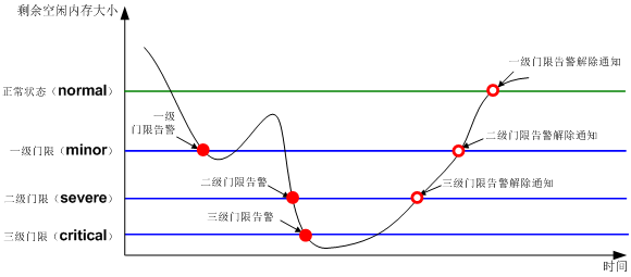

1.11  配置内存告警门限
1. 配置内存利用率阈值
当系统内存利用率大于配置的内存利用率阈值时,设备将发送Trap报文提示用户。
2. 配置三级告警门限
系统实时监控系统剩余空闲内存大小,当条件达到时,就产生相应的告警/告警解除通知,以便通知关联的业务模块/进程采取相应的措施,以便最大限度的利用内存,又能保证设备的正常运行。
设备支持一级(minor)、二级(severe)和三级(critical)三个级别的门限,对应的系统剩余空闲内存越来越少,紧急程度越来越严重,关联模块根据收到的不同级别的告警可以采取不同的响应。
·            当系统剩余空闲内存第一次小于等于一级告警门限时,产生一级告警;
·            当系统剩余空闲内存第一次小于等于二级告警门限时,产生二级告警;
·            当系统剩余空闲内存第一次小于等于三级告警门限时,产生三级告警。
·            当系统剩余空闲内存大于等于二级告警门限时,产生三级告警解除通知;
·            当系统剩余空闲内存大于等于一级告警门限时,产生二级告警解除通知;
·            当系统剩余空闲内存大于等于正常内存大小时,产生一级告警解除通知。
对于上述三个级别的内存告警门限,需要注意的是:
同一级别的告警/告警解除通知是交替进行的:当系统剩余空闲内存小于等于某级告警门限,设备产生相应级别的告警,后续只有该告警解除了,系统剩余空闲内存再次小于等于某级告警门限时,才会再次生成该级别的告警。
当系统的剩余空闲内存大小如图1-2中曲线所示时,会生成如图1-2所示的告警和解除告警通知。
图1-2 内存告警示意图
表1-12 配置内存告警门限
操作
命令
说明
进入系统视图
配置内存告警的门限值
memory-threshold [ slot slot-number [ cpu cpu-number ] ] minor minor-value severe severe-value critical critical-value normal normal-value
缺省情况下,一级告警门限为96MB,二级告警门限为64MB,三级告警门限为48MB,系统恢复到正常的内存门限为128MB
