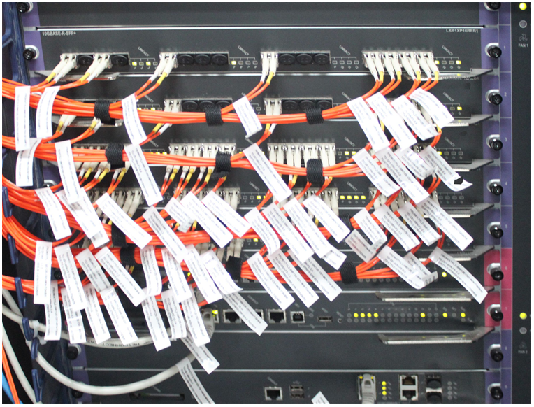

Label cables before you route or bundle them. For more information about labeling cables, see "Appendix E Engineering labels."

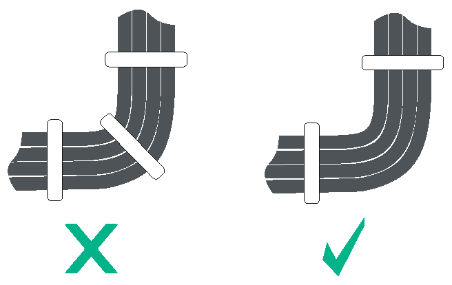

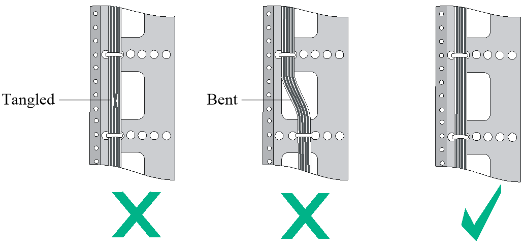

·     Bind and route the cables neatly inside the rack, and make sure the cables are not kinked or bent. Do not tie cables or bundles in a knot.
Figure 11-1 Correct and incorrect cable binding
·     When you bend cables, bind cables as shown in Figure 11-2. To avoid cable core break due to excessive stress, do not tie up the cables in the bending area. The cable bend radius at connectors must be at least 5 times the cable diameter, and must be at least twice the cable diameter away from the connectors.
Figure 11-2 Binding the cables

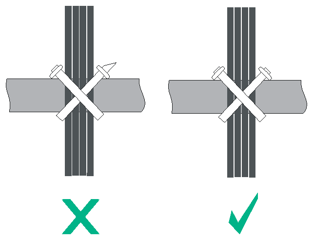

·     After binding the cables, cut the excess from the ties, leaving no sharp or angular tips. See Figure 11-3.
Figure 11-3 Cutting the cable ties

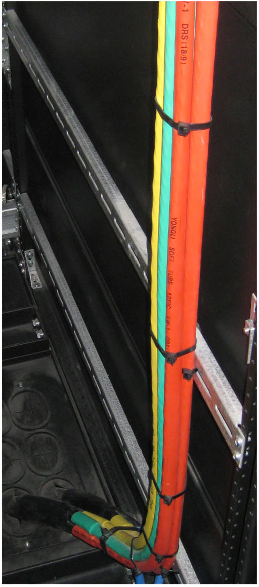

·     Fasten heavy or rigid power cords at the connectors to relief stress.

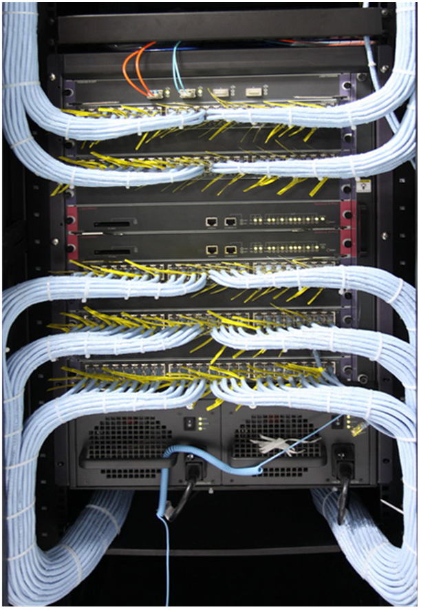

Figure 11-4 Network cable management

Figure 11-6 Power cord management
