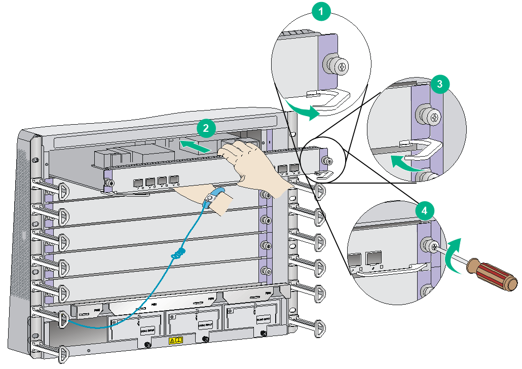

To install a horizontally oriented card:
1.     Wear an ESD wrist strap, and make sure it makes good skin contact and is reliably grounded. For more information, see "Attaching an ESD wrist strap."
2.     Remove the blank filler panel (if any) from the slot. Keep the blank filler panel for future use.
3.     Rotate down the ejector levers on the card.
Skip this step if the card is not a base card.
Figure 3-2 Rotating down the ejector levers on a base card
4.     Rotate outward the two ejector levers on the card.
5.     Hold the card by the front panel with one hand and support the card bottom with the other. Slide the card steadily into the slot along the guide rails until you cannot push the card further. Do not touch the components on the card.
6.     Rotate inward the ejector levers until the card come in close contact with the backplane.
7.     Rotate up the ejector levers.
Figure 3-3 Rotating up the ejector levers on a base card
8.     Fasten the captive screws on the card.
9.     When the switch is powered on, verify the running status of the card.
You can verify the running status of a card by referring to the card status LED (SLOT) on the MPU of the switch. If the RUN LED flashes, the card in the slot operates correctly. For more information about card status LED (SLOT), see "Appendix C LEDs."
Figure 3-4 Installing a card

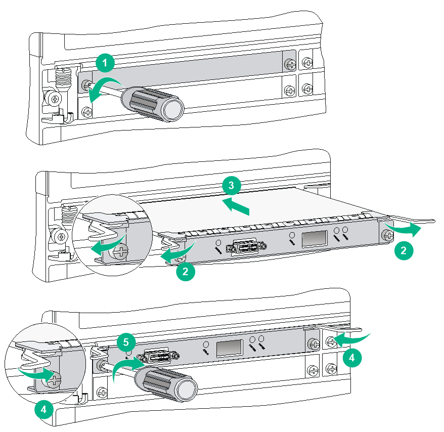

Installing subcards
IMPORTANT
IMPORTANT:
To ensure good ventilation, install a blank filler panel in an empty subslot.
This section describes how to install a subcard in a base card. Subcards are hot swappable.
To install a subcard:
1.     Wear an ESD wrist strap, and make sure it has good skin contact and is reliably grounded. For more information, see "Attaching an ESD wrist strap."
2.     Make sure a base card is installed in the switch.
3.     Unpack the subcard.
4.     If the target slot has a blank filler panel, remove the blank filler panel from the slot.
Keep the removed blank filler panel for future use.
5.     Install the subcard in the base card:
a.     Simultaneously rotate outward the two ejector levers on the subcard.
b.     Gently push the subcard (with bottom up) into the slot along the guide rails until the ejector levers come in contact with the base card panel.
c.     Push the subcard by its front panel until you cannot push the subcard further.
d.     Rotate inward the ejector levers so that the subcard panel is flush with the base card panel.
6.     Fasten the captive screws on the subcard.
Figure 3-5 Installing a subcard

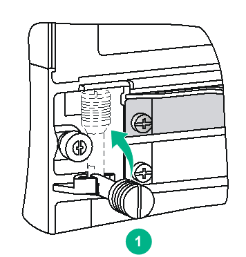

The switch series uses N + 1 or N + N power redundancy and supports AC or DC power input.
The power module slots are horizontal on S7506E-X switches and vertical on S7510E-X switches.
Strictly follow the order shown in Figure 3-6 to avoid security hazards.
Figure 3-6 Power module installation flow
Installing a power module
An AC power module and a DC power module are installed in the same way. This section uses an AC power module as an example. For information about AC and DC power modules, see H3C AC1200 Power Module User Manual, H3C AC2500 Power Module User Manual and H3C DC2400 Power Module User Manual.
Some power module slots do not have a blank panel. The figures in this section are for illustration only.

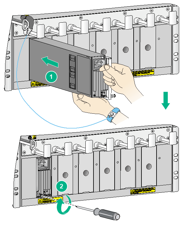

To install the power module:
1.     Wear an ESD wrist strap and make sure it makes good skin contact and is reliably grounded. For more information, see "Attaching an ESD wrist strap."
2.     Use a Phillips screwdriver to loosen the captive screws on the blank filler panel (if any) to remove the blank filler panel.
3.     Unpack the power module.
4.     Follow the installation graph printed on the blank filler panel of the power module to install the power module in a correct direction:
a.     Grasp the handle of the module with one hand and support the module bottom with the other.
b.     Push the power module along the guide rails into the slot until it has firm contact with the slot.
5.     Press the handle inward until the handle seats into the slot.
6.     Use a Phillips screwdriver to fasten the captive screw on the handle to attach the power module.
Figure 3-7 Installing a power module (AC power module in a vertical slot)

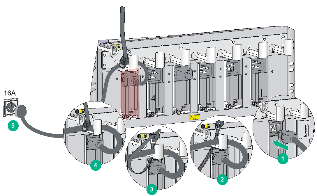

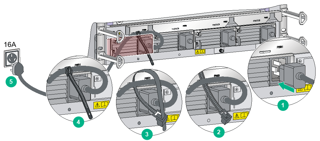

Connecting an AC power cord
CAUTION
CAUTION:
Before connecting an AC power cord, make sure the circuit breaker at the power input end is switched off.
To connect an AC power cord:
1.     Plug the power cord into the power receptacle of the power module.
2.     Use a cable tie to secure the power cord to the power cord management bracket.
¡     Figure 3-8 shows how to connect the power cord for a vertical slot switch (S7510E-X).
¡     Figure 3-9 shows how to connect the power cord for a horizontal slot switch (S7506E-X).
3.     Plug the other end of the power cord to the AC power receptacle of the power source in the equipment room and switch on the circuit breaker.
4.     Verify the power module input status LED.
If the LED is on, the power cord is correctly connected. For description of power module status LEDs, see "Appendix C LEDs."
Figure 3-8 Securing the power cord (vertical slot)
Figure 3-9 Securing the power cord (horizontal slot)

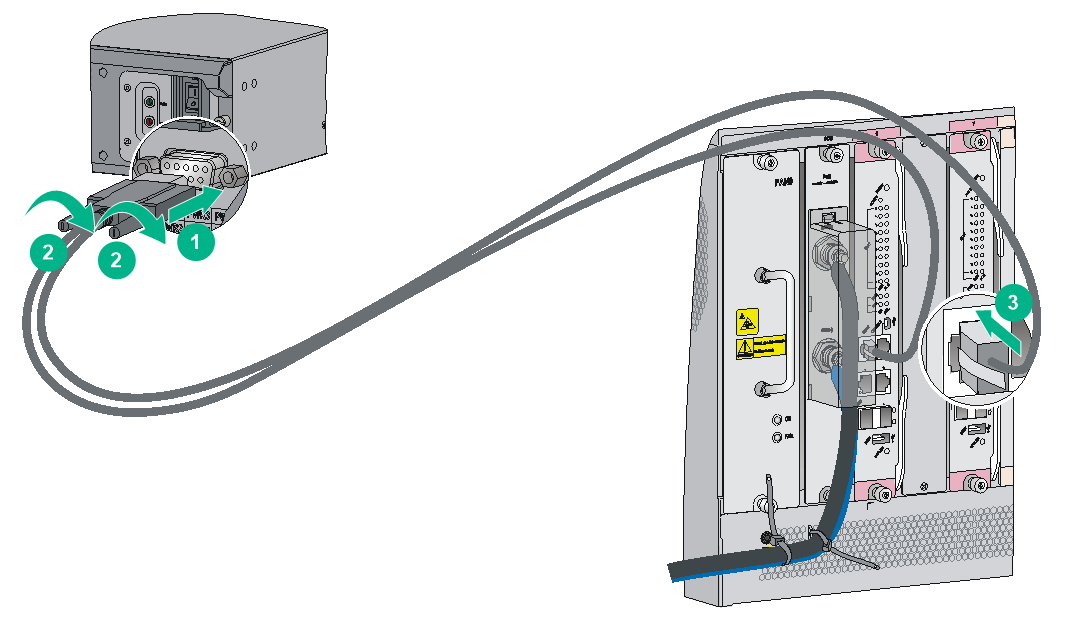

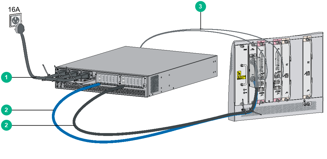

Connecting an external PoE power frame
CAUTION
CAUTION:
Make sure the power is off when you are connecting the external PoE power frame.
To connect an external PoE power frame, perform the following tasks:
1.     Connect DC power cords to the switch and external PoE power frame.
a.     Connecting DC power cords to the switch.
b.     Connecting DC power cords to the external PoE power frame.
c.     Installing power modules on the external PoE power frame.
d.     Connecting the monitoring cable.
e.     Connecting the external PoE power frame to the power source.
Figure 3-11 Connecting external PoE power frame (S7506E-X)
(1) AC power cord
(2) DC power cords
(3) Monitoring cable
·     The AC power cord and monitoring cable both are delivered with the PoE power frame (PSE16KA0).
·     The DC power cords are user-provided. For information about the available DC power cords, see "PoE power system (optional)."

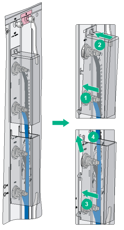

6.     Install the terminal block cover over the power terminals, as shown in Figure 3-12.
To install the terminal block cover for an S7506E-X switch or the upper terminal block cover for an S7510E-X switch:
a.     Insert the locking tabs on the terminal block cover into the holes in the terminal block.
b.     Press the terminal block cover until the cover is securely seated.
To install the lower terminal block cover for an S7510E-X switch:
b.     Press and push the terminal block cover upward until the cover is securely seated.
Figure 3-12 Installing the upper and lower terminal block covers over the power terminals (S7510E-X)
7.     (Optional.) For an S7510E-X switch, repeat steps 1 to 6 to complete connection to another pair of power terminals. Make sure the upper pair of power cords are covered by both terminal block covers.
8.     Use cable ties to secure the power cords to the cable hangers over the air vent section. For more information about how to use a cable tie, see Figure 3-8.
Figure 3-13 Connecting DC power cords to the switch (S7506E-X)

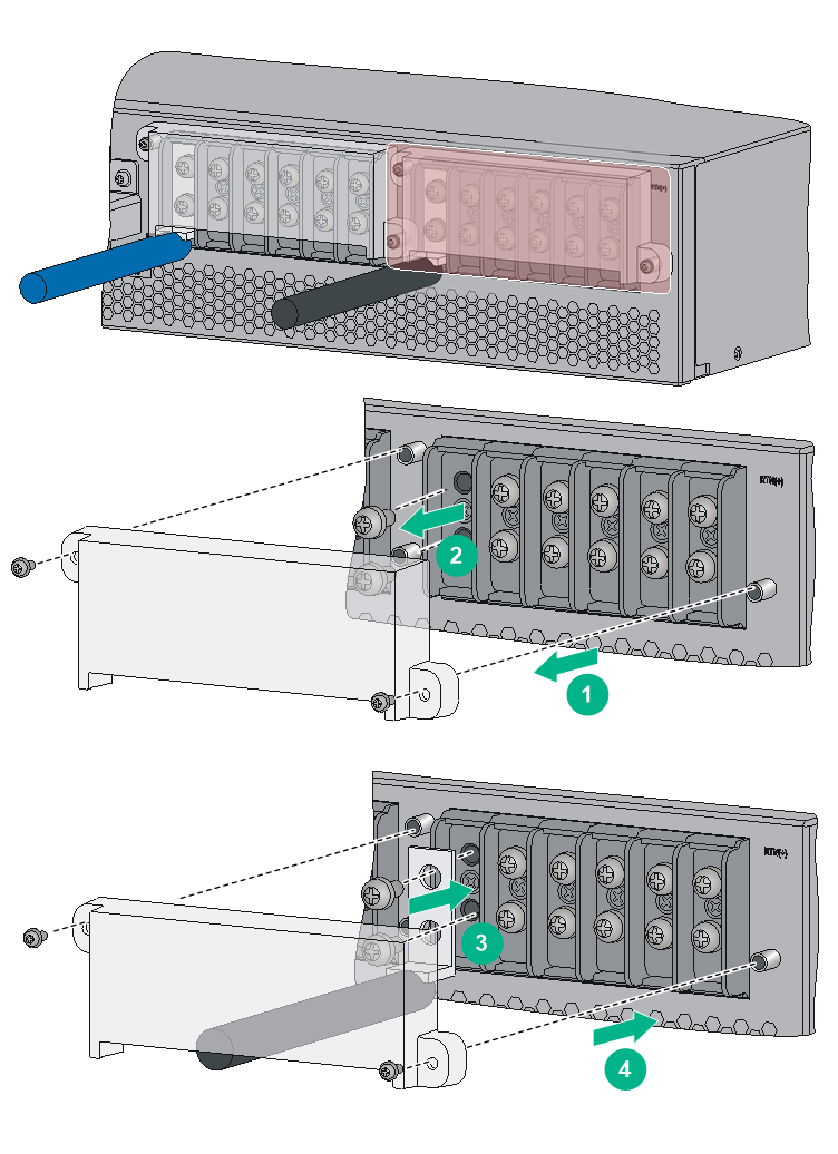

Each external PoE power frame has six pairs of terminals. Use one pair of terminals for an S7506E-X switch and use two pairs of terminals for an S7510E-X switch.
To connect DC power cords to the external PoE power frame:
1.     Remove the terminal block cover from the external PoE power frame.
2.     Connect the dual-hole lug at the other end of the black power cord to the terminal marked with RTN(+) on the external PoE power frame:
a.     Use an M6 wrench to remove the nuts and washers from the terminal.
b.     Connect the dual-hole lug to the terminal.
c.     Install the nuts and washers.
3.     Connect the dual-hole lug at the other end of the blue power cord to the terminal marked with NEG(–) on the external PoE power frame. The process is the same as step 2.
4.     Install the terminal block cover.

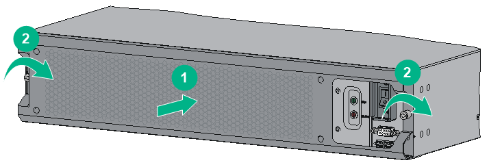

1.     Wear an ESD wrist strap and make sure it has good skin contact and is reliably grounded. For more information, see "Attaching an ESD wrist strap."
2.     Loosen the screws on the front cover of the external power frame and then remove the front cover.
Figure 3-15 Removing the front cover from the external power frame

8.     Reinstall the front cover of the external PoE power frame and fasten the screws.
Figure 3-17 Installing the front cover
An external PoE power frame monitoring cable has two RJ-45 connectors. You can connect either of the RJ-45 connectors to the RS485 port on the MPU if the switch has only one MPU. As a best practice, use both RJ-45 connectors of the monitoring cable if the switch has two MPUs.
To connect the monitoring cable:
1.     Connect the DB-9 connector of the monitoring cable to the 9-core serial port on the external PoE power frame, and fasten the screws.
2.     Connect an RJ-45 connector of the monitoring cable to the RS485 port on the MPU of the switch.
Figure 3-18 Connecting the monitoring cable
Each receptacle on the external PoE power frame corresponds to a power module slot. To enable a power module to operate, connect the AC power cord to the correspondent receptacle.
To connect the external PoE power frame to the power source:
1.     Insert the connector of the AC power cord into the receptacle of a power module.
2.     Use the cable tie to secure the power cord to the power cord management bracket.
3.     Repeat steps 1 and 2 for other power modules.
4.     Connect connectors at the other end of the power cords to the 16A power source.
Figure 3-19 Connecting the external PoE power frame to the power source

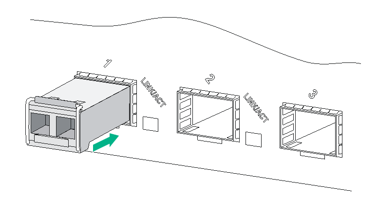

To install an SFP+ transceiver module:
2.     Remove the dust plug from the target fiber port.
3.     Unpack the SFP+ module. It comes with the bail latch catching the knob on the top of the transceiver module.
4.     Grasp the transceiver module between your thumb and index finger. Align it with the fiber port and push it gently into the port until it snaps into place.
Transceiver modules and fiber ports have disorientation rejection designs. If you cannot insert a transceiver module easily into a port, the orientation might be wrong. Remove and reorient the transceiver module.
In case of limited space, you can gently push against the front face of the transceiver module instead of the two sides.
5.     Connect optical fibers to the transceiver module. For the connection procedure, see "Connecting your switch to the network through optical fibers."
Figure 3-20 Installing an SFP+ module
