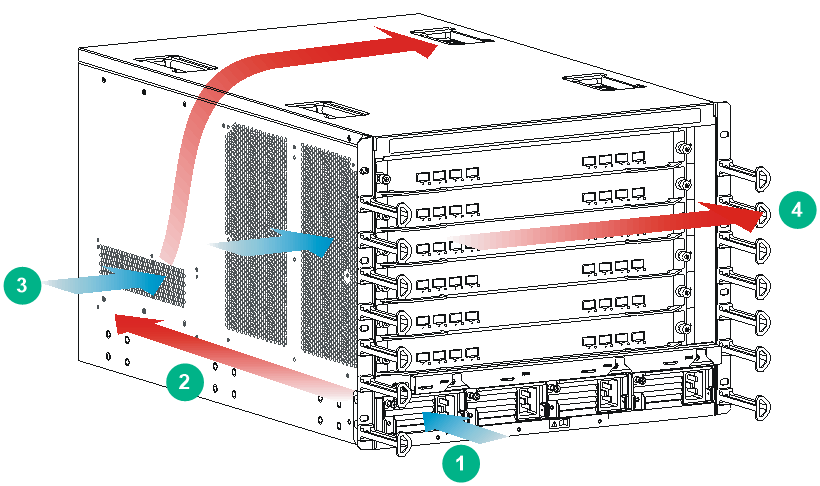

Cooling
Plan the installation site for adequate ventilation.
·     Leave a minimum of 10 cm (3.94 in) of clearance at the inlet and outlet air vents.
·     The rack for the switch has a good cooling system.
·     The installation site has a good cooling system.
·     Verify that the airflow design for the chassis meets the airflow design of the installation site.
Figure 1-1 Airflow through the switch chassis (S7506E-X)
(1) Direction of the airflow into the power modules
(2) Direction of the airflow out of the power modules
(3) Direction of the airflow into the chassis
(4) Direction of the airflow out of the chassis

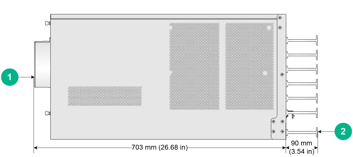

Table 1-5 Switch dimensions and rack requirements
Model
Chassis depth
Rack requirements
S7506E-X
Total depth of 793 mm (31.22 in)
·     90 mm (3.54 in) from the rack-facing surface of the mounting brackets to the front ends of the cable management brackets
·     703 mm (26.68 in) from the rack-facing surface of the mounting brackets to the PoE terminal block cover at the chassis rear
·     A minimum of 130 mm (5.12 in) between the front rack posts and the front door.
·     A minimum of 705 mm (27.76 in) between the front rack posts and the rear door.
If these requirements are met, you can use a rack with a depth of 0.8 m (2.62 ft). As a best practice, use a rack a minimum of 1.0 m (3.28 ft) in depth.

Figure 1-2 shows the depth of the S7506E-X and S7510E-X switches.
Figure 1-2 Switch depth (S7506E-X switch)
(1) PoE terminal block cover at the chassis rear
(2) Cable management bracket

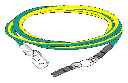

Grounding cable
1
All S7500E-X switch models

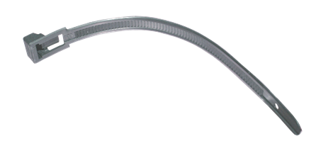

Removable cable tie
2
All power modules
·     Removable cable ties are shipped with the power modules. Other accessories are shipped with the chassis.
