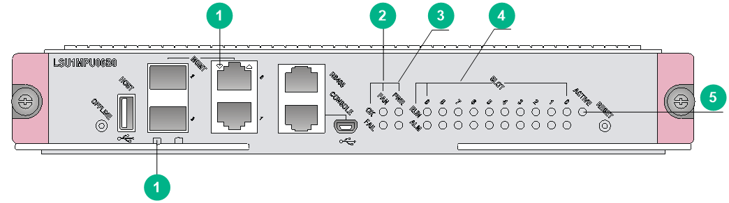

LEDs on LSQM1MPU06B0 and LSQM1MPU10C0 are similar. Figure 8-1 shows the LEDs on the LSQM1MPU06B0 MPU.
Figure 8-1 LEDs on the LSQM1MPU06B0 MPU
(1) Management Ethernet port LEDs
(2) Fan tray status LEDs
(3) Power module status LEDs
(4) Service module status LEDs
(5) MPU active/standby status LED
Each MPU uses the LINK/ACT LED to indicate the link status and data forwarding status of the management Ethernet port.
Table 8-2 Management Ethernet port LED description
LINK/ACT LED Status
Description
Flashing green
A link is present, and the management Ethernet port is receiving or sending data.
Steady green
A link is present.
Off
No link is present.
Each MPU provides one set of LEDs (OK and FAIL) to indicate the status of the fan tray (FAN).
Table 8-3 Fan tray LED description
OK LED status
FAIL LED status
Description
On
Off
The fan tray is operating correctly.
Off
On
A fan problem is present or the fan tray is not in position.
Off
Off
The switch is not powered on.
Power status LEDs
Each MPU provides one set of LEDs (OK and FAIL) to indicate the status of the power modules.
Table 8-4 Power status LED description
OK LED status
FAIL LED status
Description
On
Off
The power module is operating correctly.
Off
On
A power module problem is present or a power module is not in position.
Off
Off
Card LEDs
Each MPU has the LEDs numbered the same as card slots to indicate the status of the active MPU, standby MPU, service modules, and switching fabric modules in the slots. Table 8-5 shows the LED description.
Slot numbers are marked on the right of the slots on the switch.
Table 8-5 Card LED description
RUN LED status
ALM LED status
Description
Flashing (0.5 Hz)
Off
The card is operating correctly.
Flashing (4 Hz)
On
The service module or switching fabric module is loading software.
If the LED flashes continuously, the software version of the switch does not match that of the card.
Flashing (0.5 Hz)
Flashing (0.25 Hz)
The card temperature exceeds the upper warning threshold or falls below the lower warning threshold.
On
On
The card is booting or faulty.
On
Off
The MPU is starting up.
Off
Off
The card is not in position.
·     When the RUN LED flashes 4 times per second, the card is loading software. If the RUN LED flashes in this state continuously, the card is not compatible with the switch software.
·     Before the active MPU starts up, all card LEDs are off. The tables describe the card LED status after the active MPU starts up.
·     The ALM LED for a service module lights for a period of time at the initial phase of the system startup.
Each MPU has one ACTIVE LED to indicate the active or standby status of the MPU.
Table 8-6 MPU ACTIVE LED description
Status
Description
On
The MPU is active.
Off
·     The MPU is in standby status.
·     The MPU is faulty. Examine the card LED for an MPU problem.
