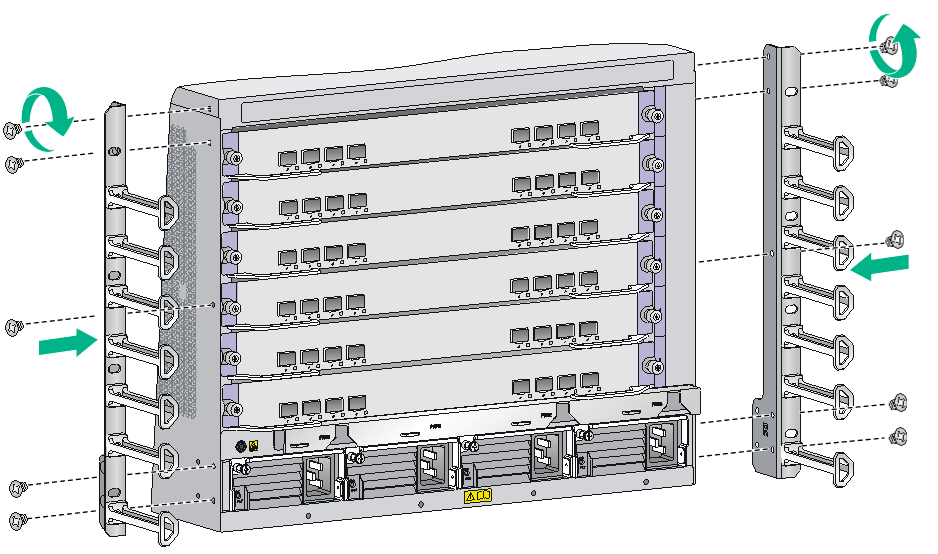

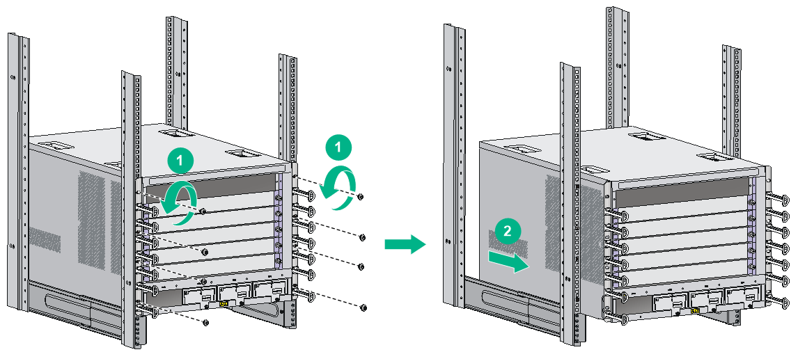

Replacing mounting brackets

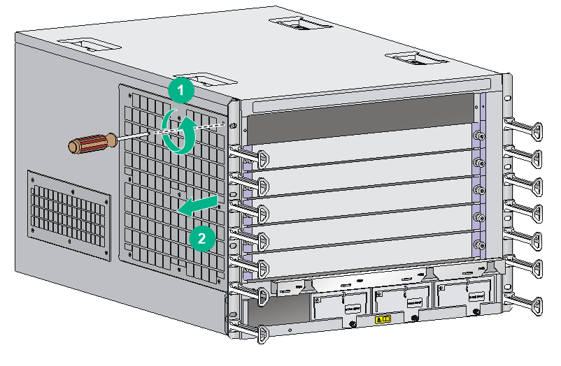

1.     Remove the screws that secure the chassis to the rack.
2.     Cooperate with one or more people to slowly pull out the chassis along the guide rails until the space is enough for replacing the mounting brackets.
Figure 5-1 Pulling out the chassis (S7506E-X)

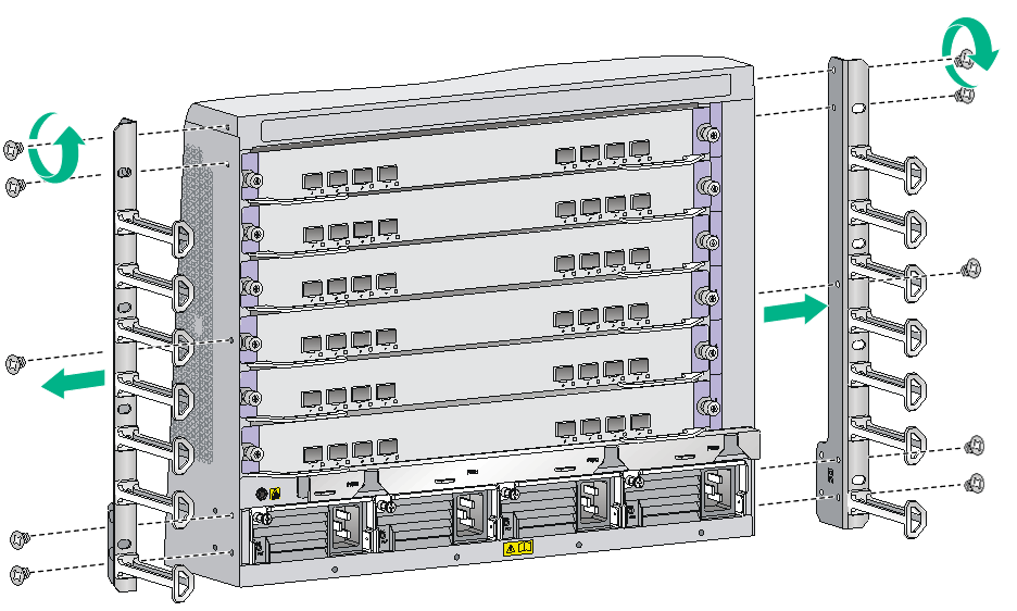

3.     Removing the mounting brackets, as shown in Figure 5-2.
Figure 5-2 Removing mounting brackets (S7506E-X)
4.     Install the new mounting brackets.
Figure 5-3 Installing mounting brackets (S7506E-X)
5.     Cooperate with one or more people to push the chassis back to the rack, and fasten the screws to secure the chassis to the rack. For more information, see "Mounting the switch in the rack."

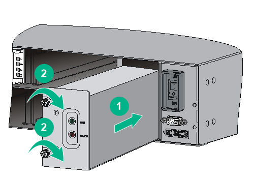

Replacing a power module
Follow these guidelines when you replace a power module:
·     Strictly follow the procedures shown in Figure 5-4 and Figure 5-5 to replace a power module to avoid device damage or bodily injury.
Figure 5-4 Power module removal procedure
Figure 5-5 Power module installation procedure
·     Power modules on the switch must be the same model. When the new power modules and the existing power modules are not the same model, power off the switch and remove all existing power modules before installing new power modules.
·     Provide a circuit breaker for each power module. Before replacing a power module, turn off its circuit breaker.
·     The power module might be of high temperature. Remove it with caution.
·     To install the removed power module in the chassis again, install it after the status LED on it is off.
·     After removing the power module from a slot, install a blank filler panel in the slot if you do not install a new power module.
To replace a power module:
1.     Prepare an antistatic mat to place the removed power module.
2.     Turn off the circuit breaker.
3.     Wear an ESD wrist strap and make sure it makes good skin contact and is reliably grounded. For more information, see "Attaching an ESD wrist strap."
4.     Remove the power cord plug from the power module.
¡     AC power cord: Remove the cable ties from the power cord, and remove the power cord plug from the power module.
¡     DC power cord: Remove the cable ties from the power cord, loosen the fastening screw on the power cord plug, and remove the plug from the power module.
5.     Use a Phillips screwdriver to loosen the captive screw on the power module, and then grasp the captive screw between your thumb and index finger to carefully pull out the handle on the power module.
6.     Holding the power module handle with one hand and supporting the bottom of the power module with the other, gently pull the power module out.
7.     Put the removed power module on the antistatic mat.
8.     Install a new power module. For the installation procedures, see "Installing power modules."
Figure 5-6 Removing a vertically oriented AC power module

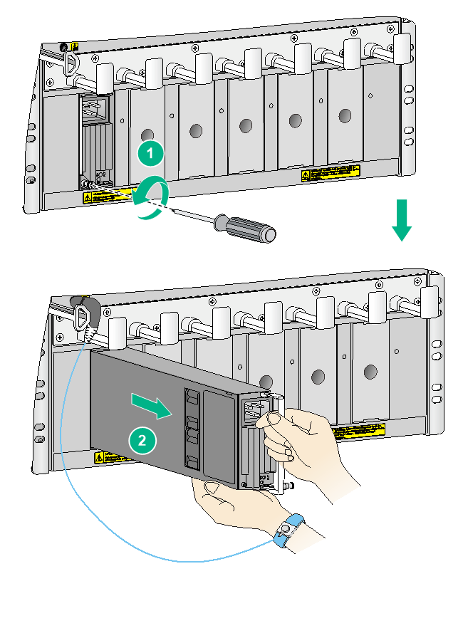

Replacing a card
CAUTION
CAUTION:
·     To remove the only MPU on the switch, first power off the switch.
·     Before you remove an MPU or service module, remove the cables from it.
·     Before you install the removed card again, make sure the status LED on it is off.
·     Install a blank filler panel in the slot where you are not to install a card.
·     To remove a switching fabric module, first press the OFFLINE button (if any) on it.

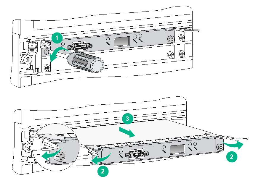

The cards can be installed in horizontal or vertical slots on the switch, and the replacement procedures are the same. The following takes a card installed in a horizontal slot as an example.
To replace a card:
1.     Prepare an antistatic mat to place the removed card.
2.     Wear an ESD wrist strap and make sure it makes good skin contact and is reliably grounded. For more information, see "Attaching an ESD wrist strap."
3.     Use a Phillips screwdriver to remove the captive screw on the card, as shown by callout 1 in Figure 5-7.
4.     Press the ejector buttons on the ejector levers to release the ejector levers. (This step is applicable only to a switching fabric module with ejector buttons on the ejector levers.)
5.     Simultaneously rotate outward the ejector levers to separate the card from the backplane, as shown by callout 2 in Figure 5-7.
For a base card, rotate the ejector levers downward to the horizontal position as shown in Figure 5-8.
6.     Use one hand to slowly move the card outwards. Supporting the bottom of the card with the other hand, pull the card out of the slot along slide rails, as shown by callout 3 in Figure 5-7.
7.     Put the removed card on the antistatic mat.
8.     Install a new card. For the installation procedures, see "Installing cards."
Figure 5-7 Replacing a card
Figure 5-8 Rotating the ejector levers of the base card downward

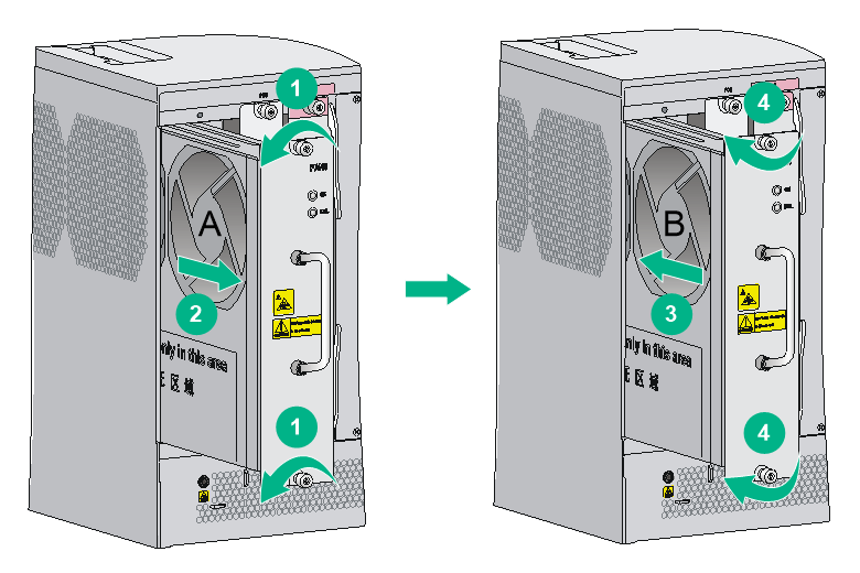

Replacing a fan tray
CAUTION
CAUTION:
·     To avoid bodily injury, do not touch the rotating fans when replacing the fan tray.
·     To ensure good ventilation, install a new fan tray within two minutes after removing the old one.
When a fan tray fails, replace the fan tray to ensure correct operation of the switch.
The fan tray removal and installation procedures for all switches are the same. The fan tray slot is vertically oriented.
To remove a fan tray:
1.     Prepare an antistatic mat to place the fan tray to be removed.
2.     Put on an ESD wrist strap and make sure the wrist strap makes good skin contact and is reliably grounded. For more information, see "Attaching an ESD wrist strap."
3.     Loosen the captive screws on the fan tray.
4.     Hold the handle of the fan tray with one hand to gently pull the fan tray part way out of the chassis. After the fans stop rotating, support the bottom of the fan tray with the other hand, and take out the fan tray from the chassis.
5.     Put the removed fan tray on the antistatic mat.
6.     Unpack the fan tray.
7.     Holding the handle of the fan tray with one hand and supporting the bottom with the other, gently slide the fan tray along the guide rails into the slot until it is firmly seated in the slot.
8.     Fasten the captive screws on the fan tray.
Figure 5-10 Replacing a fan tray
(A) Fan tray to be removed
(B) Fan tray to be installed

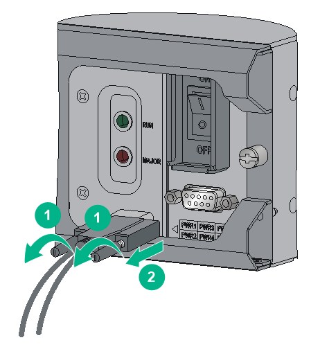

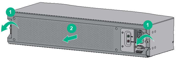

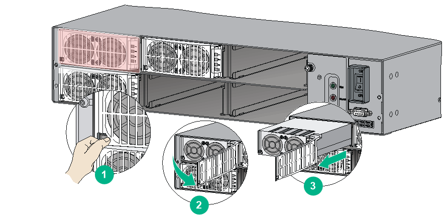

To replace a PoE power module for the external PoE power frame:
1.     Remove the DB-9 connector from the external PoE power frame.
Figure 5-14 Removing the DB-9 connector
2.     Loosen the screws on the front cover of the external PoE power frame and remove the front cover.
Figure 5-15 Removing the front cover

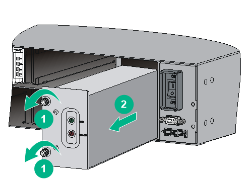

3.     Pull the retaining latch at the bottom left corner of the power module to the left to open the power module cover.
4.     Hold the bottom of the power module, gently pull out the module by its front panel.
Figure 5-16 Removing the power module

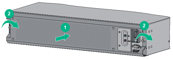

5.     Install the new power module. For more information, see "Connecting an external PoE power frame."
6.     Reinstall the front cover for the external PoE power frame and fasten the captive screws.
Figure 5-17 Installing the front cover

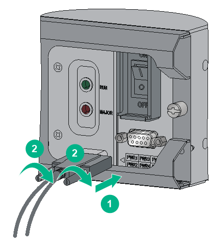

7.     Connect the DB-9 connector to the 9-core serial port on the external PoE power frame, and fasten the captive screws.
Figure 5-18 Connecting the DB-9 connector

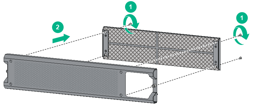

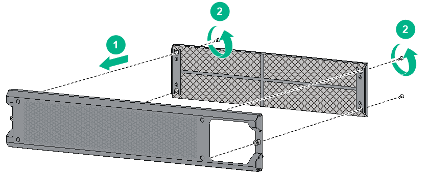

Replacing the air filter for the external PoE power frame
1.     Remove the DB-9 connector from the external PoE power frame, as shown in Figure 5-14.
2.     Remove the front cover from the external PoE power frame, as shown in Figure 5-15.
3.     Use a screwdriver to loosen screws on the air filter.
4.     Remove the air filter from the front cover.
Figure 5-21 Removing the air filter
5.     Secure the new air filter to the front cover and fasten the screws.
Figure 5-22 Installing the new air filter
6.     Reinstall the front cover for the external PoE power frame, as shown in Figure 5-17.
7.     Connect the DB-9 connector to the 9-core serial port on the external PoE power frame, and secure the captive screws, as shown in Figure 5-18.

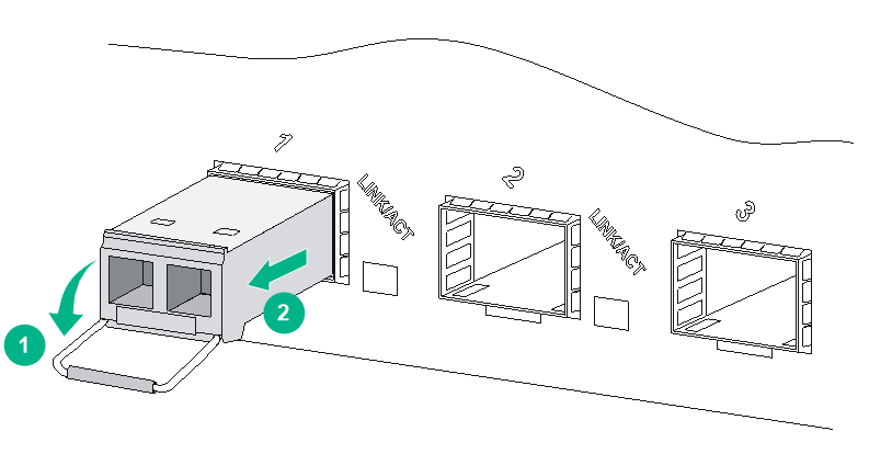

Replacing an XFP/SFP+/SFP/QSFP+ module
CAUTION
CAUTION:
·     Do not touch the golden plating on a transceiver module during the replacement process.
·     After removing a transceiver module, you must wait a minimum of 5 seconds before installing a new transceiver module.
·     Make sure the new transceiver module is the same model as the peer transceiver module at the other end of the optical fiber.
The replacement procedure is similar for XFP modules, SFP+ modules, SFP modules, and QSFP+ modules. The following procedure replaces an SFP+ module.
To replace an SFP+ module:
1.     Wear an ESD wrist strap and make sure it makes good skin contact and is reliably grounded.
2.     Remove the optical fibers from the module.
There is a latching mechanism between a fiber connector and transceiver module bore to prevent connector disengagement. Release the latching before removing the optical fiber. To avoid damages, do not use excessive force.
3.     Pivot the bail latch down to the horizontal position.
For a QSFP+ module that uses a plastic pull latch, skip this step.
4.     Hold the bail latch to pull the module out of the slot. Make sure you apply force in the direction parallel to the ground. To avoid damaging the bail latch, do not use excessive force.
If you apply force at an angle when pulling the module out, you can hardly pull the module out and the module or fiber port might be damaged.
5.     Insert the dust plugs into the removed module, and put the module into its packaging bag.
6.     Install a new module. For the installation procedure, see "Installing an XFP/SFP+/SFP/QSFP+ module."
Figure 5-23 Removing an SFP+ module

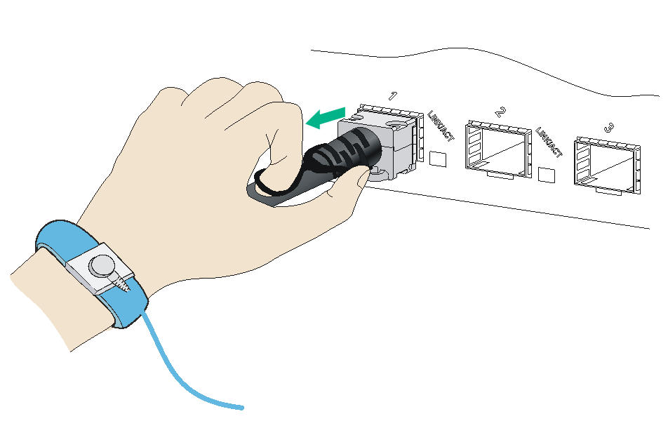

To replace an SFP+ DAC cable:
1.     Wear an ESD wrist strap and make sure it makes good skin contact and is reliably grounded. For more information, see "Attaching an ESD wrist strap."
2.     Push the modular end of the cable gently inward to release the latching mechanism. Then use the pull latch on the cable to pull the modular end out of the slot. Make sure you apply force in the direction parallel to the ground. To avoid damaging the pull latch, do not use excessive force.
If you apply force at an angle when pulling the module out, you can hardly pull the network cable out and the network cable or fiber port might be damaged.
Figure 5-24 Removing an SFP+ DAC cable
3.     Install a new cable. For the installation procedures, see "Connecting a network cable."
