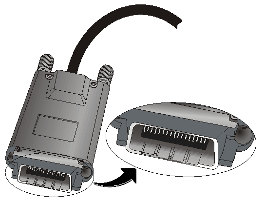

InfiniBand cable
InfiniBand cables are used to connect MATE copper ports, which use InfiniBand 4X connectors.
Figure 9-4 InfiniBand 4X connector

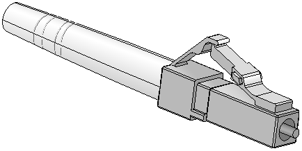

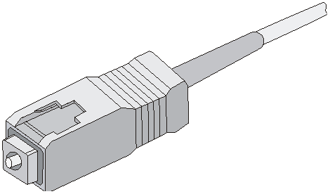

Fiber connector
Fiber connectors are indispensable passive components in an optical fiber communication system. They allow the removable connection between optical channels, which makes the optical system debugging and maintenance more convenient and the transit dispatching of the system more flexible.
Figure 9-5 SC connector
Figure 9-6 LC connector

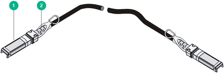

SFP+ DAC cable
You can use SFP+ DAC cables to connect SFP+ ports. The SFP+ DAC cables available for the switch series are 10 G SFP+ Cu cables, as shown in Figure 9-7.
Figure 9-7 SFP+ DAC cable
(1) Connector
(2) Pull latch

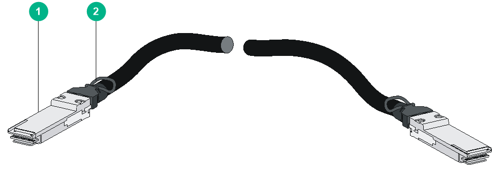

QSFP+ DAC/QSFP28 DAC cable
You can use QSFP+ DAC cables to connect QSFP+ ports.
You can use QSFP28 DAC cables to connect QSFP28 ports. The QSFP28 DAC cables are similar to QSFP+ DAC cables in appearance.
Figure 9-8 QSFP+ DAC cable
(1) Connector
(2) Pull latch

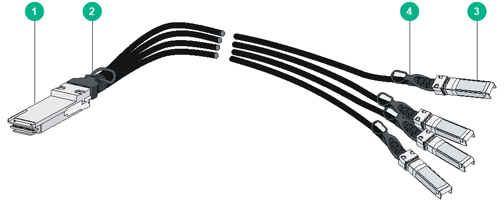

QSFP+ to SFP+ DAC cable
A QSFP+ to SFP+ DAC cable is a cable with one QSFP+ module at one end and four SFP+ modules at the other end.
Figure 9-9 QSFP+ to SFP+ DAC cable
(1) QSFP+ connector
(2) QSFP+ pull latch
(3) SFP+ connector
(4) SFP+ pull latch
