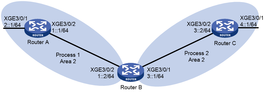

Enabling OSPFv3
To enable an OSPFv3 process on a router:
1.     Enable the OSPFv3 process globally.
2.     Assign the OSPFv3 process a router ID.
3.     Enable the OSPFv3 process on related interfaces.
An OSPFv3 process ID has only local significance. Process 1 on a router can exchange packets with process 2 on another router.
OSPFv3 requires you to manually specify a router ID for each router in an AS. Make sure all assigned router IDs in the AS are unique.
Restrictions and guideline
If a router runs multiple OSPFv3 processes, you must specify a unique router ID for each process.
2.     Enable an OSPFv3 process and enter its view.
ospfv3 [ process-id | vpn-instance vpn-instance-name ] *
By default, no OSPFv3 processes are enabled.
3.     (Optional.) Configure a description for the OSPFv3 process.
description text
By default, no description is configured for an OSPFv3 process.
To identify and manage different OSPFv3 processes, configure a unique description for each process.
4.     Specify a router ID.
router-id router-id
By default, no router ID is configured.
5.     Enter interface view.
6.     Enable an OSPFv3 process on the interface.
ospfv3 process-id area area-id [ instance instance-id ]
By default, no OSPFv3 processes are enabled on an interface.

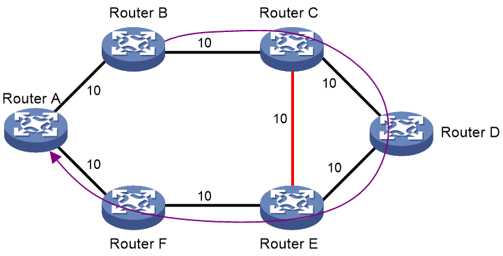

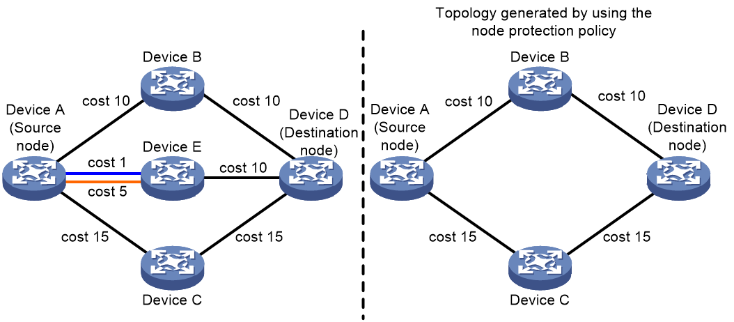

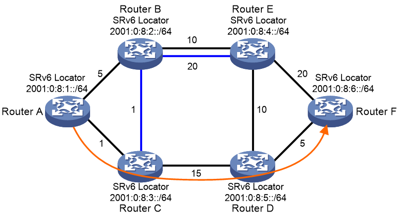

As shown in Figure 1, when no flexible algorithm is configured, all nodes calculate optimal paths by OSPFv3 link cost.
Figure 1 Topology without flexible algorithm 130
For comparison, you can configure flexible algorithm 130 for all nodes except Router F. The FAD of flexible algorithm 130 is as follows:
·     Calculation type—SPF algorithm.
·     Metric type—OSPFv3 link cost.
·     Constraint—Exclude affinity attribute red.

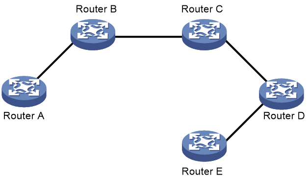

In the new topology shown in Figure 2, all nodes calculate optimal paths based on the calculation type and metric type in the FAD.
Figure 2 Topology with flexible algorithm 130

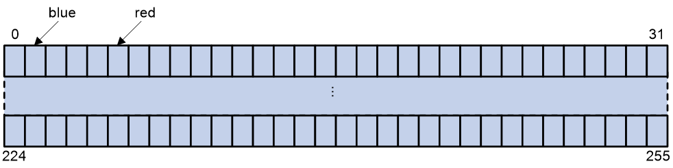

OSPFv3 supports a maximum of 256 affinity bits. They are numbered from 0 to 255. You can perform this task to map different affinity attribute names to these bits. As shown in Figure 3, affinity attribute name blue is mapped to bit 1, and red to bit 5.
This feature enables you to configure affinity attributes for links or define the flexible algorithm topology by specifying only the affinity attribute names.
Figure 3 Mapping an affinity attribute to an affinity bit

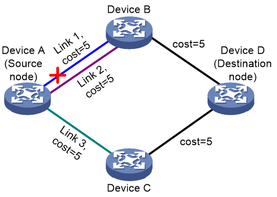

Configuring flexible algorithm FRR
The flexible algorithm FRR is similar to OSPFv3 LFA FRR, because it uses LFA to calculate a loop-free backup path with the lowest cost based on the topology.

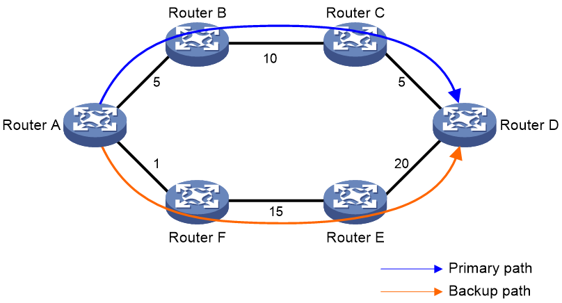

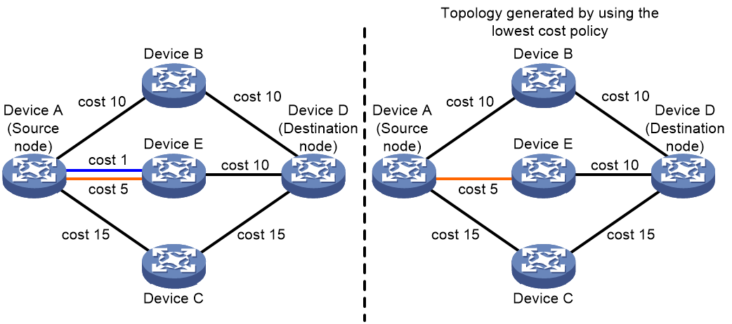

For illustration, flexible algorithm 130 is configured for all nodes in Figure 4. The FAD of flexible algorithm 130 is as follows:
Figure 4 Topology without flexible algorithm 130

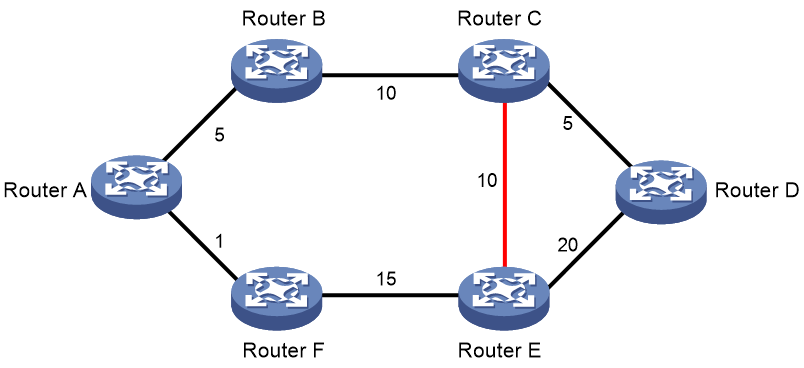

In Figure 5, after you enable FRR, flexible algorithm 130 uses LFA to calculate a primary path and a backup path from Router A to Router D.
Figure 5 Topology with flexible algorithm 130
2.     Enter OSPFv3 view.
3.     Enter flexible algorithm view.
flex-algo flex-algo-id
4.     Enable flexible algorithm FRR.
fast-reroute enable
By default, flexible algorithm FRR is enabled.
If no backup paths exist in the network, execute the undo fast-reroute enable command to disable flexible algorithm FRR to save device resources.

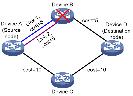

Configuring flexible algorithm TI-LFA FRR
About TI-LFA FRR
Topology-Independent Loop-free Alternate Fast Reroute (TI-LFA FRR) is an enhanced version of LFA FRR. TI-LFA FRR uses the same algorithms to calculate P space and Q space as Remote LFA FRR. This feature can protect a topology without PQ nodes.
For more information about P space, Q space and TI-LFA FRR path calculation, see SRv6 configuration in Segment Routing Configuration Guide.
TI-LFA FRR protection types
The following TI-LFA traffic protection types are available:
·     Link protection—Protects traffic that traverses a specific link.
·     Node protection—Protects traffic that traverses a specific node.
Node protection takes precedence over link protection.
TI-LFA FRR uses the common algorithm to calculate backup paths for a flexible algorithm. The only difference is that TI-LFA FRR calculates backup paths for a flexible algorithm according to the FAD and topology of that flexible algorithm.

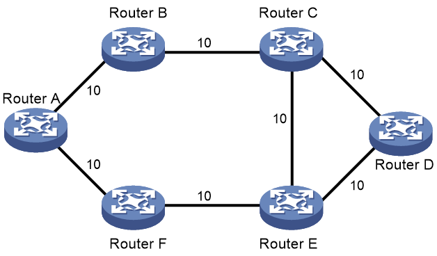

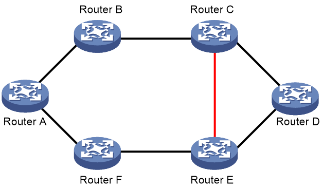

As shown in Figure 6, Router B is the source node and Router A is the destination node.
The number on each link represents the link cost. A data flow traverses from Router B to Router A. To avoid traffic loss against Router B failure, TI-LFA FRR calculates the backup path: Router B > Router C > Router E > Router F > Router A.
Figure 6 TI-LFA FRR backup path calculation without a flexible algorithm
As shown in Figure 7, flexible algorithm 130 is configured for each node. The FAD of flexible algorithm 130 is as follows:
In this case, the backup path calculated by TI-LFA FRR is Router B > Router C > Router D > Router E > Router F > Router A.
Figure 7 TI-LFA FRR backup path calculation with a flexible algorithm

Configuring OSPFv3 FRR
About OSPFv3 FRR
A primary link failure can cause packet loss and even a routing loop until OSPFv3 completes routing convergence based on the new network topology. OSPFv3 FRR enables fast rerouting to minimize the failover time.
Figure 9 Network diagram for OSPFv3 FRR
As shown in Figure 9, configure FRR on Router B. OSPFv3 FRR automatically calculates a backup next hop or specifies a backup next hop by using a routing policy. When the primary link fails, OSPFv3 directs packets to the backup next hop. At the same time, OSPFv3 calculates the shortest path based on the new network topology. It forwards packets over the path after network convergence.
You can configure OSPFv3 FRR to calculate a backup next hop by using the loop free alternate (LFA) algorithm, or specify a backup next hop by using a routing policy.
Configuring OSPFv3 FRR to use the LFA algorithm to calculate a backup next hop

OSPFv3 ECMP FRR
In ECMP scenarios, you can configure OSPF to calculate a backup next hop separately for each ECMP route with the LFA algorithm. ECMP routes might not share the same backup next hop.
As shown in Figure 10, the source node Device A forwards traffic to the destination node Device D. Traffic is load balanced among Link 1, Link 2, and Link 3.
·     With ECMP FRR disabled, OSPF does not calculate a backup next hop separately for Link 1, Link 2, and Link 3. When Link 1 fails, traffic previously forwarded through Link 1 is randomly switched to Link 2 or Link 3. This does not facilitate service traffic management.
·     With ECMP FRR enabled, OSPF calculates a backup next hop separately for Link 1, Link 2, and Link 3. For example, if the backup next hop for Link 1 is Device C, when Link 1 fails, traffic previously forwarded through Link 1 is switched to backup next hop Device C. This facilitates service traffic management.
Figure 10 Network diagram for OSPFv3 ECMP FRR
OSPFv3 ECMP-shared FRR
In ECMP scenarios, you can configure OSPF to calculate a backup next hop for ECMP routes with the LFA algorithm. ECMP routes share the same backup next hop.
As shown in Figure 11, the source node Device A forwards traffic to the destination node Device D. Traffic is load balanced between Link 1 and Link 2. ECMP-shared FRR operates as follows:
·     With ECMP-shared FRR disabled, OSPF does not calculate any backup next hop for Link 1 or Link 2. When Device B fails, Link 1 and Link 2 both fail, causing traffic disruption before routing convergence.
·     With ECMP-shared FRR enabled, OSPF calculates a backup next hop for Link 1 and Link 2. If Device B fails, traffic is switched to the backup next hop Device C, preventing traffic disruption.
Figure 11 Network diagram for OSPFv3 ECMP-shared FRR

OSPFv3 FRR uses different backup path selection policies to select the backup path as follows:
·     Node protection policy
As shown in Figure 12, Device A uses the node protection policy and selects path Device A->Device B->Device D as the backup path.
Figure 12 Node protection backup path selection
·     Lowest cost policy
As shown in Figure 13, Device A uses the lowest cost policy and selects path Device A->Device E->Device D as the backup path.
Figure 13 Lowest cost backup path selection

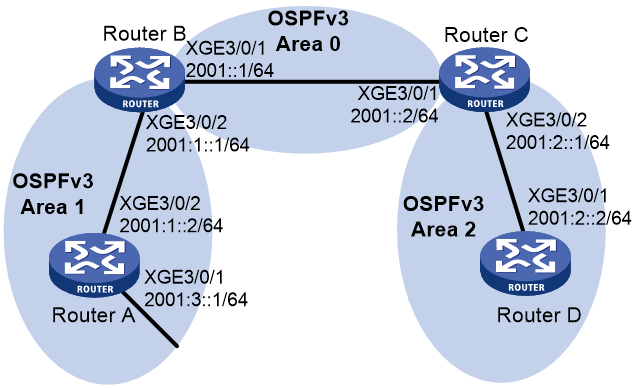

OSPFv3 configuration examples

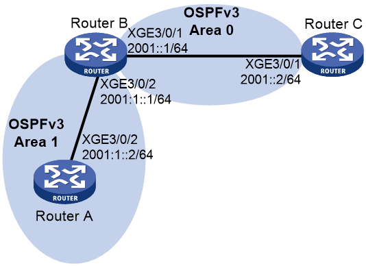

Example: Configuring OSPFv3 stub area
As shown in Figure 14:
·     Enable OSPFv3 on all routers.
·     Split the AS into three areas.
·     Configure Router B and Router C as ABRs to forward routing information between areas.
·     Configure Area 2 as a stub area to reduce LSAs in the area without affecting route reachability.
Figure 14 Network diagram
1.     Configure IPv6 addresses for interfaces. (Details not shown.)
2.     Configure basic OSPFv3:
# On Router A, enable OSPFv3 and specify the router ID as 1.1.1.1.
<RouterA> system-view
[RouterA] ospfv3 1
[RouterA-ospfv3-1] router-id 1.1.1.1
[RouterA-ospfv3-1] quit
[RouterA] interface ten-gigabitethernet 3/0/1
[RouterA-Ten-GigabitEthernet3/0/1] ospfv3 1 area 1
[RouterA-Ten-GigabitEthernet3/0/1] quit
[RouterA] interface ten-gigabitethernet 3/0/2
[RouterA-Ten-GigabitEthernet3/0/2] ospfv3 1 area 1
[RouterA-Ten-GigabitEthernet3/0/2] quit
# On Router B, enable OSPFv3 and specify the router ID as 2.2.2.2.
<RouterB> system-view
[RouterB] ospfv3 1
[RouterB-ospfv3-1] router-id 2.2.2.2
[RouterB-ospfv3-1] quit
[RouterB] interface ten-gigabitethernet 3/0/1
[RouterB-Ten-GigabitEthernet3/0/1] ospfv3 1 area 0
[RouterB-Ten-GigabitEthernet3/0/1] quit
[RouterB] interface ten-gigabitethernet 3/0/2
[RouterB-Ten-GigabitEthernet3/0/2] ospfv3 1 area 1
[RouterB-Ten-GigabitEthernet3/0/2] quit
# On Router C, enable OSPFv3 and specify the router ID as 3.3.3.3.
<RouterC> system-view
[RouterC] ospfv3 1
[RouterC-ospfv3-1] router-id 3.3.3.3
[RouterC-ospfv3-1] quit
[RouterC] interface ten-gigabitethernet 3/0/1
[RouterC-Ten-GigabitEthernet3/0/1] ospfv3 1 area 0
[RouterC-Ten-GigabitEthernet3/0/1] quit
[RouterC] interface ten-gigabitethernet 3/0/2
[RouterC-Ten-GigabitEthernet3/0/2] ospfv3 1 area 2
[RouterC-Ten-GigabitEthernet3/0/2] quit
# On Router D, enable OSPFv3 and specify the router ID as 4.4.4.4.
<RouterD> system-view
[RouterD] ospfv3 1
[RouterD-ospfv3-1] router-id 4.4.4.4
[RouterD-ospfv3-1] quit
[RouterD] interface ten-gigabitethernet 3/0/2
[RouterD-Ten-GigabitEthernet3/0/2] ospfv3 1 area 2
[RouterD-Ten-GigabitEthernet3/0/2] quit
# Display OSPFv3 neighbors on Router B.
[RouterB] display ospfv3 peer
               OSPFv3 Process 1 with Router ID 2.2.2.2
 Area: 0.0.0.0
 Router ID       Pri State             Dead-Time InstID Interface
 3.3.3.3         1   Full/BDR          00:00:40  0      XGE3/0/1
 Area: 0.0.0.1
 1.1.1.1         1   Full/DR           00:00:40  0      XGE3/0/2
# Display OSPFv3 neighbors on Router C.
[RouterC] display ospfv3 peer
               OSPFv3 Process 1 with Router ID 3.3.3.3
 Area: 0.0.0.0
 2.2.2.2         1   Full/DR           00:00:40  0      XGE3/0/1
 Area: 0.0.0.2
 4.4.4.4         1   Full/BDR          00:00:40  0      XGE3/0/2
# Display OSPFv3 neighbors on Router D.
[RouterD] display ospfv3 routing
               OSPFv3 Process 1 with Router ID 4.4.4.4
 I  - Intra area route,  E1 - Type 1 external route,  N1 - Type 1 NSSA route
 IA - Inter area route,  E2 - Type 2 external route,  N2 - Type 2 NSSA route
 *  - Selected route
*Destination: 2001::/64
  Type       : IA                        Area       : 0.0.0.2
  AdvRouter  : 3.3.3.3                   Preference : 10
  NibID      : 0x23000004                Cost       : 2
  Interface  : XGE3/0/2                  BkInterface: N/A
  Nexthop    : FE80::48C0:26FF:FEDA:305
  BkNexthop  : N/A
  Status     : Rely
 *Destination: 2001:1::/64
  NibID      : 0x23000004                Cost       : 3
  BkNexthop  : N/A
  Status     : Rely
 *Destination: 2001:2::/64
  Type       : I                         Area       : 0.0.0.2
  AdvRouter  : 4.4.4.4                   Preference : 10
  NibID      : 0x23000002                Cost       : 1
  Nexthop    : ::
  BkNexthop  : N/A
  Status     : Direct
 *Destination: 2001:3::1/128
  BkNexthop  : N/A
  Status     : Rely
 Total: 4
 Intra area: 1         Inter area: 3         ASE: 0         NSSA: 0
3.     Configure Area 2 as a stub area:
# Configure Router D.
[RouterD] ospfv3
[RouterD-ospfv3-1] area 2
[RouterD-ospfv3-1-area-0.0.0.2] stub
[RouterD-ospfv3-1-area-0.0.0.2] quit
# Configure Router C, and specify the cost of the default route sent to the stub area as 10.
[RouterC] ospfv3

Example: Configuring OSPFv3 NSSA area
As shown in Figure 15:
·     Configure OSPFv3 on all routers and split the AS into three areas.
·     Configure Area 1 as an NSSA area and configure Router A as an ASBR to redistribute static routes into the AS.
Figure 15 Network diagram
2.     Configure basic OSPFv3 (see "Example: Configuring OSPFv3 stub area").
3.     Configure Area 1 as an NSSA area:

Example: Configuring OSPFv3 route redistribution
As shown in Figure 17:
·     Router A, Router B, and Router C are in Area 2.
·     OSPFv3 process 1 and OSPFv3 process 2 run on Router B. Router B communicates with Router A and Router C through OSPFv3 process 1 and OSPFv3 process 2.
·     Configure OSPFv3 process 2 to redistribute direct routes and the routes from OSPFv3 process 1 on Router B, and set the metric for redistributed routes to 3. Router C can then learn the routes destined for 1::0/64 and 2::0/64, and Router A cannot learn the routes destined for 3::0/64 or 4::0/64.
Figure 17 Network diagram
# Enable OSPFv3 process 1 on Router A.
[RouterA] ospfv3 1
[RouterA-Ten-GigabitEthernet3/0/2] ospfv3 1 area 2
[RouterA-Ten-GigabitEthernet3/0/1] ospfv3 1 area 2
# Enable OSPFv3 process 1 and OSPFv3 process 2 on Router B.
[RouterB] ospfv3 1
[RouterB-Ten-GigabitEthernet3/0/2] ospfv3 1 area 2
[RouterB] ospfv3 2
[RouterB-ospfv3-2] router-id 3.3.3.3
[RouterB-ospfv3-2] quit
[RouterB-Ten-GigabitEthernet3/0/1] ospfv3 2 area 2
# Enable OSPFv3 process 2 on Router C.
[RouterC] ospfv3 2
[RouterC-ospfv3-2] router-id 4.4.4.4
[RouterC-ospfv3-2] quit
[RouterC-Ten-GigabitEthernet3/0/2] ospfv3 2 area 2
[RouterC-Ten-GigabitEthernet3/0/1] ospfv3 2 area 2
# Display the routing table on Router C.
[RouterC] display ipv6 routing-table
Destinations : 6 Routes : 6
Destination: ::1/128                                     Protocol  : Direct
NextHop    : ::1                                         Preference: 0
Interface  : InLoop0                                     Cost      : 0
Destination: 3::/64                                      Protocol  : Direct
NextHop    : ::                                          Preference: 0
Interface  : XGE3/0/2                                    Cost      : 0
Destination: 3::2/128                                    Protocol  : Direct
Destination: 4::/64                                      Protocol  : Direct
Interface  : XGE3/0/1                                    Cost      : 0
Destination: 4::1/128                                    Protocol  : Direct
Destination: FE80::/10                                   Protocol  : Direct
Interface  : NULL0                                       Cost      : 0
3.     Configure OSPFv3 route redistribution:
# Configure OSPFv3 process 2 to redistribute direct routes and the routes from OSPFv3 process 1 on Router B, and set the metric for redistributed routes to 3.
[RouterB] ospfv3 2
[RouterB-ospfv3-2] import-route ospfv3 1 cost 3
[RouterB-ospfv3-2] import-route direct cost 3
Destinations : 8 Routes : 8
Destination: 1::/64                                      Protocol  : O_ASE2
NextHop    : FE80::200:CFF:FE01:1C03                     Preference: 150
Interface  : XGE3/0/2                                    Cost      : 3
Destination: 2::/64                                      Protocol  : O_ASE2
Example: Configuring OSPFv3 route summarization
As shown in Figure 18:
·     OSPFv3 process 1 and OSPFv3 process 2 run on Router B. Router B communicates with Router A and Router C through OSPFv3 process 1 and OSPFv3 process 2, respectively.
·     On Router A, configure IPv6 addresses 2:1:1::1/64, 2:1:2::1/64, and 2:1:3::1/64 for Ten-GigabitEthernet 3/0/1.
·     On Router B, configure OSPFv3 process 2 to redistribute direct routes and the routes from OSPFv3 process 1. Router C can then learn the routes destined for 2::/64, 2:1:1::/64, 2:1:2::/64, and 2:1:3::/64.
·     On Router B, configure route summarization to advertise only summary route 2::/16 to Router C.
Figure 18 Network diagram
2.     Configure OSPFv3:
[RouterA] ospfv3 1
[RouterA-Ten-GigabitEthernet3/0/1] ipv6 address 2:1:1::1 64
[RouterA-Ten-GigabitEthernet3/0/1] ipv6 address 2:1:2::1 64
[RouterA-Ten-GigabitEthernet3/0/1] ipv6 address 2:1:3::1 64
[RouterB] ospfv3 1
[RouterB] ospfv3 2
[RouterC] ospfv3 2
# Configure OSPFv3 process 2 to redistribute direct routes and the routes from OSPFv3 process 1 on Router B.
[RouterB] ospfv3 2

Example: Configuring OSPFv3 FRR
As shown in Figure 21, Router A, Router B, and Router C reside in the same OSPFv3 domain. Configure OSPFv3 FRR so that when Link A fails, traffic is immediately switched to Link B.
Figure 21 Network diagram
Table 3 Interface and IP address assignment

1.     Configure IPv6 addresses for interfaces on the routers. (Details not shown.)
2.     Configure OSPFv3 on the routers to ensure that Router A, Router B, and Router C can communicate with each other at the network layer. (Details not shown.)
3.     Configure OSPFv3 FRR:
You can enable OSPFv3 FRR to either calculate a backup next hop by using the LFA algorithm, or specify a backup next hop by using a routing policy.
¡     (Method 1.) Enable OSPFv3 FRR to calculate a backup next hop by using the LFA algorithm:
# Configure Router A.
[RouterA] ospfv3 1
[RouterA-ospfv3-1] fast-reroute lfa
# Configure Router B.
[RouterB] ospfv3 1
[RouterB-ospfv3-1] fast-reroute lfa
¡     (Method 2.) Enable OSPFv3 FRR to specify a backup next hop by using a routing policy:
[RouterA] ipv6 prefix-list abc index 10 permit 20::1 128
[RouterA] route-policy frr permit node 10
[RouterA-route-policy-frr-10] if-match ipv6 address prefix-list abc
[RouterA-route-policy-frr-10] apply ipv6 fast-reroute backup-interface ten-gigabitethernet 3/0/1 backup-nexthop fe80::6eab:8bff:fed4:205
[RouterA-route-policy-frr-10] quit
[RouterA] ospfv3 1
[RouterA-ospfv3-1] fast-reroute route-policy frr
[RouterB] ipv6 prefix-list abc index 10 permit 10::1 128
[RouterB] route-policy frr permit node 10
[RouterB-route-policy-frr-10] if-match ipv6 address prefix-list abc
[RouterB-route-policy-frr-10] apply ipv6 fast-reroute backup-interface ten-gigabitethernet 3/0/1 backup-nexthop fe80::6eab:8bff:fed4:206
[RouterB-route-policy-frr-10] quit
[RouterB] ospfv3 1
[RouterB-ospfv3-1] fast-reroute route-policy frr

Example: Configuring OSPFv3 IPsec profile
As shown in Figure 22, all routers run OSPFv3, and the AS is divided into two areas.
Configure IPsec profiles on the routers to authenticate and encrypt protocol packets.
Figure 22 Network diagram
2.     Configure OSPFv3 basic features:
[RouterA] ospfv3 1
[RouterB] ospfv3 1
[RouterC] ospfv3 1
3.     Configure OSPFv3 IPsec profiles:
¡     On Router A:
# Create an IPsec transform set named trans.
[RouterA] ipsec transform-set trans
# Specify the encapsulation mode as transport.
[RouterA-ipsec-transform-set-trans] encapsulation-mode transport
# Specify the ESP encryption and authentication algorithms.
[RouterA-ipsec-transform-set-trans] protocol esp
[RouterA-ipsec-transform-set-trans] esp encryption-algorithm aes-cbc-128
[RouterA-ipsec-transform-set-trans] esp authentication-algorithm sha1
[RouterA-ipsec-transform-set-trans] quit
# Create a manual IPsec profile named profile001.
[RouterA] ipsec profile profile001 manual
# Use IPsec transform set trans.
[RouterA-ipsec-profile-manual-profile001] transform-set trans
# Configure the inbound and outbound SPIs for ESP.
[RouterA-ipsec-profile-manual-profile001] sa spi outbound esp 123456
[RouterA-ipsec-profile-manual-profile001] sa spi inbound esp 123456
# Configure the inbound and outbound SA keys for ESP.
[RouterA-ipsec-profile-manual-profile001] sa string-key outbound esp simple abcdefg
[RouterA-ipsec-profile-manual-profile001] sa string-key inbound esp simple abcdefg
[RouterA-ipsec-profile-manual-profile001] quit
¡     On Router B:
[RouterB] ipsec transform-set trans
[RouterB-ipsec-transform-set-trans] encapsulation-mode transport
[RouterB-ipsec-transform-set-trans] protocol esp
[RouterB-ipsec-transform-set-trans] esp encryption-algorithm aes-cbc-128
[RouterB-ipsec-transform-set-trans] esp authentication-algorithm sha1
[RouterB-ipsec-transform-set-trans] quit
[RouterB] ipsec profile profile001 manual
[RouterB-ipsec-profile-manual-profile001] transform-set trans
[RouterB-ipsec-profile-manual-profile001] sa spi outbound esp 123456
[RouterB-ipsec-profile-manual-profile001] sa spi inbound esp 123456
[RouterB-ipsec-profile-manual-profile001] sa string-key outbound esp simple abcdefg
[RouterB-ipsec-profile-manual-profile001] sa string-key inbound esp simple abcdefg
[RouterB-ipsec-profile-manual-profile001] quit
# Create a manual IPsec profile named profile002.
[RouterB] ipsec profile profile002 manual
[RouterB-ipsec-profile-manual-profile002] transform-set trans
[RouterB-ipsec-profile-manual-profile002] sa spi outbound esp 256
[RouterB-ipsec-profile-manual-profile002] sa spi inbound esp 256
[RouterB-ipsec-profile-manual-profile002] sa string-key outbound esp simple byebye
[RouterB-ipsec-profile-manual-profile002] sa string-key inbound esp simple byebye
[RouterB-ipsec-profile-manual-profile002] quit
¡     On Router C:
[RouterC] ipsec transform-set trans
[RouterC-ipsec-transform-set-trans] encapsulation-mode transport
[RouterC-ipsec-transform-set-trans] protocol esp
[RouterC-ipsec-transform-set-trans] esp encryption-algorithm aes-cbc-128
[RouterC-ipsec-transform-set-trans] esp authentication-algorithm sha1
[RouterC-ipsec-transform-set-trans] quit
[RouterC] ipsec profile profile002 manual
[RouterC-ipsec-profile-manual-profile002] transform-set trans
[RouterC-ipsec-profile-manual-profile002] sa spi outbound esp 256
[RouterC-ipsec-profile-manual-profile002] sa spi inbound esp 256
[RouterC-ipsec-profile-manual-profile002] sa string-key outbound esp simple byebye
[RouterC-ipsec-profile-manual-profile002] sa string-key inbound esp simple byebye
[RouterC-ipsec-profile-manual-profile002] quit
4.     Apply the IPsec profiles to areas:
[RouterA] ospfv3 1
[RouterA-ospfv3-1] area 1
[RouterA-ospfv3-1-area-0.0.0.1] enable ipsec-profile profile001
[RouterA-ospfv3-1-area-0.0.0.1] quit
[RouterB] ospfv3 1
[RouterB-ospfv3-1] area 0
[RouterB-ospfv3-1-area-0.0.0.0] enable ipsec-profile profile002
[RouterB-ospfv3-1-area-0.0.0.0] quit
[RouterB-ospfv3-1] area 1
[RouterB-ospfv3-1-area-0.0.0.1] enable ipsec-profile profile001
[RouterB-ospfv3-1-area-0.0.0.1] quit
# Configure Router C.
[RouterC] ospfv3 1
[RouterC-ospfv3-1] area 0
[RouterC-ospfv3-1-area-0.0.0.0] enable ipsec-profile profile002
[RouterC-ospfv3-1-area-0.0.0.0] quit
# Verify that OSPFv3 packets between Routers A, B, and C are protected by IPsec. (Details not shown.)
