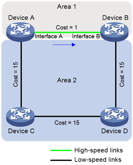

You can configure route summarization on ABRs to reduce the number of LSAs advertised to other areas and minimize the effect of topology changes.
Figure 1 Area-based OSPF network partition

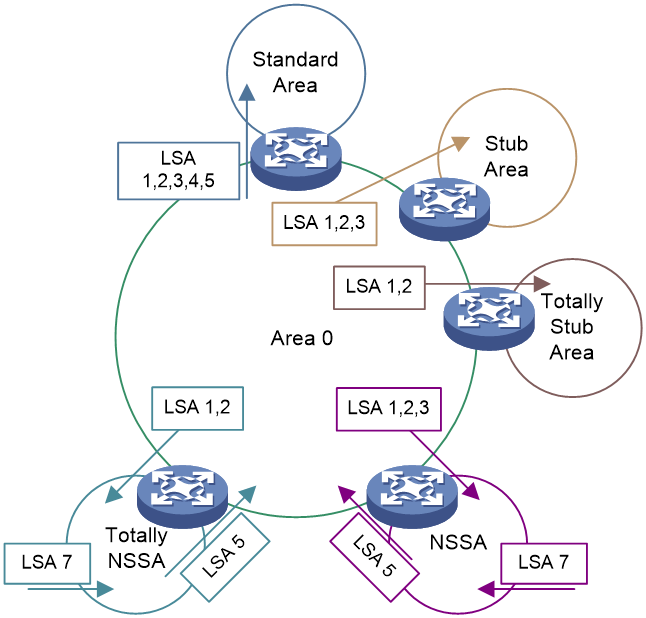

OSPF supports the following types of areas:
·     Standard area.
·     Backbone area.
·     Stub area.
·     Totally stub area.
·     Not-so-stubby area (NSSA).
·     Totally NSSA area.
Standard area
A standard area is the default OSPF area, which transmits intra-area routes, inter-area routes, and external routes.
Backbone area
Each AS has a backbone area that distributes routing information between non-backbone areas. Routing information between non-backbone areas must be forwarded by the backbone area. OSPF has the following requirements:
·     All non-backbone areas must maintain connectivity to the backbone area.
·     The backbone area must maintain connectivity within itself.

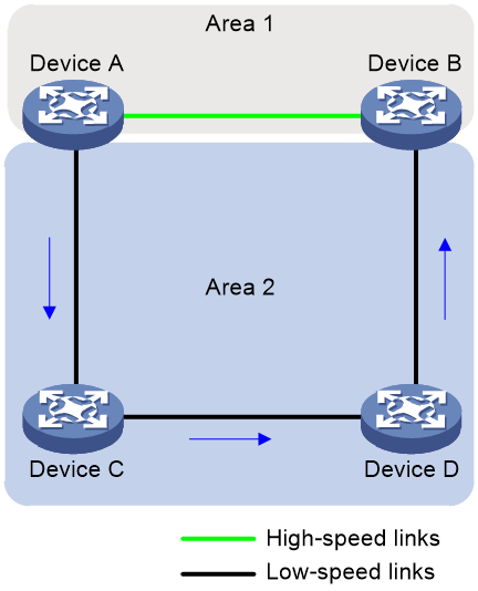

In practice, these requirements might not be met due to lack of physical links. OSPF virtual links can solve this issue.
Stub area and totally stub area
A stub area does not distribute Type-5 LSAs to reduce the routing table size and LSAs advertised within the area. The ABR of the stub area advertises a default route in a Type-3 LSA so that the routers in the area can reach external networks through the default route.
To further reduce the routing table size and advertised LSAs, you can configure the stub area as a totally stub area. The ABR of a totally stub area does not advertise inter-area routes or external routes. It advertises a default route in a Type-3 LSA so that the routers in the area can reach external networks through the default route.
NSSA area and totally NSSA area
An NSSA area does not import AS external LSAs (Type-5 LSAs) but can import Type-7 LSAs generated by the NSSA ASBR. The NSSA ABR translates Type-7 LSAs into Type-5 LSAs and advertises the Type-5 LSAs to other areas.

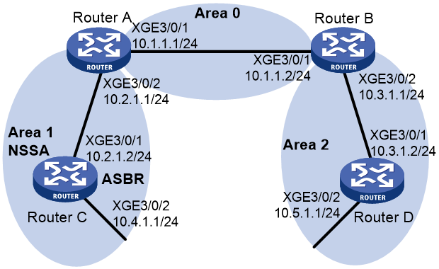

As shown in Figure 2, the OSPF AS contains Area 1, Area 2, and Area 0. The other two ASs run RIP. Area 1 is an NSSA area where the ASBR redistributes RIP routes in Type-7 LSAs into Area 1. Upon receiving the Type-7 LSAs, the NSSA ABR translates them to Type-5 LSAs, and advertises the Type-5 LSAs to Area 0.
The ASBR of Area 2 redistributes RIP routes in Type-5 LSAs into the OSPF routing domain. However, Area 1 does not receive Type-5 LSAs because it is an NSSA area.
Figure 2 NSSA area

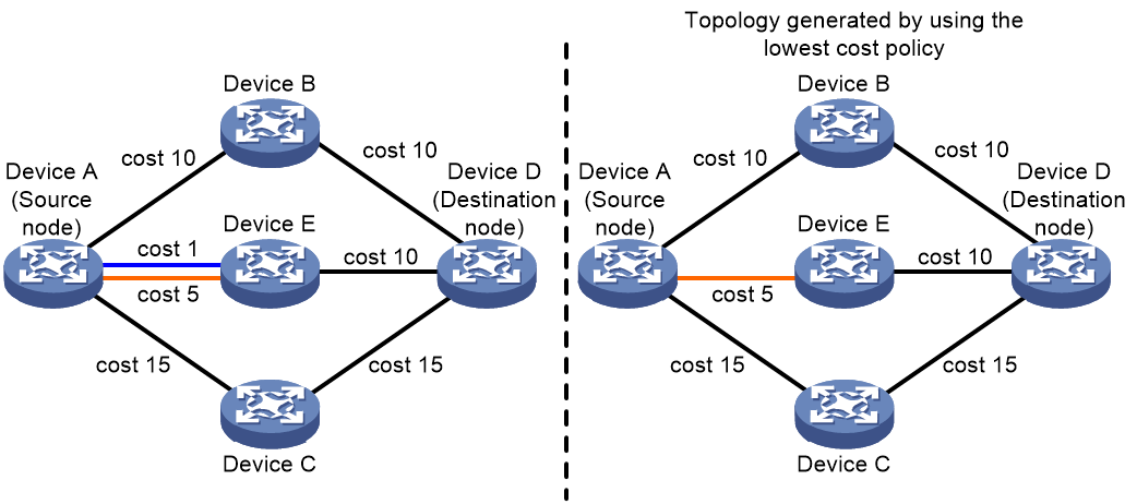

Router types

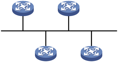

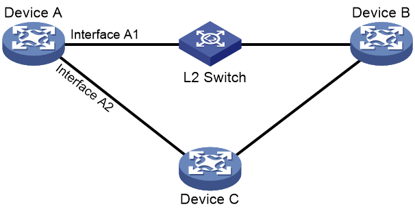

As shown in Figure 3, OSPF routers are classified into different types, including internal routers, ABRs, backbone routers, and ASBRs.
Figure 3 OSPF router types
Internal router
All interfaces on an internal router belong to one OSPF area.
ABR
An ABR belongs to more than two areas, one of which must be the backbone area. ABR connects the backbone area to a non-backbone area. An ABR and the backbone area can be connected through a physical or logical link.
Backbone router
No less than one interface of a backbone router must reside in the backbone area. All ABRs and internal routers in Area 0 are backbone routers.
ASBR
An ASBR exchanges routing information with another AS. An ASBR might not reside on the border of the AS. It can be an internal router or an ABR.

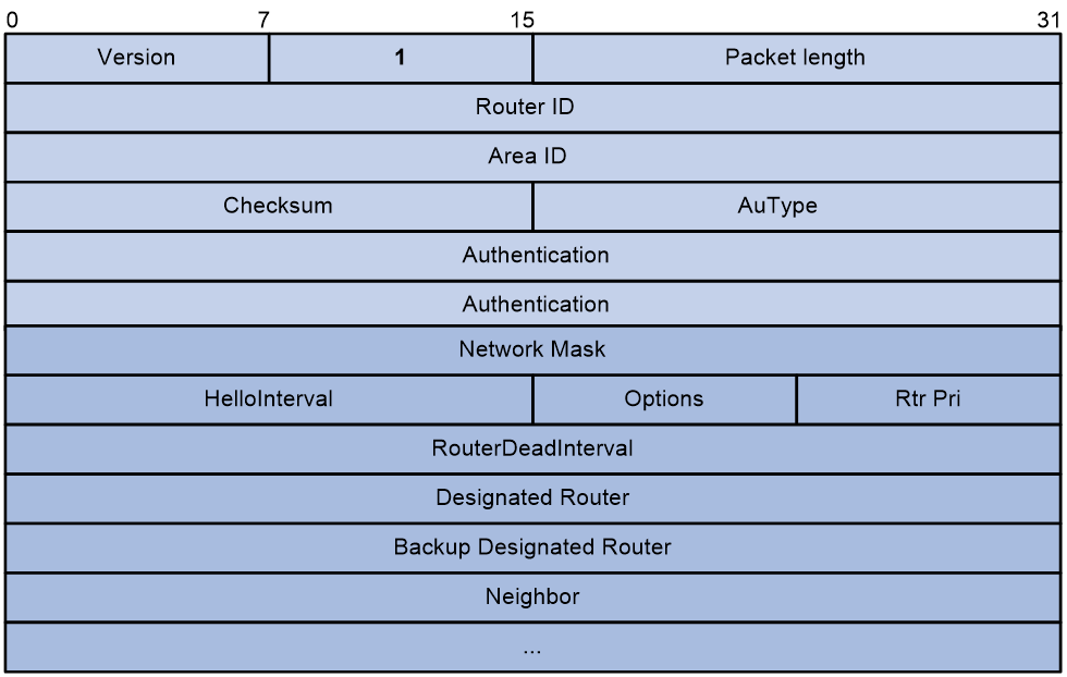

Hello packet
Hello packets establish and maintain adjacency relationships. The format of a hello packet is shown in Figure 5.
Figure 5 Hello packet format
Fields in a hello packet are as shown in Table 3.
Table 3 Fields in a hello packet
Field
Length
Description
Network Mask
32-bit
The mask of the network where the interface that transmits hello packets is located.
HelloInterval
16-bit
Transmitting interval for the hello packet.
Options
8-bit
The options of the hello packet:
·     DC—On-demand link
·     N/P—Processing method for Type-7 LSAs.
·     MC—Whether to forward multicast packets.
·     E—Whether flooding of AS-External LSAs is permitted.
¡     1—Flooding of AS-External LSAs is permitted.
¡     0—Flooding of AS-External LSAs is not permitted.
Rtr Pri
8-bit
DR priority. The default value is 1.
RouterDeadInterval
32-bit
Neighbor dead interval. If a hello packet from the neighbor is not received within the interval, the neighbor is considered unreachable.
Designated Router
32-bit
DR interface address.
Backup Designated Router
32-bit
BDR interface address.
Neighbor
32-bit
Neighbor, identified by Router ID.

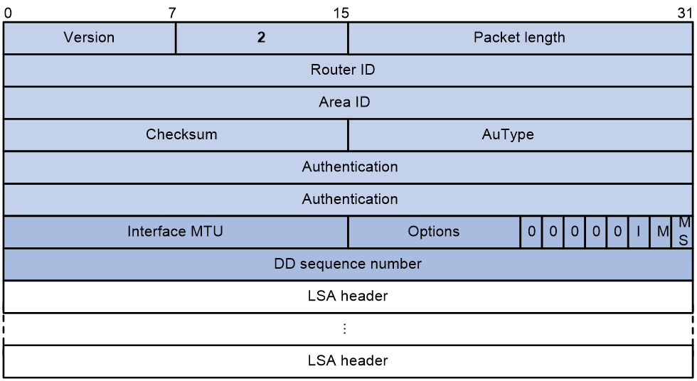

DD packet
The DD packet format is as shown in Figure 6.
Figure 6 DD packet format
Fields in a DD packet are as shown in Table 5.
Table 5 Fields in a DD packet
Field
Length
Description
Interface MTU
16-bit
Maximum length for IP packets that the interface can transmit without fragmentation.
Options
8-bit
Options in a Hello packet, including:
·     DC: On-demand link.
·     N/P: Processing method for Type-7 LSA.
·     MC: Whether IP multicast packets can be forwarded.
·     E: Whether AS-External LSA flooding is allowed. When the E flag is set to 1, it indicates AS-External LS flooding is allowed. When the E flag is set to 0, it indicates AS-External LS flooding is not allowed.
I
1-bit
Init bit. The value of 1 indicates that the transmitted packet is the first DD packet. If it is not the first DD packet, the value is set to 0.
M
1-bit
More bit. The value of 1 indicates that the transmitted packet is not the final DD packet. If it is the final DD packet, this field is set to 0.
MS
1-bit
Master/Slave bit. This field is set to 1 only in the DD packets transmitted by the master.
DD sequence number
32-bit
DD packet sequence number, used to sort DD packets. Both master and slave devices use the sequence number to ensure the reliability and integrity of DD packets during transmission.
LSA header
LSA header information in the DD packet.

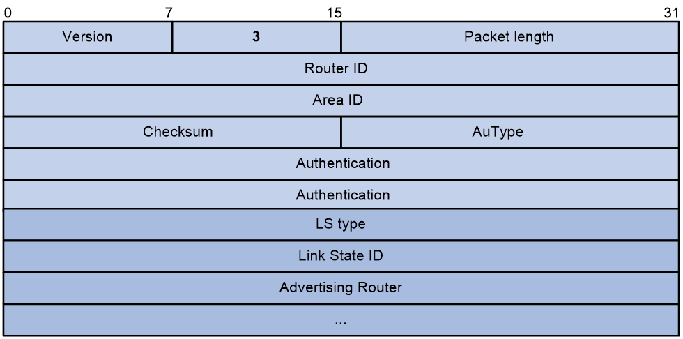

LSR packet
LSR packets request the necessary LSAs. The format of an LSR packet is as shown in Figure 7.
Figure 7 LSR packet format
Fields in an LSR packet are as shown in Table 6.
Table 6 Fields in an LSR packet
Field
Length
Description
LS type
32-bit
type of the LSA. An LSA is uniquely identified by the LS type, Link State ID, and Advertising Router.
When two LSAs have the same LS type, Link State ID, and Advertising Router, the device determines the recency of the LSAs based on the LS sequence number, LS checksum, and LS age.
Link State ID
32-bit
Link state ID.
Advertising Router
32-bit
Router ID of the device that generated this LSA.

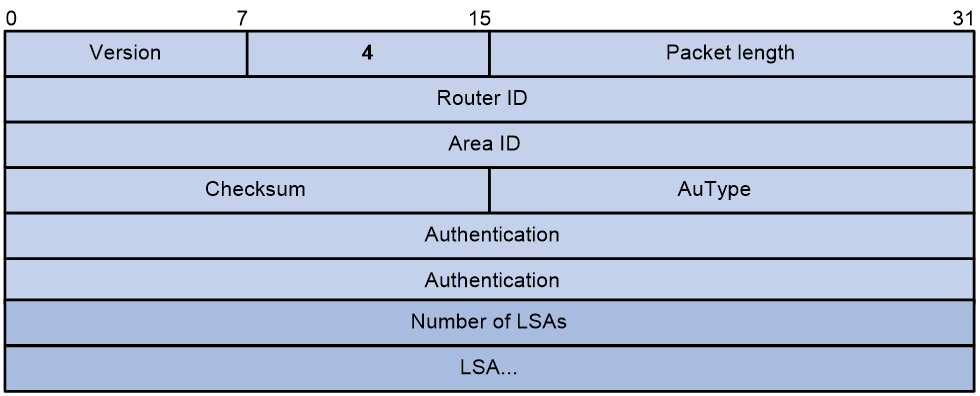

LSU packets transmit the required LSAs. The format of an LSU packet is as shown in Figure 8.
Figure 8 LSU packet format
Fields in an LSU packet are as shown in Table 7.
Table 7 Fields in an LSU packet
Field
Length
Description
Number of LSAs
32-bit
Number of LSAs in the LSU packet.

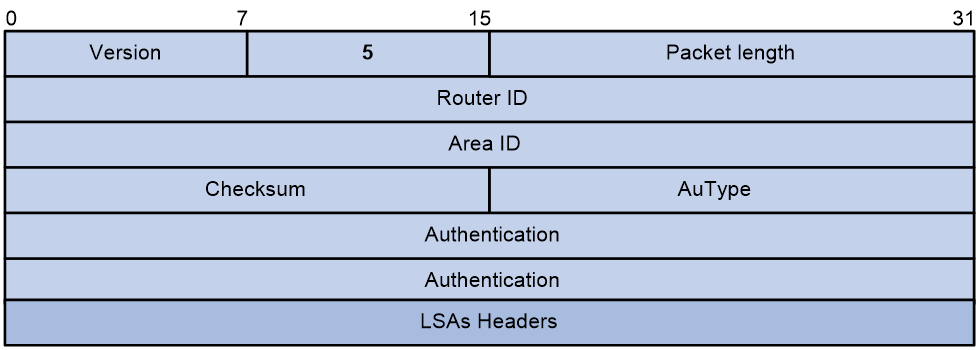

LSAck packet
LSAck packets validate the received LSAs. The format of an LSAck packet is as shown in Figure 9.
Figure 9 LSAck packet format
Fields in an LSAck packet are as shown in Table 8.
Table 8 Fields in an LSAck packet
Field
Length
Description
LSAs Headers
Vary by head length of the LSA that requires acknowledgement.
Header information of each acknowledged LSA.

Type-1, Type-2, Type-3, Type-5, Type-7 LSAs are flooded in different areas as shown in Figure 10 and Figure 10Table 9.
Figure 10 Type-1, 2, 3, 5, 7 LSAs flooded in different types of areas
Table 9 Type-1, 2, 3, 5, 7 LSAs flooded in different types of areas
Area type
Router LSA (Type-1)
Network LSA (Type-2)
Network Summary LSA (Type-3)
ASBR Summary LSA (Type-4)
AS External LSA (Type-5)
NSSA External LSA (Type-7)
Standard area and backbone area
Supported
Supported
Supported
Supported
Supported
Not supported
Stub area
Supported
Supported
Supported
Not supported
Not supported
Not supported
Totally stub area
Supported
Supported
Support for Type-3 (which announces only the default route) is not available.
Not supported
Not supported
Not supported
NSSA area
Supported
Supported
Supported
Not supported
Not supported
Supported
Totally NSSA area
Supported
Supported
The system does not support Type-3, which only announces the default route.
Not supported
Not supported
Supported

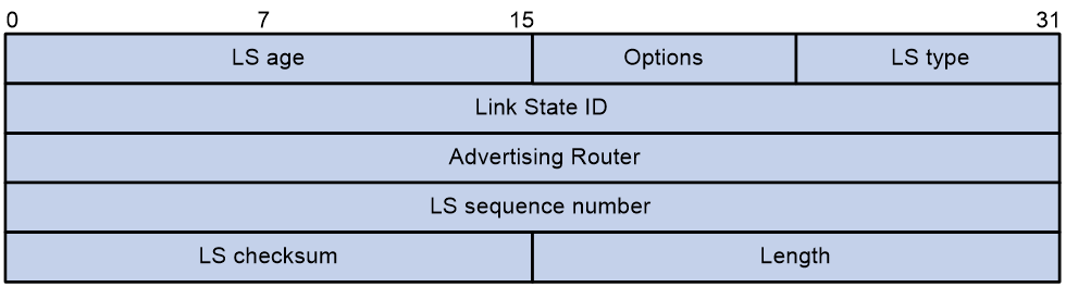

LSA header
All OSPF LSAs share the same packet header format, as shown in Figure 11.
Figure 11 LSA header format
Fields in an LSA header are as shown in Table 10.
Table 10 Fields in an LSA header
field
Length
Description
LS age
16-bit
After generation, the LSA's age, measured in seconds, continually increases during transmission over the link or while stored in the LSDB.
Options
8-bit
Options include:
·     DC—On-demand link
LS type
8-bit
LSA type. Options include:
·     1—Router LSA.
·     2—Network LSA.
·     3—Network Summary LSA.
·     4—ASBR Summary LSA.
·     5—AS External LSA.
·     7—NSSA LSA.
Link State ID
32-bit
Link state ID, which depends on the type of LSA. For example, in a Network LSA, the link state ID is the IP address of the DR interface.
Advertising Router
32-bit
LS sequence number
32-bit
Sequence number of the LSA, for other devices to determine the LSA's recency when they receive it.
LS checksum
16-bit
Checksum of the entire LSA content, excluding the LS age field.
Length
16-bit
Total length of the LSA, including the LSA header, in bytes.

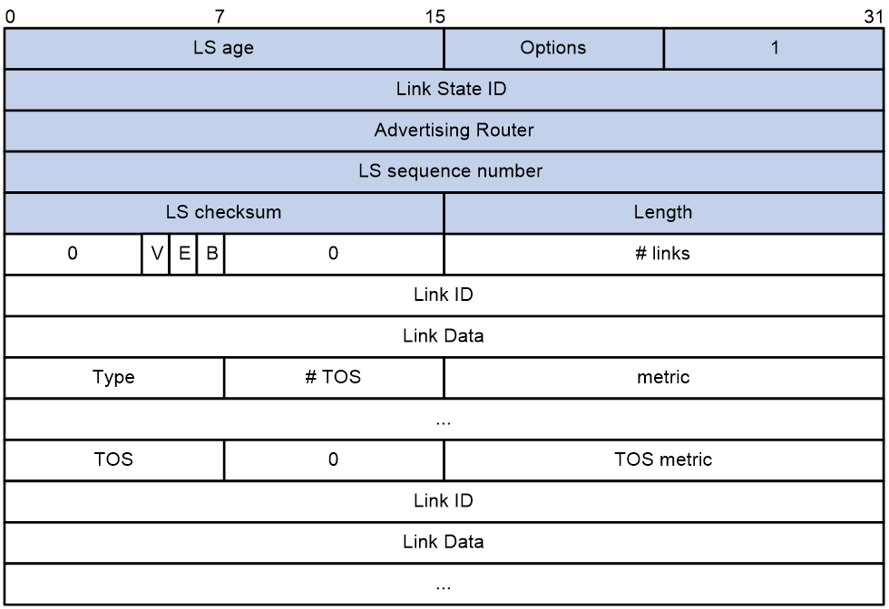

Router LSA
Each router generates Router LSAs, which describe the router's link state and cost, and advertise these LSAs within the originating area. The format of a Router LSA is as shown in Figure 12.
Figure 12 Router LSA format
Fields in a Router LSA are as shown in Table 11.
Table 11 Fields in a Router LSA
field
Length
Description
Link State ID
32-bit
Router ID of the device that generated the LSA.
V(V is for virtual link endpoint)
1-bit
·     1—Device generating the LSA is a virtual link endpoint.
·     0—Device generating the LSA is not a virtual link endpoint.
E(E is for external)
1-bit
·     1—Device generating the LSA is an ASBR.
·     0—Device generating the LSA is not an ASBR.
B(B is for border)
1-bit
·     1—Device generating the LSA is an ABR.
·     0—Device generating the LSA is not an ABR.
# links
16-bit
Number of links the LSA describes. These details must include the state information for all links (interfaces) on the device within a specific area.
Link ID
32-bit
Object to which the device connects. The link ID depends on the connection type. Options include:
·     1—Router ID.
·     2—IP address of the DR interface.
·     3—Network segment/subnet number.
·     4—Router ID of the peer in the virtual link.
Link Data
32-bit
Link data, which depends on the connection type. Options include:
·     Interface index.
·     Subnet mask.
·     Device interface IP address.
Type
8-bit
Description of the device connection status:
·     1—Connect to another device in a point-to-point manner.
·     2—Connect to the transmission network.
·     3—Connect to the Stub network.
·     4—Virtual link.
# TOS
8-bit
The number of ToS (Type of Service) metrics. OSPF can calculate routes separately for each ToS. To differentiate routes based on ToS, you can configure interface cost for each ToS separately.
metric
16-bit
Cost of the link.
TOS
8-bit
Type of service.
TOS metric
16-bit
Metric corresponding to the type of service.

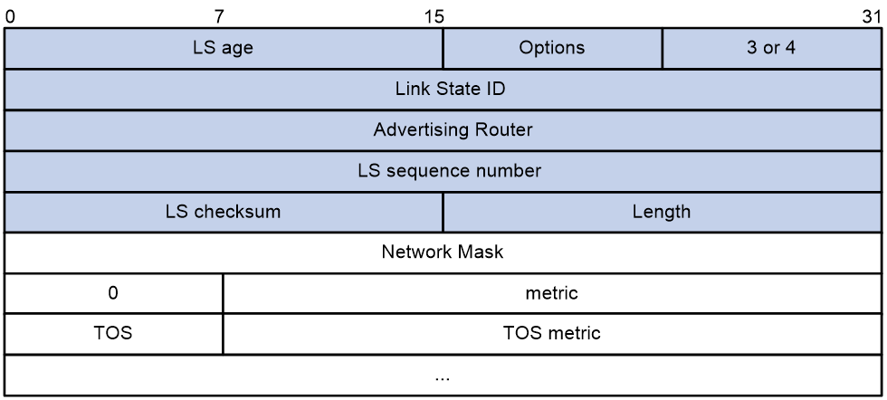

Summary LSA
Summary LSAs include Network Summary (Type-3) LSAs and ASBR Summary (Type-4) LSAs.
The ABR generates Network Summary LSAs to describe the routes for a network segment within a area and advertise it to other areas.
The ABR generates ASBR Summary LSAs to describe the routes to the ASBR and advertise it to the relevant areas.
Network Summary LSAs and ASBR Summary LSAs are in the same format, as shown in Figure 14.
Figure 14 Summary LSA format
Fields in a Summary LSA are as shown in Table 13.
Table 13 Fields in a Summary LSA
Field
Length
Description
Link State ID
32-bit
·     For a Type-3 LSA, the field is the IP address of the network or subnet announced in the LSA.
·     For a Type-4 LSA, the field is the ASBR's Router ID.
Network Mask
32-bit
·     For a Type-3 LSA, this field is the mask for the announced network or subnet.
·     For a Type-4 LSA, the field is meaningless and is fixed at 0.0.0.0.
Metric
24-bit
Cost of the path to the destination.
TOS
8-bit
Type of Service (ToS).
TOS metric
24-bit
AS External LSA
The ASBR generates AS External (Type-5) LSAs to describe routes to other ASs, and advertise them to all areas except stub and NSSA areas. The format of an AS External LSA is as shown in Figure 15.
Figure 15 AS External LSA format
Fields in an AS External are as shown in Table 14.

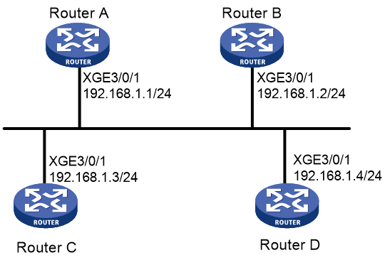

OSPF network types
OSPF classifies networks into the following types, depending on different link layer protocols:
·     Broadcast—If the link layer protocol is Ethernet or FDDI, OSPF considers the network type as broadcast by default. On a broadcast network, hello, LSU, and LSAck packets are multicast to 224.0.0.5 that identifies all OSPF routers or to 224.0.0.6 that identifies the DR and BDR. DD packets and LSR packets are unicast.
Figure 16 Broadcast network

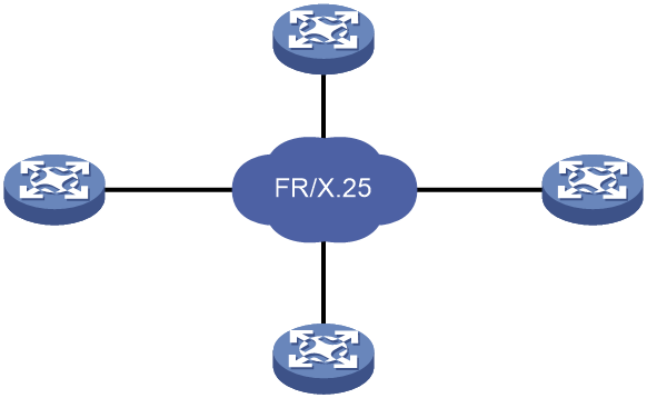

·     NBMA—If the link layer protocol is ATM, or X.25, OSPF considers the network type as NBMA by default. OSPF packets are unicast on an NBMA network.
Figure 17 NBMA network.
·     P2MP—No link is P2MP type by default. P2MP must be a conversion from other network types such as NBMA. On a P2MP network, OSPF packets are multicast to 224.0.0.5.
Figure 18 P2MP network
·     P2P—If the link layer protocol is PPP or HDLC, OSPF considers the network type as P2P. On a P2P network, DD packets are unicast and other OSPF packets are multicast to 224.0.0.5 by default.
Figure 19 P2P network
The following are the differences between NBMA and P2MP networks:
·     NBMA networks are fully meshed. P2MP networks are not required to be fully meshed.
·     NBMA networks require DR and BDR election. P2MP networks do not have DR or BDR.
·     On an NBMA network, OSPF packets are unicast, and neighbors are manually configured. On a P2MP network, OSPF packets are multicast by default, and you can configure OSPF to unicast protocol packets.

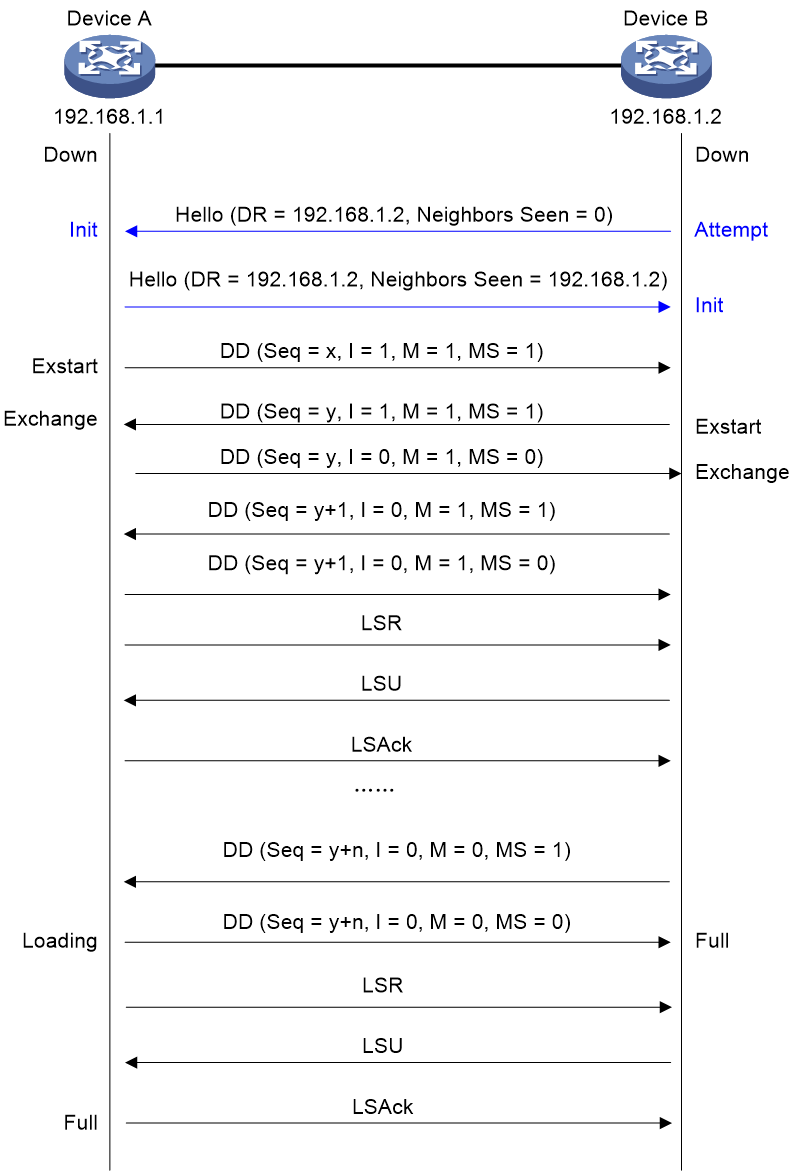

Establish OSPF adjacency in an NBMA network
The process of establishing OSPF adjacency between devices in an NBMA network is as shown. The only difference from establishing adjacency in a broadcast network is the step before switching DD packets.
Figure 24 Establishing OSPF adjacency in an NBMA network
In a broadcast network, the process for establishing OSPF adjacency between devices is as follows:
5.     Establish a neighbor relationship
a.     After Device B transmits a hello packet to an OSPF protocol interface on Device A with a status of Down, Device B changes the neighbor state to Attempt. At this point, Device B considers itself the DR (DR=192.68.1.2) but is unsure which device is the neighbor (Neighbors=0).
b.     After receiving a hello packet, Device A changes the neighbor state of Device B to Init. Then, Device A replies with a hello packet. At this point, Device A accepts Device B as the Designated Router (DR=192.68.1.2) and enters its Router ID (Neighbors Seen=192.68.1.2) in the "Neighbors Seen" field.
In an NBMA network, devices with OSPF interface state set to DR Other do not perform the following steps.

Table 17 shows the principles for advertising the default routes in different types of areas.
Table 17 Principles for advertising the default routes in different types of areas
Area type
Principle for advertising a default route
Under the default conditions, OSPF devices within a standard OSPF area do not generate a default route, even if one exists on the device.
When an ASBR device has a default route generated by other protocols, it must announce this default route throughout the entire OSPF routing domain. To accomplish this, configure the 'default-route-advertise' command on the ASBR device. Once configured, the device will release the default route via Type-5 LSA.
A default route is released via Type-5 LSA on an ASBR device only if there is an existing default route generated by another protocol.
Stub area
Stub areas do not allow the propagation of external routes (Type-5 LSA) from outside the autonomous system within the area.
Devices within a Stub area must learn routes external to the autonomous system (AS) through the Area Border Router (ABR). This is achieved by the ABR automatically announcing a default route to the entire Stub area using Type-3 Link State Advertisements (LSAs). Consequently, devices in the Stub area can reach outside the autonomous system (AS) via the ABR.
Totally stub area
A Totally Stub area does not permit the propagation of external routes from outside the autonomous system (Type-5 LSA) within the area, nor does it allow inter-area routing other than the announce of a default route (Type-3 LSA) to propagate within the area.
Devices within a Totally Stub area must learn external routes and routes from other areas via the ABR. To implement this, configure the area as a Totally Stub area, and the ABR will automatically announce a default route to the entire Totally Stub area using Type-3 LSA. This enables devices within the Totally Stub area to reach other areas and the external autonomous system through the ABR.
NSSA area
Not-so-stubby areas (NSSA) allow devices to introduce external routes without permitting the propagation of external routes (Type-5 LSA) from other areas within the area. If a neighbor in the backbone area is in FULL state and an interface is Up, the ABR will automatically announce a default route to the entire NSSA via Type-7 LSA. Consequently, devices can reach other areas through the ABR.
After configuring the command nssa default-route-advertise on the ASBR device, it will announce the default route to the entire NSSA area using Type-7 LSA. Consequently, devices within the NSSA area can generate external routes with the ASBR as the next hop.
An ABR will not translate a Type-7 LSA default route into a Type-5 LSA default route and flood it throughout the entire OSPF area.
Totally NSSA area
A Totally not-so-stubby area (NSSA) neither allows the propagation of external routes (Type-5 LSA) within the area nor permits inter-area routing, except for the announce of the default route (Type-3 LSA).
Devices within a Totally NSSA area must learn routes to other areas via the ABR. This is achieved by configuring the area as a Totally NSSA, after which the ABR automatically propagates the default route throughout the Totally NSSA area using Type-3 LSA and Type-7 LSA. Consequently, both external routes from outside the autonomous system and inter-area routing can be propagated within the area through the ABR.

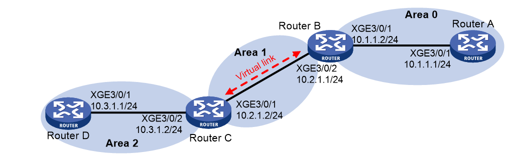

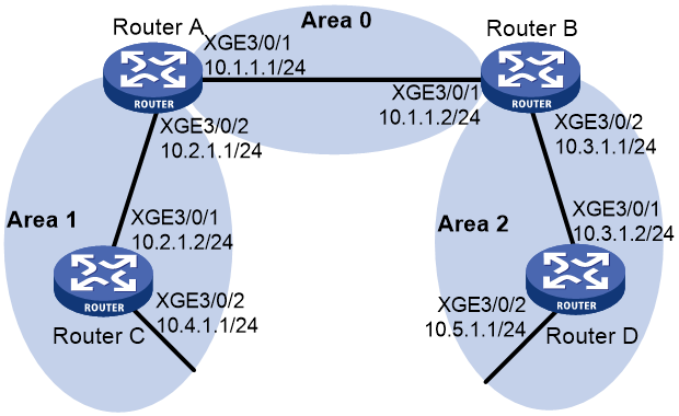

Virtual links
A virtual link is established between two ABRs through a non-backbone area. It must be configured on both ABRs to take effect. The non-backbone area is called a transit area.
As shown in Figure 27, Area 2 has no direct physical link to the backbone Area 0. You can configure a virtual link between the two ABRs to connect Area 2 to the backbone area.
Figure 27 Virtual link application 1
Virtual links can also be used as redundant links. If a physical link failure breaks the internal connectivity of the backbone area, you can configure a virtual link to replace the failed physical link, as shown in Figure 28.
Figure 28 Virtual link application 2
The virtual link between the two ABRs acts as a point-to-point connection. You can configure interface parameters, such as hello interval, on the virtual link as they are configured on a physical interface.
The two ABRs on the virtual link unicast OSPF packets to each other, and the OSPF routers in between convey these OSPF packets as normal IP packets.

Operating mechanism
As shown in Figure 29, the OSPF AS contains Area 1, Area 2, and Area 0. The other two ASs run RIP. Area 1 is an NSSA area where the ASBR redistributes RIP routes in Type-7 LSAs into Area 1. Upon receiving the Type-7 LSAs, the NSSA ABR translates them to Type-5 LSAs, and advertises the Type-5 LSAs to Area 0.

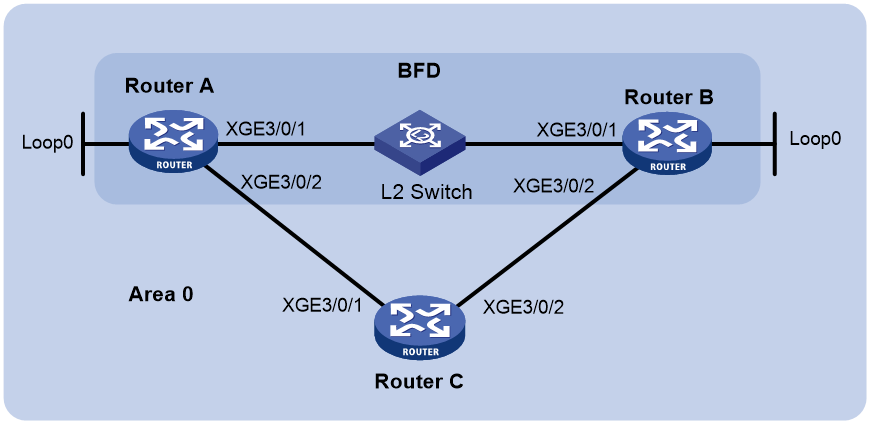

BFD for OSPF
OSPF periodically sends hello packets to neighbors to detect their states. If OSPF does not receive a hello packet from a neighbor within a specific period, OSPF considers the neighbor unavailable. Such a failure detection mechanism cannot achieve high data reliability, because it takes a long time and causes data loss.
Bidirectional Forwarding Detection (BFD) can quickly detects link faults and informs OSPF, thus enhancing the convergence speed of OSPF when link state changes. The convergence speed comparison of OSPF with and without BFD colleboration is shown in Table 18.
Table 18 Convergence speed with or without BFD for OSPF
BFD enabled for OSPF
Link fault detection mechanism
Convergence speed
Yes
The OSPF dead timer expires.
Seconds
No
The BFD session state changes to Down.
Milliseconds
As shown in Figure 30, Device A, Device B, and Device C are OSPF neighbors. When a fault occurs on the link used by Device A and Device B to communicate through the L2 Switch, BFD quickly detects it and announces to OSPF, then performs a switchover to the path through Device C. The specific process is as follows:
2.     When the OSPF neighbor state between Device A and Device B changes to Full, OSPF notifies BFD to establish a session.
3.     When a link fault occurs on the link for communication between Device A and Device B via an L2 Switch, BFD detects the fault first, sets the session state to Down, and then notifies Device A.
4.     After receiving a BFD notification, Device A recalculates the route. The new outgoing interface is Interface A2, which passes through Device C to reach Device B.
Figure 30 OSPF and BFD colleboration

OSPF multi-area adjacency
According to OSPF protocols, intra-area paths have higher priority than inter-area paths. Assume an area contains a high-speed link. Devices in other areas cannot use it for data transmission, because the interface belongs to only one area. To address this issue, you can configure multiple subinterfaces and enable them in different areas. However, this method requires assigning a unique IP address to each subinterface, which increases the total number of routes released by the device.
OSPF multi-area adjacency can enable an OSPF interface into multiple areas, allowing a single path to be shared among multiple areas.
Multi-area adjacency interfaces
You can use the network command or the ospf area command to enable an OSPF interface as the primary interface. Then, use the ospf multi-area command to add more areas to the primary interface. The additional OSPF logical interfaces are multi-area adjacency interfaces.
Multi-area adjacency provides the following features:
·     Multi-area adjacency interfaces and the primary interface belong to different OSPF areas.
·     The network type for multi-area adjacency interfaces must be P2P, and they run independent OSPF interface state machines and OSPF neighbor state machines.
·     Multi-area adjacency interfaces and the primary interface have the same interface type and number, sharing the same packet transmission channel. You can identify whether a packet is sent from a multi-area adjacency interface based on the area ID in the OSPF packet header and the configuration.
Operating mechanism
As shown in Figure 31, only the link between Device A and Device B in Area 1 is a high-speed link. Before the OSPF multi-area adjacency feature is enabled, the traffic forwarding path from Device A to Device B in Area 2 is Device A -> Device C -> Device D -> Device B. To use the traffic forwarding path Device A -> Device B, enable the OSPF multi-area adjacency feature.
Figure 31 OSPF multi-area adjacency disabled
As shown in Figure 32, create multi-area adjacency interfaces on primary interfaces Interface A and Interface B on Device A and Device B, respectively. The multi-area adjacency interfaces belong to Area 2. Then, establish neighbor relationship between the multi-area adjacency interfaces on Device A and Device B. When Device A calculates routes to Device B, it finds that the link cost between the multi-area adjacency interfaces in Area 2 is the lowest. Therefore, the traffic forwarding path from Device A to Device B in Area 2 is determined as Device A -> Device B, achieving the goal of sharing a path across multiple areas.
Figure 32 OSPF multi-area adjacency enabled

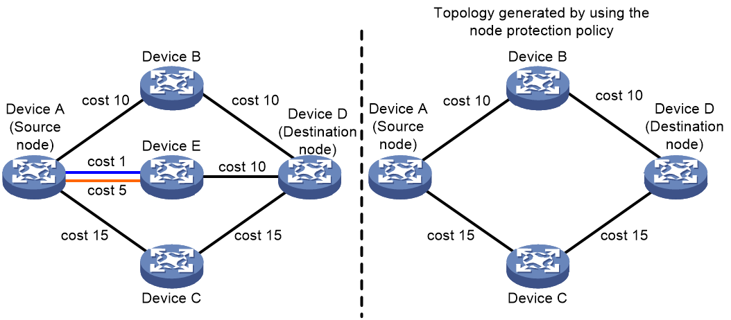

As shown in Figure 33, the traffic forwarding path is PE 1—P 1—P 2—PE 2. To avoid traffic loss caused by link failures between P 1 and P 2, the system establishes an LDP tunnel between P 1 and P 4, which is the PQ node. When the link between P 1 and P 2 fails, P 1 encapsulates IP packets in MPLS packets and sends the MPLS packets to P 4 through the LDP tunnel. After receiving the MPLS packets, P 4 removes the MPLS labels of the packets and then forwards the packets to the next hop based on the IP routing table.
The system determines P 4 as the PQ node as follows:
1.     Uses P 1 (source node of the protected link) and its neighbors except P 2 (which passes the protected link) as the roots to establish shortest path trees.
2.     Finds out all nodes that are reachable from P 1 or one of its neighbors without passing the protected link, which are PE 1, P 1, P 3, and P 4.
These nodes form the extended P space.
3.     Uses P 2 (destination node of the protected link) as the root to establish a reverse shortest path tree.
4.     Finds out all nodes that are reachable from P 2 without passing the protected link, which are PE 2 and P 4.
These nodes form the Q space.
5.     Finds out all nodes that reside in both the extended P space and the Q space.
Only P 4 resides in both the extended P space and the Q space, so P 4 is the PQ node of the protected link.

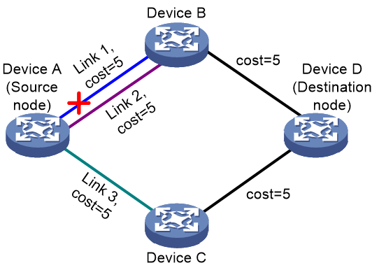

·     Node protection and SRLG disjoint policies.
As shown in Figure 36, Device A uses the node protection and SRLG disjoint policies and selects path Device A->Device B->Device D as the backup path.

You can configure a non-backbone area at an AS edge as a stub area. To do so, execute the stub command on all routers attached to the area. The routing table size is reduced because Type-5 LSAs will not be flooded within the stub area. The ABR generates a default route into the stub area so all packets destined outside of the AS are sent through the default route.
To further reduce the routing table size and routing information exchanged in the stub area, configure a totally stub area by using the stub no-summary command on the ABR. AS external routes and inter-area routes will not be distributed into the area. All the packets destined for outside of the AS or area will be sent to the ABR for forwarding.
A stub or totally stub area cannot have an ASBR because external routes cannot be distributed into the area.
Do not configure the backbone area as a stub area or totally stub area.
To configure an area as a stub area, execute the stub command on all routers attached to the area.
To configure an area as a totally stub area, execute the stub command on all routers attached to the area, and execute the stub no-summary command on the ABR.

Configuring an NSSA area
A stub area cannot import external routes, but an NSSA area can import external routes into the OSPF routing domain while retaining other stub area characteristics.
To configure an area as a totally NSSA area, use the nssa no-summary command. The ABR of the area does not advertise inter-area routes into the area.
Do not configure the backbone area as an NSSA area or totally NSSA area.
To configure an NSSA area, configure the nssa command on all the routers attached to the area.
To configure a totally NSSA area, configure the nssa command on all the routers attached to the area and configure the nssa no-summary command on the ABR.
Procedure (OSPF area view)
2.     Enter OSPF view.
ospf [ process-id | router-id { auto-select | router-id } | vpn-instance vpn-instance-name ] *
3.     Enter area view.
area area-id
4.     Configure the area as an NSSA area.
nssa [ default-route-advertise [ cost cost-value | nssa-only | route-policy route-policy-name | type type ] * | no-import-route | no-summary | suppress-fa | [ [ [ translate-always ] [ translate-ignore-checking-backbone ] ] | translate-never ] | translator-stability-interval value ] *
By default, no area is configured as an NSSA area.
5.     (Optional.) Set a cost for the default route advertised to the NSSA area.
default-cost cost-value
By default, the cost is 1 for the default route advertised to the NSSA area.
This command takes effect only on the ABR/ASBR on an NSSA area or totally NSSA area.
Configuring a virtual link
You can configure a virtual link to maintain connectivity between a non-backbone area and the backbone, or in the backbone itself.
A virtual link cannot traverse a stub area, totally stub area, NSSA area, or totally NSSA area.
2.     Enter OSPF view.
3.     Enter OSPF area view.
area area-id
4.     Configure a virtual link.
vlink-peer router-id [ dead seconds | hello seconds | { { hmac-md5 | hmac-sha-256 | md5 } key-id { cipher | plain } string | keychain keychain-name | simple { cipher | plain } string } | retransmit seconds | trans-delay seconds ] *
Configure this command on both ends of a virtual link. The hello and dead intervals must be identical on both ends of the virtual link.
This command is available only in OSPF area view.

Setting an OSPF cost for an interface
Set an OSPF cost for an interface by using either of the following methods:
·     Set the cost value in interface view.
·     Set a bandwidth reference value for the interface. OSPF computes the cost with this formula: Interface OSPF cost = Bandwidth reference value (100 Mbps) / Expected interface bandwidth (Mbps). The expected bandwidth of an interface is configured with the bandwidth command (see Interface Command Reference).
¡     If the calculated cost is greater than 65535, the value of 65535 is used. If the calculated cost is less than 1, the value of 1 is used.
¡     If no cost or bandwidth reference value is configured for an interface, OSPF computes the interface cost based on the interface bandwidth and default bandwidth reference value.
2.     Enter interface view.
3.     Set an OSPF cost for the interface.
ospf cost cost-value
By default, the OSPF cost is calculated according to the interface bandwidth. For a loopback interface, the OSPF cost is 0 by default.
Setting a bandwidth reference value
2.     Enter OSPF view.
ospf [ process-id | router-id { auto-select | router-id } | vpn-instance instance-name ] *
3.     Set a bandwidth reference value.
bandwidth-reference value
The default setting is 100 Mbps.
Changing the link cost of a Layer 3 aggregate interface when its bandwidth falls below the threshold
When a member port of a Layer 3 aggregate interface goes down, the bandwidth of the aggregate interface decreases and services might be interrupted. To resolve this issue, perform this task to change the link cost of a Layer 3 aggregate interface as follows:
·     When the bandwidth of the Layer 3 aggregate interface falls below the specified threshold, the aggregate interface uses the specified link cost. Make sure the link cost you specified is larger than the original link cost, so that OSPF can select an optimal path for traffic forwarding.
·     When the bandwidth of the Layer 3 aggregate interface is equal to or larger than the bandwidth threshold, the aggregate interface uses the original link cost.
For more information about OSPF link cost, see "Setting an OSPF cost for an interface."
This feature applies to only Layer 3 aggregate interfaces and Layer 3 aggregate subinterfaces.
3.     Change the link cost of the interface to the specified value when the bandwidth of the interface falls below the specified threshold.
ospf cost-fallback cost-value threshold bandwidth-value [ instance instance-id ]
By default, an aggregate interface uses the original link cost.

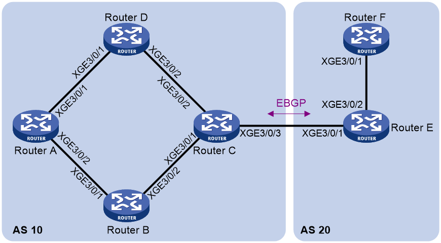

A stub router is used for traffic control. It reports its status as a stub router to neighboring OSPF routers. The neighboring routers can have a route to the stub router, but they do not use the stub router to forward data.
Router LSAs from the stub router might contain different link type values. A value of 3 means a link to a stub network, and the cost of the link will not be changed by default. To set the cost of the link to 65535, specify the include-stub keyword in the stub-router command. A value of 1, 2 or 4 means a point-to-point link, a link to a transit network, or a virtual link. On such links, a maximum cost value of 65535 is used. Neighbors do not send packets to the stub router as long as they have a route with a smaller cost.
As shown in Figure 38, Device A, Device B, Device C, and Device D run OSPF. Device C is the backup device for Device B. Device A and Device B, Device A and Device C, Device B and Device D, and Device C and Device D are IBGP peers.
When the network is stable, BGP and OSPF can finish route convergence completely. Device A forwards traffic destined for 10.3.1.0/30 to Device B. If Device B fails, Device C will take over to forward the traffic from Device A.
After Device B recovers, Device A immediately forwards the traffic Device B. However, BGP might have not finished route convergence when OSPF has finished route convergence, because OSPF has a higher route convergence speed than BGP. In this situation, Device B does not have a route to 10.3.1.0/30 and will discard the traffic destined for 10.3.1.0/30. To resolve this issue, configure Device B to act as a stub router during BGP route convergence. Device A will forward traffic to Device C instead of Device B until Device B finishes BGP route convergence.
Figure 38 Network diagram

Configuring BFD for OSPF
About BFD for OSPF
OSPF sends hello packets to neighbors at specific intervals to detect their state. If OSPF does not receive a hello packet from a neighbor within a specific period, OSPF considers the neighbor stale. Such a failure detection method cannot achieve high data reliability, because it takes a long time and causes data loss.
To resolve this issue, configure Bidirectional Forwarding Detection (BFD) for OSPF. This feature improves the route convergence speed against link state changes through fast link state detection. For more information about BFD, see High Availability Configuration Guide.
OSPF supports the following BFD detection modes:
·     Bidirectional control detection—Requires BFD configuration to be made on both OSPF routers on the link.
·     Single-hop echo detection—Requires BFD configuration to be made on one OSPF router on the link.
Configuring bidirectional control detection
3.     Enable BFD bidirectional control detection.
ospf bfd enable
By default, BFD bidirectional control detection is disabled.
Both ends of a BFD session must be on the same network segment and in the same area.
Configuring single-hop echo detection
2.     (Optional.) Configure the source address of echo packets.
bfd echo-source-ip ip-address
By default, the source address of echo packets is not configured.
As a best practice to avoid network congestion caused by massive ICMP redirect packets from the remote end, execute this command and specify a source IP address that is not on the same network segment as any local interface's IP address.
For more information about this command, see BFD commands in High Availability Command Reference.
3.     Enter interface view.
4.     Enable BFD single-hop echo detection.
ospf bfd enable echo
By default, BFD single-hop echo detection is disabled.

A link or router failure on a path can cause packet loss until OSPF completes routing convergence based on the new network topology. FRR enables fast rerouting to minimize the impact of link or node failures.
Figure 39 Network diagram for OSPF FRR
As shown in Figure 39, configure OSPF FRR on Router B to calculate a backup next hop by using the LFA algorithm. When the primary link fails, OSPF directs packets to the backup next hop. At the same time, OSPF calculates the shortest path based on the new network topology. It forwards packets over the path after network convergence.
OSPF ECMP FRR
In ECMP scenarios, you can configure OSPF to calculate a backup next hop separately for each ECMP route with the LFA algorithm. ECMP routes might not share the same backup next hop.
As shown in Figure 40, the source node Device A forwards traffic to the destination node Device D. Traffic is load balanced among Link 1, Link 2, and Link 3.
·     With ECMP FRR disabled, OSPF does not calculate a backup next hop separately for Link 1, Link 2, and Link 3. When Link 1 fails, traffic previously forwarded through Link 1 is randomly switched to Link 2 or Link 3. This does not facilitate service traffic management.
·     With ECMP FRR enabled, OSPF calculates a backup next hop separately for Link 1, Link 2, and Link 3. For example, if the backup next hop for Link 1 is Device C, when Link 1 fails, traffic previously forwarded through Link 1 is switched to backup next hop Device C. This facilitates service traffic management.
Figure 40 OSPF ECMP FRR

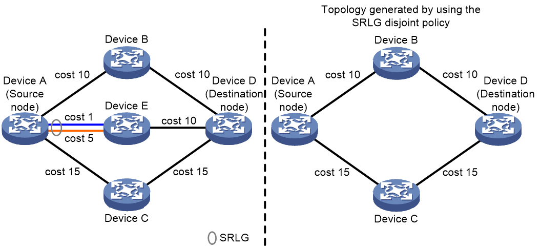

OSPF ECMP-shared FRR
In ECMP scenarios, you can configure OSPF to calculate a backup next hop for ECMP routes with the LFA algorithm. ECMP routes share the same backup next hop.
As shown in Figure 41, the source node Device A forwards traffic to the destination node Device D. Traffic is load balanced between Link 1 and Link 2. ECMP-shared FRR operates as follows:
·     With ECMP-shared FRR disabled, OSPF does not calculate any backup next hop for Link 1 or Link 2. When Device B fails, Link 1 and Link 2 both fail, causing traffic disruption before routing convergence.
·     With ECMP-shared FRR enabled, OSPF calculates a backup next hop for Link 1 and Link 2. If Device B fails, traffic is switched to the backup next hop Device C, preventing traffic disruption.

Configuring OSPF remote LFA FRR
In a network topology where OSPF LFA FRR cannot calculate the backup path, configure remote LFA FRR to ensure network reliability.
Remote LFA uses the following concepts:
·     P space—Use the source node of the protected link as the root to establish a shortest path tree. All nodes that are reachable from the source node without passing the protected link form the P space. Nodes in the P space are called P nodes.
·     Extended P space—Use the source node of the protected link and its neighbors as the roots to establish shortest path trees. All nodes that are reachable from the source node or one of its neighbors without passing the protected link form the extended P space. The P space is a subset of the extended P space.
·     Q space—Use the destination node of the protected link as the root to establish a reverse shortest path tree. All nodes that are reachable from the root node without passing the protected link form the Q space. Nodes in the Q space are called Q nodes.
·     PQ node—A PQ node refers to a node that resides in both the extended P space and the Q space. Remote LFA uses a PQ node as the destination node of a protected link.
As shown in Figure 42, the traffic forwarding path is PE 1—P 1—P 2—PE 2. To avoid traffic loss caused by link failures between P 1 and P 2, the system establishes an LDP tunnel between P 1 and P 4, which is the PQ node. When the link between P 1 and P 2 fails, P 1 encapsulates IP packets in MPLS packets and sends the MPLS packets to P 4 through the LDP tunnel. After receiving the MPLS packets, P 4 removes the MPLS labels of the packets and then forwards the packets to the next hop based on the IP routing table.
Figure 42 Network diagram for OSPF remote LFA FRR

·     Node protection policy.
As shown in Figure 43, Device A uses the node protection policy and selects path Device A->Device B->Device D as the backup path.
Figure 43 Node protection backup path selection
·     Lowest cost policy.
As shown in Figure 44, Device A uses the lowest cost policy and selects path Device A->Device E->Device D as the backup path.
Figure 44 Lowest cost backup path selection
As shown in Figure 45, Device A uses the node protection and SRLG disjoint policies and selects path Device A->Device B->Device D as the backup path.
Figure 45 SRLG disjoint backup path selection

According to OSPF protocols, intra-area paths have higher priority than inter-area paths. Assume an area contains a high-speed link. Devices in other areas cannot use it for data transmission, because the interface belongs to only one area. To address this issue, perform this task.

OSPF configuration examples
Example: Configuring basic OSPF
As shown in Figure 46:
·     Enable OSPF on all routers, and split the AS into three areas.
·     Configure Router A and Router B as ABRs.
Figure 46 Network diagram
1.     Configure IP addresses for interfaces. (Details not shown.)
2.     Enable OSPF:
# Configure Router A.
<RouterA> system-view
[RouterA] router id 10.2.1.1
[RouterA] ospf
[RouterA-ospf-1] area 0
[RouterA-ospf-1-area-0.0.0.0] network 10.1.1.0 0.0.0.255
[RouterA-ospf-1-area-0.0.0.0] quit
[RouterA-ospf-1] area 1
[RouterA-ospf-1-area-0.0.0.1] network 10.2.1.0 0.0.0.255
[RouterA-ospf-1-area-0.0.0.1] quit
[RouterA-ospf-1] quit
# Configure Router B.
<RouterB> system-view
[RouterB] router id 10.3.1.1
[RouterB] ospf
[RouterB-ospf-1] area 0
[RouterB-ospf-1-area-0.0.0.0] network 10.1.1.0 0.0.0.255
[RouterB-ospf-1-area-0.0.0.0] quit
[RouterB-ospf-1] area 2
[RouterB-ospf-1-area-0.0.0.2] network 10.3.1.0 0.0.0.255
[RouterB-ospf-1-area-0.0.0.2] quit
[RouterB-ospf-1] quit
# Configure Router C.
<RouterC> system-view
[RouterC] router id 10.4.1.1
[RouterC] ospf
[RouterC-ospf-1] area 1
[RouterC-ospf-1-area-0.0.0.1] network 10.2.1.0 0.0.0.255
[RouterC-ospf-1-area-0.0.0.1] network 10.4.1.0 0.0.0.255

Example: Configuring OSPF NSSA area
As shown in Figure 50:
·     Configure OSPF on all routers and split AS into three areas.
·     Configure Router A and Router B as ABRs to forward routing information between areas.
·     Configure Area 1 as an NSSA area and configure Router C as an ASBR to redistribute static routes into the AS.
Figure 50 Network diagram
2.     Enable OSPF (see "Example: Configuring basic OSPF").
3.     Configure Area 1 as an NSSA area:

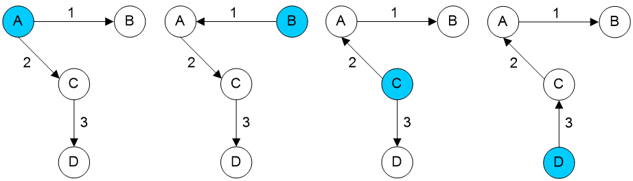

Example: Configuring OSPF DR election
As shown in Figure 51:
·     Enable OSPF on Routers A, B, C, and D on the same network.
·     Configure Router D as the DR, and configure Router C as the BDR.
·     Change the router priorities on the interfaces to configure Router A as the DR and Router C as the BDR.
Figure 51 Network diagram
2.     Configure basic OSPF settings on all routers. (Details not shown.)
For more information, see "Example: Configuring basic OSPF."
3.     Display neighbor information on Router A.
[RouterA] display ospf peer verbose
 (M) Indicates MADJ neighbor
          OSPF Process 1 with Router ID 1.1.1.1
                  Neighbors
 Area 0.0.0.0 interface 192.168.1.1(Ten-GigabitEthernet3/0/1)'s neighbors
 Router ID: 2.2.2.2          Address: 192.168.1.2      GR State: Normal
   State: 2-Way  Mode: None  Priority: 1
   DR: 192.168.1.4  BDR: 192.168.1.3  MTU: 0
   Options is 0x02 (-|-|-|-|-|-|E|-)
   Dead timer due in 38  sec
   Neighbor is up for 00:01:31
   Authentication Sequence: [ 0 ]
   Neighbor state change count: 6
   BFD status: Disabled
 Router ID: 3.3.3.3          Address: 192.168.1.3      GR State: Normal
   State: Full  Mode: Nbr is master  Priority: 1
   Dead timer due in 31  sec
   Neighbor is up for 00:01:28
 Router ID: 4.4.4.4          Address: 192.168.1.4      GR State: Normal
The output shows that Router D is the DR and Router C is the BDR.
4.     Configure router priorities on interfaces:
[RouterA] interface ten-gigabitethernet 3/0/1
[RouterA-Ten-GigabitEthernet3/0/1] ospf dr-priority 100
[RouterA-Ten-GigabitEthernet3/0/1] quit
[RouterA] quit
[RouterB] interface ten-gigabitethernet 3/0/1
[RouterB-Ten-GigabitEthernet3/0/1] ospf dr-priority 0
[RouterB-Ten-GigabitEthernet3/0/1] quit
[RouterB] quit
[RouterC] interface ten-gigabitethernet 3/0/1
[RouterC-Ten-GigabitEthernet3/0/1] ospf dr-priority 2
[RouterC-Ten-GigabitEthernet3/0/1] quit
[RouterC] quit
# Display information about neighbors of Router D.
<RouterD> display ospf peer verbose
          OSPF Process 1 with Router ID 4.4.4.4
                  Neighbors
 Area 0.0.0.0 interface 192.168.1.4(Ten-GigabitEthernet3/0/1)'s neighbors
 Router ID: 1.1.1.1      Address: 192.168.1.1      GR State: Normal
   State: Full  Mode:Nbr is  slave  Priority: 100
   Neighbor is up for 00:11:17
   State: Full  Mode:Nbr is  slave  Priority: 0
   Dead timer due in 35  sec
   Neighbor is up for 00:11:19
   State: Full  Mode:Nbr is  slave  Priority: 2
   Dead timer due in 33  sec
   Neighbor is up for 00:11:15
The output shows that the DR and BDR are not changed, because the new router priority settings do not take effect immediately.
5.     Restart OSPF processes:
# Restart the OSPF process on Router A.
<RouterA> reset ospf 1 process
Warning : Reset OSPF process? [Y/N]:y
# Restart the OSPF process on Router B.
<RouterB> reset ospf 1 process
# Restart the OSPF process on Router C.
<RouterC> reset ospf 1 process
# Restart the OSPF process on Router D.
<RouterD> reset ospf 1 process
# Display neighbor information on Router D.
                  Neighbors
   State: Full  Mode: Nbr is slave  Priority: 100
   DR: 192.168.1.1  BDR: 192.168.1.3  MTU: 0
   Dead timer due in 39  sec
   Neighbor is up for 00:01:40
   State: 2-Way  Mode: None  Priority: 0
   Neighbor is up for 00:01:44
   State: Full  Mode: Nbr is slave  Priority: 2
   Neighbor is up for 00:01:41
The output shows that Router A becomes the DR and Router C becomes the BDR.
The full neighbor state means an adjacency has been established. The 2-way neighbor state means the two routers are not the DR or BDR, and they do not exchange LSAs.
# Display OSPF interface information.
<RouterA> display ospf interface
 (M) Indicates MADJ interface
                  Interfaces
 Area: 0.0.0.0
 IP Address      Type      State   Cost  Pri   DR             BDR
 192.168.1.1     Broadcast DR      1     100   192.168.1.1    192.168.1.3
<RouterB> display ospf interface
          OSPF Process 1 with Router ID 2.2.2.2
                  Interfaces
 Area: 0.0.0.0
 192.168.1.2     Broadcast DROther  1     0     192.168.1.1    192.168.1.3
The interface state DROther means the interface is not the DR or BDR.
Example: Configuring OSPF virtual link
As shown in Figure 52, configure a virtual link between Router B and Router C to connect Area 2 to the backbone area. After configuration, Router B can learn routes to Area 2.
Figure 52 Network diagram
2.     Enable OSPF:
[RouterA] ospf 1 router-id 1.1.1.1
[RouterB] ospf 1 router-id 2.2.2.2
[RouterB-ospf-1] area 1
[RouterB–ospf-1-area-0.0.0.1] network 10.2.1.0 0.0.0.255
[RouterB–ospf-1-area-0.0.0.1] quit
[RouterC] ospf 1 router-id 3.3.3.3
[RouterC-ospf-1-area-0.0.0.1] quit
[RouterC-ospf-1] area 2
[RouterC–ospf-1-area-0.0.0.2] network 10.3.1.0 0.0.0.255
[RouterC–ospf-1-area-0.0.0.2] quit
[RouterC-ospf-1] quit
# Configure Router D.
<RouterD> system-view
[RouterD] ospf 1 router-id 4.4.4.4
[RouterD-ospf-1] area 2
[RouterD-ospf-1-area-0.0.0.2] network 10.3.1.0 0.0.0.255
[RouterD-ospf-1-area-0.0.0.2] quit
[RouterD-ospf-1] quit
# Display OSPF routing information on Router B.
[RouterB] display ospf routing
                   Routing Table
                Topology base (MTID 0)
 Routing for network
 Destination        Cost     Type    NextHop         AdvRouter       Area
 10.2.1.0/24        2        Transit 10.2.1.1        3.3.3.3         0.0.0.1
 10.1.1.0/24        2        Transit 10.1.1.2        2.2.2.2         0.0.0.0
 Total nets: 2
 Intra area: 2  Inter area: 0  ASE: 0  NSSA: 0
The output shows that Router B does not have routes to Area 2 because Area 0 is not directly connected to Area 2.
3.     Configure a virtual link:
[RouterB] ospf
[RouterB-ospf-1-area-0.0.0.1] vlink-peer 3.3.3.3
[RouterB-ospf-1-area-0.0.0.1] quit
[RouterC] ospf
[RouterC-ospf-1-area-0.0.0.1] vlink-peer 2.2.2.2
                   Routing Table
 Routing for network
 10.3.1.0/24        5        Inter   10.2.1.2        3.3.3.3         0.0.0.0
 Total nets: 3
 Intra area: 2  Inter area: 1  ASE: 0  NSSA: 0
The output shows that Router B has learned the route 10.3.1.0/24 to Area 2.

Example: Configuring BFD for OSPF
As shown in Figure 54, run OSPF on Router A, Router B, and Router C so that they can reach each other at the network layer.
·     When the link over which Router A and Router B communicate through a Layer 2 switch fails, BFD can quickly detect the failure and notify OSPF of the failure.
·     Router A and Router B then communicate through Router C.
Figure 54 Network diagram

3.     Configure BFD:
# Enable BFD on Router A and configure BFD parameters.
[RouterA] bfd session init-mode active
[RouterA-Ten-GigabitEthernet3/0/1] ospf bfd enable
[RouterA-Ten-GigabitEthernet3/0/1] bfd min-transmit-interval 500
[RouterA-Ten-GigabitEthernet3/0/1] bfd min-receive-interval 500
[RouterA-Ten-GigabitEthernet3/0/1] bfd detect-multiplier 7
[RouterA] quit
# Enable BFD on Router B and configure BFD parameters.
[RouterB] bfd session init-mode active
[RouterB-Ten-GigabitEthernet3/0/1] ospf bfd enable
[RouterB-Ten-GigabitEthernet3/0/1] bfd min-transmit-interval 500
[RouterB-Ten-GigabitEthernet3/0/1] bfd min-receive-interval 500
[RouterB-Ten-GigabitEthernet3/0/1] bfd detect-multiplier 6
# Display the BFD information on Router A.
<RouterA> display bfd session
 Total sessions: 1        Up sessions: 1        Init mode: Active
 IPv4 session working in control packet mode:
 LD/RD          SourceAddr      DestAddr        State    Holdtime    Interface
 3/1            192.168.0.102   192.168.0.100   Up       1700ms      XGE3/0/1

The output shows that Router A communicates with Router B through Ten-GigabitEthernet 3/0/1. Then the link over Ten-GigabitEthernet 3/0/1 fails.

The output shows that Router A communicates with Router B through Ten-GigabitEthernet 3/0/2.
