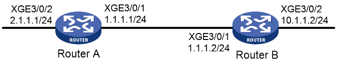

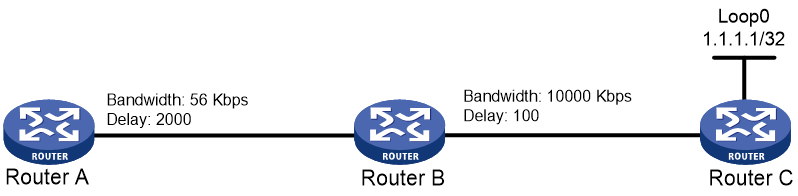

Figure 1 EIGRP composite route metric calculation
As shown in Figure 1, for Path A (between Router A and Router B), the bandwidth is 56 Kbps, and the delay is 2000 (in 10 microseconds). For Path B (between Router B and Router C), the bandwidth is 10000 Kbps, and the delay is 100 (in 10 microseconds). The values for K1 through K5 are 1, 0, 1, 0, and 0, respectively. For a given destination network 1.1.1.1/32, EIGRP calculates the composite metric as follows:
·     For Path A, the metric = 256 × (10000000 / 56 + 2000) = 46226285.
·     For Path B, the metric = 256 × (10000000 / 10000 + 100) = 281600.
·     For the entire path (Path A + Path B), the metric = 256 × [10000000/56 + (2000 + 100)] = 46251885.
The calculation result shows that the metric for the entire path is not calculated by simply summing the metrics for Path A and Path B. For simplicity purposes, the following sections illustrate route metric calculation by simply summing separate path metrics.

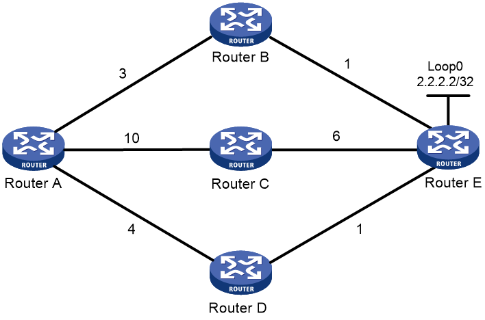

Figure 2 illustrates how EIGRP selects feasible successors and successors for every destination network in the topology table.
Figure 2 EIGRP successor selection
As shown in Figure 2, Router A has three paths to reach the destination network 2.2.2.2/32. The path metrics are represented by numbers for simplicity purposes. By simply summing up all the separate metrics for every path, Router A calculates the following CD values:
·     A CD value of 4 for Path A (through Router B).
·     A CD value of 16 for Path B (through Router C).
·     A CD value of 5 for Path C (through Router D).
Because Path A has the lowest CD value, Router B becomes the successor for the destination network, and the FD value is 4. Router D provides an RD value of 1 that is lower than the FD value, so Router D becomes a feasible successor for Router A.

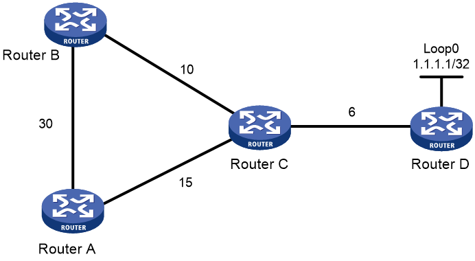

Figure 3 EIGRP route calculation when links are normal
As shown in Figure 3, the metric is 30 for path Router A–Router B, 10 for path Router B–Router C, 15 for path Router A–Router C, and 6 for path Router C–Router D. For a given destination network 1.1.1.1/32, the following conditions exist:
·     For Router A, the shortest path to the destination network is Router A–>Router C–>Router D, with a metric of 21, Router C as the successor, and an FD of 21.
·     For Router B, the shortest path to the destination network is Router B–>Router C–>Router D, with a metric of 16, Router C as the successor, and an FD of 16.
·     For Router C, the shortest path to the destination network is Router C–>Router D, with a metric of 6, Router D as the successor, and an FD of 6.
·     For Router A, Router B advertises an RD of 16, which is smaller than the FD. Router B becomes the FS for the destination network.
·     For Router B, Router A advertises an RD of 21, which is greater than the FD. Router A cannot be the FS for the destination network.

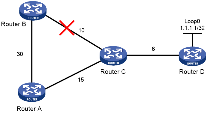

Figure 4 EIGRP route calculation when a link is broken
As shown in Figure 4, when the path Router B–Router C is broken, the available shortest path from Router B to the destination network is Router B–>Router A–>Router C–>Router D. Router A does not match the FC because it advertises an RD of 21 (greater than the FD 16 for the original path). Another route must be selected as follows:
1.     Router B sets the original route to Active state in the topology table, and sends a Query packet to Router A.
2.     Upon receiving the Query packet, Router A checks its topology table. Finding that it has a successor Router C and the route is in Passive state, Router A immediately sends a Reply packet to advertise the route to Router B.
3.     After receiving the Reply packet (which means all Reply packets are received in this example), Router B performs route recalculation. The route, with a CD of 41 and Router A as the successor, is converged on Router B and enters the Passive state.

Example: Configuring basic EIGRP
As shown in Figure 5, enable EIGRP for Router A and Router B to exchange routing information.
Figure 5 Network diagram
1.     Configure IP addresses for interfaces. (Details not shown.)
2.     Configure basic EIGRP settings:
# Create EIGRP process 1 on Router A and enable EIGRP on the specified networks.
<RouterA> system-view
[RouterA] eigrp 1
[RouterA-eigrp-1] address-family ipv4
[RouterA-eigrp-1-ipv4] network 1.1.1.0 0.0.0.255
[RouterA-eigrp-1-ipv4] network 2.1.1.0 0.0.0.255
[RouterA-eigrp-1-ipv4] quit
# Create EIGRP process 1 on Router B and enable EIGRP on the specified networks.
<RouterB> system-view
[RouterB] eigrp 1
[RouterB-eigrp-1] address-family ipv4
[RouterB-eigrp-1-ipv4] network 1.1.1.0 0.0.0.255
[RouterB-eigrp-1-ipv4] network 10.1.1.0 0.0.0.255
[RouterB-eigrp-1-ipv4] quit
# Display neighbor information for EIGRP process 1 on Router A.
[RouterA] display eigrp 1 peer
       Brief EIGRP neighbor Information for AS 1
 Address           State     Hold time    Interface
 1.1.1.2           Up        14           XGE3/0/1
# Display neighbor information for EIGRP process 1 on Router B.
[RouterB] display eigrp 1 peer
 1.1.1.1           Up        10           XGE3/0/1
# Display topology table information for EIGRP process 1 on Router A.
[RouterA] display eigrp 1 topology
        EIGRP topology for AS 1 with Router ID 3.1.1.1
Destination        FD         State    Successor        Out interface
1.1.1.0/24         5120       Passive  Direct           XGE3/0/1
2.1.1.0/24         5120       Passive  Direct           XGE3/0/2
10.1.1.0/24        7680       Passive  1.1.1.2          XGE3/0/1
# Display topology table information for EIGRP process 1 on Router B.
[RouterB] display eigrp 1 topology
        EIGRP topology for AS 1 with Router ID 10.2.1.1
2.1.1.0/24         7680       Passive  1.1.1.1          XGE3/0/1
10.1.1.0/24        5120       Passive  Direct           XGE3/0/2
Example: Configuring EIGRP interface metrics
As shown in Figure 6, enable EIGRP on Router A, Router B, Router C, Router D, and Router E.
Router A has two paths (through Router B and Router C, respectively) to reach Router D. Each path has a bandwidth of 1000000 Kbps and a delay of 100 microseconds.
Configure EIGRP metrics for Ten-GigabitEthernet 3/0/2 on Router A to make the route learned from Router C the optimal route to the destination network 1.1.5.0/24.
Figure 6 Network diagram
Device
Interface
IP address
Router A
XGE3/0/1
1.1.1.1/24
Router A
XGE3/0/2
1.1.2.1/24
Router B
XGE3/0/1
1.1.1.2/24
Router B
XGE3/0/2
1.1.3.1/24
Router C
XGE3/0/1
1.1.2.2/24
Router C
XGE3/0/2
1.1.4.1/24
Router D
XGE3/0/1
1.1.4.2/24
Router D
XGE3/0/2
1.1.3.2/24
Router D
XGE3/0/3
1.1.5.1/24
Router E
XGE3/0/1
1.1.5.2/32
# Configure Router A.
[RouterA] eigrp 1
[RouterA-eigrp-1-ipv4] network 1.1.0.0 0.0.255.255
# Configure Router B.
[RouterB] eigrp 1
[RouterB-eigrp-1-ipv4] network 1.1.0.0 0.0.255.255
# Configure Router C.
<RouterC> system-view
[RouterC] eigrp 1
[RouterC-eigrp-1] address-family ipv4
[RouterC-eigrp-1-ipv4] network 1.1.0.0 0.0.255.255
[RouterC-eigrp-1-ipv4] quit
# Configure Router D.
<RouterD> system-view
[RouterD] eigrp 1
[RouterD-eigrp-1] address-family ipv4
[RouterD-eigrp-1-ipv4] network 1.1.0.0 0.0.255.255
[RouterD-eigrp-1-ipv4] quit
# Configure Router E.
<RouterE> system-view
[RouterE] eigrp 1
[RouterE-eigrp-1] address-family ipv4
[RouterE-eigrp-1-ipv4] network 1.1.0.0 0.0.255.255
[RouterE-eigrp-1-ipv4] quit
        EIGRP topology for AS 1 with Router ID 1.1.1.1
1.1.2.0/24         5120       Passive  Direct           XGE3/0/2
1.1.3.0/24         7680       Passive  1.1.1.2          XGE3/0/1
1.1.4.0/24         7680       Passive  1.1.2.2          XGE3/0/2
1.1.5.0/24         10240      Passive  1.1.2.2          XGE3/0/2
                                       1.1.1.2          XGE3/0/1
The output shows that Router A has two EIGRP routes to the network 1.1.5.0/24 with next hops of Router B (1.1.1.2) and Router C (1.1.2.2), respectively. The FD for the route is 10240.
3.     Configure metrics for an EIGRP interface:
# Configure a delay of 50 microseconds for Ten-GigabitEthernet 3/0/2 on Router A.
[RouterA] interface ten-gigabitethernet 3/0/2
[RouterA-Ten-GigabitEthernet3/0/2] eigrp 1 metric delay 5
# Display topology table information for EIGRP process 1 on Ten-GigabitEthernet 3/0/2 of Router A.
1.1.2.0/24         3840       Passive  Direct           XGE3/0/2
1.1.4.0/24         6400       Passive  1.1.2.2          XGE3/0/2
1.1.5.0/24         8960       Passive  1.1.2.2          XGE3/0/2
The output shows that Router A chooses Router C as the successor after interface metric configuration.

Configure Router B to redistribute direct routes and routes of EIGRP 10 to EIGRP 20. This ensures that Router C can learn routes to networks 10.2.1.0/24 and 11.1.1.0/24, but Router A cannot learn routes to networks 12.3.1.0/24 and 16.4.1.0/24.
Figure 7 Network diagram
2.     Configure basic EIGRP settings (see "Example: Configuring basic EIGRP").
3.     Configure route redistribution:
# Configure Router B to redistribute direct routes and routes of EIGRP 10 to EIGRP 20.
[RouterB] eigrp 20
[RouterB-eigrp-20] address-family ipv4
[RouterB-EIGRP-20-ipv4] import-route direct
[RouterB-EIGRP-20-ipv4] import-route eigrp 10
[RouterB-EIGRP-20-ipv4] quit
# Display topology table information for Router C.
<RouterC> display eigrp topology
        EIGRP topology for AS 20 with Router ID 12.3.1.2
10.2.1.0/24        284160     Passive  12.3.1.1         XGE3/0/1
11.1.1.0/24        284160     Passive  12.3.1.1         XGE3/0/1
12.3.1.0/24        5120       Passive  Direct           XGE3/0/1
16.4.1.0/24        5120       Passive  Direct           XGE3/0/2
The output shows that Router C has learned from Router B the direct route 11.1.1.0/24 and the route 10.2.1.0/24 of EIGRP 10.

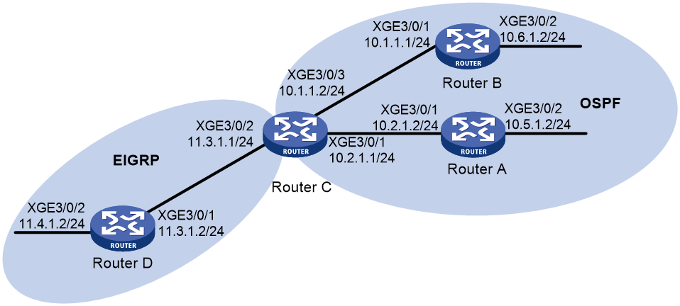

Example: Configuring EIGRP route summarization
As shown in Figure 8, Router A and Router B run OSPF. Router D runs EIGRP. Router C runs OSPF and EIGRP at the same time.
Configure Router C to redistribute OSPF routes, so that Router D can learn routes to networks 10.1.1.0/24, 10.2.1.0/24, 10.5.1.0/24, and 10.6.1.0/24.
To reduce the routing table size of Router D, configure route summarization on Router C to advertise summary route 10.0.0.0/8 instead of the more specific routes.
Figure 8 Network diagram
2.     Configure basic OSPF settings:
[RouterA] ospf
[RouterA-ospf-1] area 0
[RouterA-ospf-1-area-0.0.0.0] network 10.5.1.0 0.0.0.255
[RouterA-ospf-1-area-0.0.0.0] network 10.2.1.0 0.0.0.255
[RouterA-ospf-1-area-0.0.0.0] quit
[RouterA-ospf-1] quit
[RouterB] ospf
[RouterB-ospf-1] area 0
[RouterB-ospf-1-area-0.0.0.0] network 10.1.1.0 0.0.0.255
[RouterB-ospf-1-area-0.0.0.0] network 10.6.1.0 0.0.0.255
[RouterB-ospf-1-area-0.0.0.0] quit
[RouterB-ospf-1] quit
[RouterC] ospf
[RouterC-ospf-1] area 0
[RouterC-ospf-1-area-0.0.0.0] network 10.1.1.0 0.0.0.255
[RouterC-ospf-1-area-0.0.0.0] network 10.2.1.0 0.0.0.255
[RouterC-ospf-1-area-0.0.0.0] quit
[RouterC-ospf-1] quit
3.     Configure basic EIGRP settings:
[RouterC] eigrp 1
[RouterC-eigrp-1-ipv4] network 11.3.1.0 0.0.0.255
[RouterD] eigrp 1
[RouterD-eigrp-1-ipv4] network 11.3.1.0 0.0.0.255
[RouterD-eigrp-1-ipv4] network 11.4.1.0 0.0.0.255
# Configure Router C to redistribute routes from OSPF process 1 and direct routes.
[RouterC] eigrp 1
[RouterC-eigrp-1-ipv4] import-route ospf 1
[RouterC-eigrp-1-ipv4] import-route direct
# Display topology table information for Router D.
[RouterD] display eigrp topology
        EIGRP topology for AS 1 with Router ID 11.1.1.1
10.1.1.0/24        284160     Passive  11.3.1.1         XGE3/0/1
10.2.1.0/24        284160     Passive  11.3.1.1         XGE3/0/1
10.5.1.2/32        284160     Passive  11.3.1.1         XGE3/0/1
10.6.1.2/32        284160     Passive  11.3.1.1         XGE3/0/1
11.3.1.0/24        5120       Passive  Direct           XGE3/0/1
11.4.1.0/24        5120       Passive  Direct           XGE3/0/2
4.     Configure route summarization:
# Enable automatic route summarization on Router C.
[RouterC] eigrp 1
[RouterC-eigrp-1-ipv4] summary automatic
10.0.0.0/8         284160     Passive  11.3.1.1         XGE3/0/1
11.0.0.0/8         7680       Passive  11.3.1.1         XGE3/0/1
The output shows that Router C advertises only a summary route 10.0.0.0/8 to Router D.
