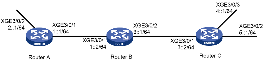

Configuring RIPng FRR
About RIPng FRR
A link or router failure on a path can cause packet loss and even routing loop until RIPng completes routing convergence based on the new network topology. FRR enables fast rerouting to minimize the impact of link or node failures.
Figure 1 Network diagram for RIPng FRR

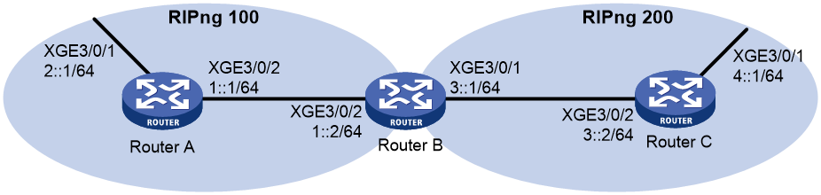

Example: Configuring RIPng route redistribution
As shown in Figure 3, Router B communicates with Router A through RIPng 100 and with Router C through RIPng 200.
Configure route redistribution on Router B, so the two RIPng processes can redistribute routes from each other.
Figure 3 Network diagram
1.     Configure IPv6 addresses for the interfaces. (Details not shown.)
2.     Configure basic RIPng settings:
# Enable RIPng 100 on Router A.
<RouterA> system-view
[RouterA] ripng 100
[RouterA-ripng-100] quit
[RouterA] interface ten-gigabitethernet 3/0/1
[RouterA-Ten-GigabitEthernet3/0/1] ripng 100 enable
[RouterA-Ten-GigabitEthernet3/0/1] quit
[RouterA] interface ten-gigabitethernet 3/0/2
[RouterA-Ten-GigabitEthernet3/0/2] ripng 100 enable
[RouterA-Ten-GigabitEthernet3/0/2] quit
# Enable RIPng 100 and RIPng 200 on Router B.
<RouterB> system-view
[RouterB] ripng 100
[RouterB-ripng-100] quit
[RouterB] interface ten-gigabitethernet 3/0/2
[RouterB-Ten-GigabitEthernet3/0/2] ripng 100 enable
[RouterB-Ten-GigabitEthernet3/0/2] quit
[RouterB] ripng 200
[RouterB-ripng-200] quit
[RouterB] interface ten-gigabitethernet 3/0/1
[RouterB-Ten-GigabitEthernet3/0/1] ripng 200 enable
[RouterB-Ten-GigabitEthernet3/0/1] quit
#  Enable RIPng 200 on Router C.
<RouterC> system-view
[RouterC] ripng 200
[RouterC] interface ten-gigabitethernet 3/0/1
[RouterC-Ten-GigabitEthernet3/0/1] ripng 200 enable
[RouterC-Ten-GigabitEthernet3/0/1] quit
[RouterC] interface ten-gigabitethernet 3/0/2
[RouterC-Ten-GigabitEthernet3/0/2] ripng 200 enable
[RouterC-Ten-GigabitEthernet3/0/2] quit
# Display the routing table on Router A.
[RouterA] display ipv6 routing-table
Destinations : 6 Routes : 6
Destination: ::1/128                                     Protocol  : Direct
NextHop    : ::1                                         Preference: 0
Interface  : InLoop0                                     Cost      : 0
Destination: 1::/64                                      Protocol  : Direct
NextHop    : ::                                          Preference: 0
Interface  : XGE3/0/2                                    Cost      : 0
Destination: 1::1/128                                    Protocol  : Direct
Destination: 2::/64                                      Protocol  : Direct
Interface  : XGE3/0/1                                    Cost      : 0
Destination: 2::1/128                                    Protocol  : Direct
Destination: FE80::/10                                   Protocol  : Direct
Interface  : NULL0                                       Cost      : 0
3.     Configure RIPng route redistribution:
# Configure route redistribution between the two RIPng processes on Router B.
[RouterB] ripng 100
[RouterB-ripng-100] import-route ripng 200
[RouterB] ripng 200
[RouterB-ripng-200] import-route ripng 100

Example: Configuring RIPng GR
As shown in Figure 4, Router A, Router B, and Router C learn IPv6 routing information through RIPng.
Configure Router A as the GR restarter. Configure Router B and Router C as the GR helpers to synchronize their routing tables with Router A by using GR.
Figure 4 Network diagram
2.     Configure RIPng on the routers to ensure the following: (Details not shown.)
¡     Router A, Router B, and Router C can communicate with each other at Layer 3.
¡     Dynamic route update can be implemented among them with RIPng.

Example: Using an IPsec profile to protect RIPng
As shown in Figure 6, configure RIPng on the routers, and configure IPsec profiles on the routers to authenticate and encrypt protocol packets.
Figure 6 Network diagram

4.     Apply the IPsec profiles to the RIPng process on each device:
¡     On Router A:
[RouterA] ripng 1
[RouterA-ripng-1] enable ipsec-profile profile001
[RouterA-ripng-1] quit
¡     On Router B:
[RouterB] ripng 1
[RouterB-ripng-1] enable ipsec-profile profile001
[RouterB-ripng-1] quit
¡     On Router C:
[RouterC] ripng 1
[RouterC-ripng-1] enable ipsec-profile profile001
[RouterC-ripng-1] quit
# Verify that the RIPng packets between Routers A, B, and C are protected by IPsec. (Details not shown.)
