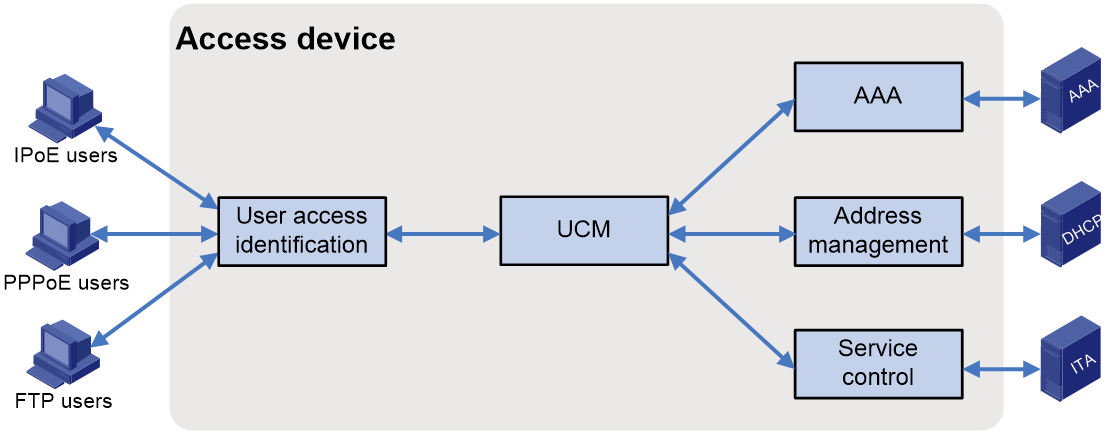

User Connection Management (UCM) is a unified user management component. UCM centralizedly manages connections of various access users to simplify user management and O&M.
Basic UCM functional structure
As shown in Figure 1, the access user login procedure involves five components. UCM is the bridge among the other four components. UCM coordinates the interoperation among these components and assists user connection setup, maintenance, and removal.
Figure 1 Basic UCM functional structure
This chapter describes only the basic functions of these components. For more information, see the documents for these components.
The basic functions of these components are as follows:
·     User access identification component—Identifies and processes various access protocol packets of users, and obtains the usernames, passwords, and physical locations of users in the user authentication procedure to provide information and security for valid user access.
·     UCM component—Acts as a bridge among the other four components to coordinate the interoperation among these components and assist user connection setup, maintenance, and removal.
·     AAA component—Performs authentication, authorization, and accounting for users.
·     Address management component—Allocates IP addresses to access users, and ensure proper use of IP resources through unified IP address management.
·     Service control component—Controls the access privilege, bandwidth, and QoS policies for the basic services and value-added services of access users.
