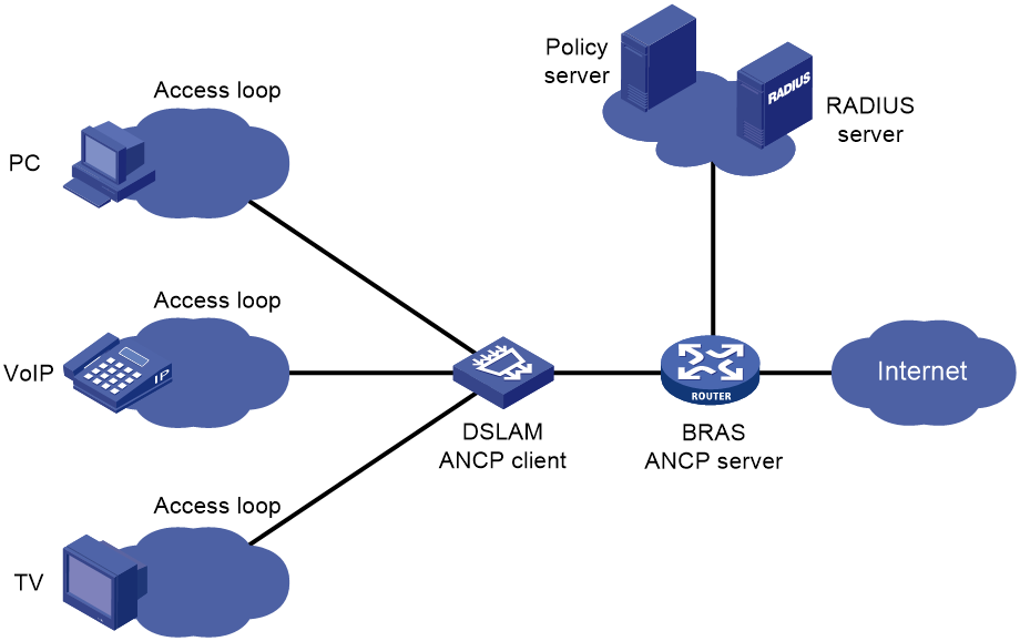

As shown in Figure 1, the ANCP client runs on a DSLAM (an AN), and the ANCP server runs on a BRAS (an H3C device). Access loops are digital subscriber lines (DSLs).
Figure 1 ANCP network diagram
ANCP works between the DSLAM and the BRAS as follows:

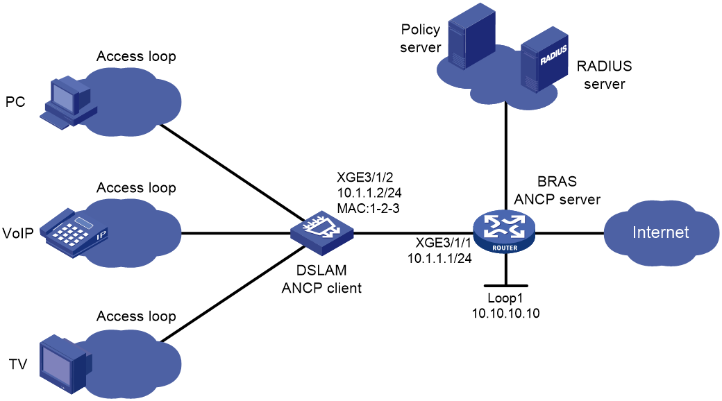

As shown in Figure 2, users access the network through IPoE or PPPoE. The RADIUS server performs user authentication and accounting.
Configure ANCP to achieve the following purposes:
·     The BRAS can dynamically discover DSLs on the DSLAM.
·     The BRAS can configure DSLs.
·     The BRAS can perform OAM tests on DSLs.
Figure 2 Network diagram
1.     Configure the DSLAM so it can reach interface loopback 1 on the BRAS.
2.     Enable the ANCP client on the DSLAM.
3.     Configure BRAS access, including the authentication scheme, accounting scheme, RADIUS server, address pool, uplink interfaces, and so on. For more information, see related configuration guides.
