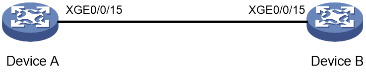

Synchronous Ethernet configuration examples
Example: Configuring SyncE
As shown in Figure 1, configure SyncE on the devices for high-precision frequency synchronization.
# On Device A, enable the synchronous mode and ESMC on Ten-GigabitEthernet 0/0/15.
<DeviceA> system-view
[DeviceA] interface ten-gigabitethernet 0/0/15
[DeviceA-Ten-GigabitEthernet0/0/15] synchronous mode
[DeviceA-Ten-GigabitEthernet0/0/15] esmc enable
[DeviceA-Ten-GigabitEthernet0/0/15] quit
# On Device B, enable the synchronous mode and ESMC on Ten-GigabitEthernet 0/0/15.
<DeviceB> system-view
[DeviceB] interface ten-gigabitethernet 0/0/15
[DeviceB-Ten-GigabitEthernet0/0/15] synchronous mode
[DeviceB-Ten-GigabitEthernet0/0/15] esmc enable
[DeviceB-Ten-GigabitEthernet0/0/15] quit
# Verify that ESMC is enabled on both Device A and Device B when they are connected to their respective clock references. The clock QLs of Device A and Device B are QL-PRC and QL-SEC, respectively. Device A provides more precise timing than Device B.
[DeviceA] display esmc
Interface : Ten-GigabitEthernet0/0/15
Mode : Synchronous
ESMC status : Enable
ESMC bundle : N/A
Port status : Up
Duplex mode : Full
QL received : QL-SEC
QL sent : QL-PRC
ESMC information packets received : 2195
ESMC information packets sent : 6034
ESMC event packets received : 1
ESMC event packets sent : 1
ESMC information rate : 1 packets/sec
ESMC expiration : 5 seconds
[DeviceB] display esmc
Mode : Synchronous
ESMC bundle : N/A
Port status : Up
Duplex mode : Full
QL received : QL-PRC
QL sent : QL-SEC
ESMC information packets received : 6034
ESMC information packets sent : 2195
# Verify that QL information is exchanged correctly after synchronization between Device A and Device B. Ten-GigabitEthernet0/0/15 on Device B becomes a reference input port. The clock QL sent from Device B to Device A changes to QL-DNU.
Mode : Synchronous
ESMC bundle : N/A
Port status : Up
Duplex mode : Full
QL received : QL-DNU
QL sent : QL-PRC
ESMC information packets received : 2573
ESMC information packets sent : 6412
Mode : Synchronous
ESMC bundle : N/A
Port status : Up
Duplex mode : Full
QL sent : QL-DNU
ESMC information packets received : 6412
ESMC information packets sent : 2573
