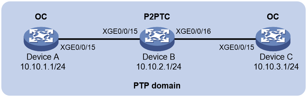

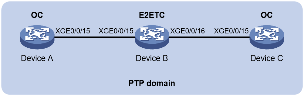

Clock node and PTP port (IEEE 1588 version 2)
A node in a PTP domain is called a clock node. A port enabled with PTP is called a PTP port. IEEE 1588 version 2 defines the following types of basic clock nodes:
· Ordinary Clock (OC)—A PTP clock with a single PTP port in a PTP domain for time synchronization. It synchronizes time from its upstream clock node through the port. If an OC operates as the clock source, it sends synchronization time through a single PTP port to its downstream clock nodes.
· Boundary Clock (BC)—A clock with more than one PTP port in a PTP domain for time synchronization. A BC uses one of the ports to synchronize time from its upstream clock node. It uses the other ports to synchronize time to the relevant downstream clock nodes. If a BC operates as the clock source, such as BC 1 in Figure 1, it synchronizes time through multiple PTP ports to its downstream clock nodes.
· Transparent Clock (TC)—A TC does not keep time consistency with other clock nodes. A TC has multiple PTP ports. It forwards PTP messages among these ports and performs delay corrections for the messages, instead of performing time synchronization. TCs include the following types:
¡ End-to-End Transparent Clock (E2ETC)—Forwards non-P2P PTP messages in the network and calculates the delay of the entire link.
¡ Peer-to-Peer Transparent Clock (P2PTC)—Forwards only Sync, Follow_Up, and Announce messages, terminates other PTP messages, and calculates the delay of each link segment.
Figure 1 shows the positions of these basic clock nodes in a PTP domain.
Figure 1 Clock nodes and PTP ports in a PTP domain (IEEE 1588 version 2)
In addition to these basic types of clock nodes, PTP introduces hybrid clock nodes. For example, a TC+OC has multiple PTP ports in a PTP domain. One port is the OC type, and the others are the TC type.
A TC+OC forwards PTP messages through TC-type ports and performs delay corrections. In addition, it synchronizes time through its OC-type port. TC+OCs include these types: E2ETC+OC and P2PTC+OC.

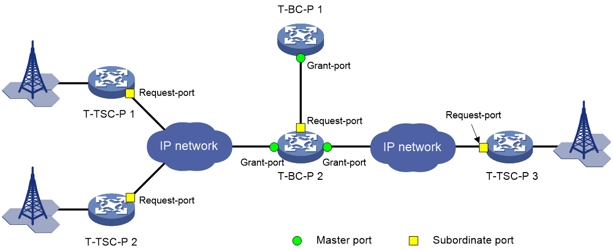

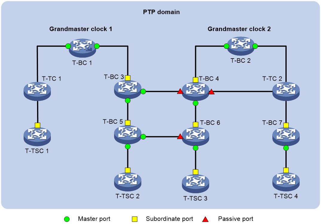

Clock node and PTP port (ITU-T G.8275.1)
A node in a PTP domain is a clock node. A port enabled with PTP is a PTP port.
ITU-T G.8275.1 defines the following types of basic clock nodes:
· Telecom boundary clock (T-BC)—A clock node with more than one PTP port in a PTP domain for time synchronization. It uses one of the ports to synchronize time to its upstream clock node and uses the other ports to distribute time to the downstream clock nodes. If a T-BC operates as the clock source, it distributes time through multiple PTP ports to its downstream clock nodes.
· Telecom transparent Clock (T-TC)—A clock code that forwards non-P2P PTP messages in the network. The forwarding duration will be included in calculation of the entire link delay.
· Telecom time slave clock (T-TSC) —An OC clock node (as defined in IEEE 1588 version 2 and IEEE 802.1AS) that can act only as a member clock.
Figure 2 Clock nodes and PTP ports in a PTP domain (ITU-T G.8275.1)

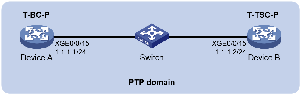

Clock nodes and PTP ports (ITU-T G.8275.2)
ITU-T G.8275.2 defines the following types of basic clock nodes:
· Partial-support telecom boundary clock (T-BC-P)—A clock node with more than one PTP port in a PTP domain for time synchronization. It uses one of the ports to synchronize time to its upstream clock node and uses the other ports to distribute time to the downstream clock nodes. When a T-BC-P clock node is a clock source, it distributes time through multiple PTP ports to its downstream clock nodes.
· Partial-support telecom time slave clock (T-TSC-P)—A clock node with a single PTP port in a PTP domain for time synchronization. It synchronizes time from its upstream clock node through the port. It can operate only as a member clock.
Figure 3 shows the positions of these basic clock nodes in a PTP domain.
Figure 3 Clock nodes and PTP ports in a PTP domain (ITU-T G.8275.2)

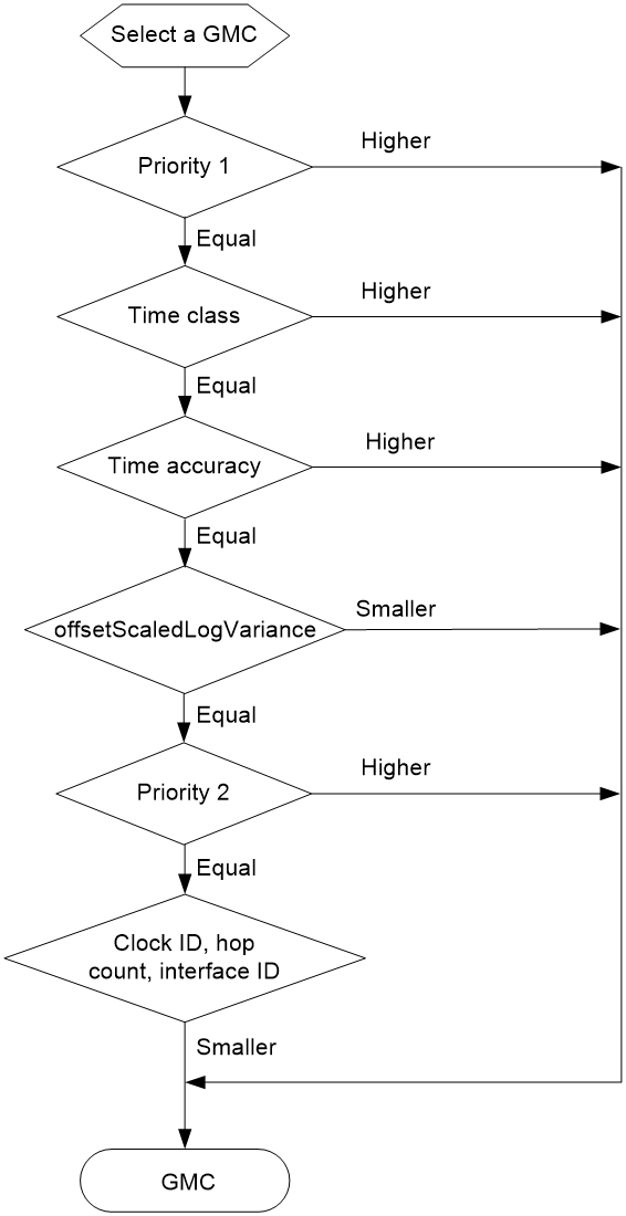

Grandmaster clock selection
A GM can be manually specified. It can also be automatically elected through the BMC algorithm as follows:
1. The clock nodes in a PTP domain exchange announce messages and elect a GM by using the following rules in descending order of precedence:
a. Clock node with higher priority 1.
b. Clock node with higher time class.
c. Clock node with higher time accuracy.
d. Clock node with higher priority 2.
e. Clock node with a smaller port ID (containing clock number and port number).
The master nodes, member nodes, master ports, and subordinate ports are determined during the process. Then a spanning tree with the GM as the root is generated for the PTP domain.
2. The master node periodically sends announce messages to the member nodes. If the member nodes do not receive announce messages from the master node, they determine that the master node is invalid, and they start to elect another GM.
Figure 1 BMC comparison rule for GMC selection

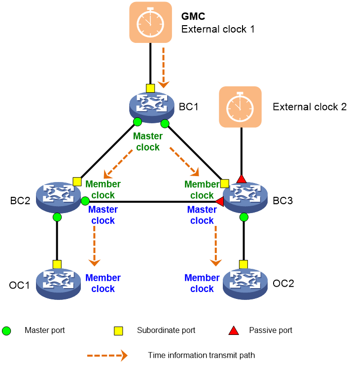

Establishing master-member/subordinate relationships
The master-member/subordinate relationships between the clock nodes (except for the TCs) on a PTP network are automatically determined based on the Best Master Clock (BMC) algorithm. You can also manually specify a role for the clock nodes.
The following master-member/subordinate relationships exist:
· Master/Member node—A master node propagates time synchronization information, and a member node receives time synchronization information.
· Master/Member clock—The clock on a master node is a master clock. The clock on a member node is a member clock.
· Master/Subordinate port—A master port propagates time synchronization, and a subordinate port receives time synchronization information. The master and subordinate ports can be on a BC or an OC. A port that neither propagates nor receives timing information is a passive port. Passive ports are used to prevent PTP messages from forming loops.
After the grandmaster clock is elected and master-member/subordinate relationships are established, a loop-free, all connected shortest path tree with the grandmaster clock as the root is established in the PTP domain, as shown in Figure 2. Time is synchronized between the clock nodes in the domain along the path tree.
Figure 2 PTP master-member/subordinate relationships
a. Clock node with higher time class.
b. Clock node with higher time accuracy.
c. Clock node with higher priority 2.
d. Clock node with higher local priority.
You can use the ptp priority clock-source command to set the local priority for the local node.
To set a local priority for the peer node, use the ptp local-priority command to set a local priority for the PTP interface connected to the peer node. This priority will be used as the local priority of the peer node.
e. Whether the time class values of the clock nodes are smaller than or equal to 127.
- If the time class values of the clock nodes are smaller than or equal to 127, two or more clock nodes are elected GMs in the PTP domain. A member node selects the GM nearer to it as its master node. Two or more spanning trees are generated. No PTP messages are exchanged between the trees.
- If the time class values of the clock nodes are greater than 127, the clock node with a smaller port ID (containing clock number and port number) will be the GM.
ITU-T G.8275.2
This profile allows using two approaches to establish a synchronization tree.
· Specifying the grant-ports and request-ports—The request-ports request announce messages from a specific grant-port and the grant-port grants and provides announce messages to the request-ports, to quickly determine the GM. Plan in advance to ensure that the device where the grant-port resides has the best clock source. If the device does not have the best clock source, the request-ports will be in listening state, resulting in time synchronization failure.
· Dynamic election—All clock ports exchange announce messages to elect the GM and establish a synchronization tree.
In a PTP domain, use the same approach on the clock nodes to establish a synchronization tree as a best practice. If you apply the two approaches on the same device, both the announce messages requested by the request-port and received during dynamic election participate in Alternate BMC calculation for GM election. As a result, the request-ports might not be selected as the ports for clock synchronization.

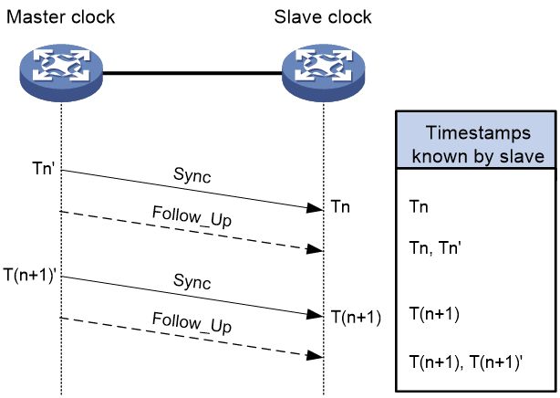

Frequency synchronization mechanism
After the grandmaster clock is selected and master-member relationships are established, the master clock sends Sync messages to the member clocks periodically. Assume that the path delay between the master and member clock nodes remains unchanged, if the frequency of the member clock and the master clock are synchronized, the time offset between the master and member clock will be the same at the same intervals, which is T(n+1)–Tn = T(n+1)'–Tn', as shown in Figure 3.
1. If T(n+1)–Tn > T(n+1)'–Tn', the member clock is faster in frequency than the master clock and will reduce its frequency.
2. If T(n+1)–Tn < T(n+1)'–Tn', the member clock is slower in frequency than the master clock and will increase frequency faster.
The member clock uses the formula T(n+1)–Tn / T(n+1)'–Tn' to calculate its frequency ratio with the master clock and adjust its clock frequency accordingly.
PTP frequency synchronization can run in single-step mode or two-step mode. The figure below shows the most commonly used two-step frequency synchronization mode. In single-step mode, Tn' and T(n+1)' timestamps are carried in a Sync message, and no Follow_Up message is sent.
Figure 3 PTP frequency synchronization in two-step mode
PTP frequency synchronization can run in one of the following modes:
· Single-step mode—Uses Sync and Pdelay_Resp messages to carry timestamps, and does not send follow-up messages (Follow_Up or Pdelay_Resp_Follow_Up). The single-step mode has fewer interactive messages than the two-step mode, and occupies less network bandwidth, but it requires hardware chip support. In single-step mode, a timestamp is assigned before the message is sent. Therefore, the timestamp sent in single-step mode is the estimated message sending time that is not as accurate as the two-step mode.
· Two-step mode—Uses Follow_Up messages to carry Sync message transmit timestamps and Pdelay_Resp_Follow_Up messages to carry Pdelay_Req message receive and Pdelay_Resp message transmit timestamps. The timestamps sent in two-step mode is the actual sending time of the messages, so the two-step mode is more accurate than the single-step mode and can improve PTP time synchronization accuracy.

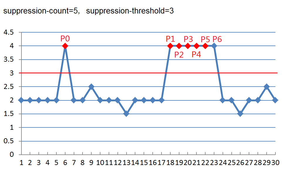

Configuring the PTP offset threshold and PTP synchronization suppressions
Application scenarios
This command is used to prevent clock source jumps. With this mechanism, the device can ensure that time synchronization is restored after the clock source stabilizes, and avoid time synchronization errors caused by sudden clock changes.
Operating mechanism
After master-member relationships are established between the clock nodes, the master and member clock nodes exchange PTP messages and record the message transmit and receive time. Based on the timestamps, each member clock calculates the path delay and then gets the time offset between them and the master clock and adjusts their time accordingly for time synchronization with the master clock.
With this command configured, if the clock is in a stable synchronization state but the offset value at the current sampling point exceeds the PTP time offset threshold, the device will identify this as a clock source jump and stop the current PTP time synchronization. The device will then determine whether to synchronize subsequent clock signals based on the following rules:
· If the offset for the next sampling point is smaller than or equal to the PTP time offset threshold, the device continues synchronization with the clock source.
· If the offset is greater the PTP time offset threshold, the device performs PTP time synchronization only when the number of suppressions reaches the specified value. When the device receives the next clock signal, it performs PTP time synchronization no matter whether the offset value is greater than the PTP time offset threshold or not.
Assume that the values for suppression-count and threshold-value are set to 5 and 3, respectively. When the offset is less than or equal to 3, the device synchronizes its time with the clock source normally. When a sudden clock change causes the offset to exceed 3, the device stops synchronization with the clock signal until the value of suppression-count is reached. As shown in Figure 6, because the offset value is greater than 3 at sampling points P0 through P5, the device stops synchronization with the clock source. At sampling point P6, the device starts to synchronize with the clock source no matter whether the offset is greater than the PTP time offset threshold or not, because the number of suppressions has reached 5.
Figure 6 PTP clock source jump prevention
1. Enter system view.
2. Configure the PTP offset threshold and the number of times PTP time synchronization is suppressed.
ptp time-offset { suppression-count suppression-count | suppression-threshold threshold-value } *
By default, the PTP offset threshold is 3000 nanoseconds, and PTP time synchronization is suppressed twice.

Configuring a priority for a clock (ITU-T G.8275.1 and ITU-T G.8275.2)
Under the ITU-T G.8275.1 or ITU-T G.8275.2 PTP profile, you can configure priorities for the local clock node and the peer clock node.
Priorities for clocks affect the GM election. The smaller the priority value, the higher the priority. For more information about GM election, see "PTP operating mechanisms
Grandmaster clock selection and master-member/subordinate relationship establishment."

As shown in Figure 7, configure PTP (IEEE 1588 version 2, IEEE 802.3/Ethernet transport, multicast transmission) to enable time synchronization between Device A and Device C.
· Specify the IEEE 1588 version 2 PTP profile and multicast IEEE 802.3/Ethernet transport of PTP messages for Device A, Device B, and Device C.
· Assign Device A, Device B, and Device C to the same PTP domain. Specify the OC clock node type for Device A and Device C, and E2ETC clock node type for Device B. All clock nodes elect a GM through BMC in the PTP domain.
· Use the default Request_Response delay measurement mechanism on Device A and Device C.
1. Configure Device A:
# Specify the IEEE 1588 version 2 PTP profile.
<DeviceA> system-view
[DeviceA] ptp profile 1588v2
# Specify the OC clock node type.
[DeviceA] ptp mode oc
# Specify PTP for obtaining the time on the default MDC.
[DeviceA] clock protocol ptp mdc 1
# Enable PTP on Ten-GigabitEthernet 0/0/15.
[DeviceA] interface ten-gigabitethernet 0/0/15
[DeviceA-Ten-GigabitEthernet0/0/15] ptp enable
[DeviceA-Ten-GigabitEthernet0/0/15] quit
2. Configure Device B:
<DeviceB> system-view
[DeviceB] ptp profile 1588v2
# Specify the E2ETC clock node type.
[DeviceB] ptp mode e2etc
[DeviceB] clock protocol ptp mdc 1
[DeviceB] interface ten-gigabitethernet 0/0/15
[DeviceB-Ten-GigabitEthernet0/0/15] ptp enable
[DeviceB-Ten-GigabitEthernet0/0/15] quit
# Enable PTP on Ten-GigabitEthernet 0/0/16.
[DeviceB] interface ten-gigabitethernet 0/0/16
[DeviceB-Ten-GigabitEthernet0/0/16] ptp enable
[DeviceB-Ten-GigabitEthernet0/0/16] quit
3. Configure Device C:
<DeviceC> system-view
[DeviceC] ptp profile 1588v2
[DeviceC] ptp mode oc
[DeviceC] clock protocol ptp mdc 1
[DeviceC] interface ten-gigabitethernet 0/0/15
[DeviceC-Ten-GigabitEthernet0/0/15] ptp enable
[DeviceC-Ten-GigabitEthernet0/0/15] quit
When the network is stable, perform the following tasks:
· Use the display ptp clock command to display PTP clock information.
· Use the display ptp interface brief command to display brief PTP running information for all PTP interfaces.
# Display PTP clock information on Device A.
[DeviceA] display ptp clock
PTP profile : IEEE 1588 Version 2
PTP mode : OC
Slave only : No
Sync uncertain : Disabled
Clock state : Disabled
Lock status : Unlocked
Clock ID : 000FE2-FFFE-FF0000
Clock type : Local
Clock domain : 0
Number of PTP ports : 1
Priority1 : 128
Priority2 : 128
Clock quality :
Class : 248
Accuracy : 254
Offset (log variance) : 65535
Offset from master : 0 (ns)
Mean path delay : 0 (ns)
Steps removed : 0
Local clock time : Sun Jan 15 20:57:29 2019
Clock source info:
Clock Pri1 Pri2 Accuracy Class TimeSrc Direction In-Status Offset(log variance)
Local 128 128 254 248 160 N/A N/A 65535
ToD0 128 128 32 6 32 In Inactive 65535
ToD1 128 128 32 6 32 N/A Inactive 65535
# Display brief PTP running information for all PTP interfaces on Device A.
[DeviceA] display ptp interface brief
Name State Delay mechanism Clock step Asymmetry correction
XGE0/0/15 Master E2E Two 0
# Display PTP clock information on Device B.
[DeviceB] display ptp clock
PTP mode : E2ETC
Slave only : No
Clock ID : 000FE2-FFFE-FF0001
Clock type : Local
Clock domain : 0
Number of PTP ports : 2
Priority1 : 128
Priority2 : 128
Clock quality :
Class : 248
Accuracy : 254
Offset from master : N/A
Mean path delay : N/A
Steps removed : N/A
Clock source info:
# Display brief PTP running information for all PTP interfaces on Device B.
[DeviceB] display ptp interface brief
XGE0/0/15 N/A E2E Two 0
XGE0/0/16 N/A E2E Two 0
The output shows that Device A is elected as the GM, and Ten-GigabitEthernet0/0/15 on Device A is the master port.
Example: Configuring PTP (IEEE 1588 version 2, IPv4 UDP transport, multicast transmission)
As shown In Figure 8, configure PTP (IEEE 1588 version 2, IPv4 UDP transport, multicast transmission) to enable time synchronization between the devices.
· Specify the IEEE 1588 version 2 PTP profile and multicast IPv4 UDP transport of PTP messages for Device A, Device B, and Device C.
· Assign Device A, Device B, and Device C to the same PTP domain. Specify the OC clock node type for Device A and Device C, and P2PTC clock node type for Device B. All clock nodes elect a GM through BMC in the PTP domain.
· Specify the peer delay measurement mechanism (p2p) for Device A and Device C.
# Configure the source IP address for multicast PTP messages transmitted over IPv4 UDP.
[DeviceA] ptp source 10.10.1.1
# On Ten-GigabitEthernet 0/0/15, specify the IPv4 UDP transport protocol for PTP messages and the peer delay measurement mechanism, and enable PTP.
[DeviceA-Ten-GigabitEthernet0/0/15] ptp transport-protocol udp
[DeviceA-Ten-GigabitEthernet0/0/15] ptp delay-mechanism p2p
# Specify the P2PTC clock node type.
[DeviceB] ptp mode p2ptc
[DeviceB] ptp source 10.10.2.1
# On Ten-GigabitEthernet 0/0/15, specify the IPv4 UDP transport protocol for PTP messages and enable PTP.
[DeviceB-Ten-GigabitEthernet0/0/15] ptp transport-protocol udp
# On Ten-GigabitEthernet 0/0/16, specify the IPv4 UDP transport protocol for PTP messages and enable PTP.
[DeviceB-Ten-GigabitEthernet0/0/16] ptp transport-protocol udp
[DeviceC] ptp source 10.10.3.1
[DeviceC-Ten-GigabitEthernet0/0/15] ptp transport-protocol udp
[DeviceC-Ten-GigabitEthernet0/0/15] ptp delay-mechanism p2p

5. Configure the base station.
# Specify PTP domain 0.
# Specify IPv4 UDP transport of PTP messages.
# Set the destination IP address of unicast PTP messages to 12.10.10.2.
# Specify the Request_Response delay measurement mechanism.
For more information, see the configuration guide for the base station.
PTP mode : BC
Slave only : No
Clock type : ToD0
ToD direction : In
ToD delay time : 1000 (ns)
Offset from ToD: 10 (ns)
Clock domain : 0
Priority1 : 0
Priority2 : 128
Clock quality :
Class : 6
Accuracy : 32
Steps removed : 0
Clock source info:
ToD0 128 128 32 6 32 In Active 65535
# Display PTP clock information on Device C.
[DeviceC] display ptp clock
PTP mode : BC
Slave only : No
Lock status : Locked
Clock type : Local
Clock domain : 0
Priority1 : 128
Priority2 : 128
Clock quality :
Class : 248
Accuracy : 254
Offset from master : 50 (ns)
Mean path delay : 2791 (ns)
Steps removed : 2
Clock source info:
# Display brief PTP running information for all PTP interfaces on Device C.
[DeviceC] display ptp interface brief
XGE0/0/15 Slave E2E Two 0
XGE0/0/16 Master E2E Two 0

Example: Configuring PTP (ITU-T G.8275.2, IPv4 UDP encapsulation, unicast transmission)
As shown in Figure 11, Device A and Device B are in a PTP domain. The switch is a Layer 2 switch that does not support PTP. Configure PTP (ITU-TG.8275.2, IPv4 UDP encapsulation, unicast transmission) to enable Device B to synchronize to Device A.
· Specify the ITU-TG.8275.2 PTP profile for Device A and Device B.
· Use the default Request_Response delay measurement mechanism on Device A and Device B.
Configure IP addresses and routing protocols for the devices. Make sure the devices are reachable to each other.
IMPORTANT: The ITU-T G.8275.2 PTP profile transports PTP messages over IPv4 UDP rather than IEEE 802.3/Ethernet and in unicast rather than multicast mode. |
